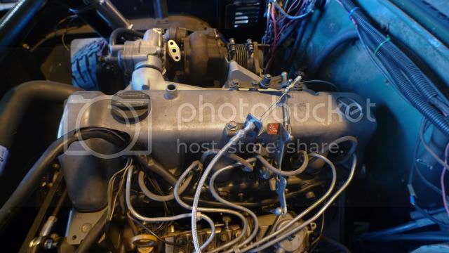

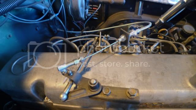

worked on converting to a cable linkage for my om617 conversion...here's what I came up with:
used one of the original mercedes cruise-control brackets :)
will be adding a stop to the skinny peddle to limit the throw...but seems to operate nicely.
