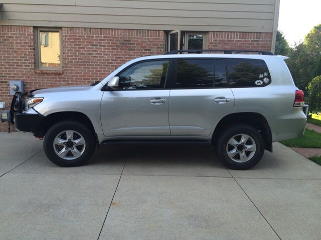

I know it's kind of a nothing mod but hey I did something:) New wheels and tires on Tuesday!!! Couldn't swing 35's cause this is our family road trip machine and I don't have a spot for the spare yet! Once I get a rear bumper I'll jump up to 35's also, hey "A guy needs two pairs of shoes" right:cheers:
new tires? wotjaget ?

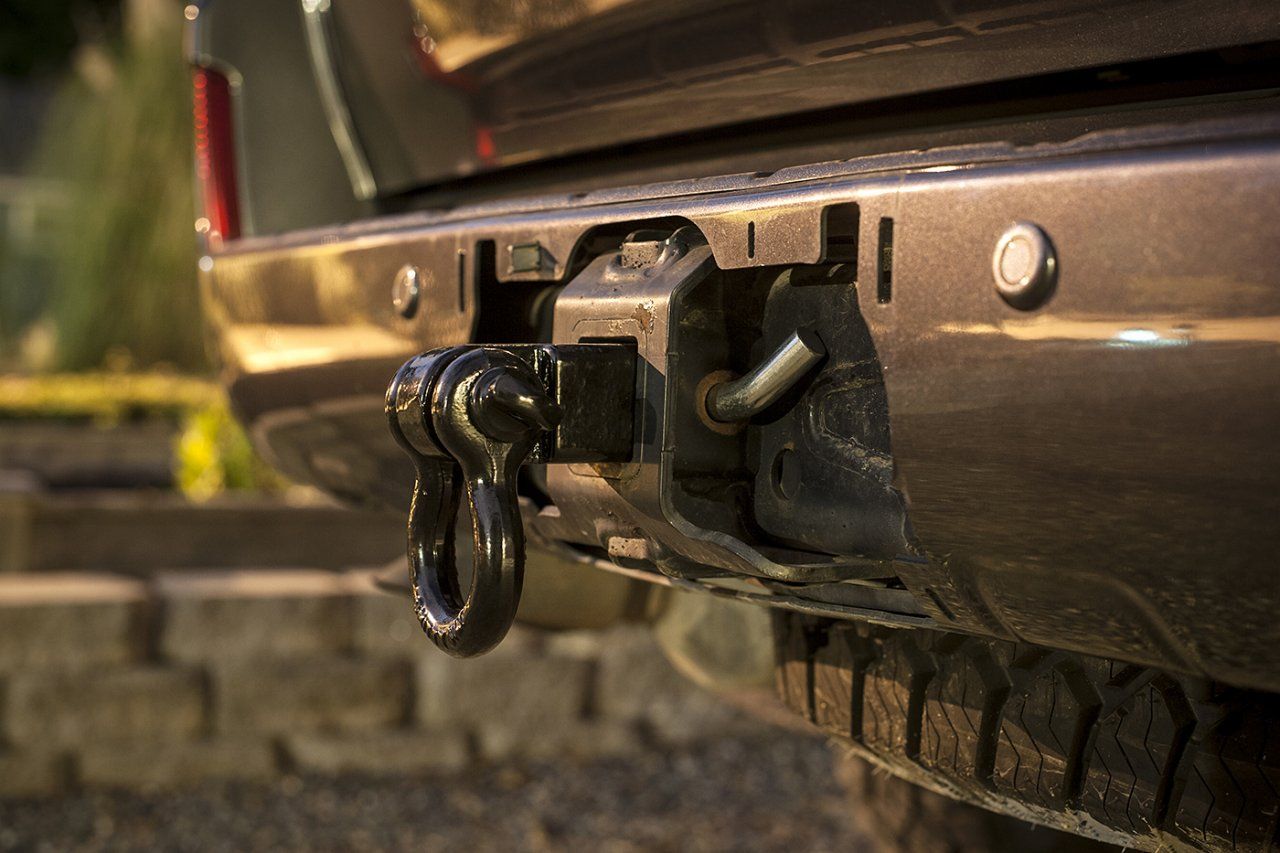

just picked up the little tow dealeo that ya slide in the tow hitch spot, nothing major! New tires on Tuesday, 285/70/R18's in the BFG Mud Terrain flavor!
