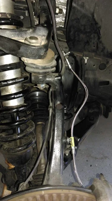

Atwalz, great info. Thanks for posting. In the instructions for this method, was there any description of what could happen if you leave the rears open too long?
I just installed stainless lines last weekend and didn't follow this procedure. Don't think I had the lines open too long, just curious of what might have been affected.
planning on re-bleeding this weekend.....:bang:
I've been considering changing out my brake lines for nice SS ones as well. I'm having trouble finding a source online. Did you have them made locally or order them from some place? I appreciate any good sources.

Brussum, I would recommend having the lines made locally. I ordered a kit from Goodrige out of England. Top quality, but not 100% correct. The fittings are right, but the mounting and lengths are a little off. The fronts are +2" which is why I went with the kit. the rears took some creative routing to get to work. They do work great, and I don't have to worry about full travel in the front!
If you can't find it locally, I used the +2 kit for a 2006 land cruiser:
Goodridge G-Stop Brake Lines (2-21127)
G-Stop Brake Line Kit
2in Extended Line
6 Line Kit
