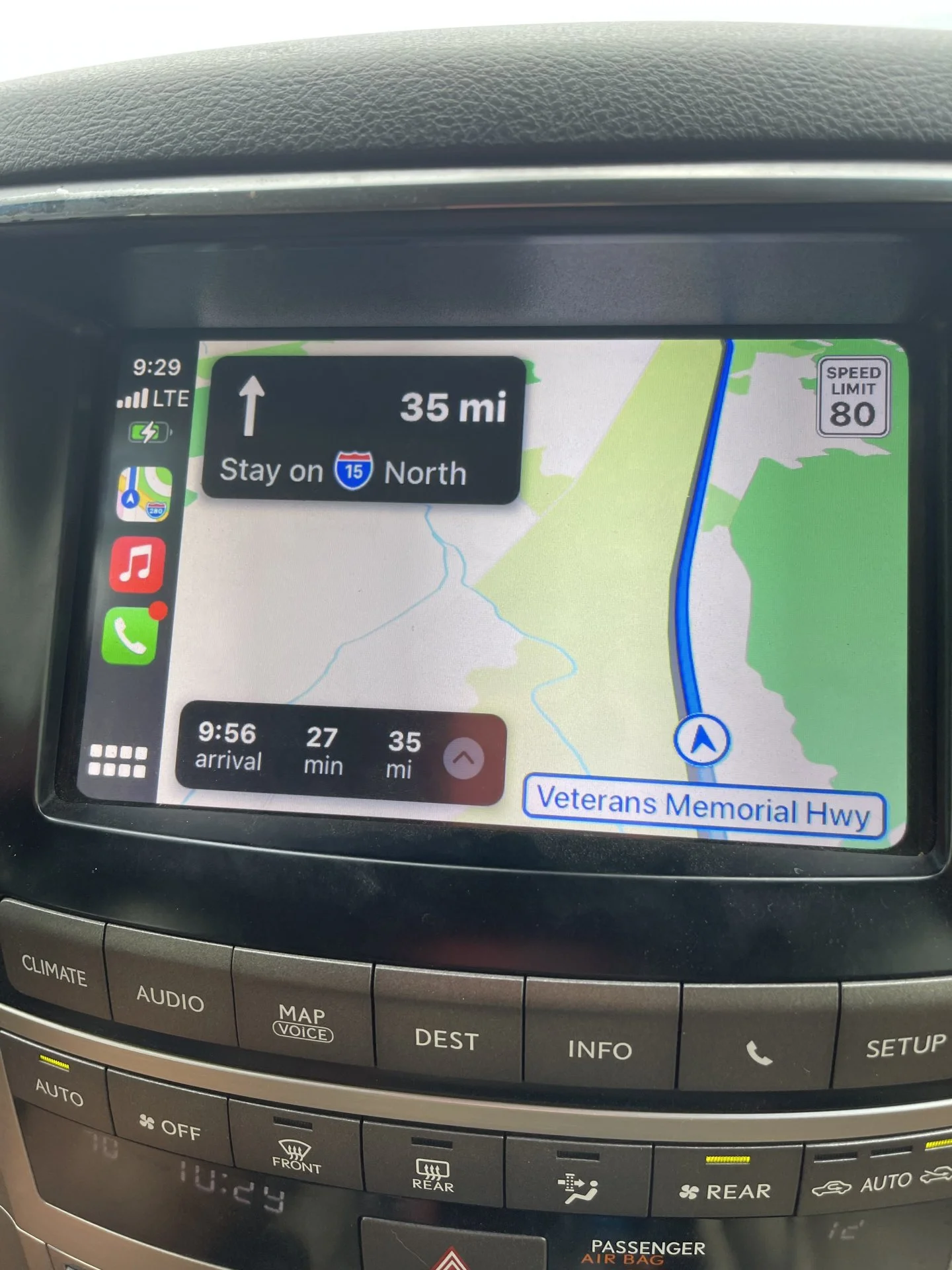

Ha you were fine! I noticed gas got really expensive as I moved North and West....This is never a good feeling when your GPS says this is the closest fuel:

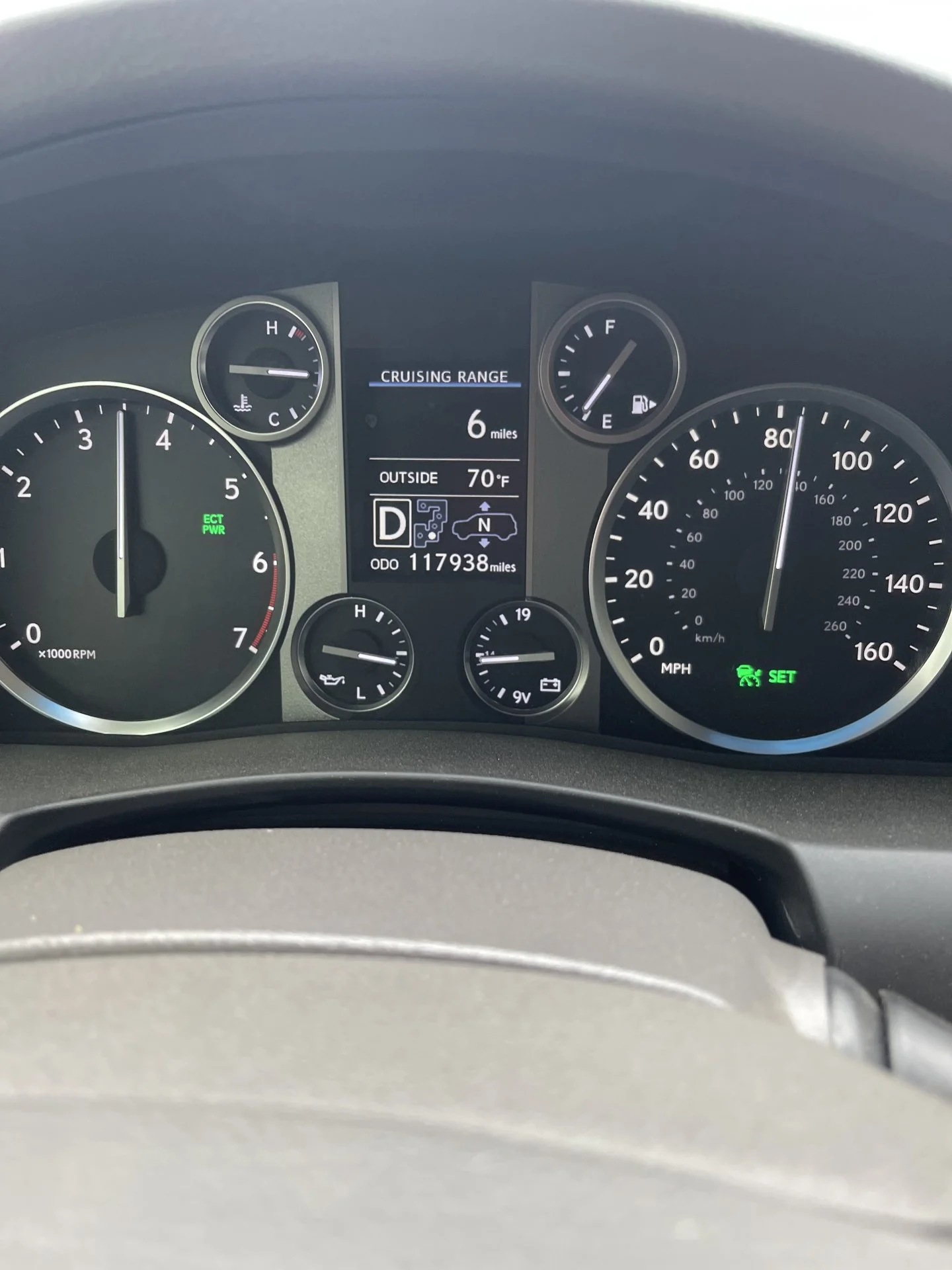

And your fuel gauge says this:

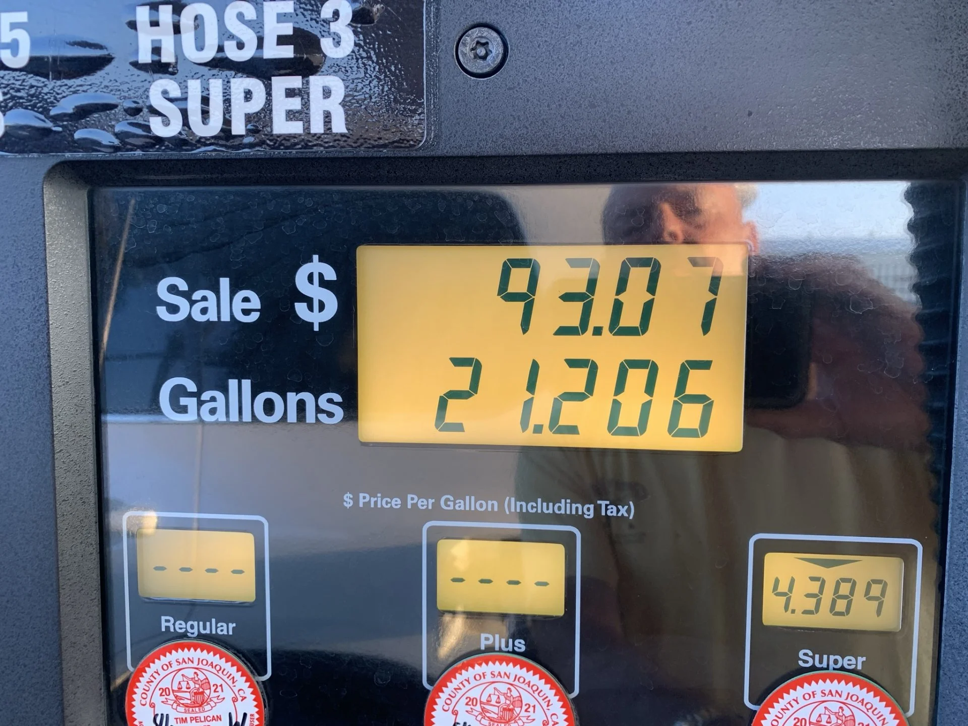

Tank took 22.6 gal to fill, so I had a couple gallons to spare.
Question
Would 2 remaining gallons on has tank be enough to “cool” the fuel pump avoiding pump failure, or jus once in a while let it drop that much be safe?
Good question, I never considered the submerged fuel pump. Not sure I want to find out. That's the closet I've ever gotten to empty.
Question
I had that question once but someone on the forum much smarter than me explained how our pump doesn’t need to be submerged to stay cool. Wish I could find the reply but it’s around here somewhere

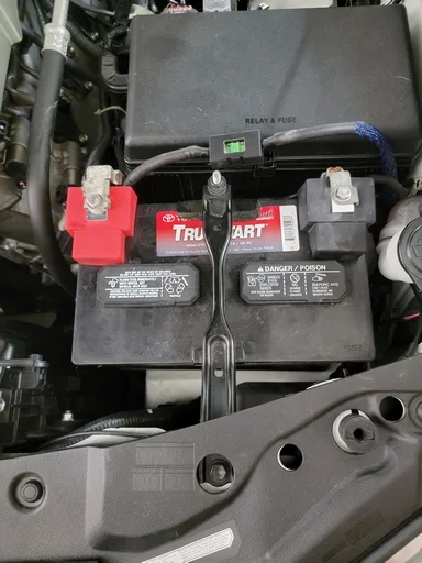

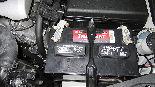

Replaced the OEM battery terminals with new ones made by SDHQ:
SDHQ Built Billet Battery Terminal Upgrade Kit - https://sdhqoffroad.com/collections/08-21-toyota-land-cruiser-200-series-electrical/products/sdhq-built-billet-battery-terminal-upgrade-kit
I liked the way the OEM harness attached to the top of the SDHQ terminals without having to cut the wires.
I also got the covers which don't actually cover the factory wires but do cover everything else.
So there's now plenty of room to add new stuff in the future.
Oh and I'm finally rid of that ridiculous OEM positive terminal cover.
OLD:
NEW:

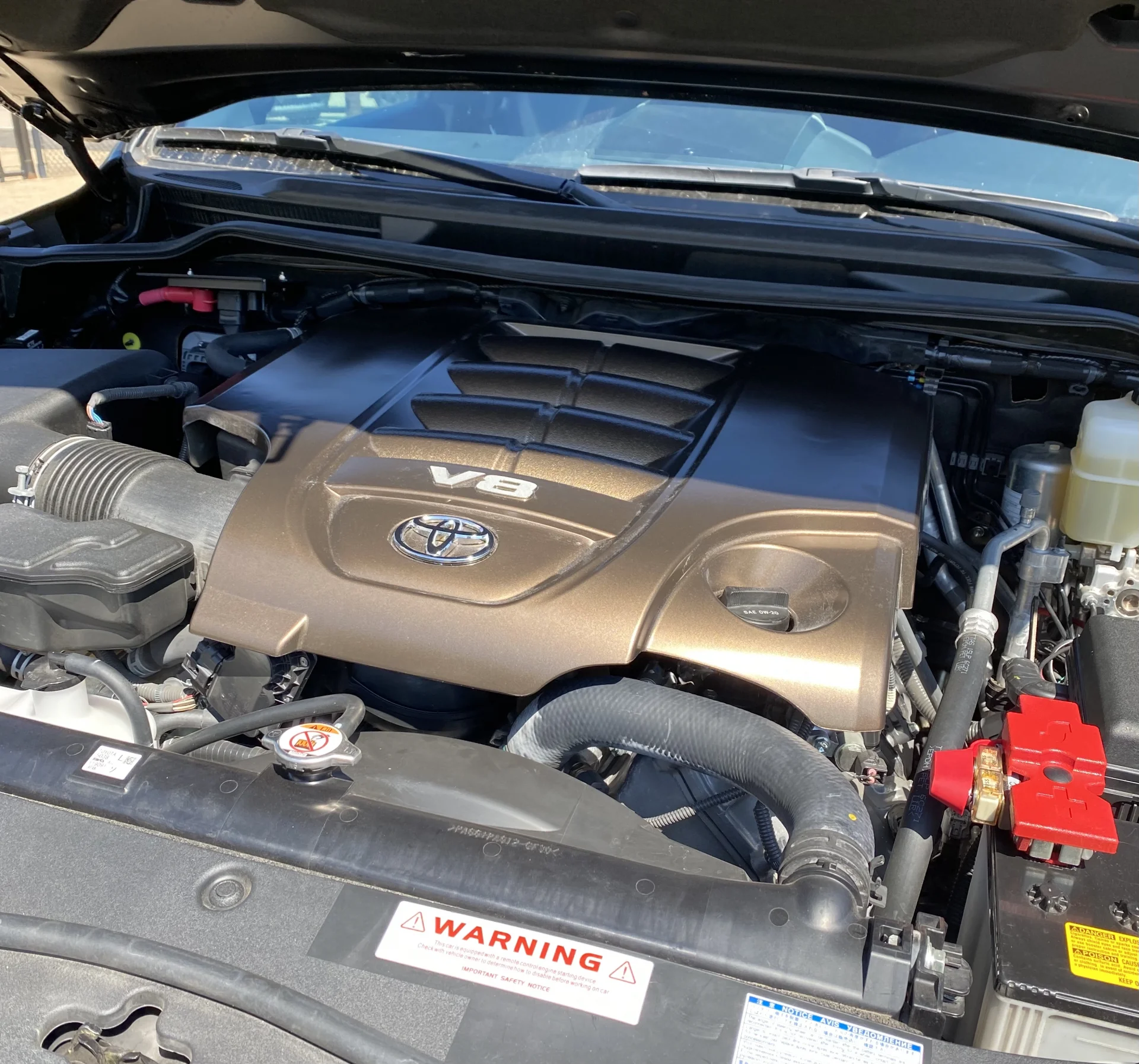

For no reason, painted Heritage Bronze
