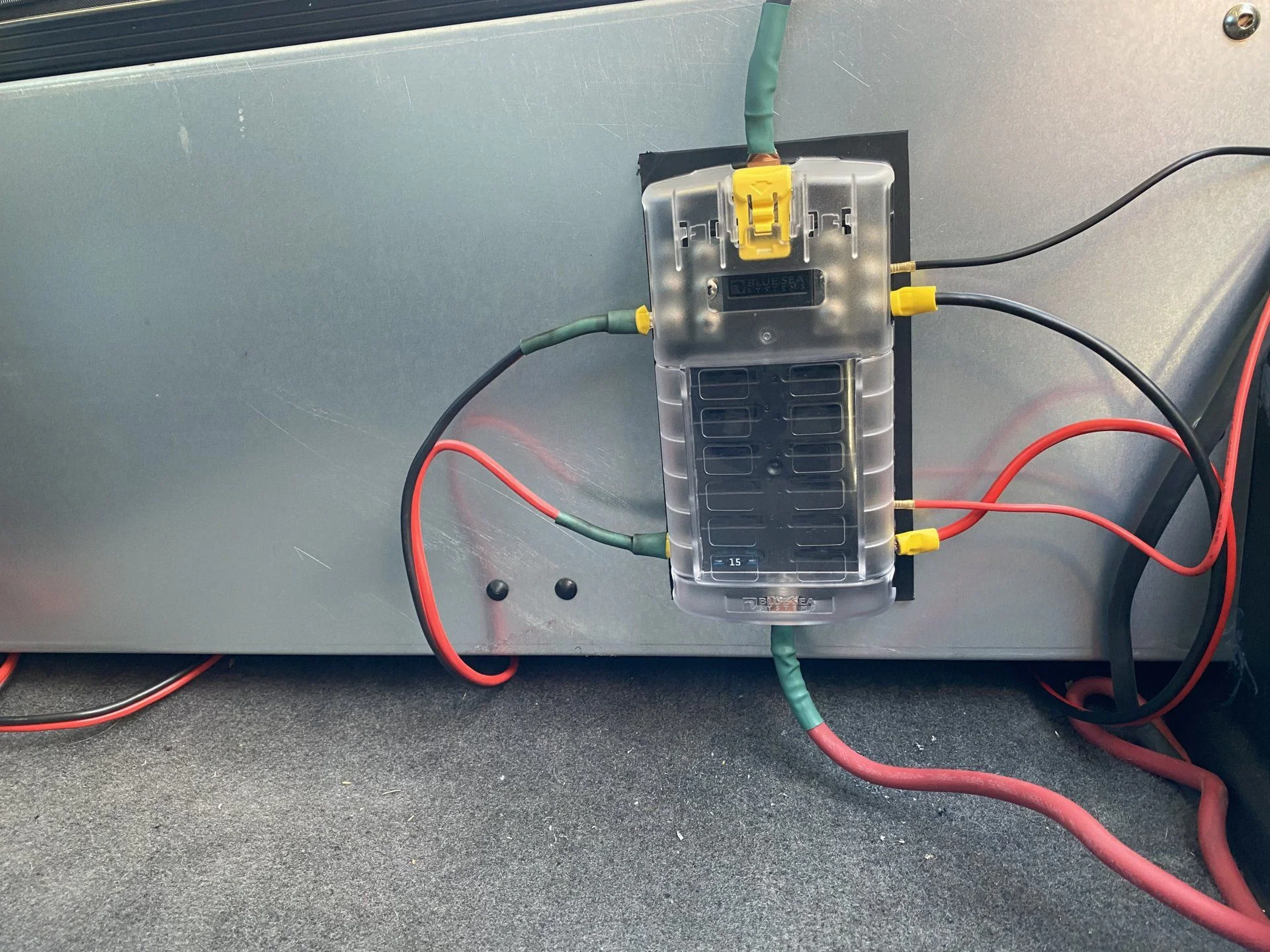

Finally got all of my wiring done... for now. Ran 8 gauge from the battery to a fuse block mounted to the forward face of my drawers. I cut to fit a rubber mat as a mounting surface/dampener/insulation.

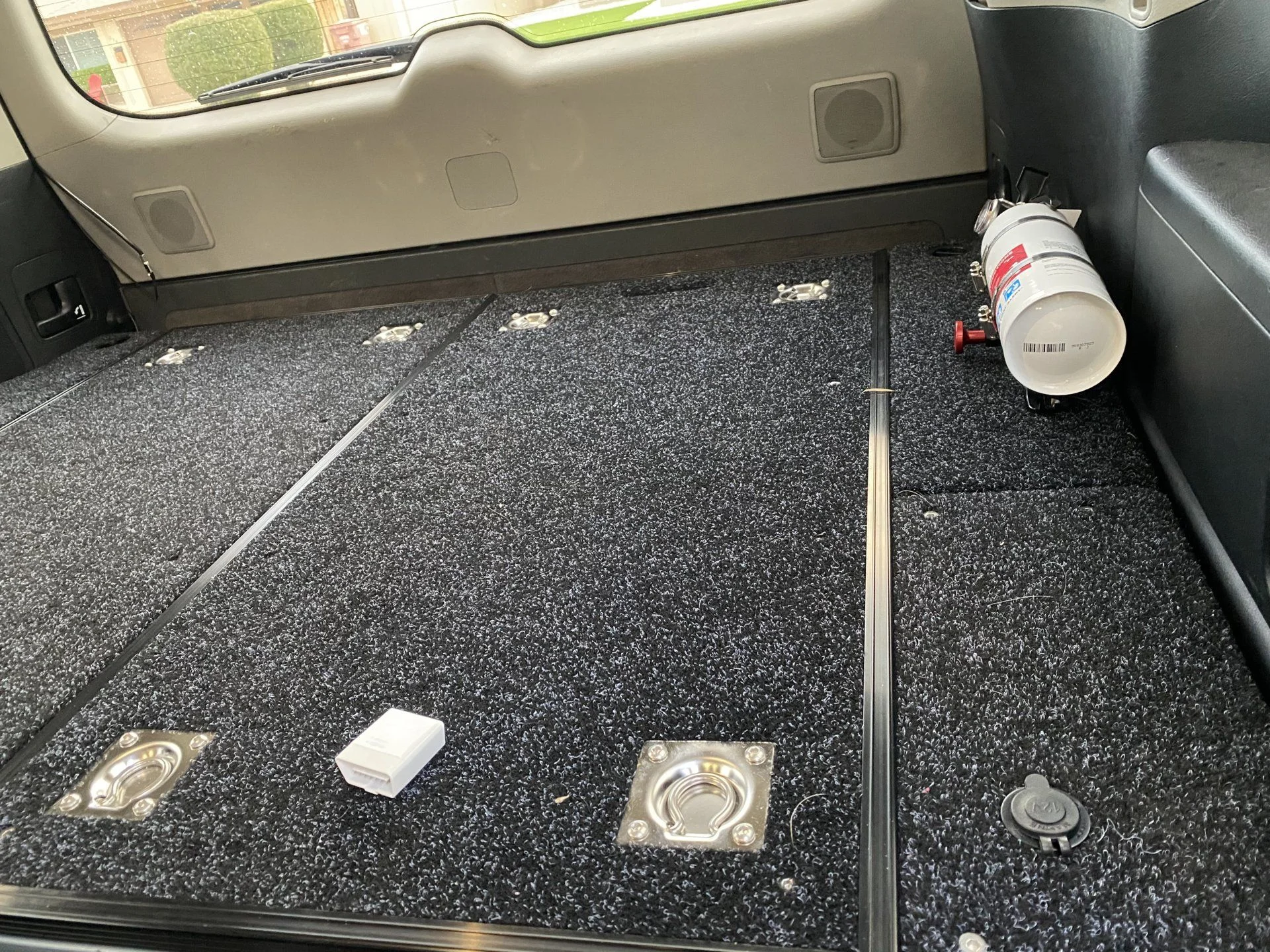

Now have power to my 12v gang on the rear face of the drawers:
Have power for my fridge:

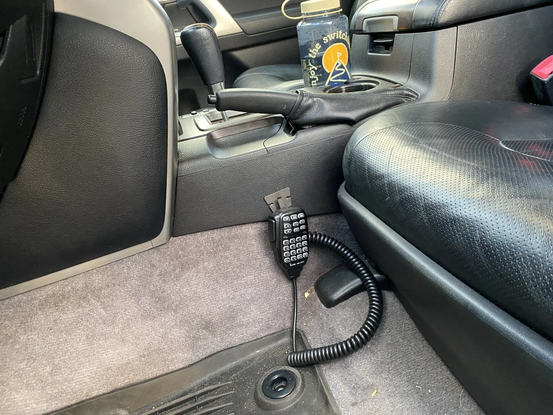

Have my Icom ID-5100a mounted to the forward face of the drawers as well. Ran a mic extension to the center console and mounted the mic hook where it was easy to reach, largely out of sight and doesn't get in the way. Also using a mag mount for the head unit that mounts in the CD slot:

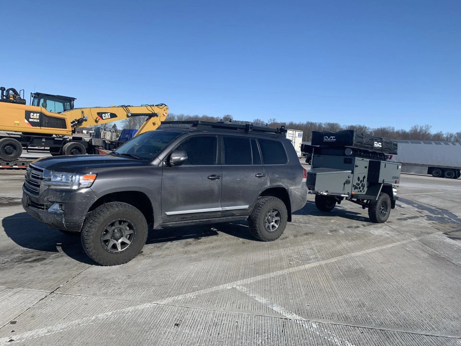

Drove to Ohio and picked up a used Turtleback trailer and then stopped at Ed Martin Toyota in Indiana, on the way home, to drop the LC off for some R and R and to have some new mods done.
Thank you to @Eric Sarjeant for loaning me a Tundra to finish towing the Turtleback home. Looking forward to getting my LC back soon. Droped it off yesterday and already miss driving it.

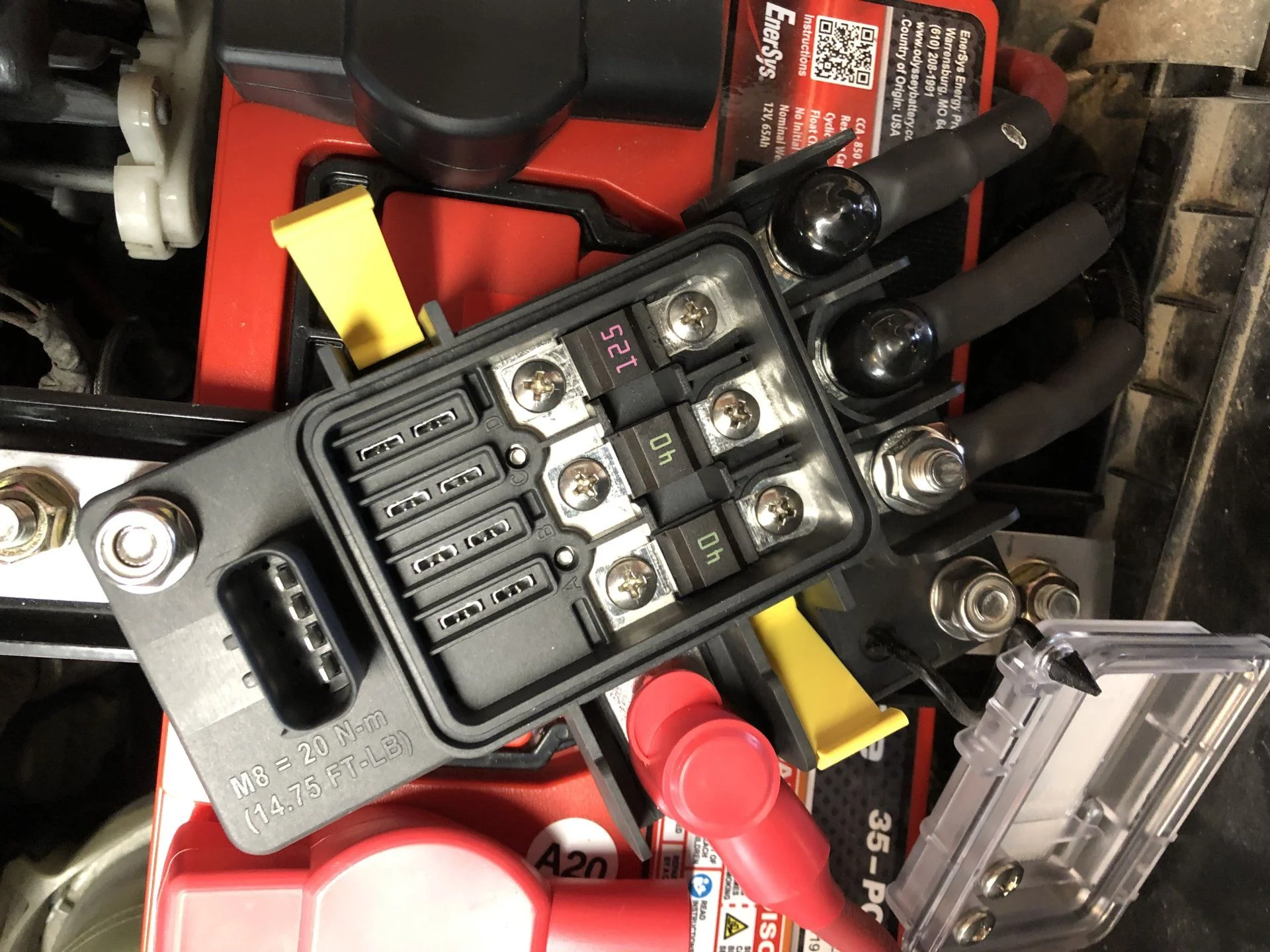

Side note - isn't that Bluesea SafetyHub 100 fuse box great! I used one on my auxiliary battery to eliminate three separate Redarc MIDI fuse holders. I don't have any need for ATO/ATC fused side - I wish they made a 3-4 position MIDI fuse holder of this same design without the other part.
Yep, love the Blue Sea SafetyHub - have one on each battery.

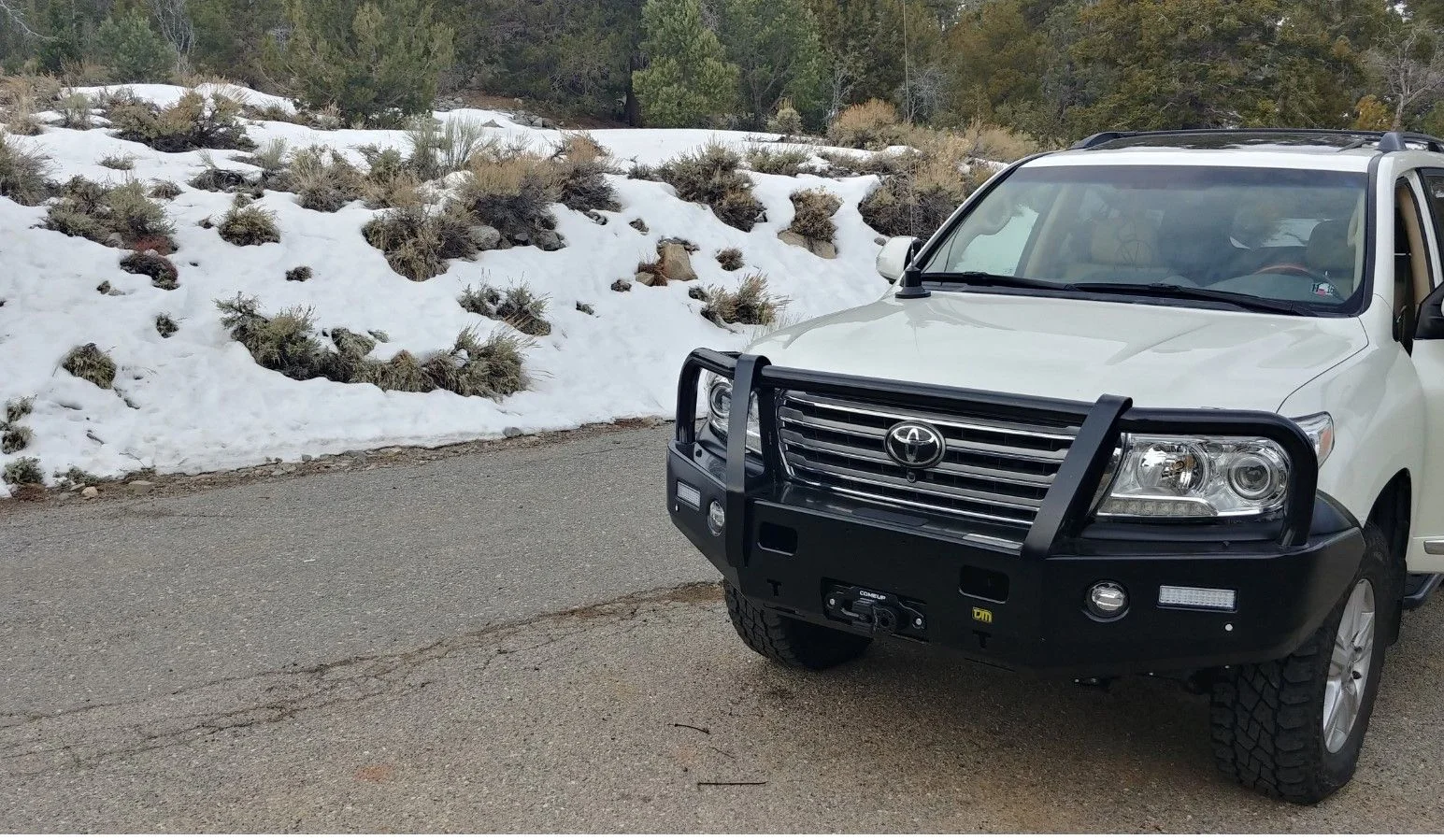

Went off-roading.
damn son! do those 265's rub?
