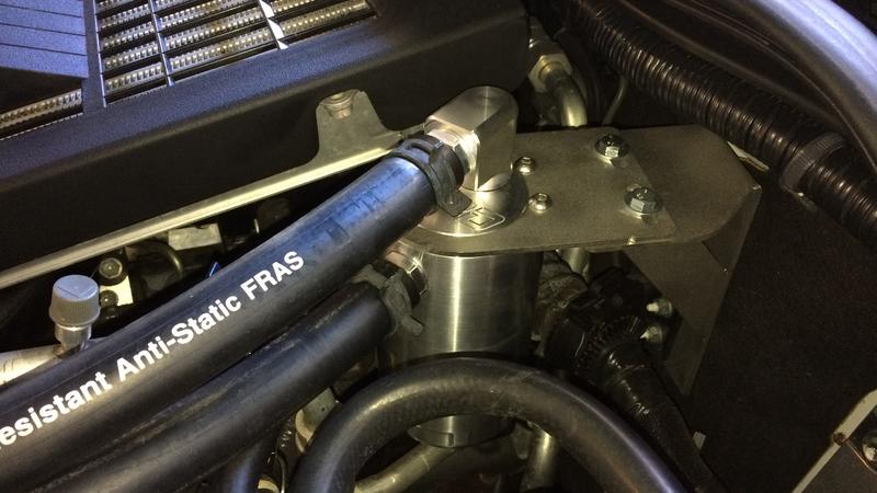

I haven't been on here for a while. I had some work done on my diesel 200 a week or so ago.

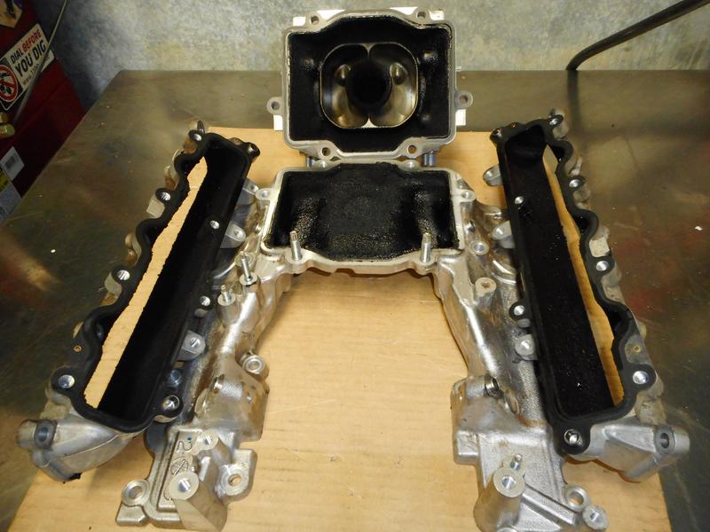

I had the induction chamber cleaned out. It gets really gunked up with a mixture of soot from the EGR and oil. I previously solved the oil issue by installing an oil catch can.
This is the induction chamber before the clean.

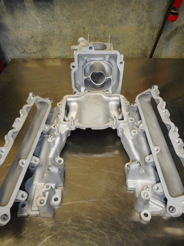

This is after the clean.

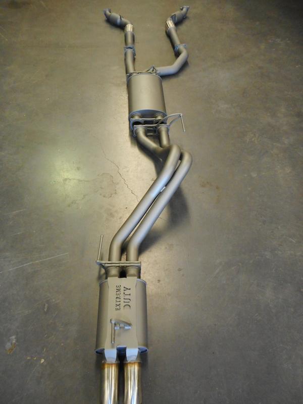

I also had a new exhaust system fitted.

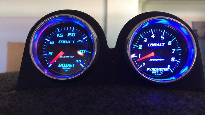

The new exhaust has ports for temperature probes so I had an EGT gauge and a Boost gauge fitted.

@Gone Bush - that's an aggressive amount of coking. Did you have to get it walnut blasted? Do you think the catch can will prevent the coking in the future?
I'm not sure about the cleaning technique (it may have included a lot of rubber gloves) but it's about normal judging by the many photos I've seen on the 'net.
I think it will stay very clean with the Catch Can and other measures I've taken.
