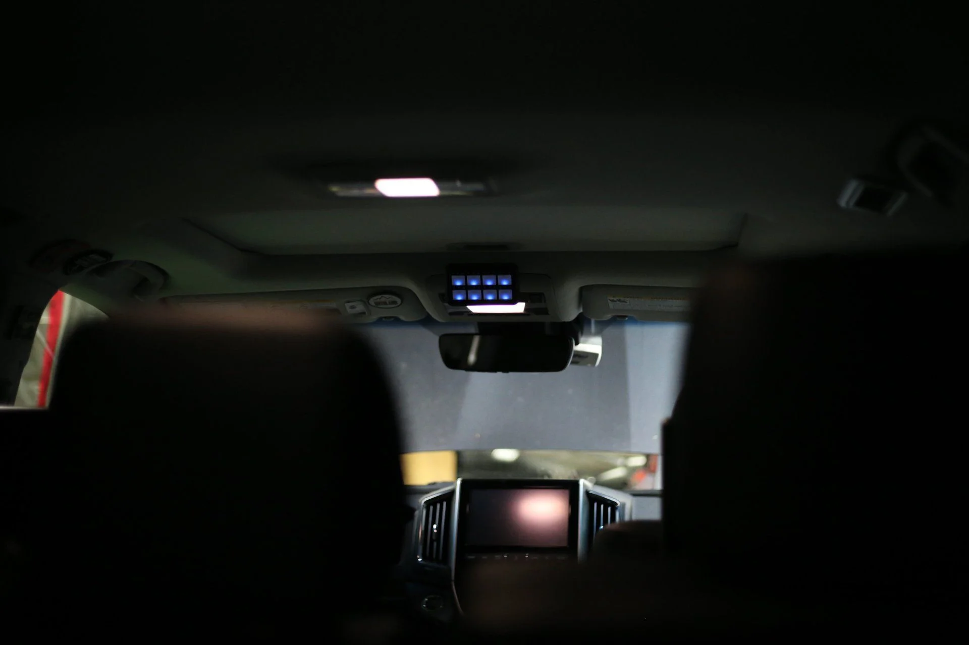

Things are coming along with my build of the 200! SPOD, National Luna lights, and the Cruiser Outfitters Rear Hatch Release installed.
I actually added the third row hatch switch/handle and a national luna touch light last weekend too! I have an issue with mine however where it randomly turns on and off and blinks. Also most of the time when I try to turn it off it takes about 10 tries before it will fully shut down. I'm curious if you run into any issues or if I just got a bad one.
I will let you know. I haven’t had a chance to really mess with it and that would be a major kick in the face. I did two of them, one red and one yellow.
