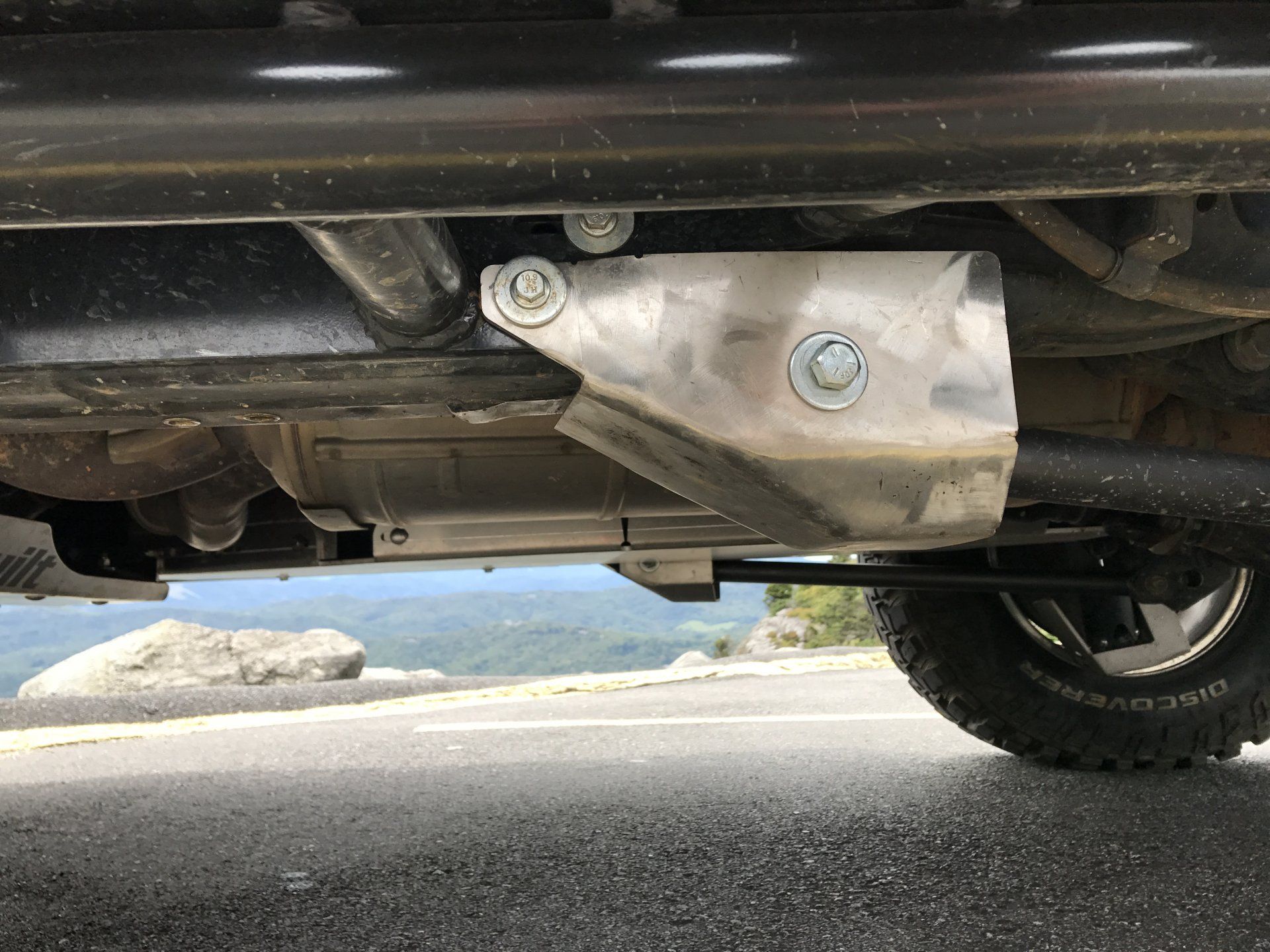

I got my 200 fitted with a mix of 1/4" aluminum and 3/16" stainless steel BudBuilt skid plates. Just so happy to finally have some real armor under the truck.
Also protected the control arms mounts. I like these because you don't have to remove the control arm bolt... what!!!
@Markuson, there's your shock guard back there, the Mark II, it's a beast, thanks for the testing and trail feedback to Bud, got me an even better solution to a long standing Toyota SUV problem.
I also switch the rear springs from a 2722 to a 2723 (thanks @Willy beamin). Sooooo much happier now, and all I have is a RTT and camping gear. I know with a rear bumper I'm definitely going with 2724s though.

Looks awesome! Is there a new cross member under there? I'm trying to figure out what that last section of plate is connected to....
Magic... no there is a substantial crossmember in there. Absolutely nothing touches the transfer case, unlike the OEM and ARB skids. It's pretty cool, Bud lifted the whole backend of the 200 up from it and it barely deflected, I love engineers.

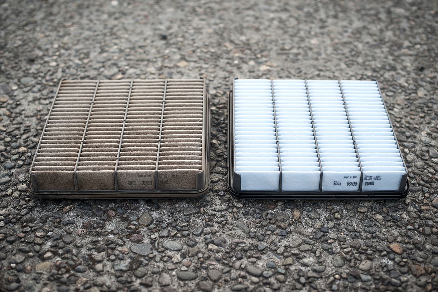

Giving my rig some post Moab/desert love, that air filter was brand new a little over a month ago:)
View attachment 1537360 View attachment 1537361 View attachment 1537362
That is one of the benefits of a snorkel. Not just being asked what that exhaust thing coming out of your engine is in parking lots.
Without the snorkel, you are pulling in air from the wheel well where when you are on a dusty road or eating the dust cough cough of the person in front of you. The snorkel raises the intake up much higher were there is less dust. Still some if your behind someone like Markuson or TonyP :D
