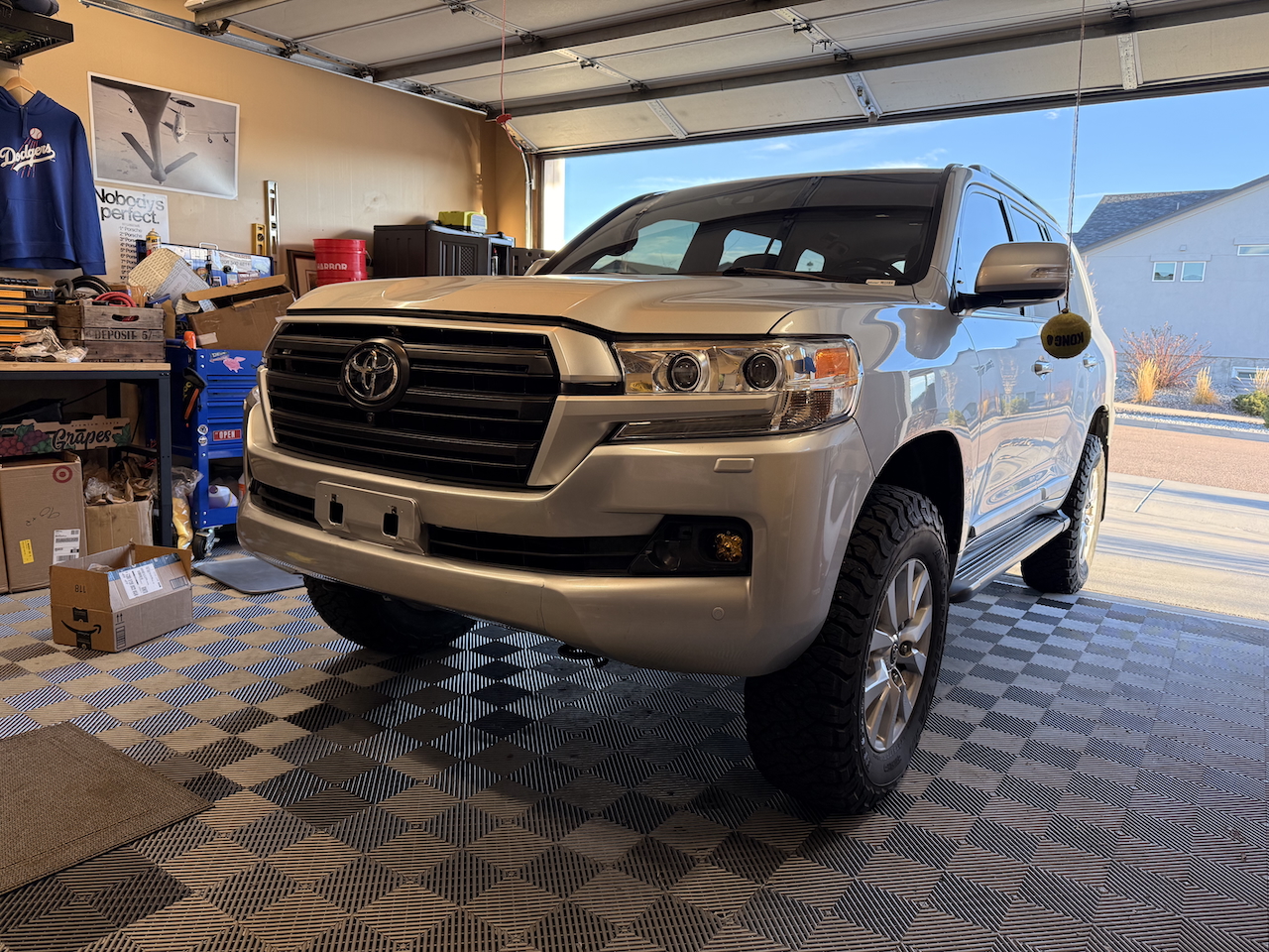

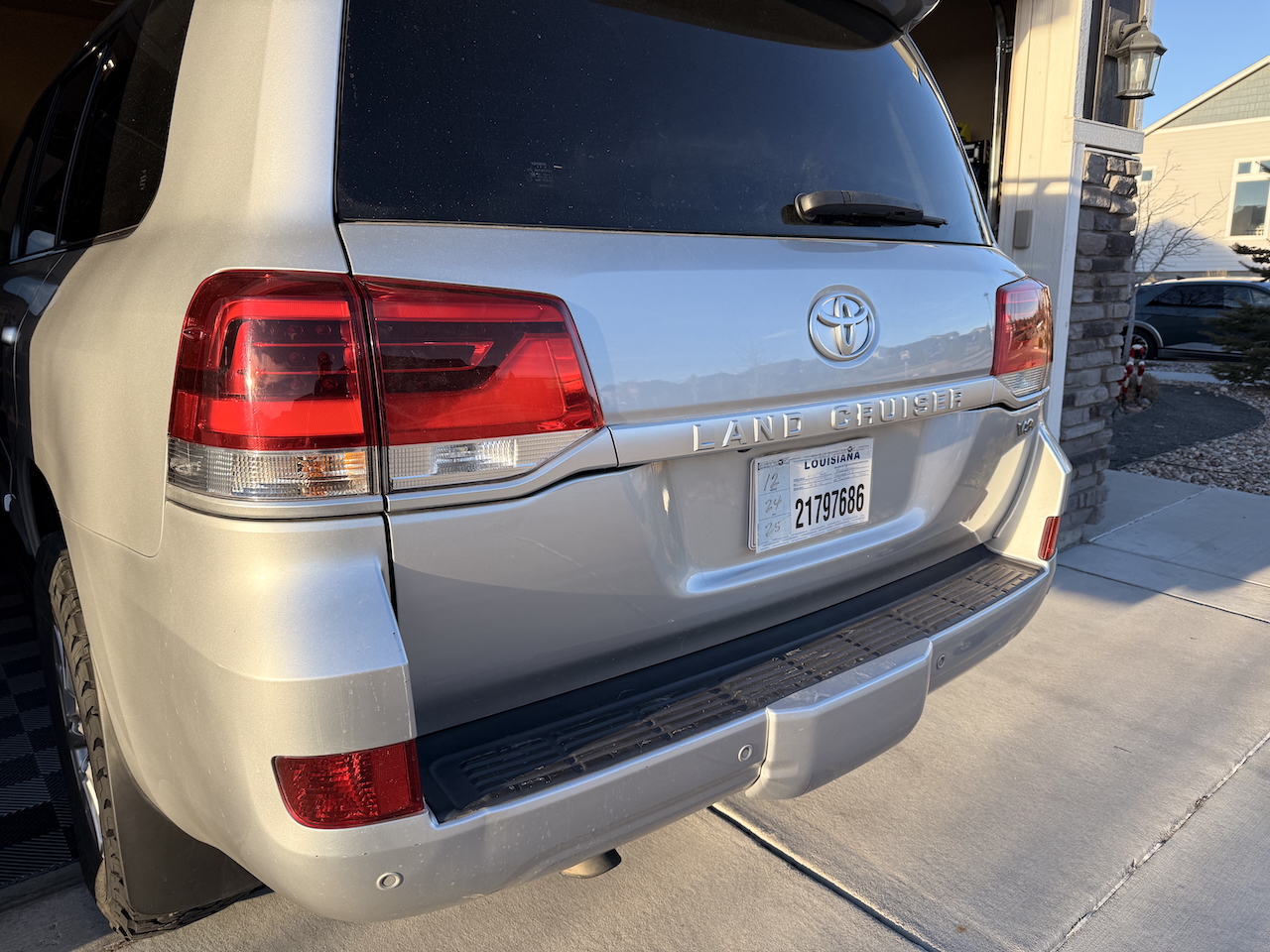

Finished up a bunch of things I ordered right after picking it up in early Nov. Changed the idler pulley/tensioner/belt earlier this week. Switched to 5w40. Removed rear video screens and installed the Victory4x4 covers.

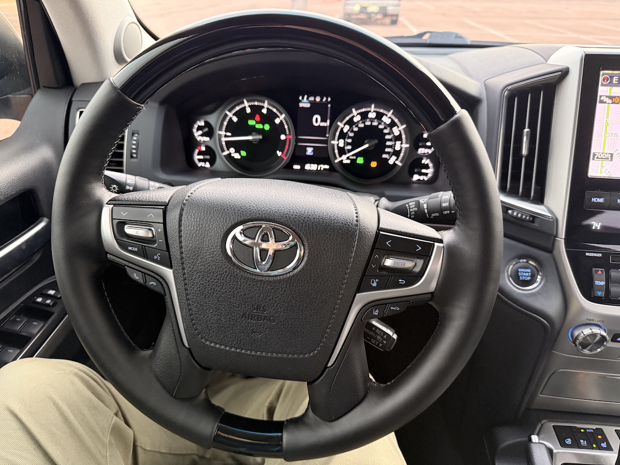

New piano black steering wheel from eBay to replace the haggard-looking stock one. Fatter grip than stock, heat isn't great but it's still there, pretty happy for the ~$300 I paid.

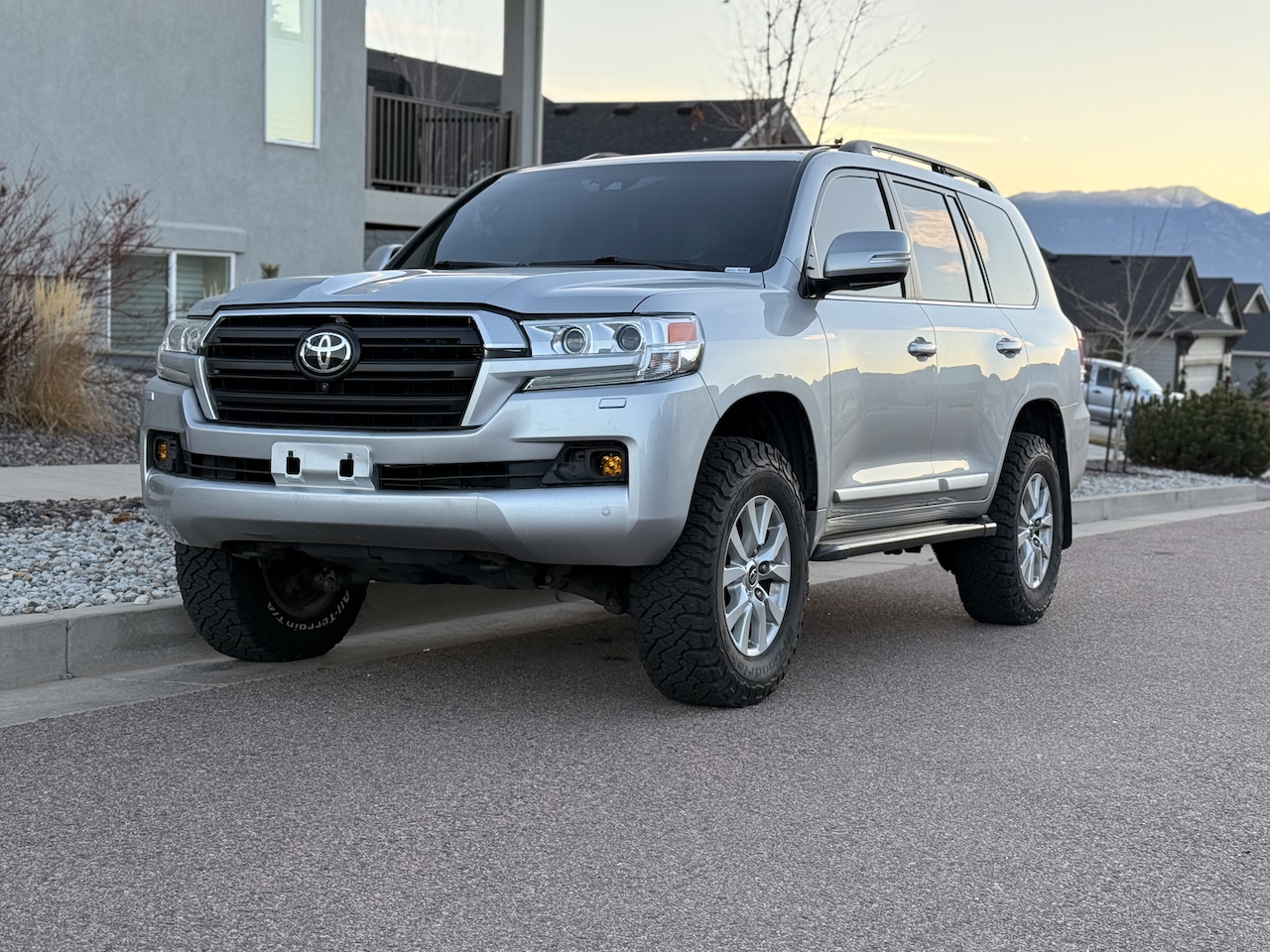

Paint matched the grille and most of the chrome to see how it looked using HyperDip, will probably take it all off and take it a shop for paint whenever this stuff starts peeling off. Still need to re-install the fog trim, oops.
Installed stock weight Bilstein rear coils to match the front lift. I have Kings in front (22" hub to fender) and the Bilstein coils with Dobinsons MRRs in back (22.5" hub to fender). Mostly happy with things, tho I do wish there was a coil that was just slightly stiffer, but I'm gonna add airbags in the spring and hope it helps with the wallow. 275/70/18s with 1.5 spacers....and I already wish I went with 295s lol.
