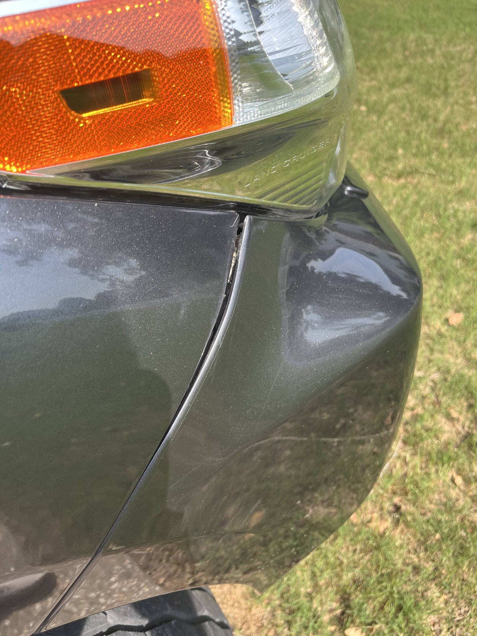

Does anyone have any tips on how to fix this lose attachment point on the front passenger-side bumper? I’ve already replaced the support bracket piece, but it still doesn’t want to stick.
Mine does this, and a friend's LX does as well. Seems like a poorly designed tab on the bumper skin can't be grabbed firmly enough by the retaining clip, usually after removal of the skin.
Curious if someone has a solution.

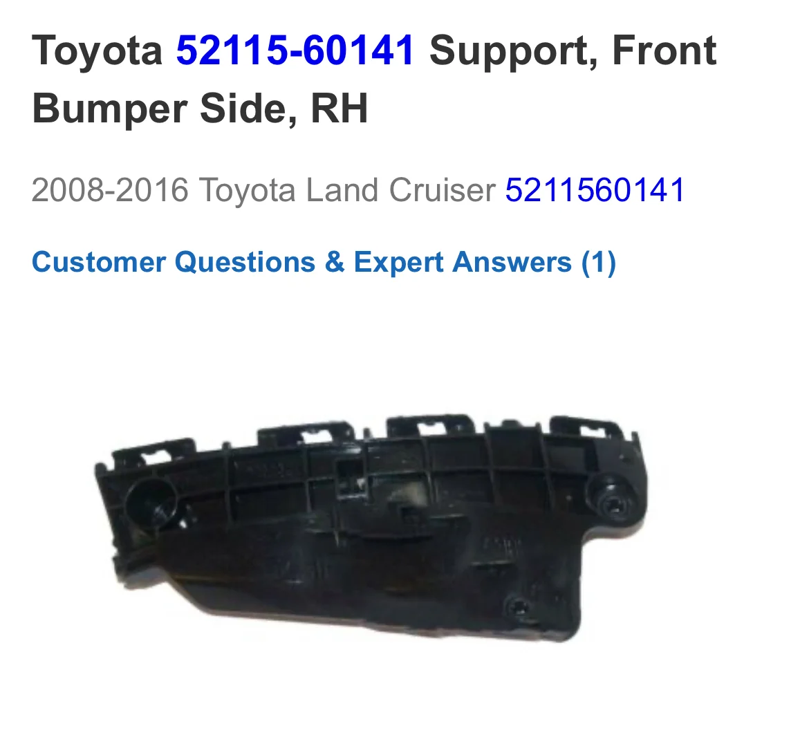

If the tiny plastic pieces on the plastic bumper itself (the ones that engage with the 52115-60141 pictured above) are broken or flattened, there isn't much you can do aside from replacing the bumper itself, or adding some sort of external fastening mechanism like the import car guys do since they can't keep bumpers on either...

If the lower portion of the bumper has ever been hit or snagged on something, it can distort the metal attachment brackets down there, which can pull on the upper attachment points that you're messing with. So, that's at least something to check as well.

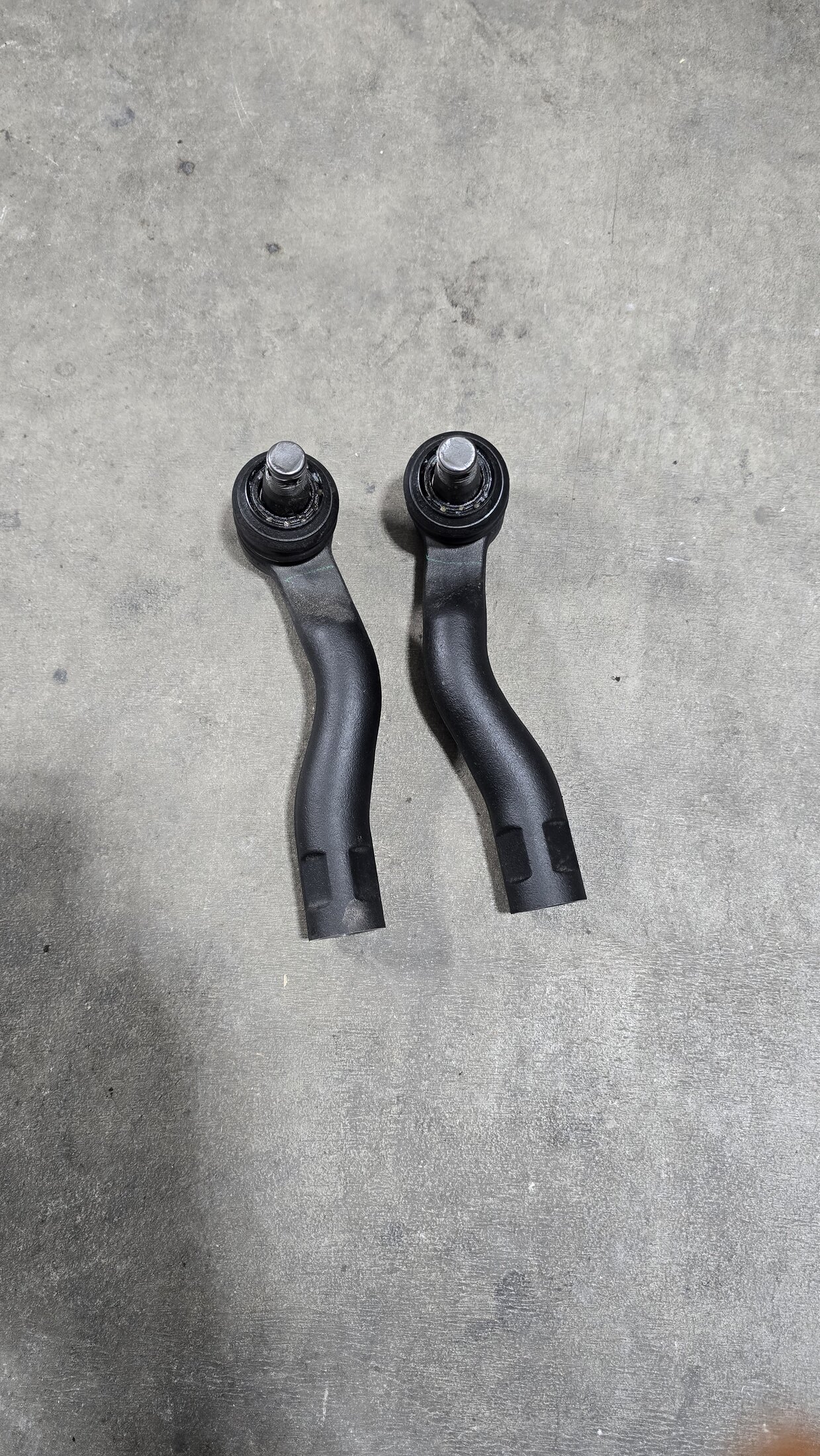

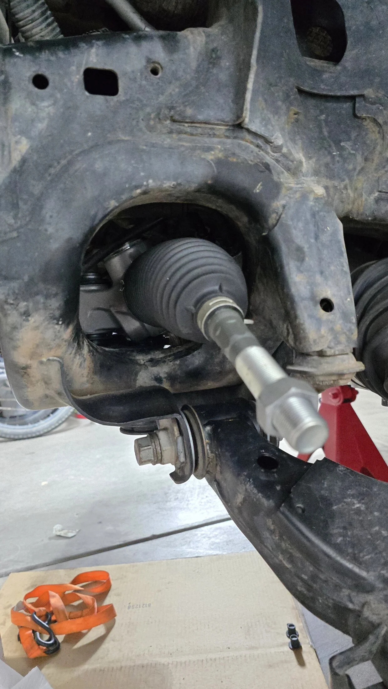

Almost done with replacing the steering rack.
Since I'm using tundra parts, if anyone wants the unused oem outer tierod ends that came with the rack, you can have them for free, just pay shipping. Edit: these are gone.

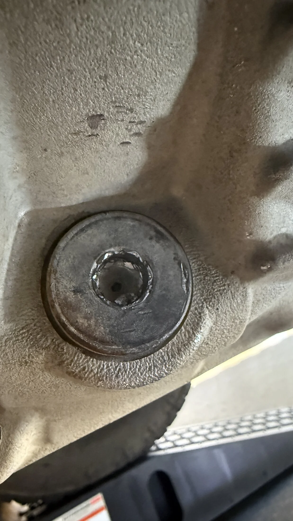

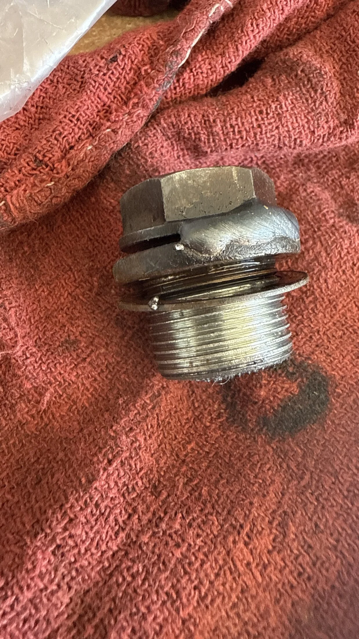

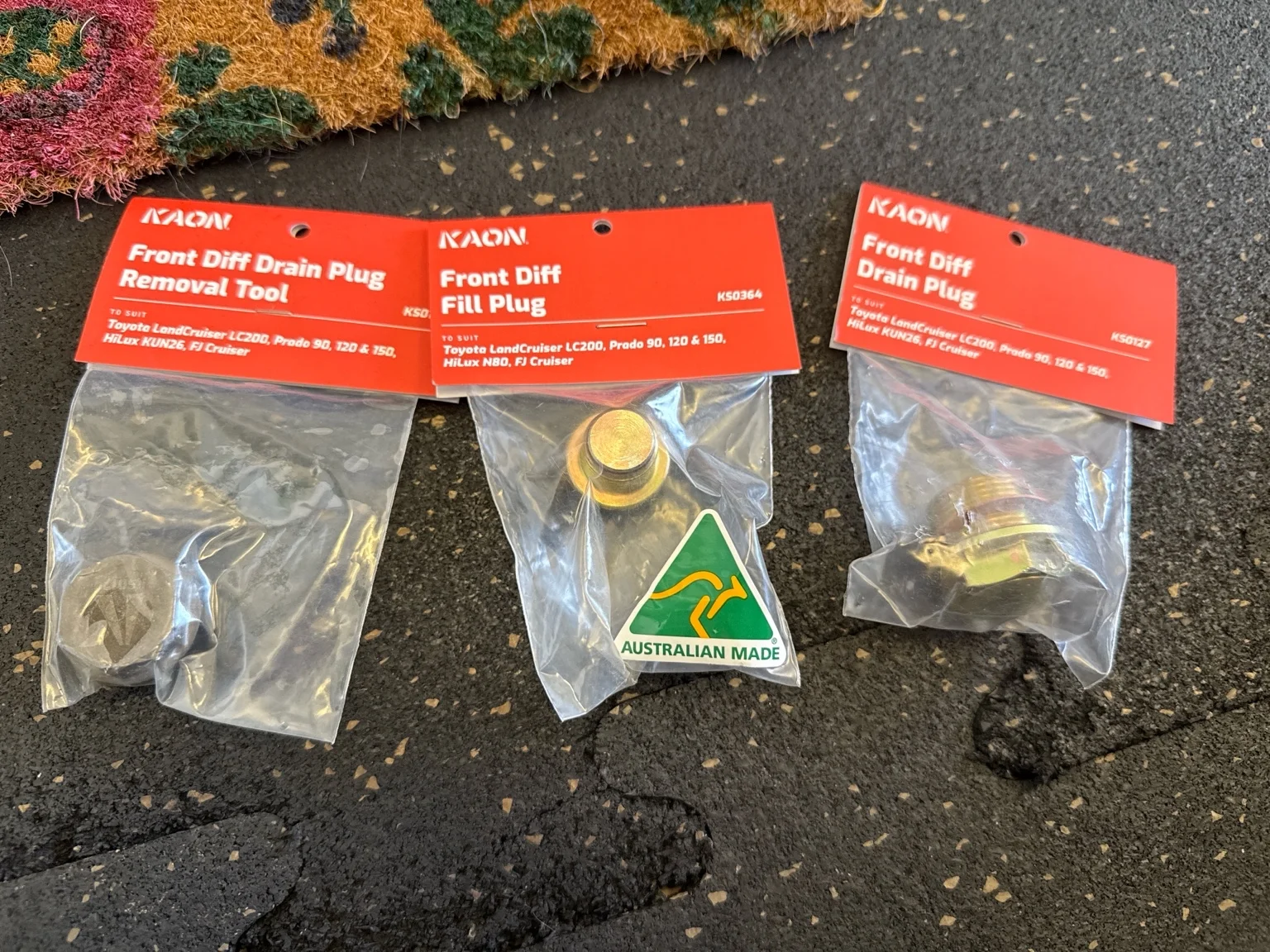

Stripped/ rounded out my front diff drain plug today. I ordered and already received new fill and drain plugs and the front diff drain plug removal tool from KAON. I’m glad I ordered it just in case. Welded the tool to the plug and was able to get it out no problem. Refilled with new fluid and am good to go now.
For anyone else coming along if you tap (“firmly”) around the edge of the original plug with a hammer it usually comes out without issue.
If the tab is compromised, you can do a few things depending on how impacted it is. Some heavy duty permanent type 3M or Gorilla duct tape for added bulk/grip. Possibly rebuild or add bulk/features to it with some plastic welding. Can even be reinforced by embedding some thin wire or staples.
