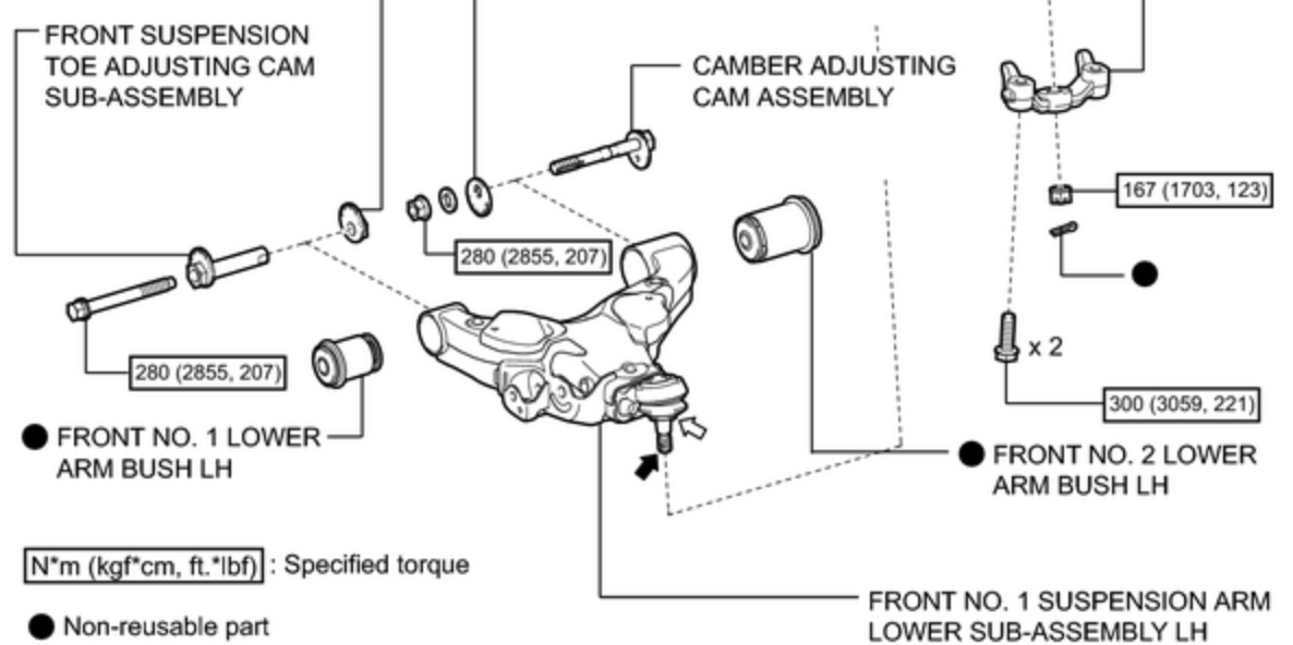

Probably thinking of the lower ball-joint bridge bolts at 221.
Same issue with a previous Euro SUV at the dealer, and when I called the service manager to complain he was stupid enough to dismiss the importance of it all. Then again I had to provide them the FSM pages on adjusting the caster for them to even admit it was adjustable in the first place. And people wonder why I do my own work on cars...
This 100%. After my latest frustration with under torqued LCA bolts I was surfing Facebook marketplace while sitting at the dealership for the LCA replacement looking at used hunter machines. Was surprised to find a few not far from me attainable for around $6k. Now I need to see if I can fit all this in my already cramped basement garage.
