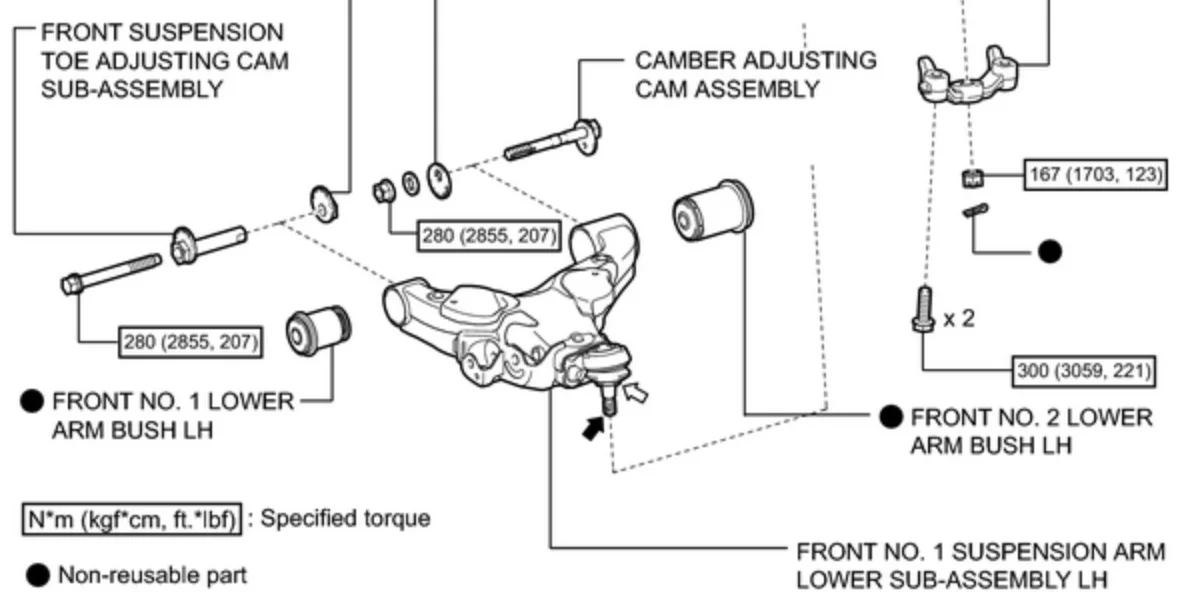

It wasnt training right before? If not they likely didn’t torque your LCA pivot bolts to spec. It’s quite high.. many shops don’t go far enough.
This…. This happened to me 2x with my Tundra
Now I bring my torque wrench when I pick it up and do the final Ugga Uggas right in the parking lot before I drive it home
I used to, until I found an alignment shop I like and they were receptive. Though they were pretty surprised at how high the spec is.
207ft-lbf for anyone wondering.
Yes. Same. Found one here that knows their stuff and after 2 alignments with them, I checked them in the lot and both were good.
I’ll likely still always check them now just due to the mess it caused having to have it redone elsewhere, easy enough check
Thanks for this. I saw somewhere it was 220?
I watched one guy tighten my bolt with an open ended wrench while it was on the rack. I smiled, nodded, and left without ever returning.
Probably thinking of the lower ball-joint bridge bolts at 221.
No, just got an alignment like 2-3 weeks ago after getting new tires put on. Bought the lifetime through Firestone. Certain shops here are hit and miss. Guess I found the miss.
TBH this issue would probably occur in the majority of alignment bays these days. Other than those routinely doing work on track/race cars, serious off-road rigs, etc.
I'd just bring it back and say its no longer driving straight, and politely ask them to be sure they confirm all four LCA bolts go to the torque spec with a torque wrench. Maybe even mention this is a common issue on our platform.
My experience has been that if these things get done correctly and the parts are healthy you can beat the crap out of our front suspension and the alignment won't drift at all.
I brought mine to our Local Firestone here, mainly because they were the only ones open on Sunday and the “tech” who looked all of 20 told me “oh, this is a 4x4, this is going to take awhile, can you pick it up tomorrow”
I just drove away…. While shaking my head
I just drove away…. While shaking my head.
Yeah, Firestone can be hit or miss, but the lifetime will/should pay for itself in due process. I’ll just take the great advice of asking for torque spec and let them know. Shouldn’t be a big deal.
