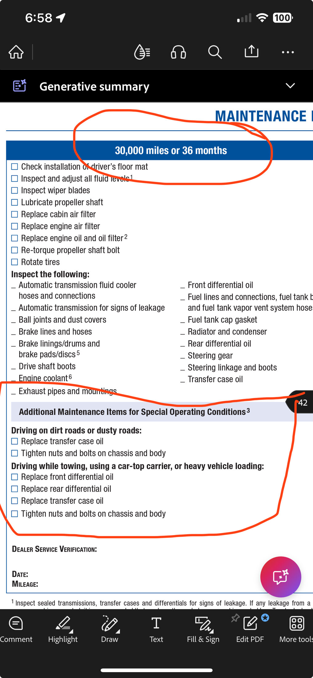

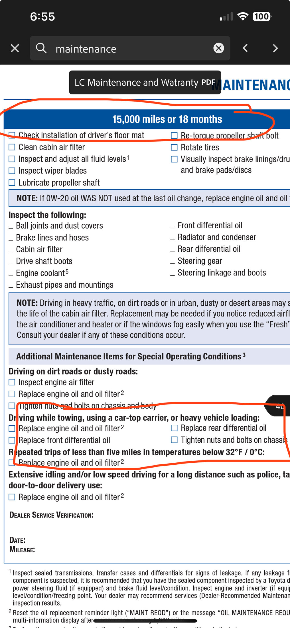

new HPL diff and tcase fluid front to back and greased the zerks pushing out old (different brand) grease. Which was easy and mess free (sarcasm). The lock N lube fittings and a judicious battery powered grease gun for the spider yokes was clutch compared to the manual type. I'm close to 90k on the odo. What's everyone's typical interval for tcase/diff fluid? 30k? More? TIA.
I have 30k in my spreadsheet and I believe that is the “severe service” schedule. Unless you’re contaminated from water crossings or the like I can’t see needing more often than that. Our diff gears especially are very high quality materials and machining and as a result tend to be easy on the fluids.
Given I don't do water crossings, etc I'll gladly start adding a little more to my interval. Thanks for this. The fluid looked good when I drained it and minimal debris on the magnetic drain plugs.

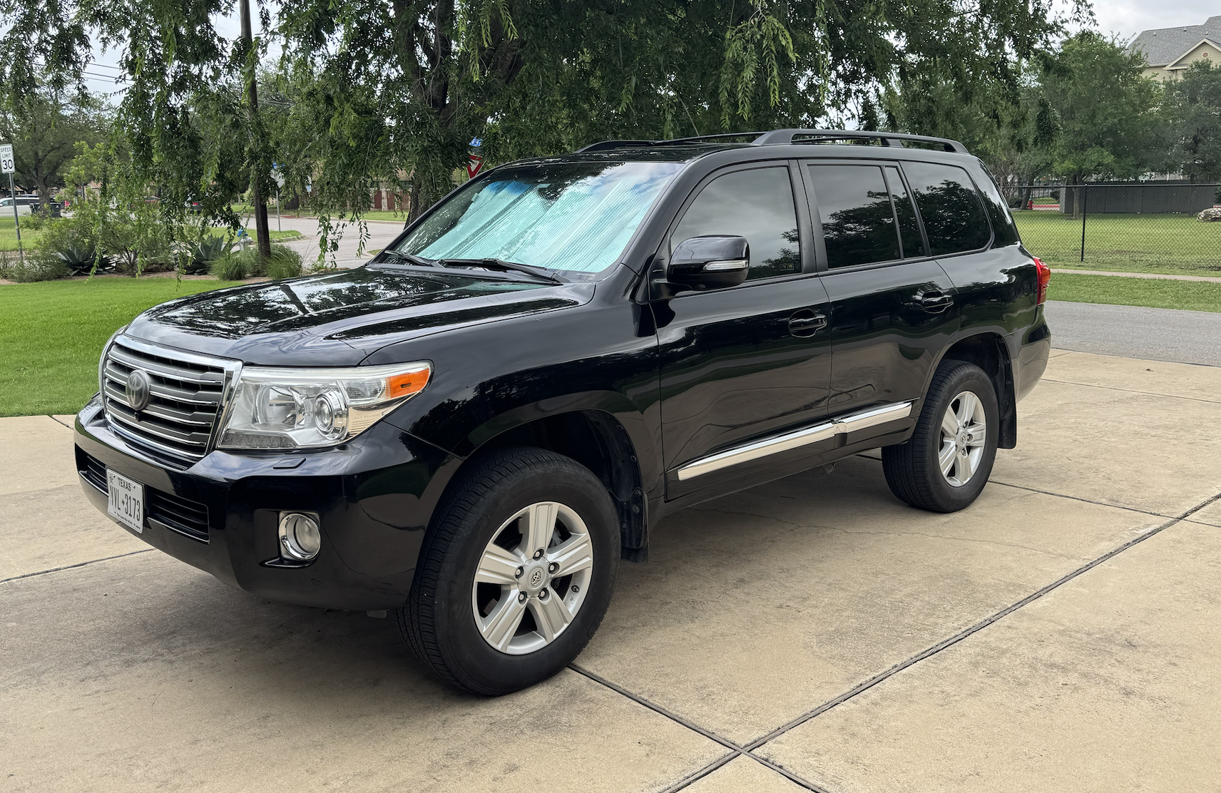

Elsie has been getting a good amount of love this week!

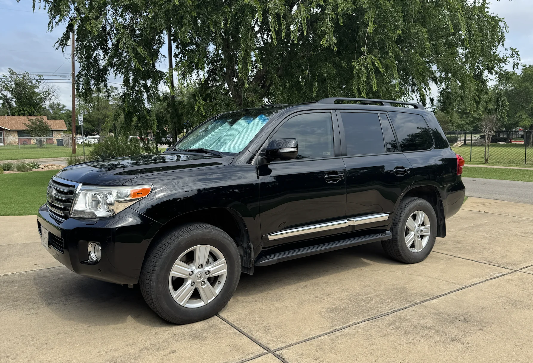

With nearly 230k miles on her (23k since I bought her May 2024), she got new OEM shocks. Long, annoying story, but I had a parts credit at a local dealership and needed spend it down quickly. An independent shop put on the front spacer and the shocks. I took off the side steps this afternoon. Alignment later this week. Prepping for two long roadtrips this summer.

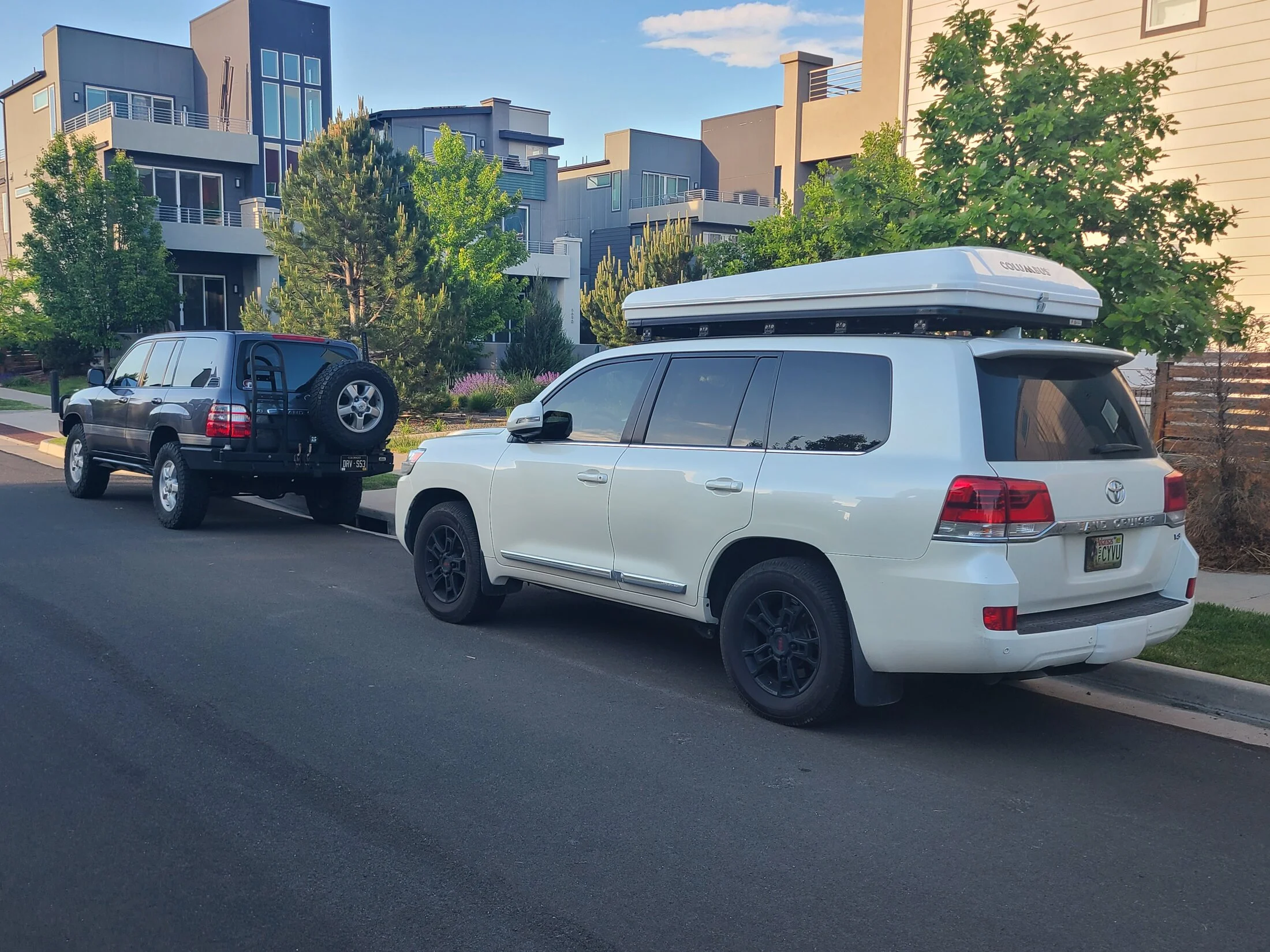

Looking at a cargo box - Thule Motion 3 XL Low - any opinions?
(Yes I know FB marketplace and Craigslist have boxes half price, but I have been shopping for a while and haven't found what I am looking for.)
Just as food for thought, I’ve used both Yakima and Thule and thought the Yakima seemed more robust and less flimsy. The Thule I have has broken both hinges in the past 2 years. I didn’t use the Yakima long enough to break anything but it seemed more well built.

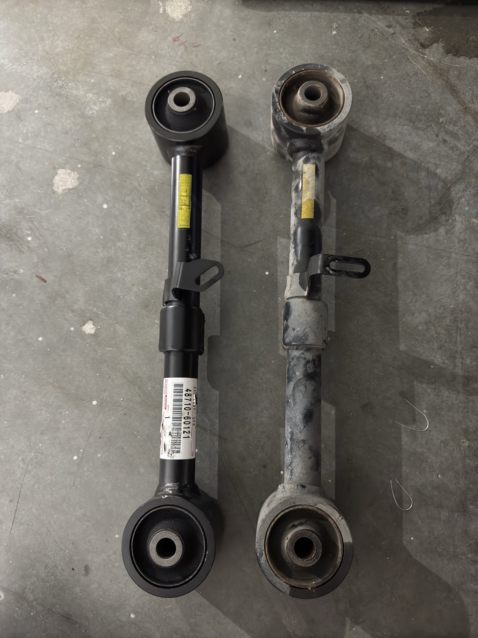

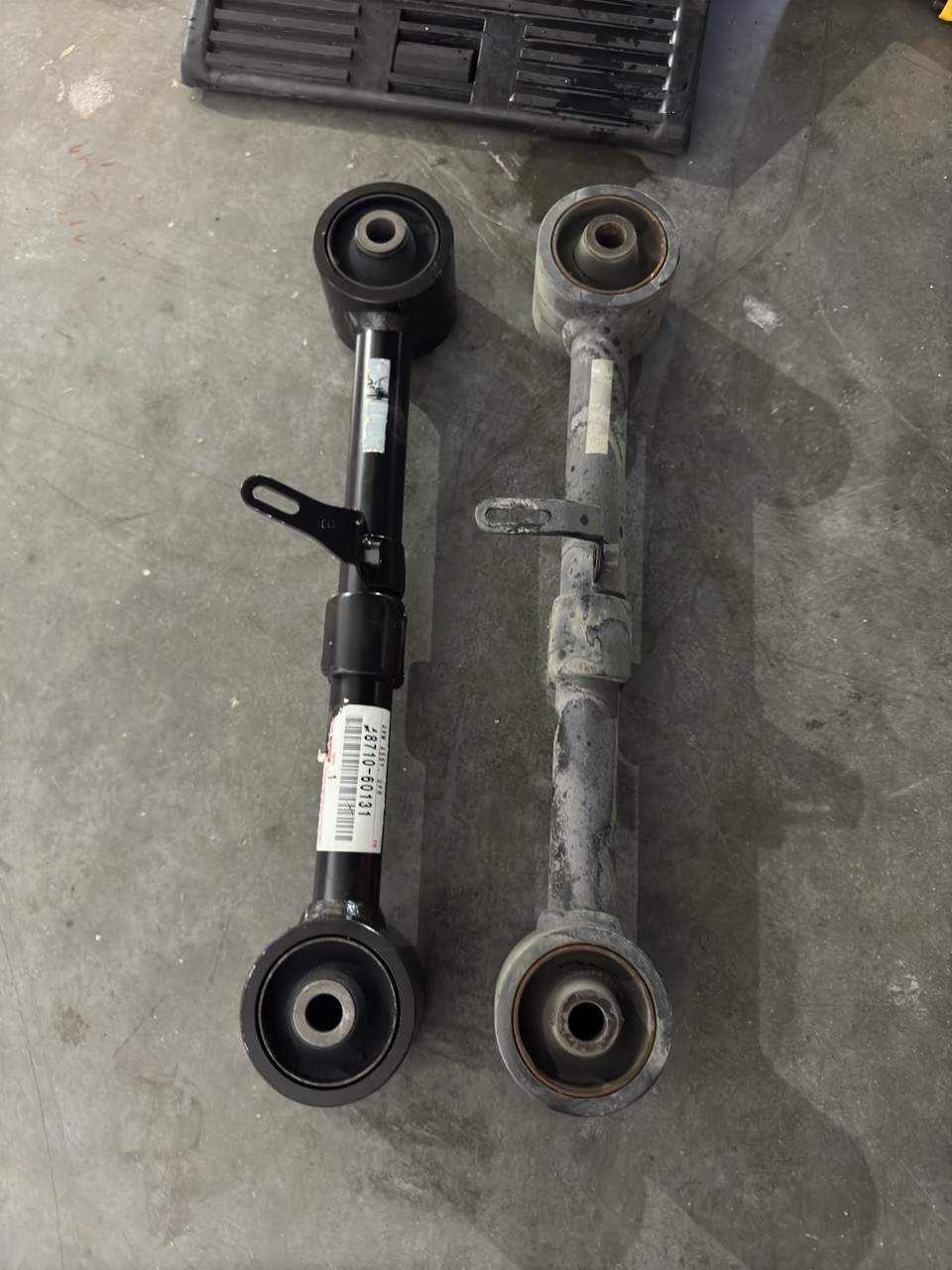

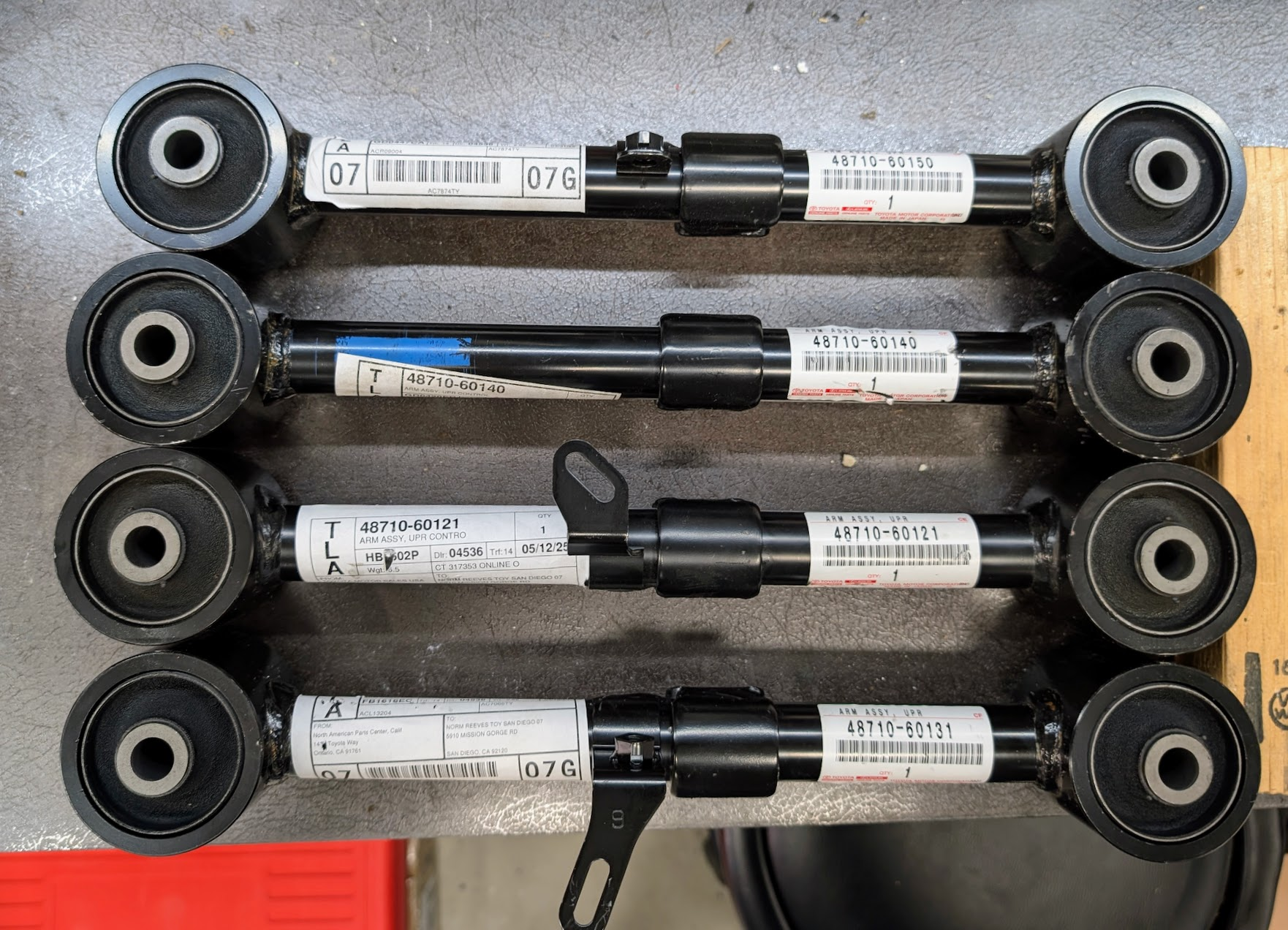

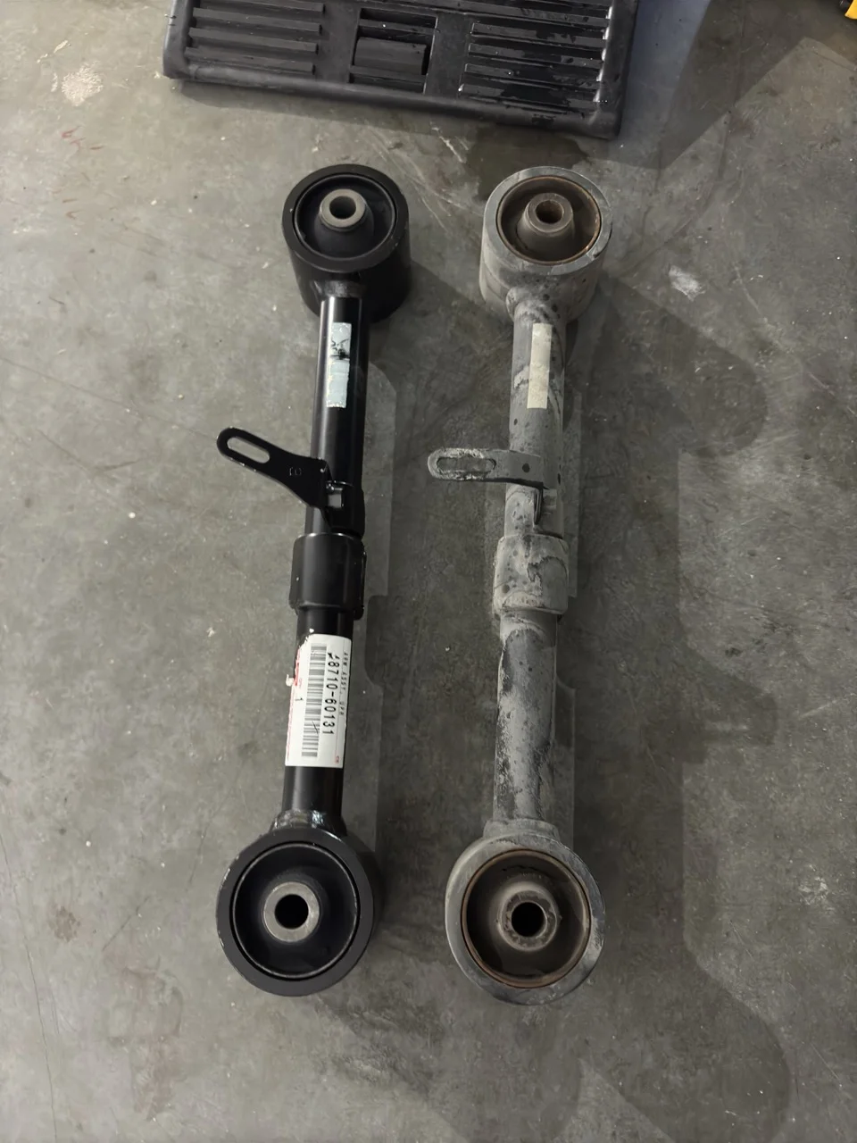

None are like the other. Lesson learned rear upper trailing arms from the LC are not the same as those for the LX. The LX (bottom two) arms have brackets for height sensors.
Another fun fact, upper arms are asymmetric in length. Just as driver vs passenger springs are asymmetric.
Not to mention the sensor brackets changed somewhere along the way. Dirty ones in my pics are original from 2008.

severe duty for diffs is 15k, t-case is 30k.
Well - that is one reason I went with new and not FB market place. Here’s hoping the Thule is still a good product because it is being installed on Friday!

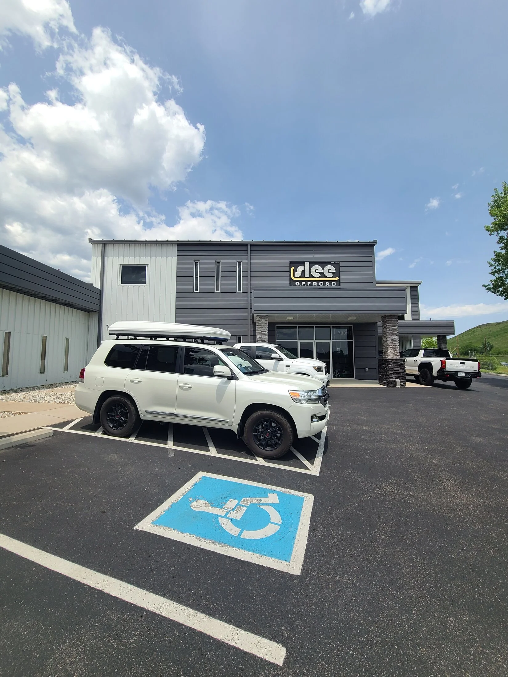

Drove it 2400 miles. Made a loop from NW Arkansas out to Taos, Durango, Silverton, Ouray, then up to Denver for a few days before heading back home.
Met 2 great Rising Sun Members to pick up our tent and SPC UCA's..

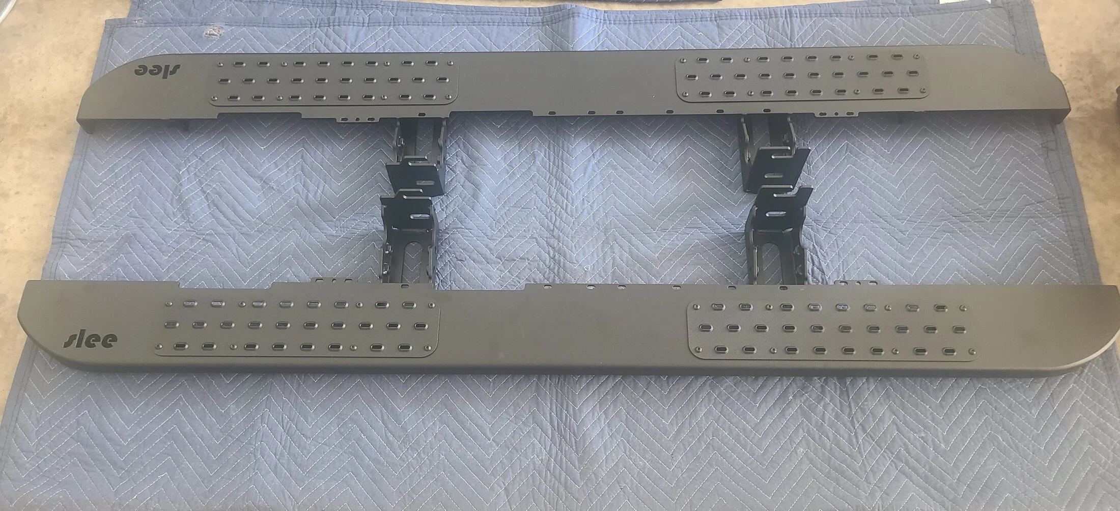

Stopped at Slee for new Formed step sliders, and hung with one of my best friends who bought my old built 100 series.

Interesting how they changed the adjustment slot. In this orientation, it also changes the motion ratio a bit. Maybe Toyota chasing the last bits of refinement.

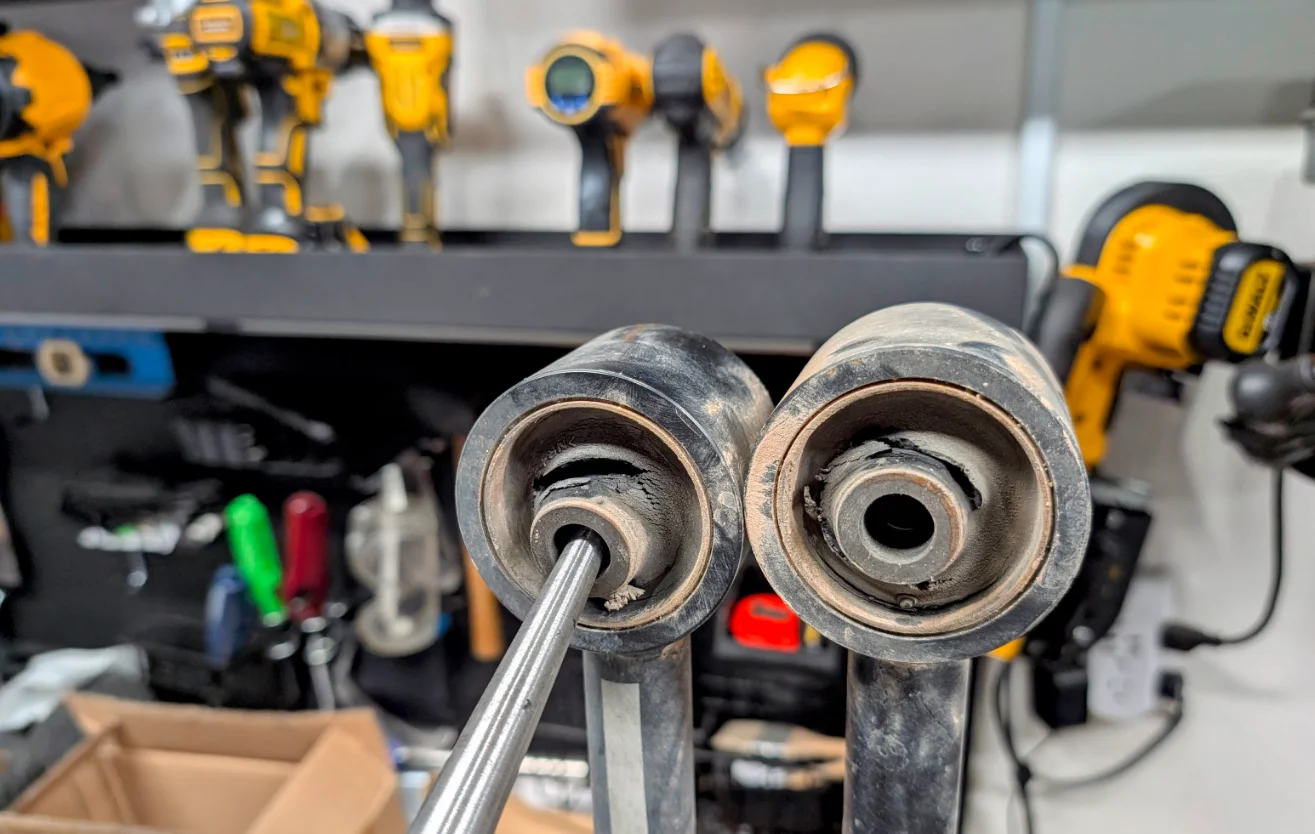

Just got my uppers out today and the bushings are smoked (definitely the right technical term per @Boston Mangler ) with tears all the way through. The eyelet position is well displaced from center too, which surely affects alignment.
Most people seem to change the rear lower trailing arms and while those can need attention too, it's the uppers that take the beating but they're harder to see.
PSA: I'll echo Boston's PSA, anyone near 200k miles, especially with hard offroad use and/or towing, highly recommend refreshing the rear upper links.

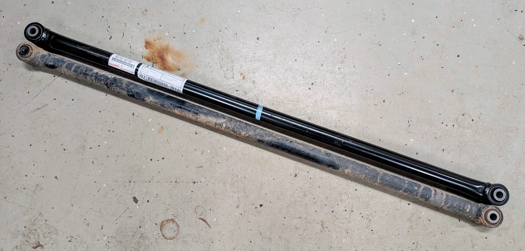

Are you on the original panhard rod? If so how do those bushings look?
Yes. Mine was actually in great shape and the bushings had little to no signs of wear.
@Boston Mangler had a different experience with his.
I think in an aggressively lifted rig, that would be a different story as sagitta is such it is always pushing the vehicle side to side with every bump without a panhard correction bracket.

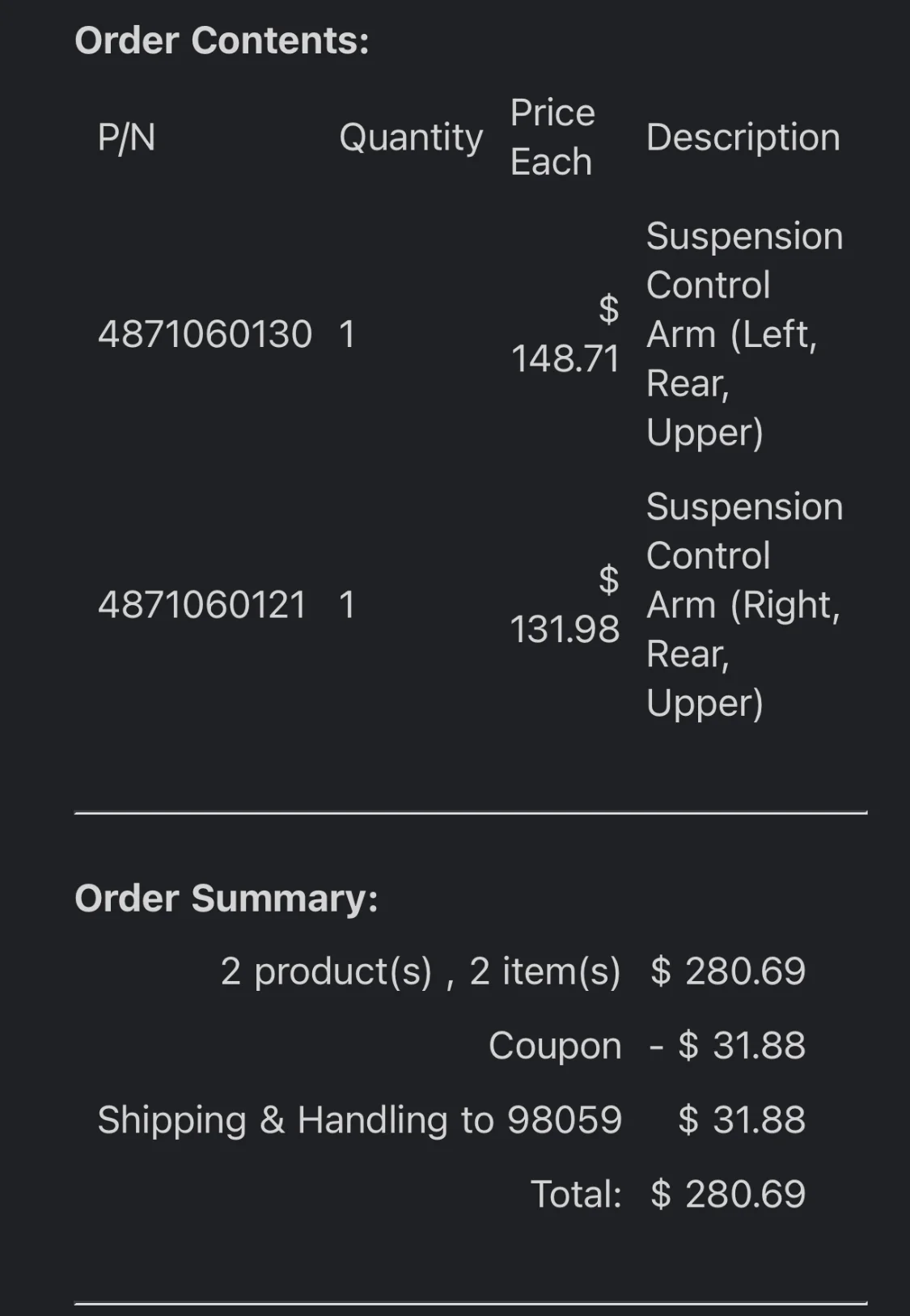

Mine look like that too 😱
Just got a set very cheap from Treasure Coast Lexus

Yes, mine was quite odd. One end of mine was perfectly in tact and one end was completely smoked (proper term) and torn in half 🤷🏻‍♂️

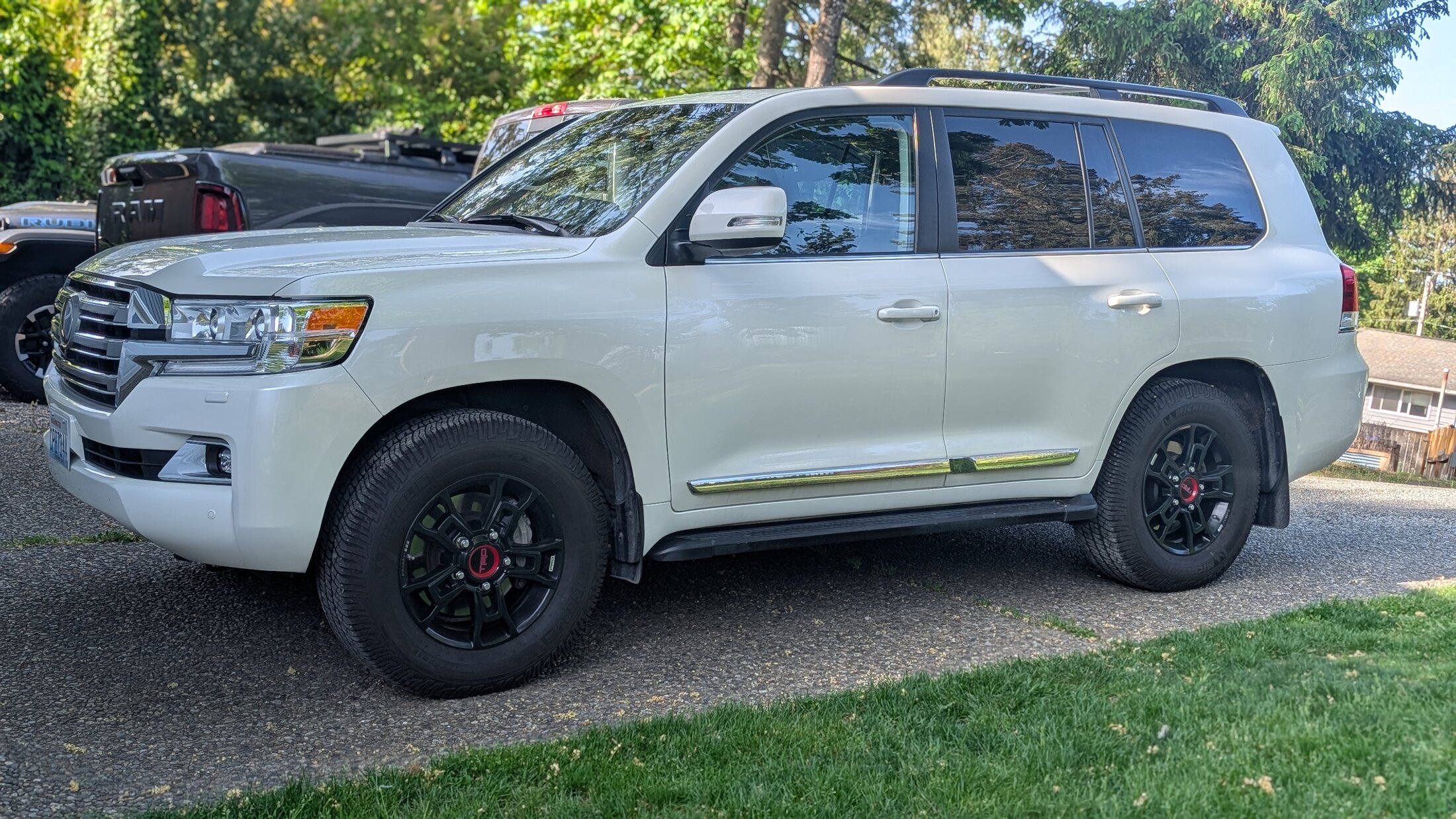

Finally scored me a set of Tundra BBS wheels. I've had three different sets of these lined up, but sellers flaked out.
Looks fantastic. I can’t tell in the pics but if you got the matte finish ones I’ve found the chemical guys matte finish sealant works really well at keeping them looking clean and not faded/chalky.
