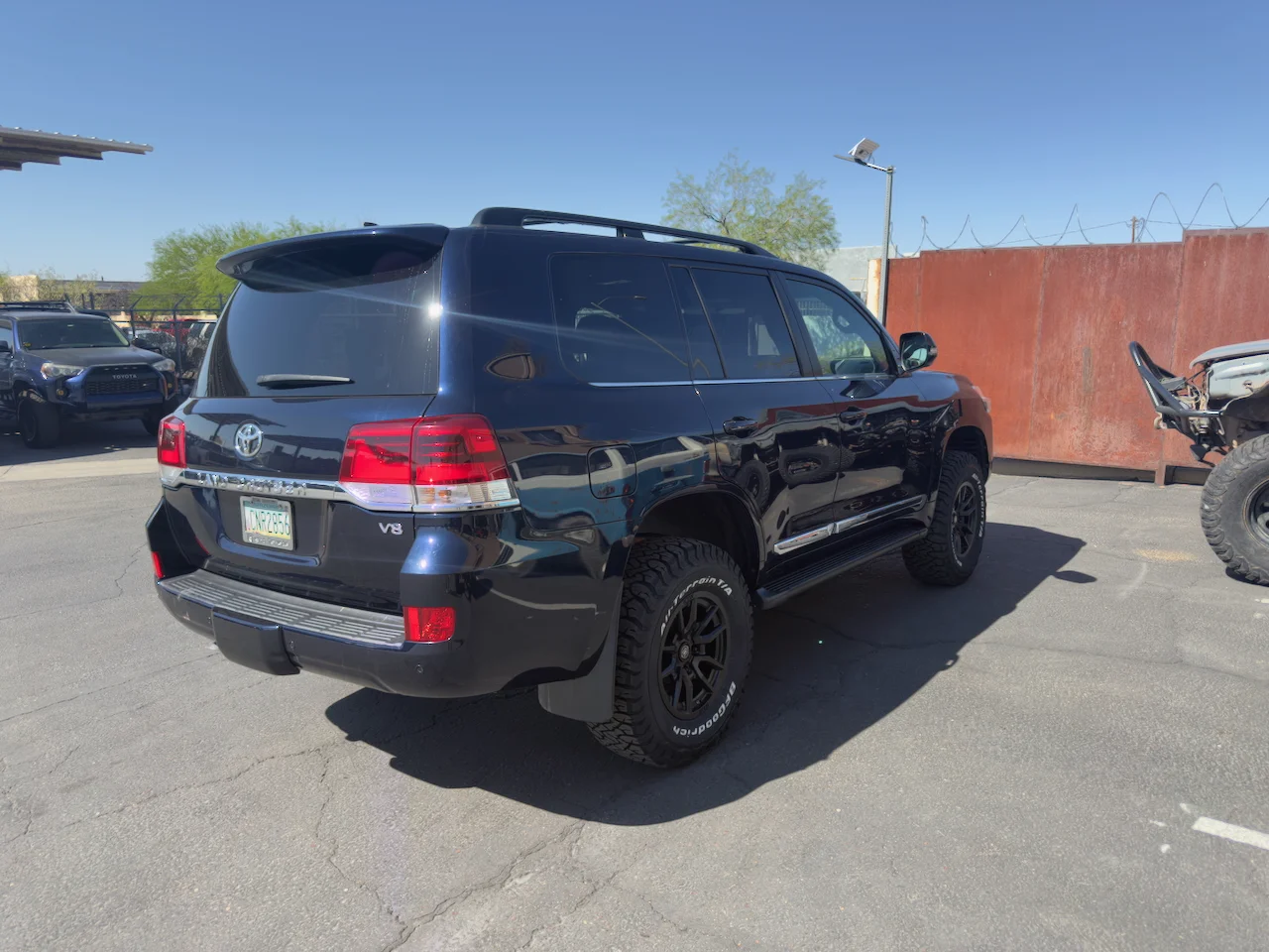

My buddy has a Higgy’s bumper and tire carrier on his 80. Sweet piece of hardware!View attachment 3881018
Dobinsons IMS front and rear shocks, rear springs, ~2" of lift front and rear, Icon Vector Vs 17" and KO3s to replace my outgoing KO2s.
Higgy's of Mesa did the work. Cool little shop that had my truck back to me super fast.

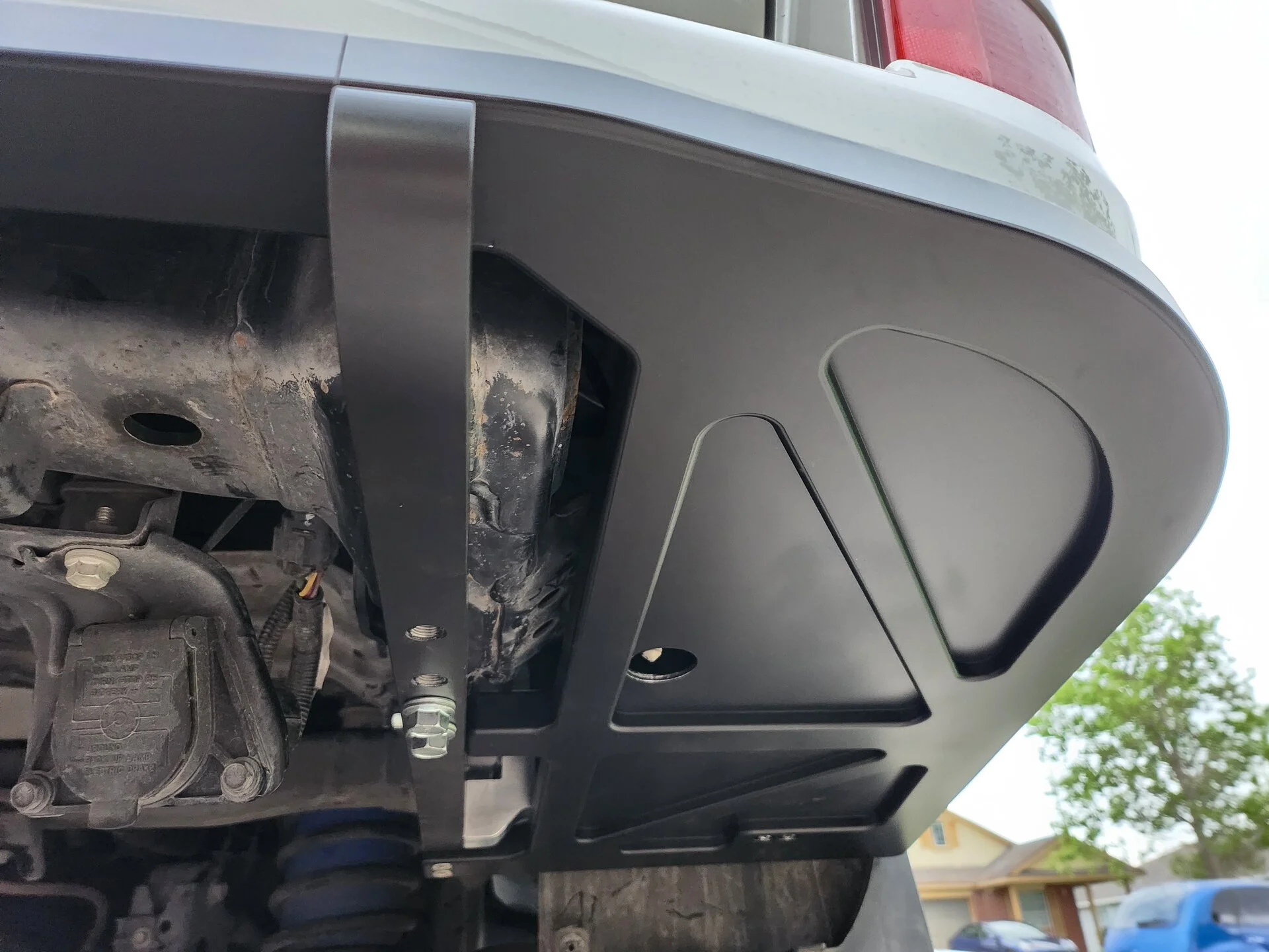

Something like this? I still need to touch up paint after install.This is the solution I've been looking for. Could you post a few more pics from a lower POV?
I feel like even with the 2" lift I get with the Bilstein set-up, I'm eventually going to crush the back bumper cover.

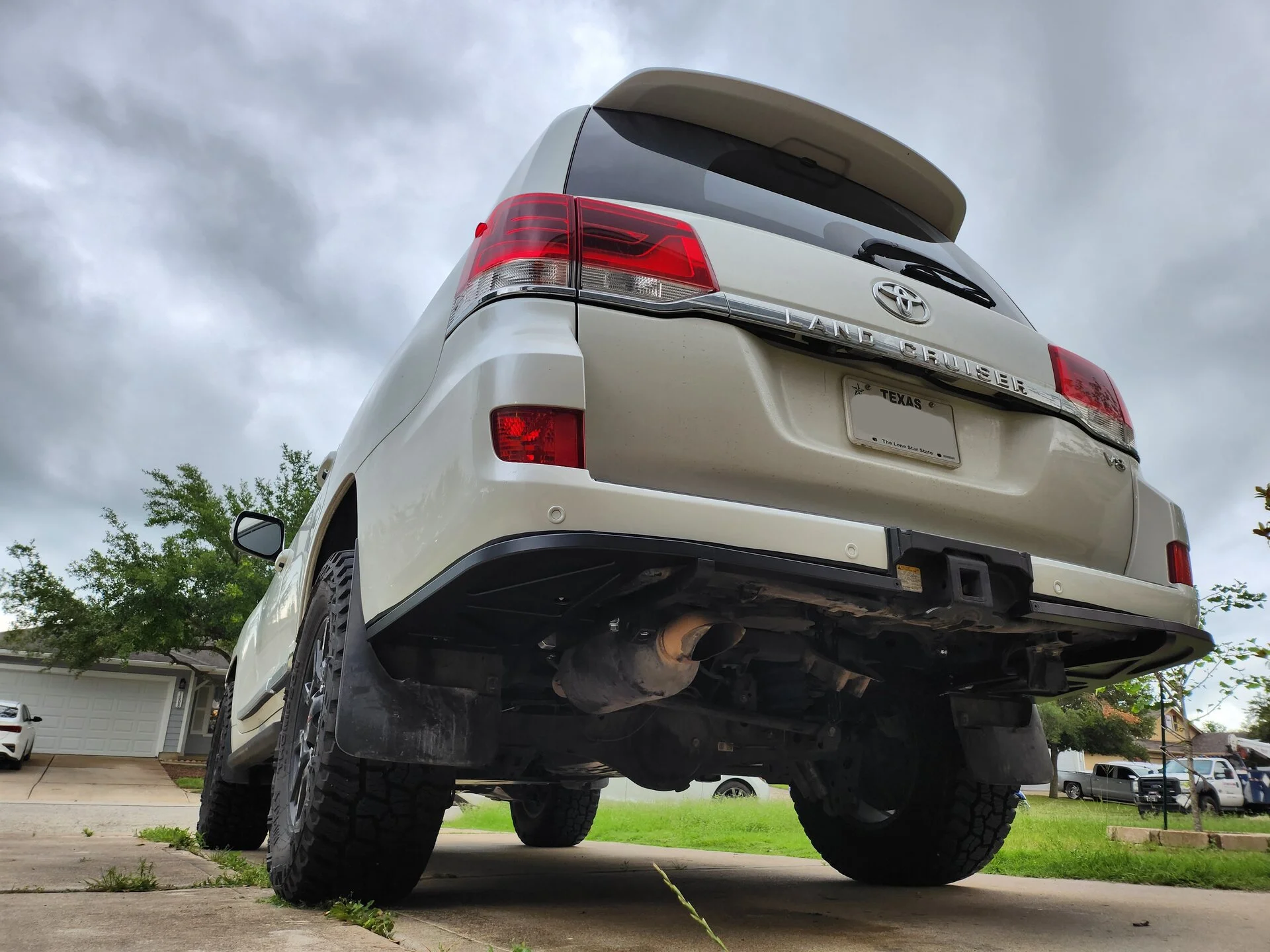

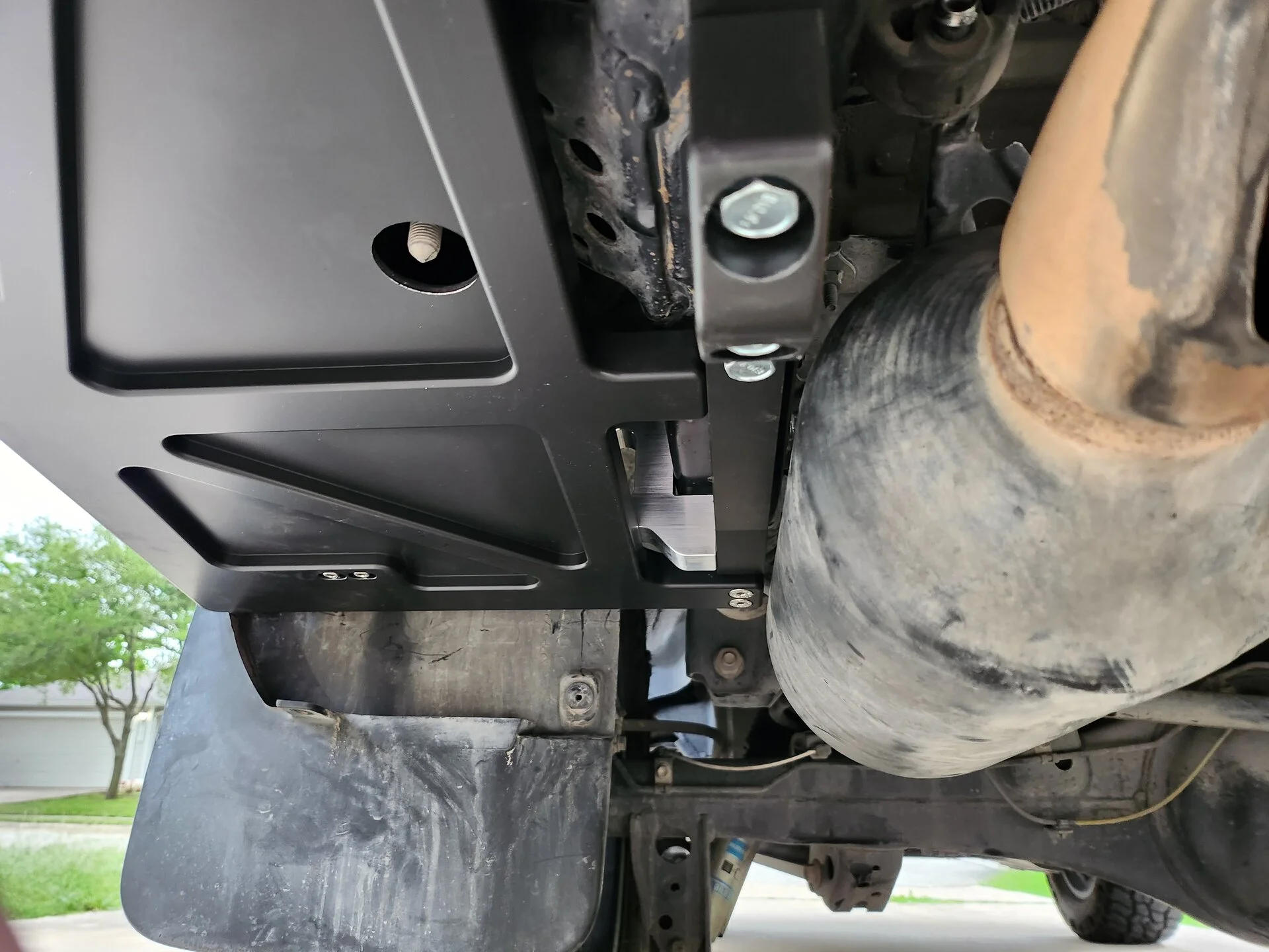

Here's some more lower angle photos from when I installed mine:
Any thoughts on some way to fill in the recessed area of the mud flap after this bumper is installed? Trimming off a portion of the mud flap is certainly an option, but wondering there are other options for filling in the area. Perhaps something 3D printed?

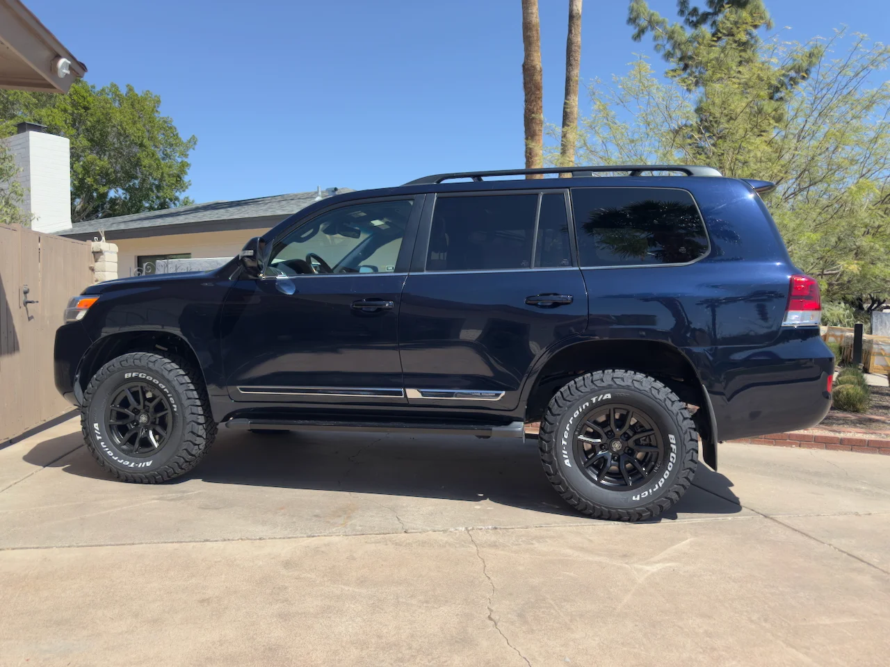

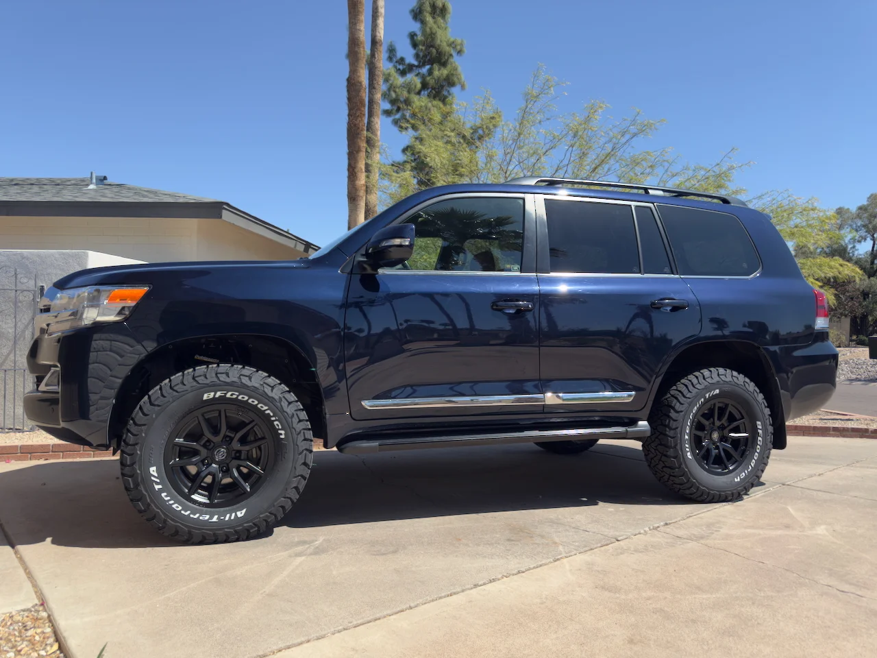

What size tires? And any rubbing? Love the white lettering facing outView attachment 3881018
Thanks!What size tires? And any rubbing? Love the white lettering facing out
Most likely you're hitting the front air deflector...thingies...in front of the tires. That's where my same-sized tires were hitting in reverse.Thanks!
285/70R17. Very slight rub at near full lock on reverse. Not sure on what yet but seems minor and avoidable. Front mud flaps had to be removed.
Which direction are looking to have filled. @turbo8 includes a spacer to bolt to the bumper that fills the gap between the mud flap and the bumper on the horizontal plane. He did it in two pieces so that it could be removed in the case that you run larger tires. There really isn't a gap in the vertical plane, but there is that ridge in the mudflap that would have normally caught the old bumper as it wrapped under the truck. I suppose you could trim that off if it looks incomplete. My though was to trim the mudflap up to that line so that it would look a little nicer. It really isn't that noticeable in day to day.Any thoughts on some way to fill in the recessed area of the mud flap after this bumper is installed? Trimming off a portion of the mud flap is certainly an option, but wondering there are other options for filling in the area. Perhaps something 3D printed?

Thanks for the feedback! Yes... I was referring to the gap where the removed portion of the bumper fit into the mudflap (that ridge in the mudflap that would have normally caught the old bumper as it wrapped under the truck).Which direction are looking to have filled. @turbo8 includes a spacer to bolt to the bumper that fills the gap between the mud flap and the bumper on the horizontal plane. He did it in two pieces so that it could be removed in the case that you run larger tires. There really isn't a gap in the vertical plane, but there is that ridge in the mudflap that would have normally caught the old bumper as it wrapped under the truck. I suppose you could trim that off if it looks incomplete. My though was to trim the mudflap up to that line so that it would look a little nicer. It really isn't that noticeable in day to day.
