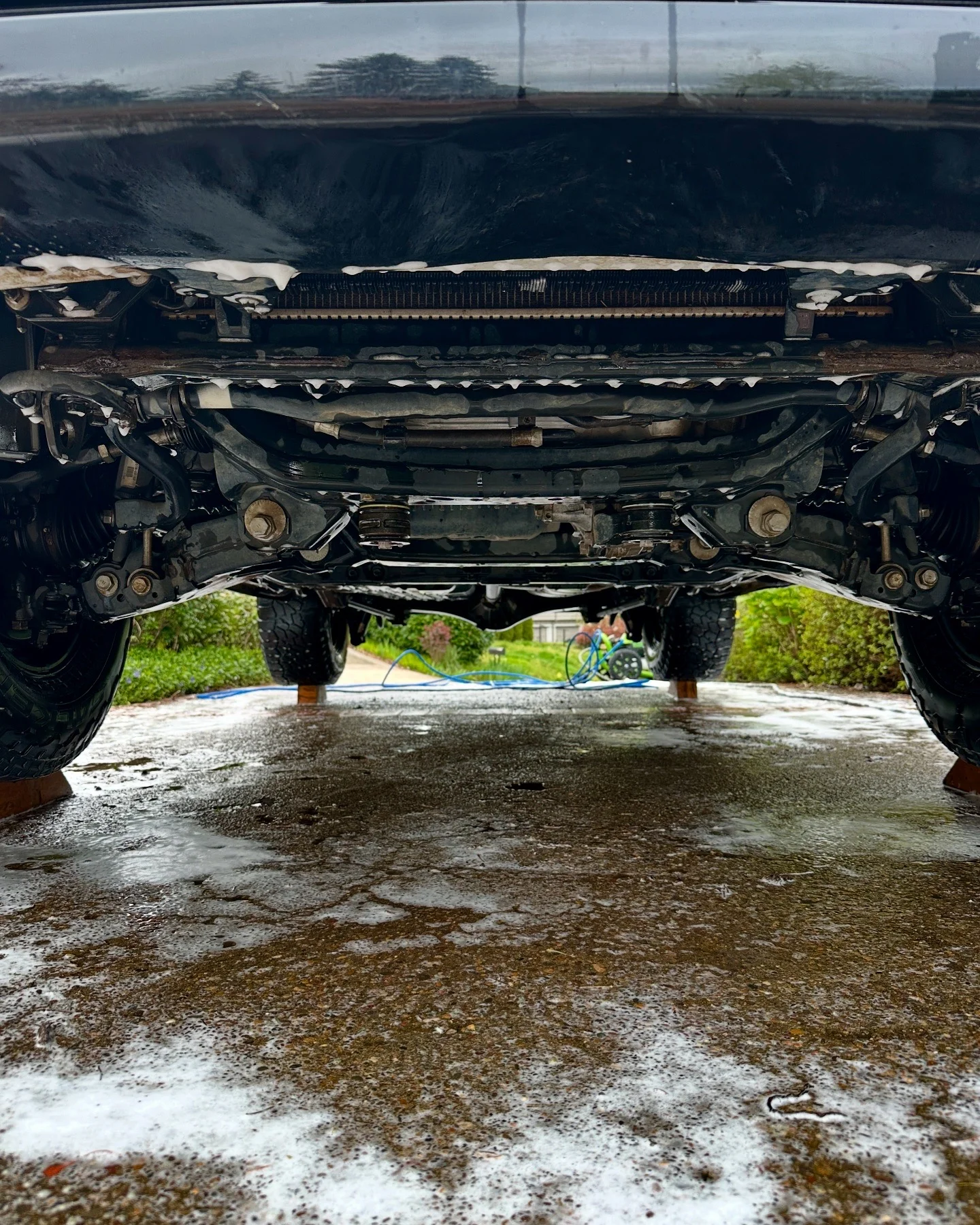

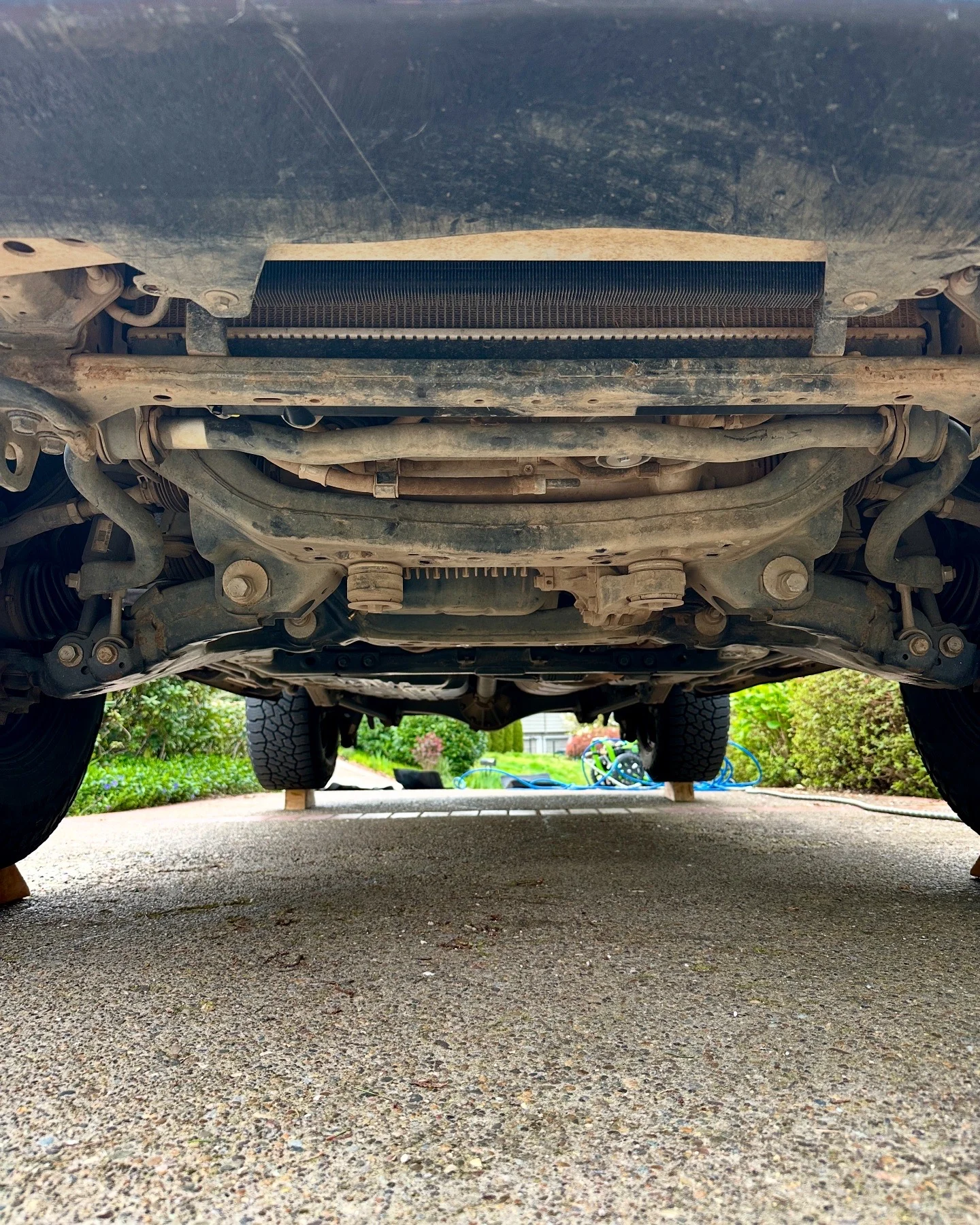

Huge thank you to all the folks who have posted so much helpful info on here. I could not have done it without the contributions of many on here. I am by no means a mechanic, but a very happy new owner of a 2013 LX, 165k miles when purchased. Drove it 1k miles home and noticed a radiator leak. Sat in my driveway for 2 weeks (you have no idea how frustrating it was to finally have the vehicle I have always wanted and not be able to drive it) while I ordered 3 different Denso radiators, first 2 both arrived with a broken stem off the radiator cap. Finally got that installed and did a few other things. Next on the list is f/r diff and transfer case fluid, and I would like to add a dash cam that plugs into the rearview mirror.
Radiator was not as bad as I feared. The last plug was not fun. The thermostat was not fun. The pcv valve was really gunked up, it still shook a little but nothing like the new one and i could get a little air past it. I highly recommend doing the PCV if you have not already, its ten bucks and takes ten minutes.

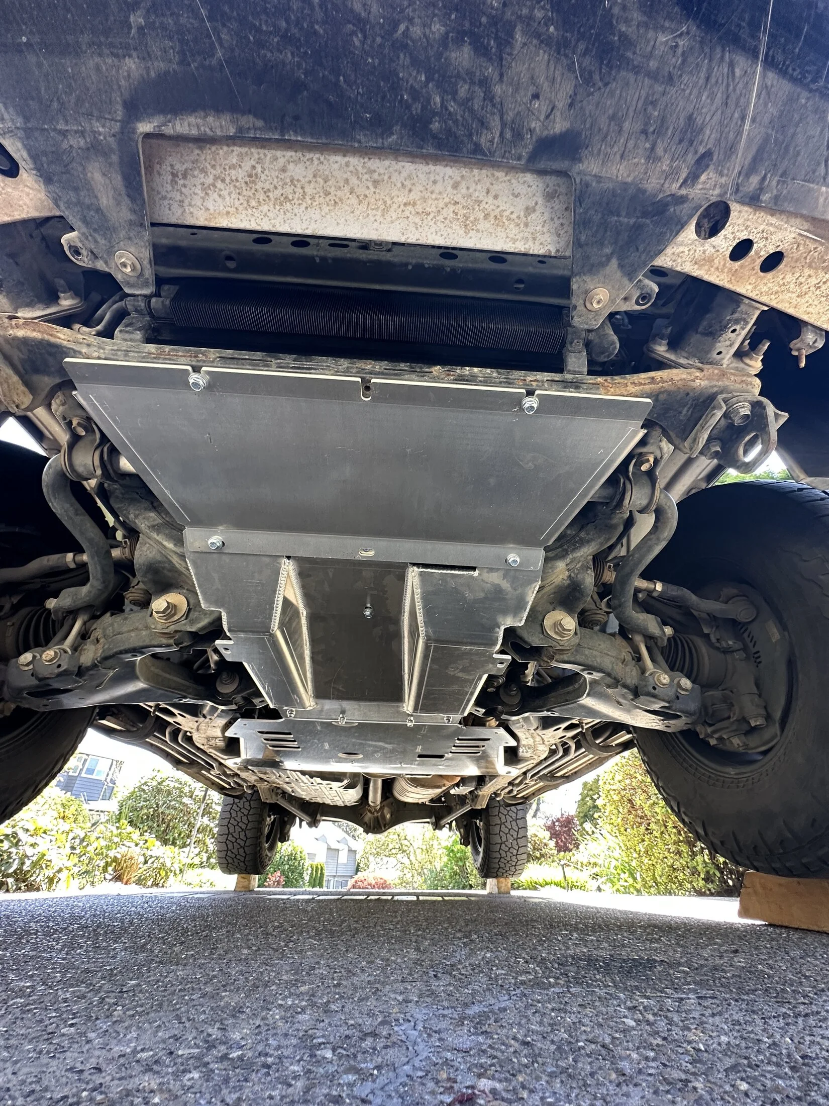

New skids, who dis? I'm pumped to have these skids from Dissent installed finally. If you have an LX570 and are considering these, my installation didn't allow for the optional stiffener brackets. I guess time will tell how critical those are to the performance. The install gave me a good reason to attach some much needed spring cleaning.
