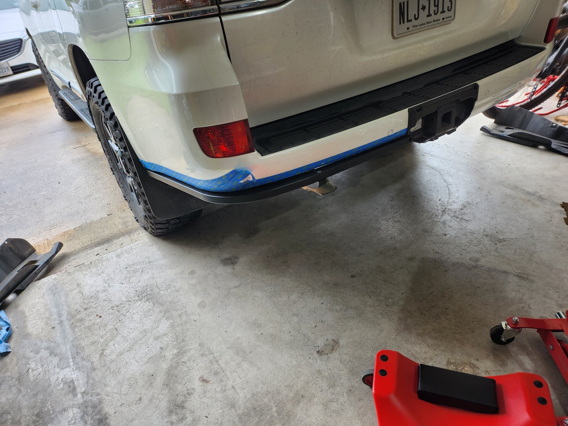

Taped and measured some reference points where I would make my first conservative cut on the bumper skin. The point here is to get enough bumper removed to allow the new bumper to be temporarily installed, so that the full gap required can then be measured, marked, and cut. I used a laser level to mark the line, then I traced it with pencil.
Then start cutting! I was happy that all my old scrapes were now cut off.

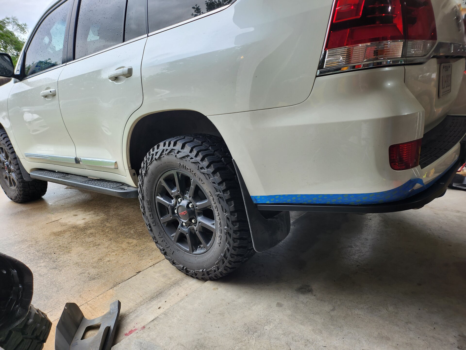

Bumper wing installed, mark the correct gap where the bumper needs to have its final cut. Since you have the full wing installed, this is also the right time to mark where you need to drill the frame on the bumper arm that reaches over toward the hitch receiver. Then remove the bumper wing, cut the bumper skin at the new mark you made, and drill the frame where you marked it.
Then install it again, but now for the final time. This side's bumper wing is now done. Super simple. Then do the same for the passenger side and you're done!

I still need to trim the mudflaps. Also, the edge of the new bumper panel that is next to the wheel well has M6-threaded holes next to the mud flap. They are intended for a gap filler for people running tires smaller than 37" (I'm at 33"), but I'm planning to secure the remaining portion of the mudflap (after trimming) to it.
