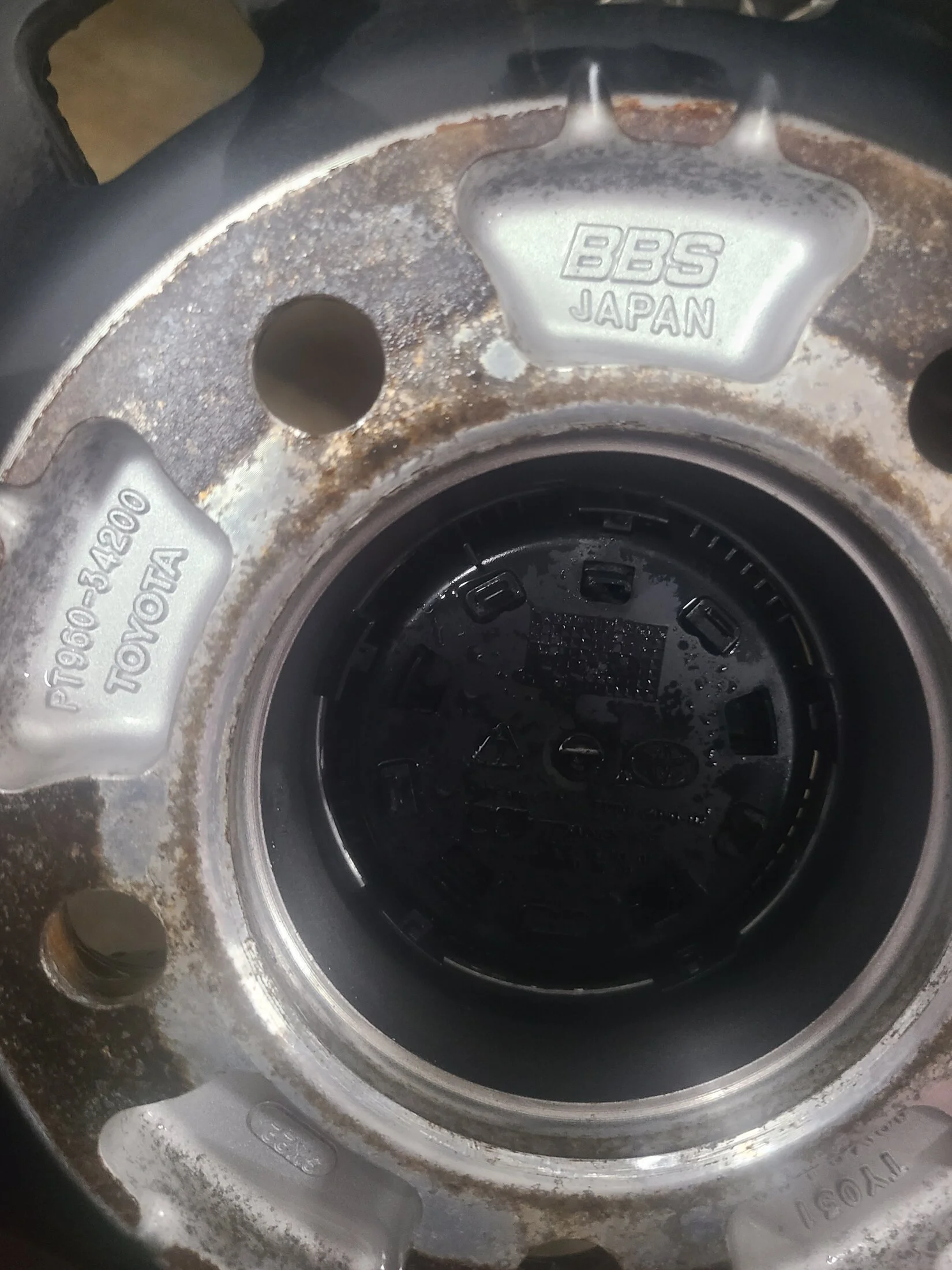

Would it be worthwhile to take a light wire wheel to the back of those? Or would it remove too much of the substrate along with the rust?
I once had a wheel ruined by discount with their aggressive cleaning.
I prefer to use sandpaper and a nice flat piece of wood.
I was thinking a very high grit sandpaper maybe? I plan to address that..
Not sure the best option there. I have silver wheel weights I need to remove too. My OCD won't allow that haha.
Otherwise they are in really nice shape, I'll get everything sorted out

I’d imagine sandpaper with low enough grit count would likely do the same thing. Probably a situation that you can always sand more. Just can’t put it back on.
Agreed, but the point of the board is to at least keep things flat. I didn't mention using light, even pressure, which is actually just as important.
As long as I'm not too aggressive with things it should only remove the high spots, which would be build-up. A wire wheel can absolutely remove aluminum, and that is what messed up the wheel I mentioned.
For someone with steel wheels? Go to town.

Did you taper up in a higher grit or just use say a 2k grit paper?
What seemed to work best for you?
Thx bloc!!
It has been a while since I did it but pretty sure it was only one stage and medium grit. This doesn’t need to be a perfect surface, just clean and flat.

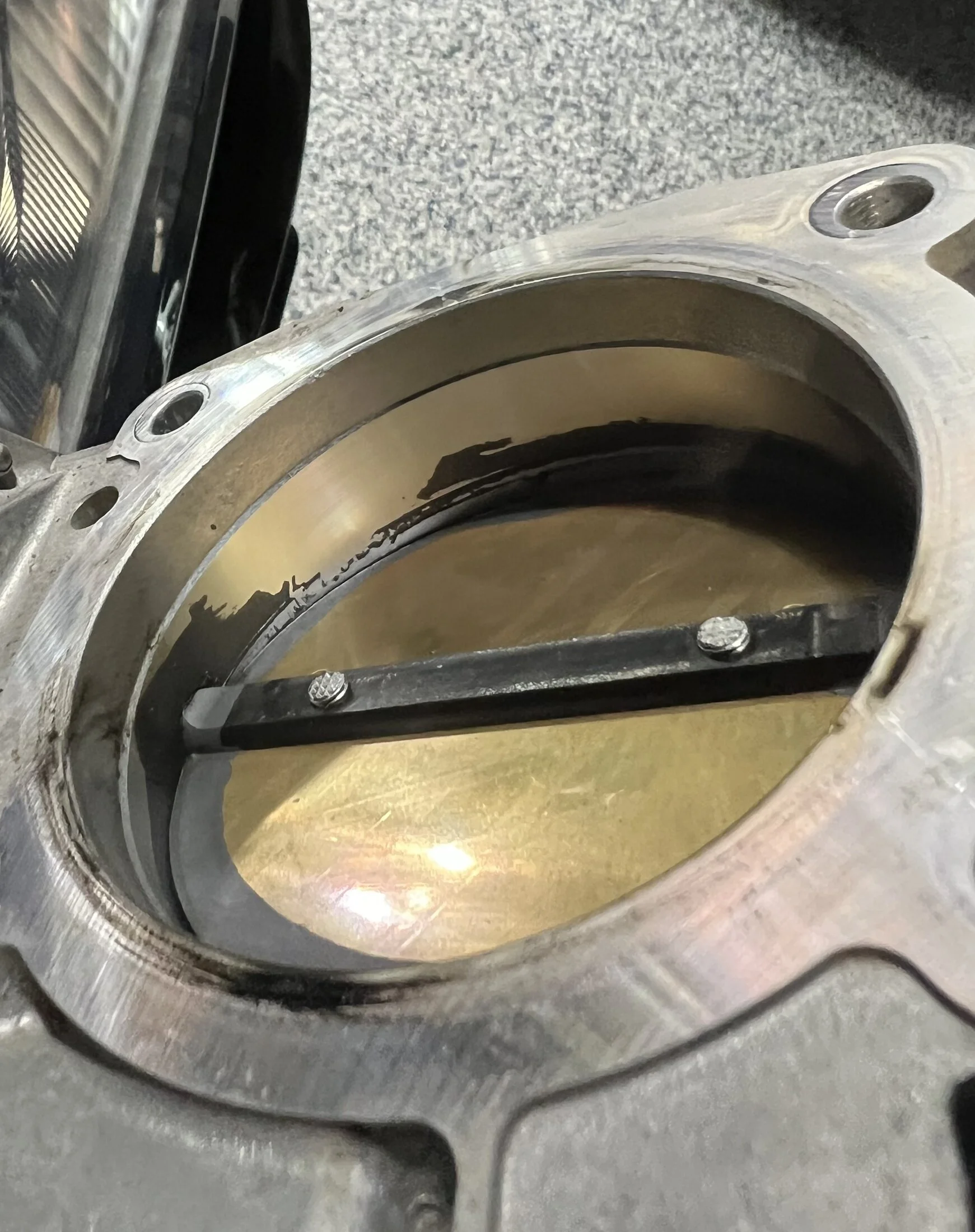

A few weeks ago I added BG Platinum 44k fuel additive, anticipating the work today. Within a tank, responsiveness was better.
Today I removed, cleaned, and reinstalled the throttle body. Clearly prior service I paid for didn’t remove and clean it like they said they would. The pattern of deposits on the back side looked older, thicker, and was harder to remove than the film around the rest of the throat, which came off easily. A little extra time, cleaner, and a bit of elbow grease got it all.
I am a first timer doing this, and it’s like 🍌🍌 at best. Maybe 40 minutes at most. (I also cleaned my 2021 GX 460 throttle body while I was in the mood. Much lower mileage, even easier to clean up.)
Don’t put this off - It’s one of the best bang-for-your-buck DIY maintenance items to save money. This is a way over priced item if you pay for it. Plenty of guides out there to help. I think I saved about $600 today between both - compared to dealer pricing.
Before and after (inside)…

Good work.
If others attempt this, the gasket behind it has an integrated mesh strainer to avoid bolts or other unwelcome objects getting into the intake and nuking the whole engine. The mesh portion can be cleaned but the gasket is silicon, can compress, and is technically considered a non-reusable part.
22271-38010 and it's pretty cheap.. under $10
