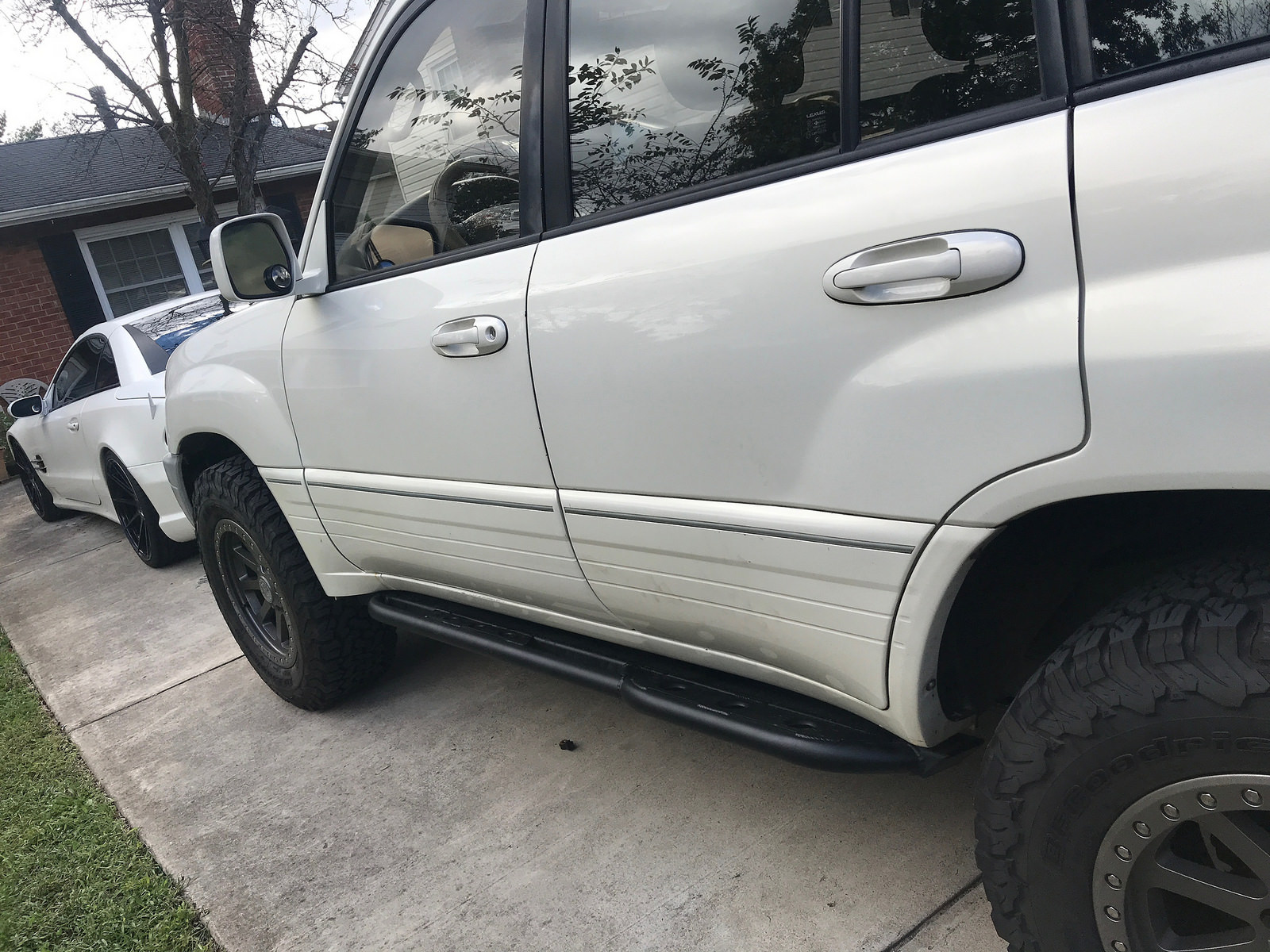

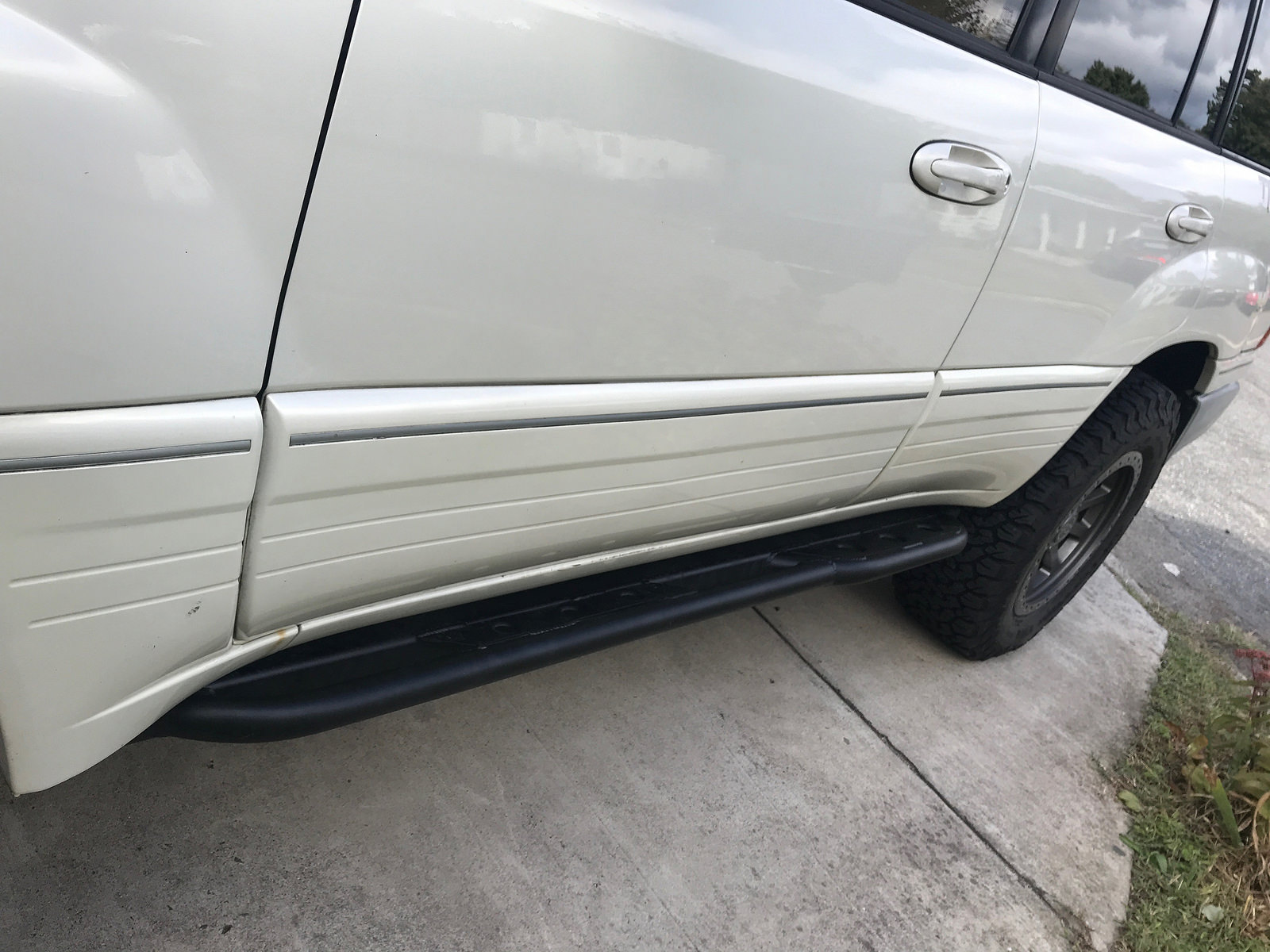

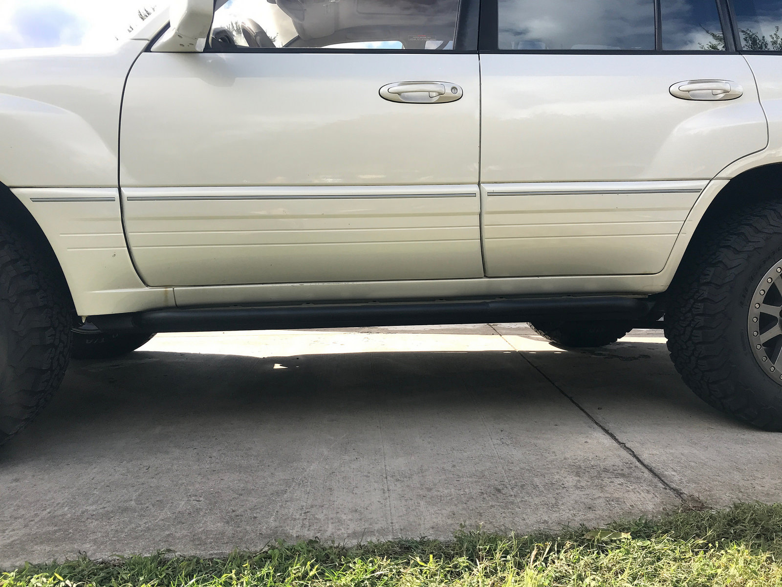

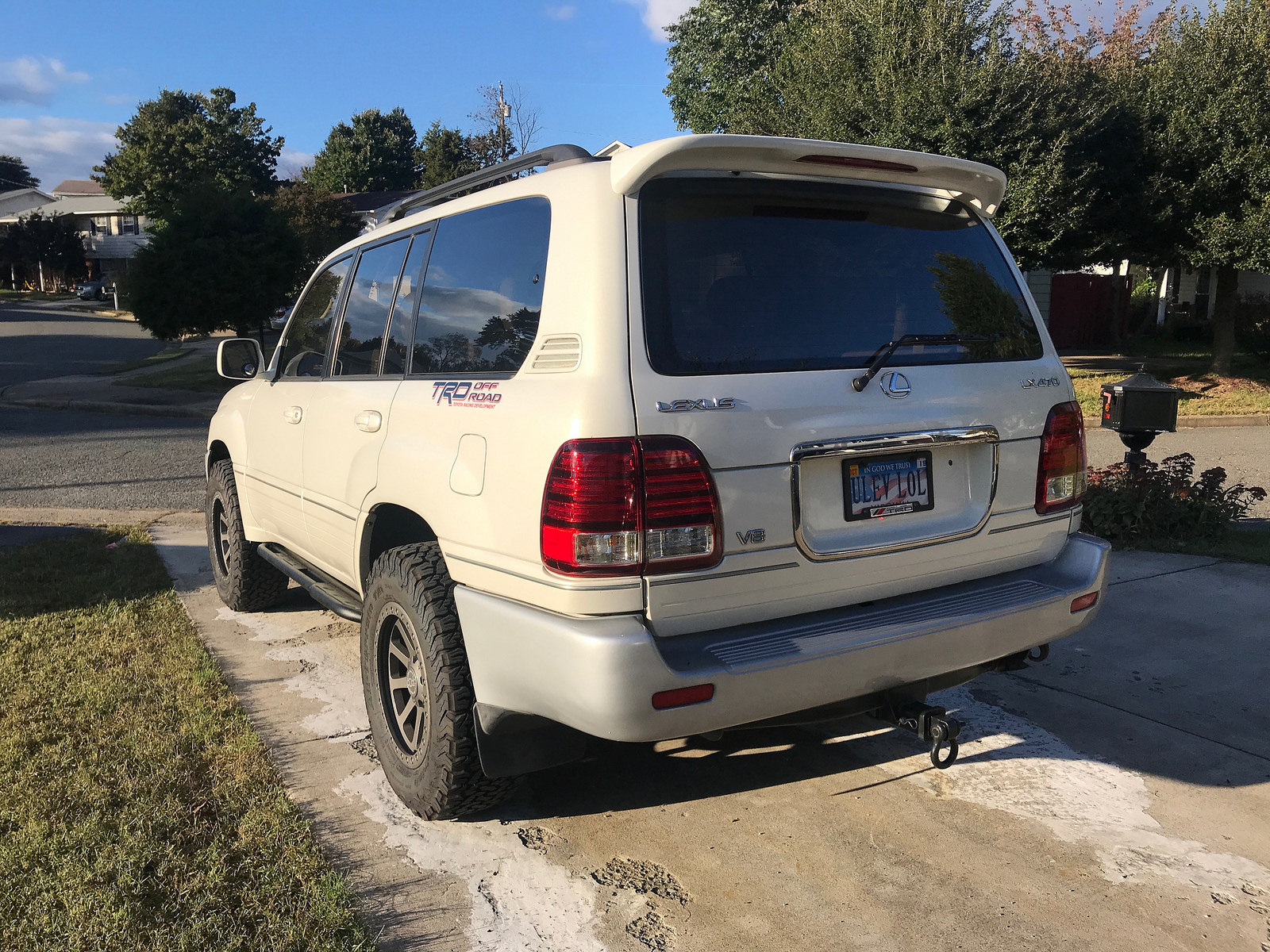

Got some Metal Tech sliders on, man these things are beefy, can't wait to test them out on the trail but i have no doubt it'll hold up the 3 ton beast. Looks great too. A little tricky putting them on because of the AHC lines, snaking the Ubolt around the frame under the line while holding up the sliders were no fun, they're heavy!
