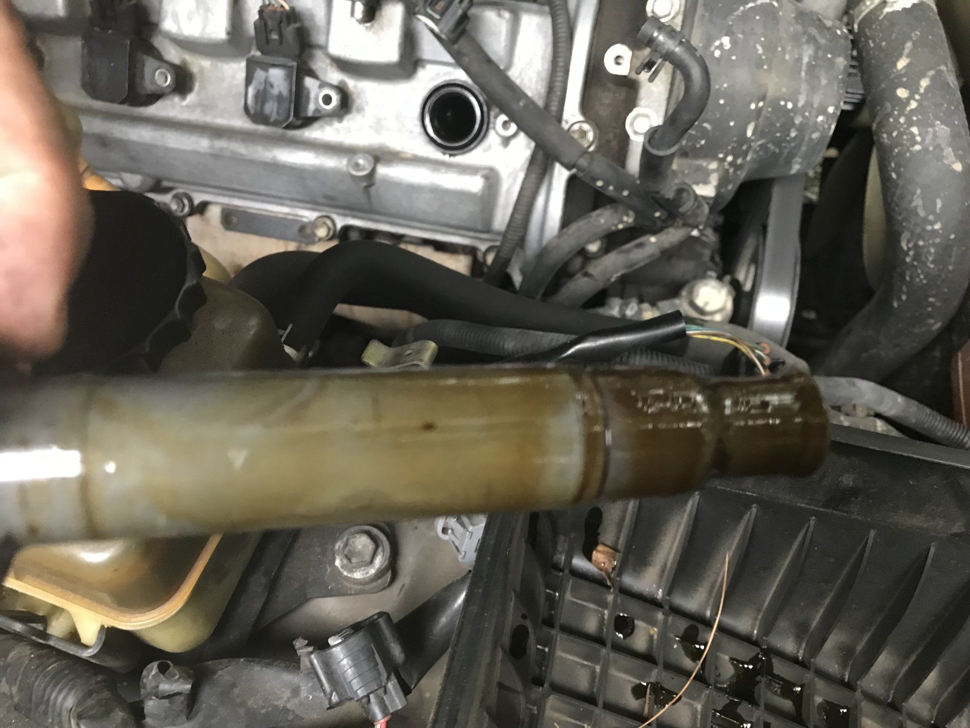

Busy weekend chasing down a random misfire. Found the coils 2,4,6&8 covered in oil.
Replaced...valve cover gaskets, Spark plug gaskets, Coils and plugs on both sides. When that didn’t fix it completely, I located a vacuum leak between cylinder 1&3.
And then replaced intake gaskets.
The leak was confirmed when I found the lower intake gasket completely cracked in half. Almost looked and felt like plastic. Seems odd to have a plastic gasket in that location though. Everything is back together a running good as new.

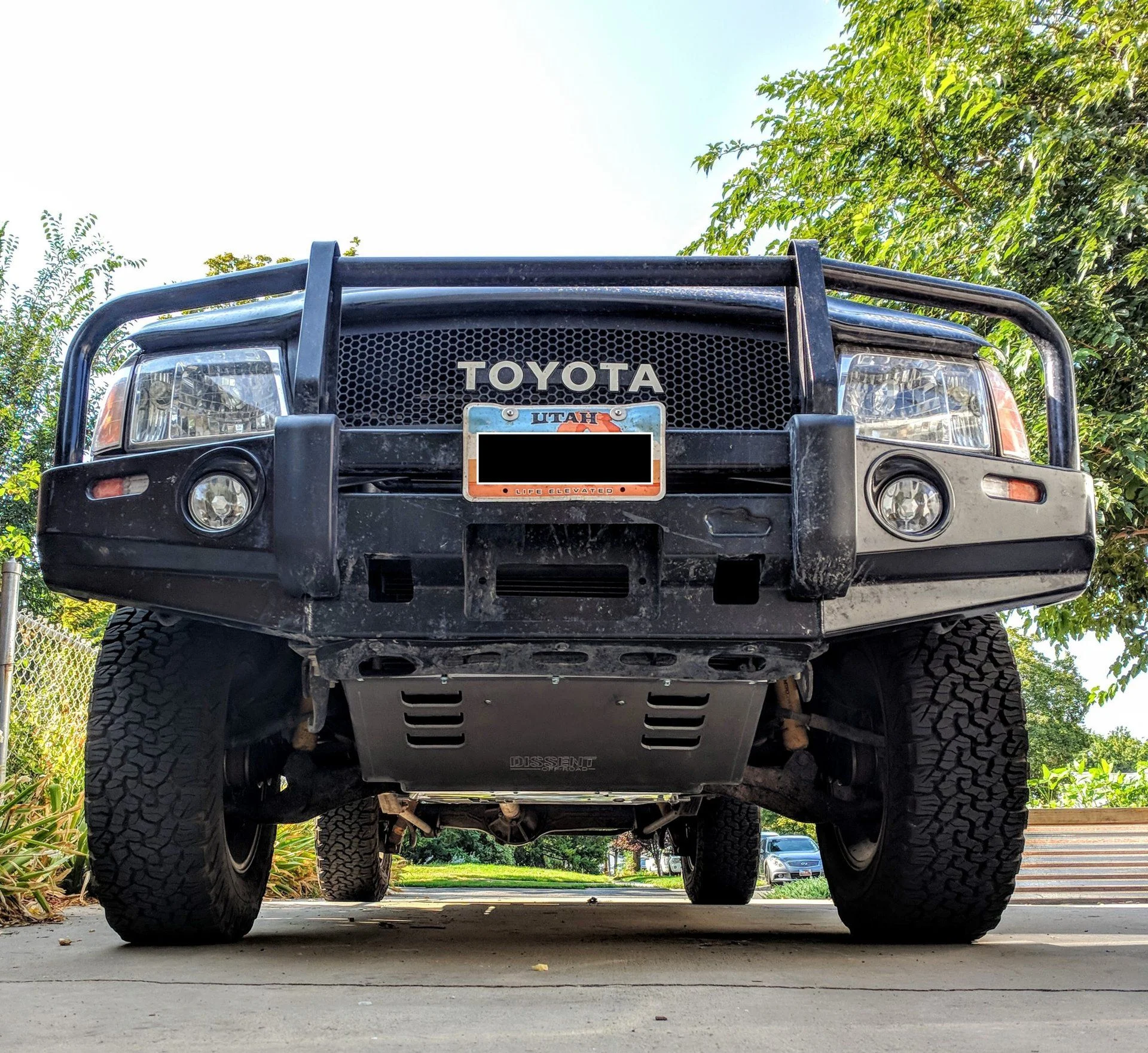

Past few weeks, but drilled out and tapped frame holes to install skids. Noticed a small leak from the radiator/transmission cooler that another clamp on the transmission line did not resolve, so replaced radiator/thermostat/hoses and new SLL. Thanks to @2001LC and @abuck99 for their extensive discussion of replacement options, went with a spectra rad and gates hoses.
Got the skids installed and went wandering for performance testing purposes.

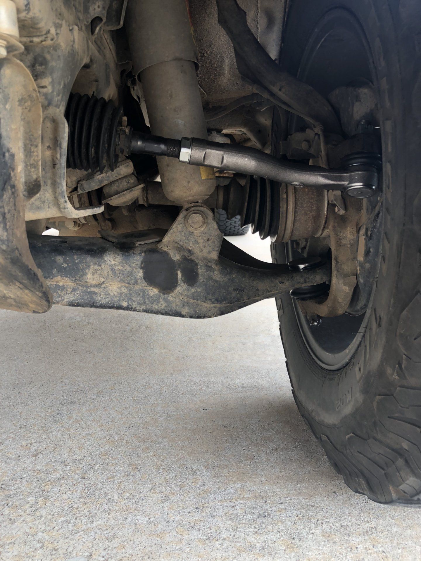

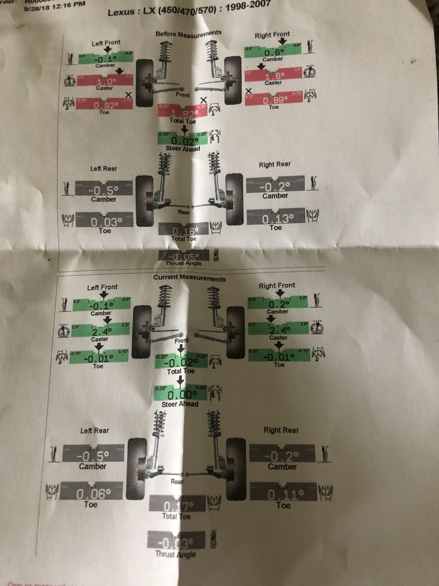

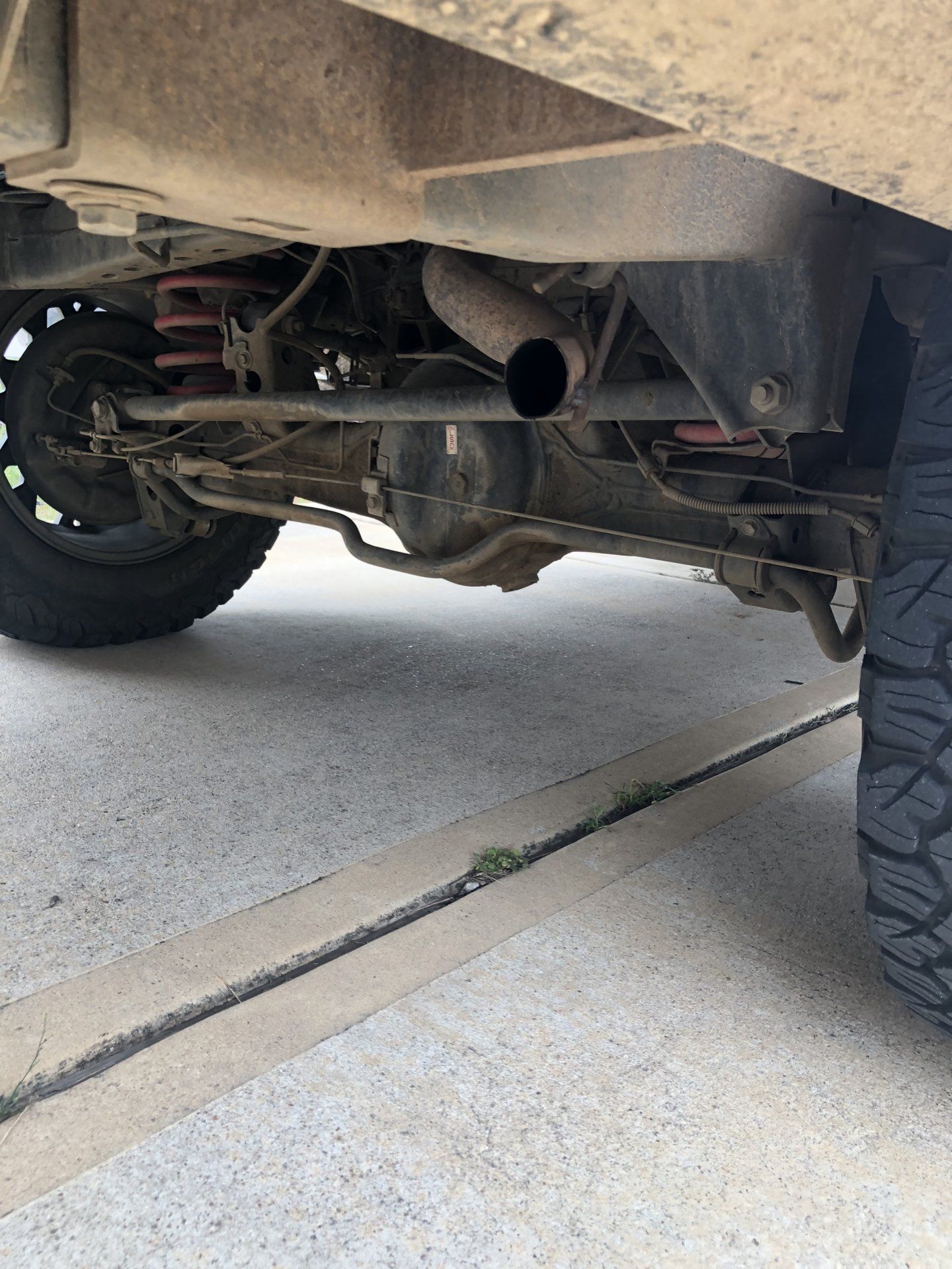

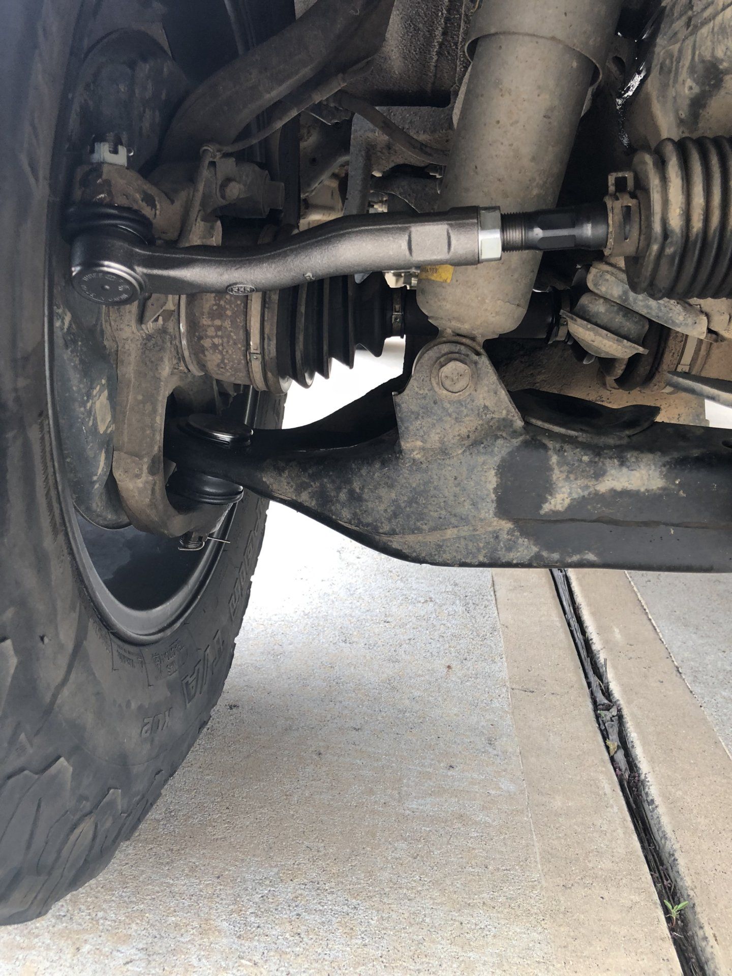

One BIG update (new inner/outer tie rods and lower ball joints) and one “saws all” update (removed resonator). The old inner tie rods were trash as was one of the LBJs. Had to get the vehicle aligned again as I couldn’t quite get it just right. Thankfully have the free lifetime alignment from Firestone. Resonator delete made no difference. Still drives the same with no increase in noise. Nice to have the clearance though as my resonator looked like it went a few rounds with Mike Tyson.
Went with the 555 LBJs and Tie Rods from Kurt at Cruiser Outfitters. EXCELLENT customer service and super quick shipping. Can't say enough good things about he and his team. Highly recommend parts through them.
