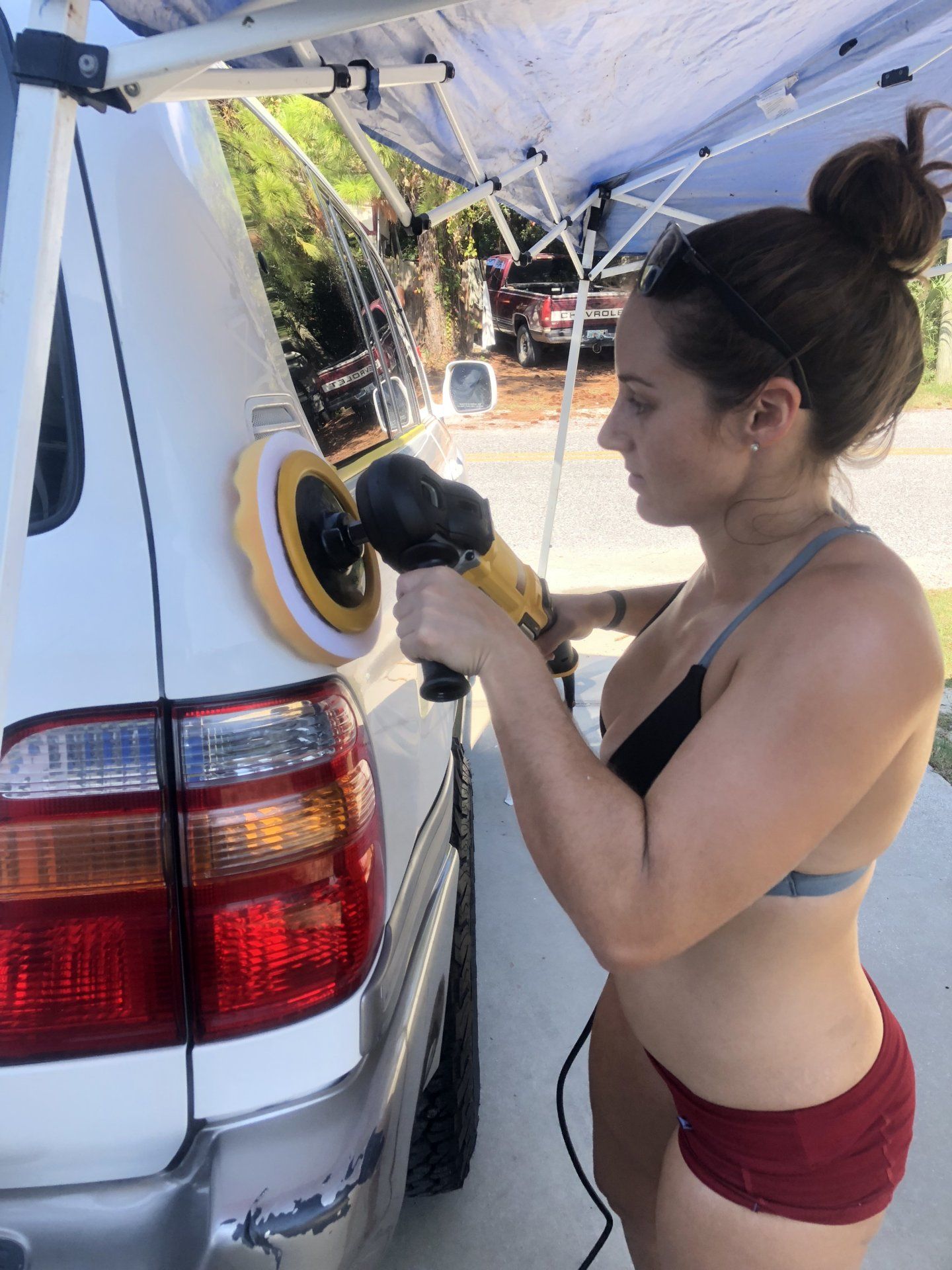

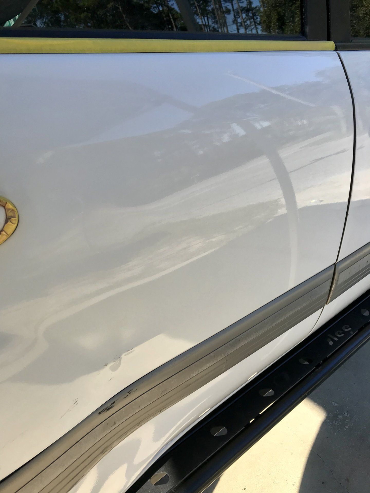

Well I started my paint correction until the Florida weather hit. I managed to get about halfway done. This is my first attempt so there are some scratches left but my main goal was to make the paint shine again. I’m not aiming for perfection as there are a bunch of rock chips, a good dent on the passenger side thanks to the previous owner and the trim needs to be completely repainted. There isn’t any wax on it yet but it is SOO much shinier. Now my husband wants me to polish some scratches on his ‘17 tundra ;) I guess I owe him since the last time I drove it some crazy lady took a shopping cart down 3/4 of the drivers side at the grocery store :rage:
Here’s a before, after one round of compound and polish, and me in action

Nice job! What products did you use?
Thanks! Not bad for the first time. I used some cheaper turtle wax heavy duty compound on my heavy cut pad and Meguiar’s mirros glaze fine cut on my medium pad. Hopefully I can finish those two all the way around then hit it with the show car glaze on my finishing pad and wax or seal it. I went the cheaper route since it was my first time. My drivers side has only been hit with the heavy duty compound and my neighbor saw that side, came over to ask if I got it painted. So I’m not disappointed for using some ok products. Next time I might splurge on some higher end stuff now that I feel comfortable with my machine and he process.
