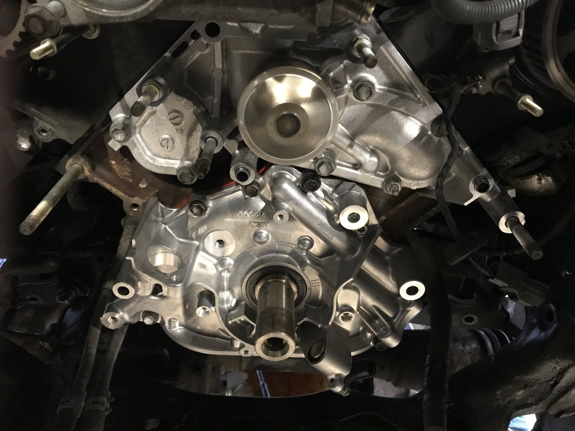

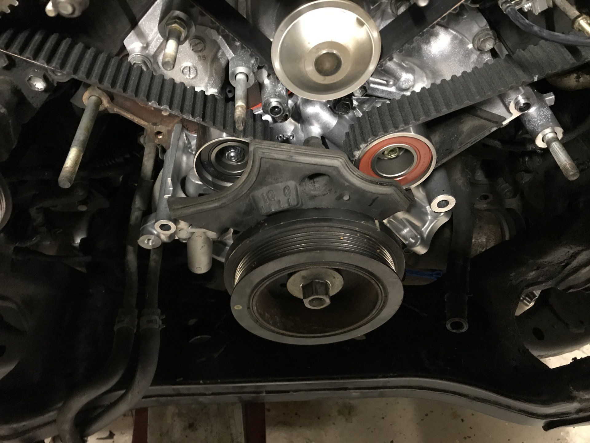

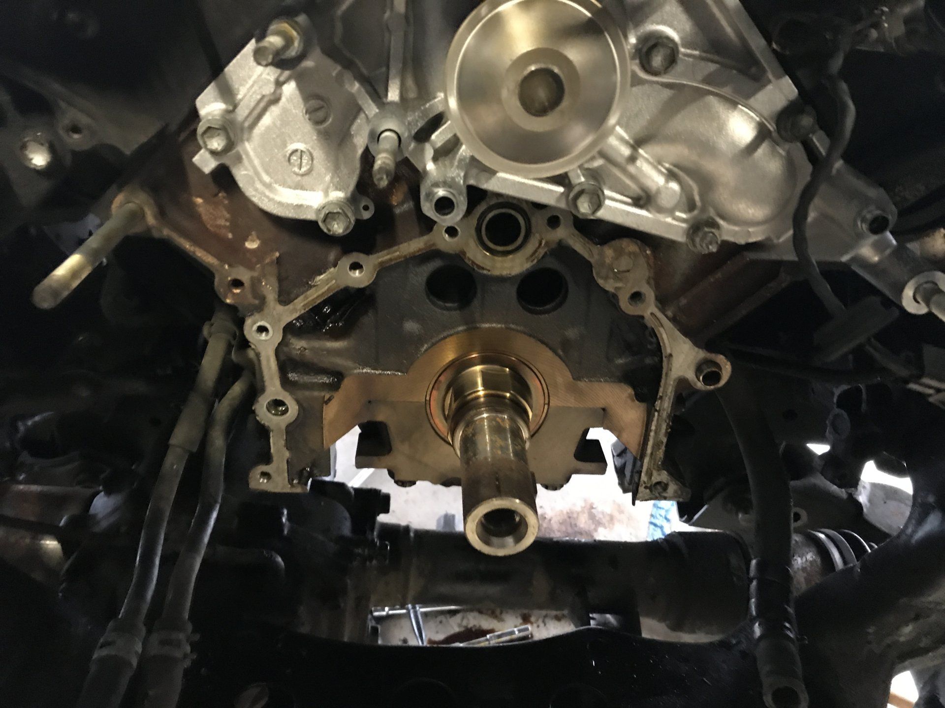

Spent some time this winter getting things under the hood sorted out:
Oil pump
Oil pan gaskets
Timing belt/tensioners
Water pump
Alternator
Drive belt
Front main seal
Fan clutch
Steering rack/rod ends
Coolant hoses
Drive belt/tensioners/idler

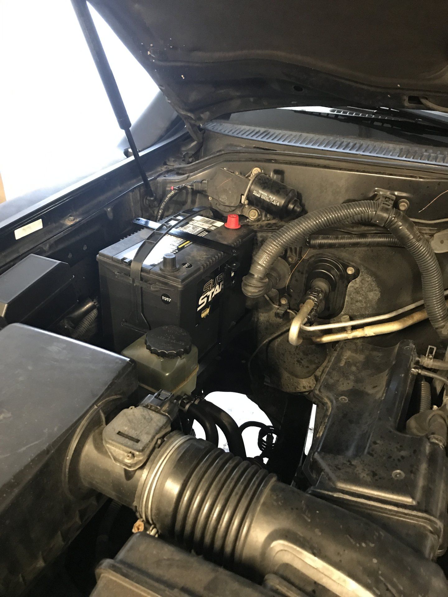

While I was in there I added my dual battery, ome heavy all around and the thin TJM skids.
This was a lot bigger project than I thought it would be. Im glad everything is new though. I went Aisin on 75% of it from rock auto. Rolled the dice on a reman steering rack.

Well, oil pan was not in the plan until I stripped a hole in the oil pump (even with a torque wrench ☹️). I had the steering rack out and dropped the diff about 4”.
It’s important to note that there are 2 “pans”. One it the traditional stamped pan on the bottom. The other is an aluminum “wall” that bolts to the bottom of the block. There was a perfect angle/twist move that had to be done going in and out that took me several minutes each way to figure out.
