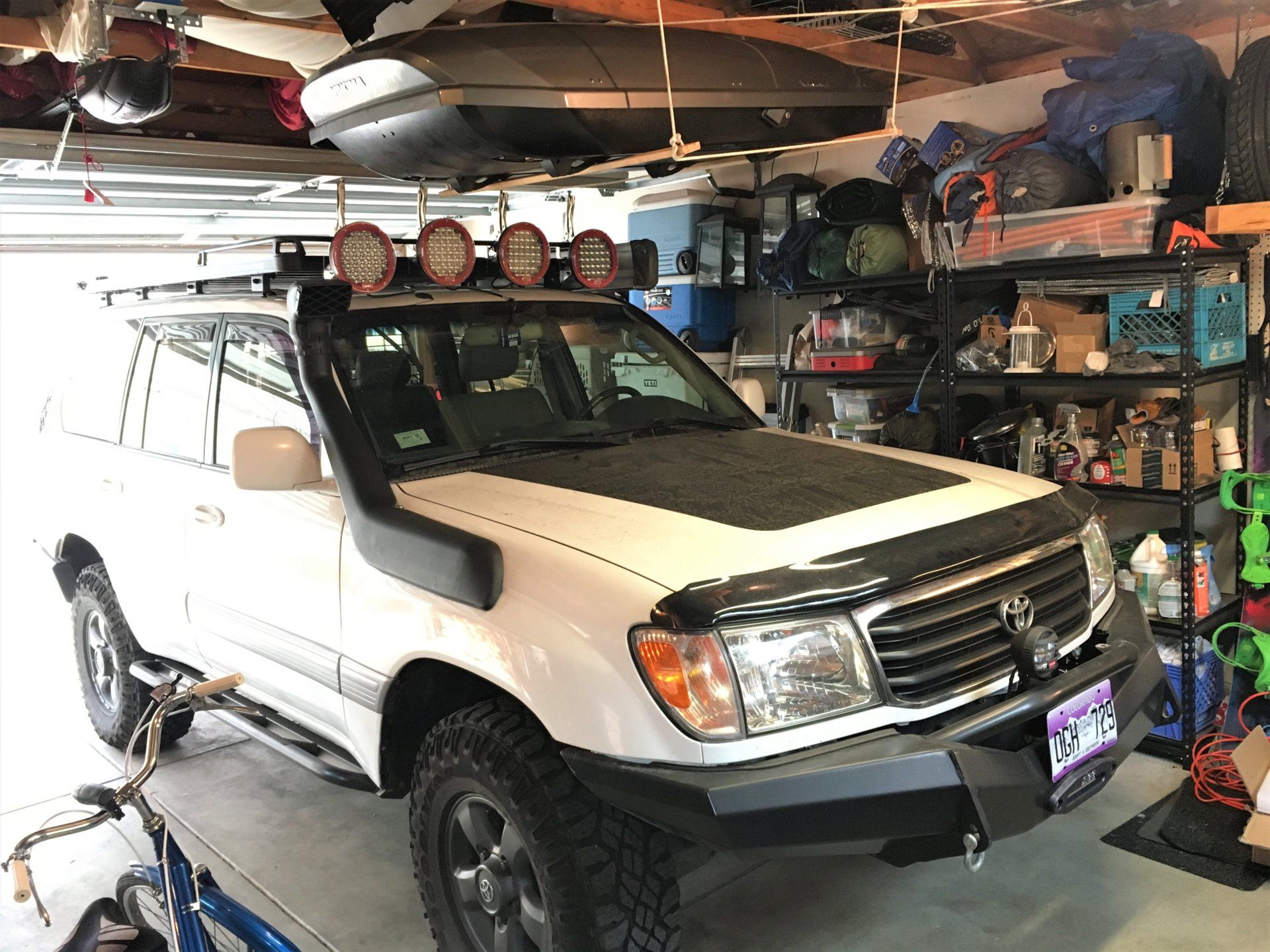

Picked up some ARB knockoffs from Amazon. Build quality is really good. All stainless nuts/bolts/brackets. Haven't powered them up yet, so can't comment on the brightness, throw, or beam pattern.
Nilight 185W 9" LED Lights
Just mocked up for now to figure out how mount them. Probably going to have to fabricate some kind of glare shield for the bottom side of the lights.

You'll love them. Mine have been great they are more flood then anything. Also i had to run two power relays because they suck some power up.

Awesome. I heard they are more flood than spot. Thanks for the heads up on the dual relays. That is what I figured I would have to do. Another member on here did a bench test on them and at 11.9V each light pulled something like 12amps.
Question, did you wire them up to a single switch? I was going to do that or I was thinking of a 3 position switch. position 1 - Off, position 2; on - middle two lights, position 3; on - all lights.

Yes I just hooked them in to one switch. I kinda like the three position switch idea tho.
