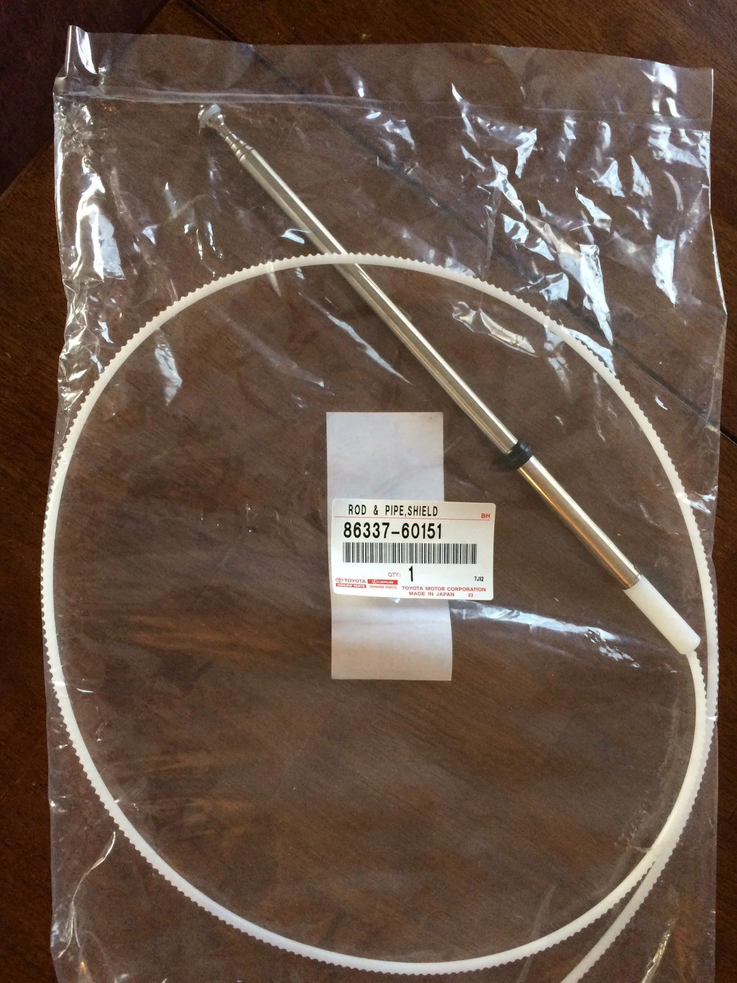

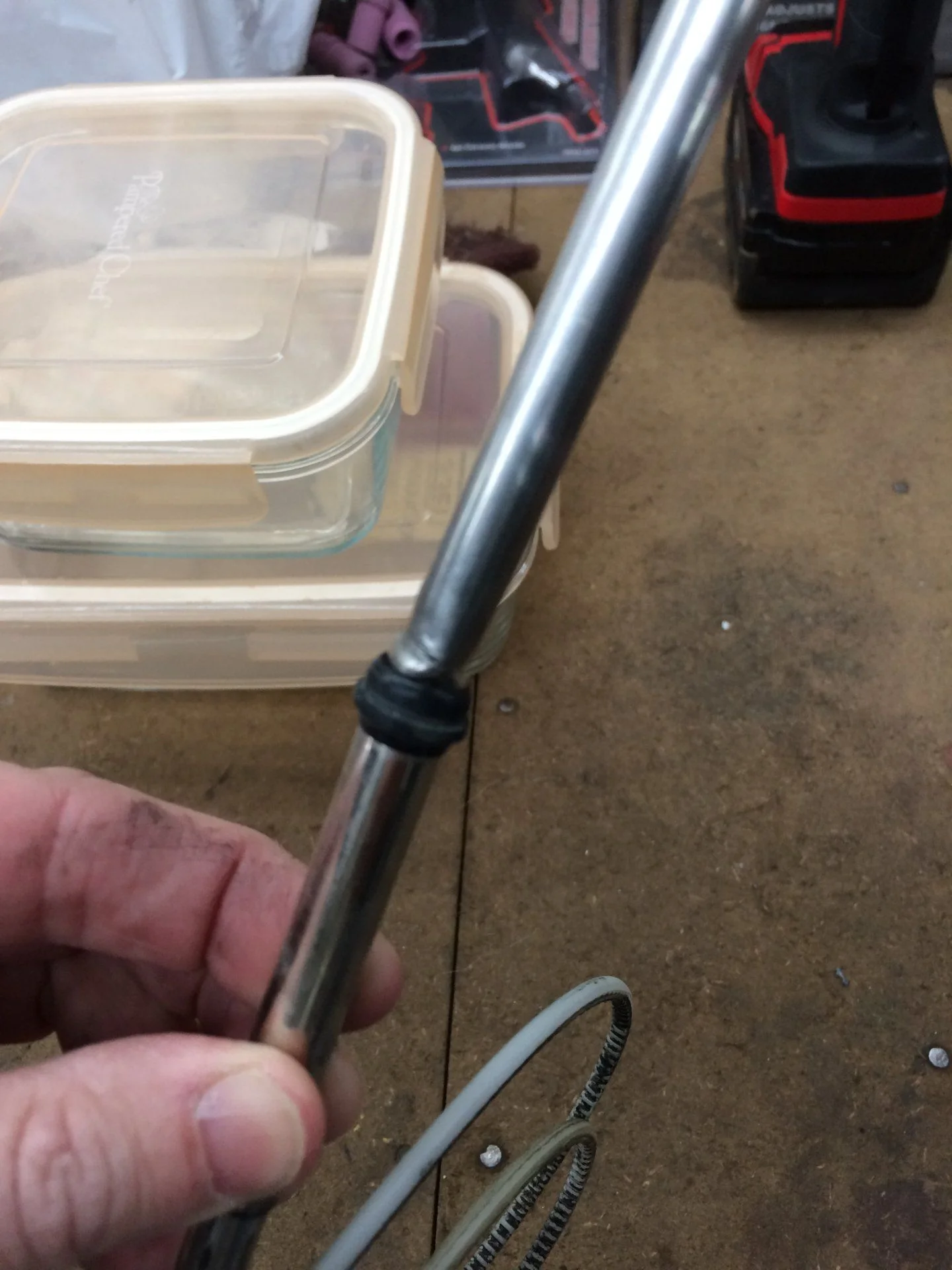

Olive can you please share the info that you got from the forum on replacement of the shaft?
Sure thing, although I don't remember exactly what the search was but it is so easy it won't matter.
1. undo the top nut on the antenna
2. have someone turn the ignition to the "on" position
3. turn the radio "on" this will raise the antenna
4. catch the antenna when it comes out
5. put the new mast in teeth forward until it bottoms out in the hole
6. have said friend turn the ignition to the "off" position. This will draw the antenna back into place.
7. put the nut back on.
*** Beer may or may not affect the time this takes***

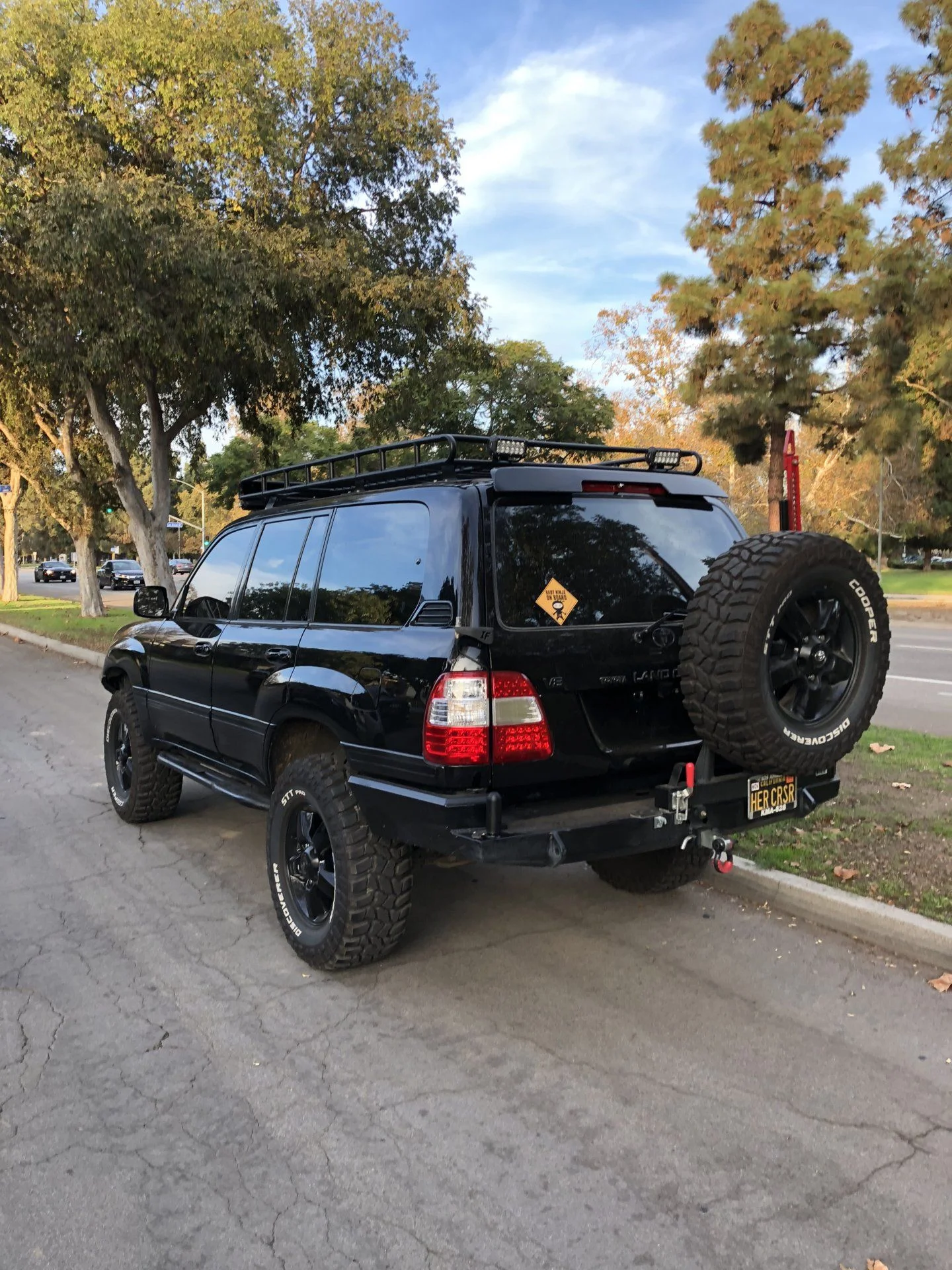

Removed my second swing out to allow for easier access to the back.... looks a little weird. Will take some getting used to.
So stoked to find your rig on here! I was driving home from Eldo and saw your truck parked. Pulled an abrupt U-turn just to come check it out. Keep it up and if you ever need a buddy to go wheeling with, hit me up!
Thanks Olive.
