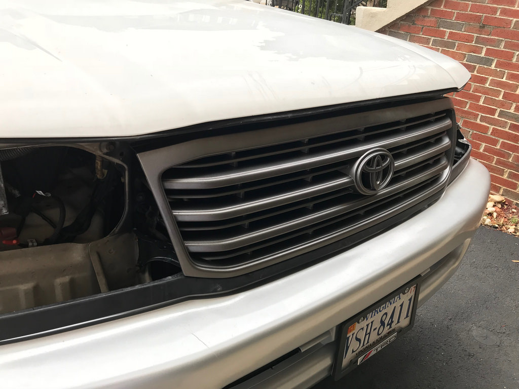

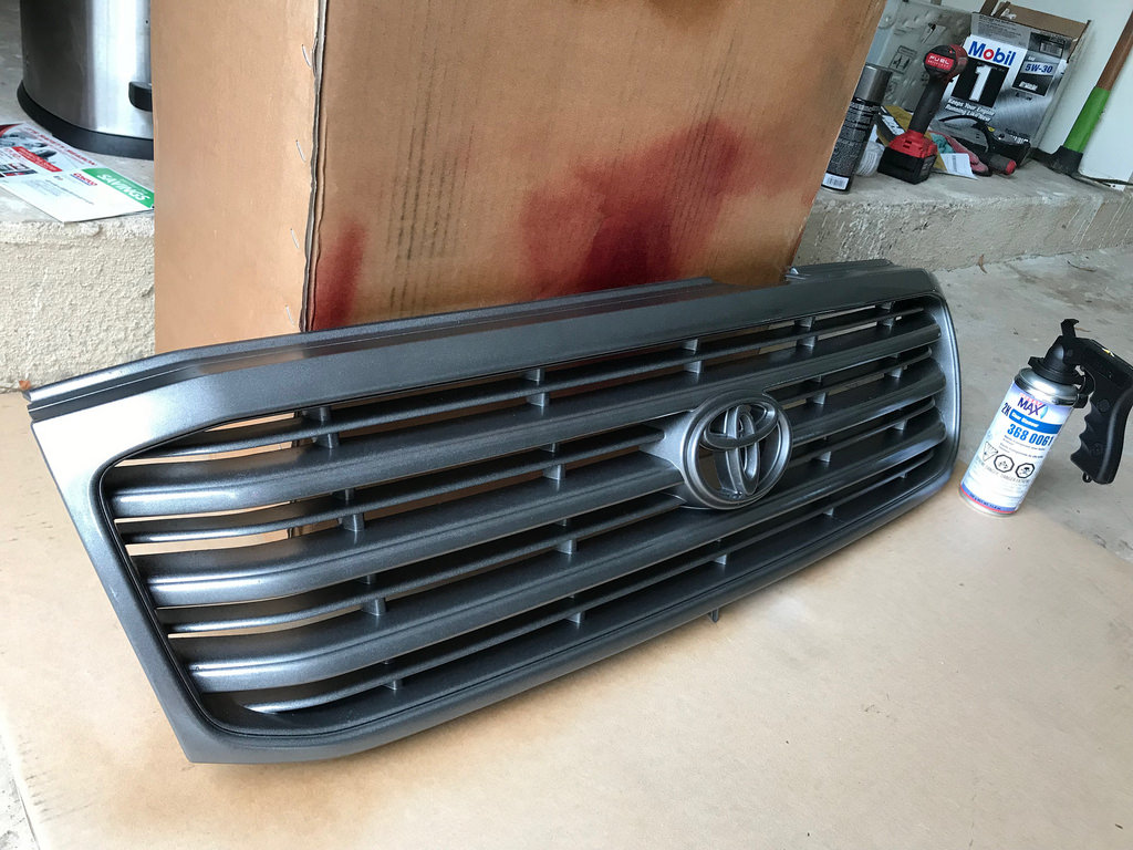

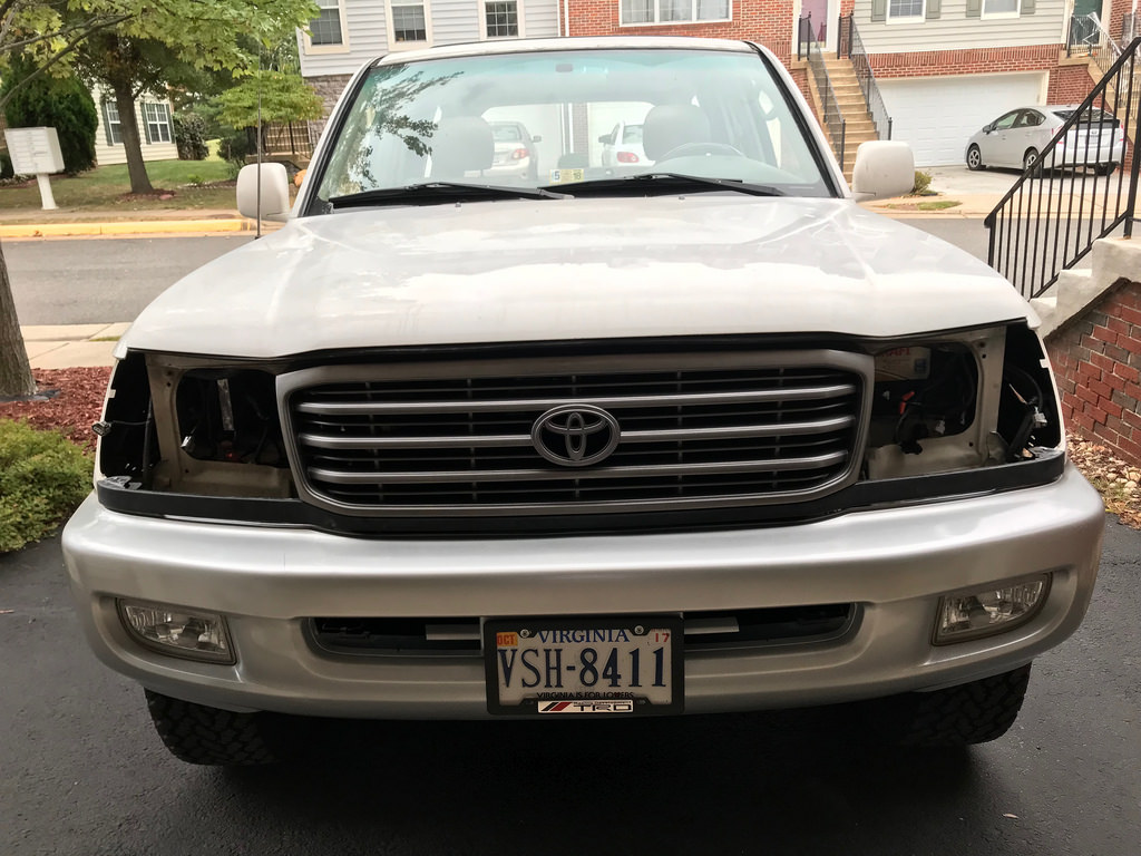

Painted the front grill, it was looking weathered and beat up from rock chips, also hated the chrome so i shot it in Graphite metallic wheel paint, and cleared it with a 2K Clear. This stuff is unbelievable, it's as close to autobody grade clear as you can get in a can. $22 a can though :(
