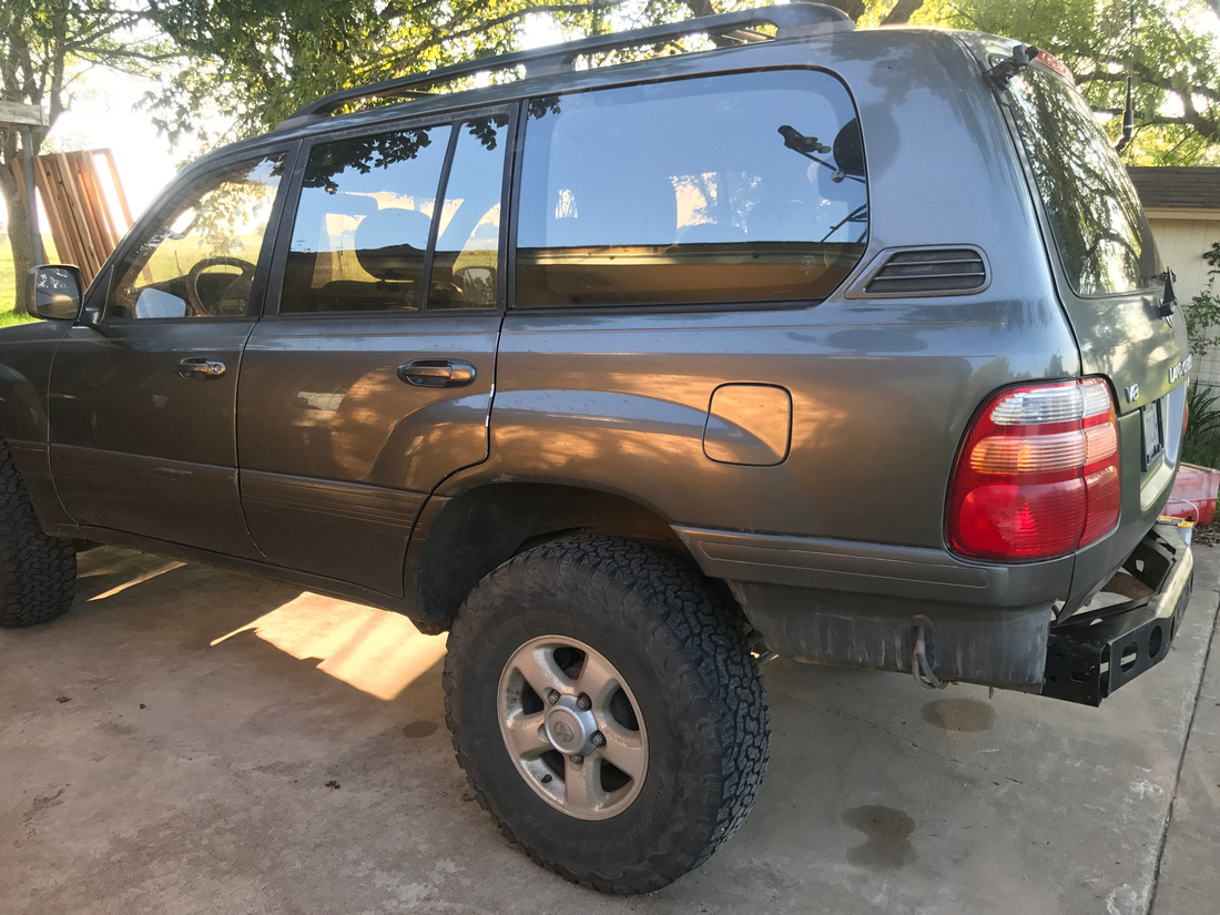

Today I made this pile of parts (installed Slee heavy rear springs and OME shocks) and I didn't mow my lawn :cool: I also pulled all of the spare tire mount hardware out
Next, I'm off to the Funny Car Nationals... diggin that rake flashback from the 70's... now where did I put those air shocks and traction bars? :smokin: eh... maybe not... The LC is a bit short on horsepower. Is there even a Funny Car category anymore?
I think I'm going to like the lift. It rides fine. Once the rear bumper and front lift is on it should get better.
I've got to go to town and pick up a 30mm socket and 20mm nut. Around here going to town is 120 mile round trip so that will eat up my morning. Hopefully I can get the front part of the lift kit (torsion bars, diff drop, UCA's, and shocks) on by tomorrow. If not... maybe the rear bumper.
That truck is obviously lifted, but is that bumper that lightweight? LOL, Looks like the front end went up a couple inches.

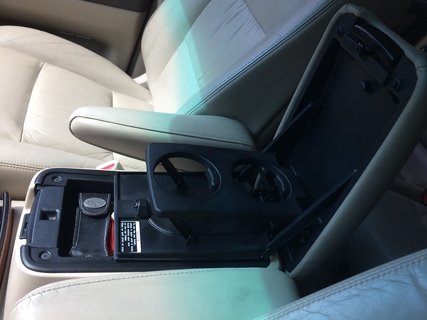

I've had a couple of really annoying squeaks/rattles inside my LC. One coming from the dash that I have spent a lot of time trying to isolate and lived with for months. Happened to put my arm on the center console while going over some bumps and the rattling stopped. Ended up being the extra cup holder thing under the lid. Just wasn't latched in quite right I guess. One problem solved.

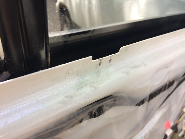

The other rattle was coming from the rear driver's side door panel. Removed it and put a thin film of grease where the clips go on the the inner door skin. Second problem solved.
Can't tell you how great it is to be rid of these rattles. Happy again. :)
OCD rattle chaser... My kind of guy.
