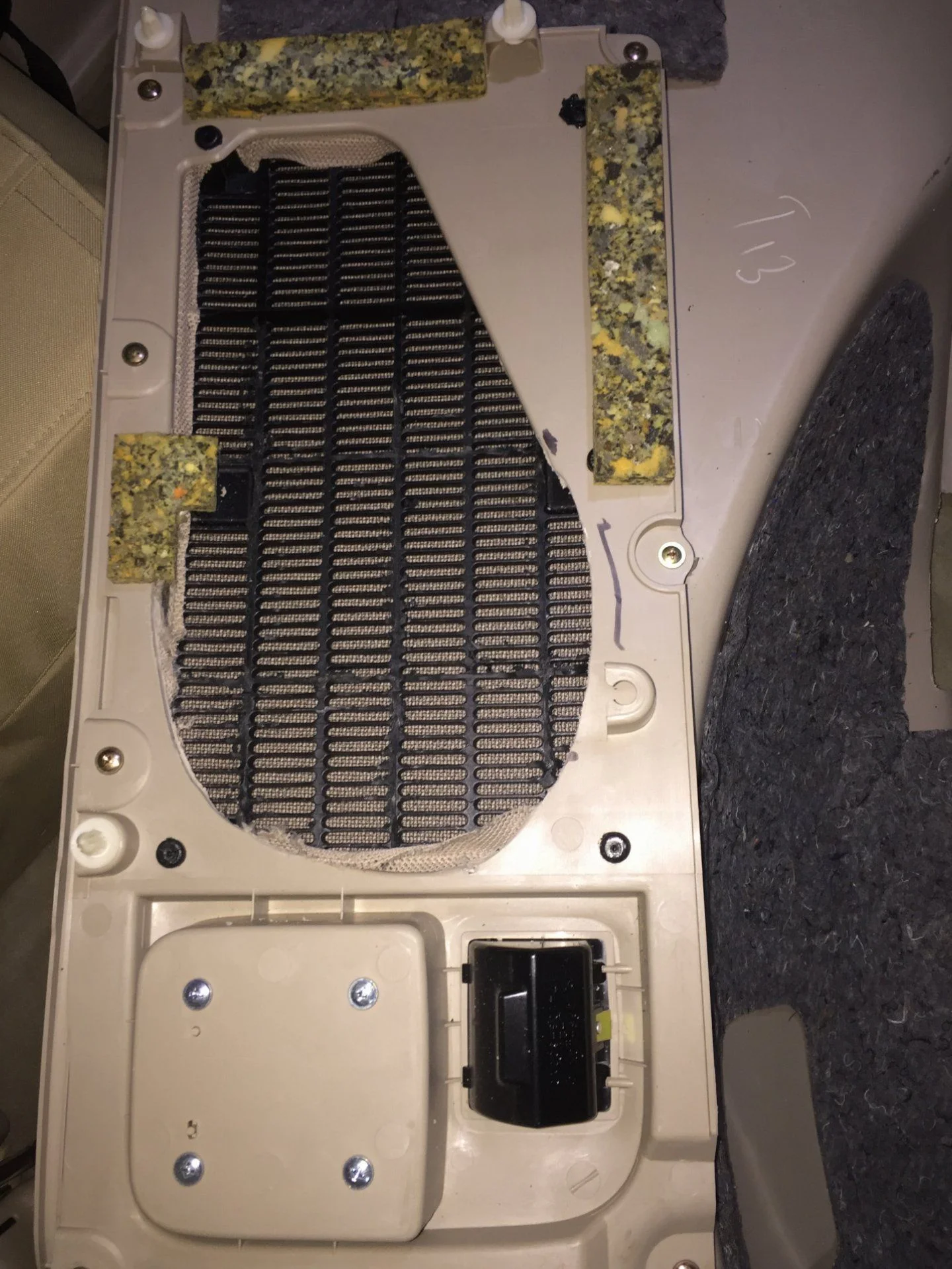

Replaced the zzzz...zzzz.....zzzz rear Sub last night with a Kicker CompRT (43CWRT672) $99. This is a shallow mount 6.75" 2ohm 150w rms speaker. Pretty much a direct fit, direct wire into the JBL box, new mounting holes required but self tapping screws help with that. Wiring is simple plug & play with the Kicker spring loaded connectors built into the speaker.
The new Sub clears the internal depth inside the box and the fits the opening, but the front sticks out about 1/4" further than the OEM sub. To correct I trimmed the fins off of the inside of the speaker grill and widened the speaker grill opening.
The body panels snapped back in place, not 100% perfect (I could have trimmed the grill opening a tad more) but good enough. The biggest pita was pulling the drawers back out to get the panel off. (should have fixed this prior to the drawer install)
Sound is quite good, but realistically anything would have been an improvement over the torn factory Sub.
