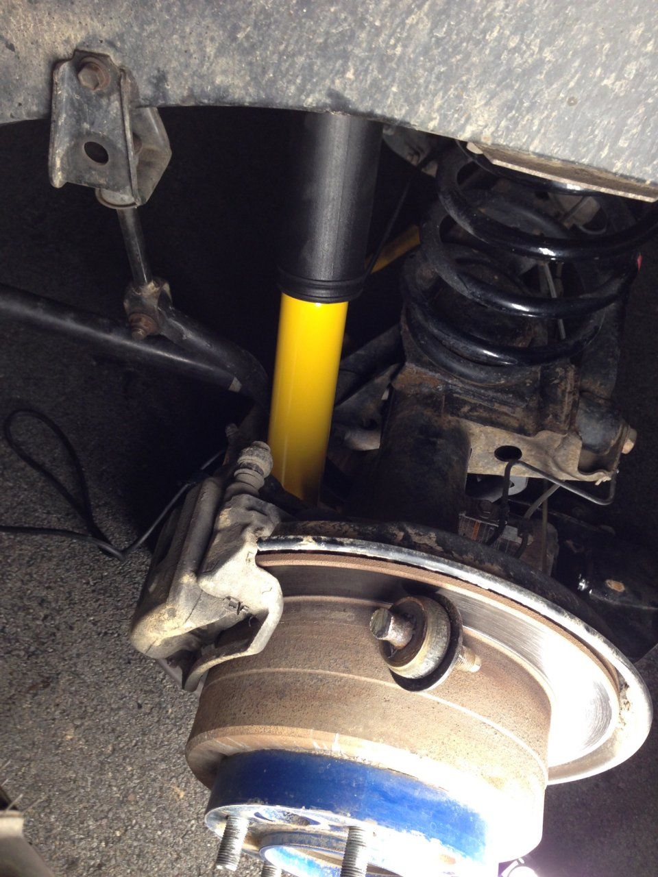

Do's
Do, learn from the others who have been kind enough to post how they took out their rear shocks
Do, cut them out with a sawzall
Do, remove the spare because sitting up is better than laying down on the job (the angle is way better too)
Do, stop and go to dinner when it's ready especially if the 1st shock is in
Do, chuckle that you got it done when the local mech tried and handed the keys back
Do, test drive and grab some ice cream
Don't, give up, the third time is the charm
Don't, stop when the 1st one is done just because it's been dark for an hour
Don't, cut at the top nut because 2/3 way thru it will pinch the blade and bend it
Don't, forget to tighten the bottom bolts just because the top nuts move "like butter"

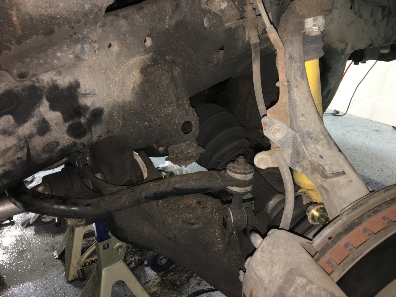

Over the last two weeks my husband ripped out my AHC and installed my Slee diff drop, OME springs, Total Chaos UCAs, and Fox 2.0 shocks while I wire wheeled and painted the frame and the splash guard. Got some help from my little one.
It looks amazing, but it drives even better. I am hoping I never have to get rid of these shocks and that they can eventually handle some weight.

Do read the thread on how to change your rear shocks in less than a hour using a hole saw.:grinpimp:
I need to replace or rebuild my steering rack, How much time did it take you ?
I'm sure you could do just the steering rack in a few hours. I replaced almost all the bushings and ball joints, both cv axles, steering rack, bearings, and degreased everything underneath. It was bad, took me a whole day to get all the grease and dirt off everything.
This thread and fsm helped out a lot: How To: Replace your own steering rack
1st cylinder exhaust flange on drivers side
2nd cylinder
1st one all cleaned up and ready to go back in. Took me almost seven hours to take it apart and get it back in. Three hours was spent just on fixing broken studs on exhaust manifold to y-pipe connection. Long day for minimal return, but no more crazy loud tick on cold start ups is priceless.
The ride is so much nicer. I do think I can objectively say that.
