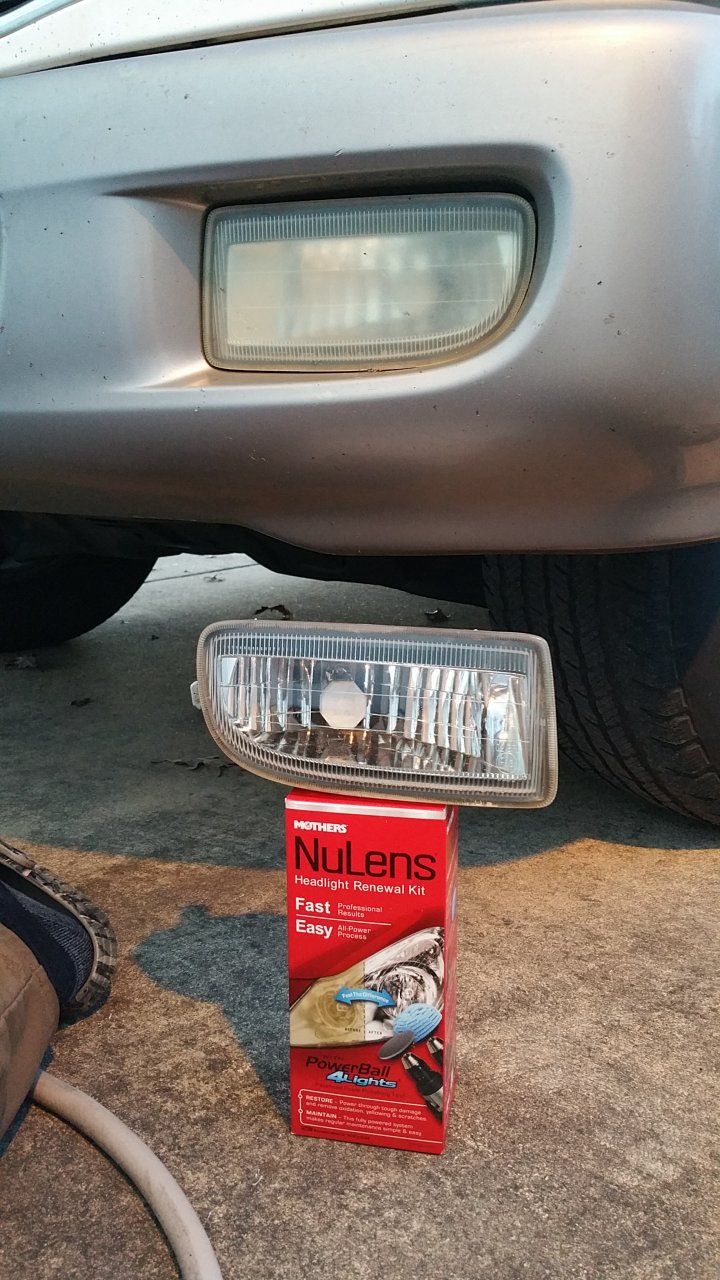

I took a gamble with a Mothers lens cleaning kit and for 28 bucks or so it worked great for me. Not new or perfect but the fogs I started with had 436K miles on them anyways so I figured what the heck! Of course the dream is t have a BB front or ARB eventually. But time will tell.

Wow, perfect solution. So you recommend that product given how cheap it was?
Yeah, and I mean with the mileage I have I just can't justify the 100 bucks or so on the eBay lens assemblies. Especially when my right headlight lens is pretty new and the left lens is original, lol...
I have a cheap drill that was plenty fast enough.
I will recommend you have some plastic clamps as I ended up clamping the light assemblies lightly to a wooden workbench/shelf in my shed. Made working the drill a lot easier.
I would NOT recommend trying it with the lenses in the bumper, there is no way you can get to the entire surface and not damage the bumper. Besides it's just one 10mm nut securing the assembly.
