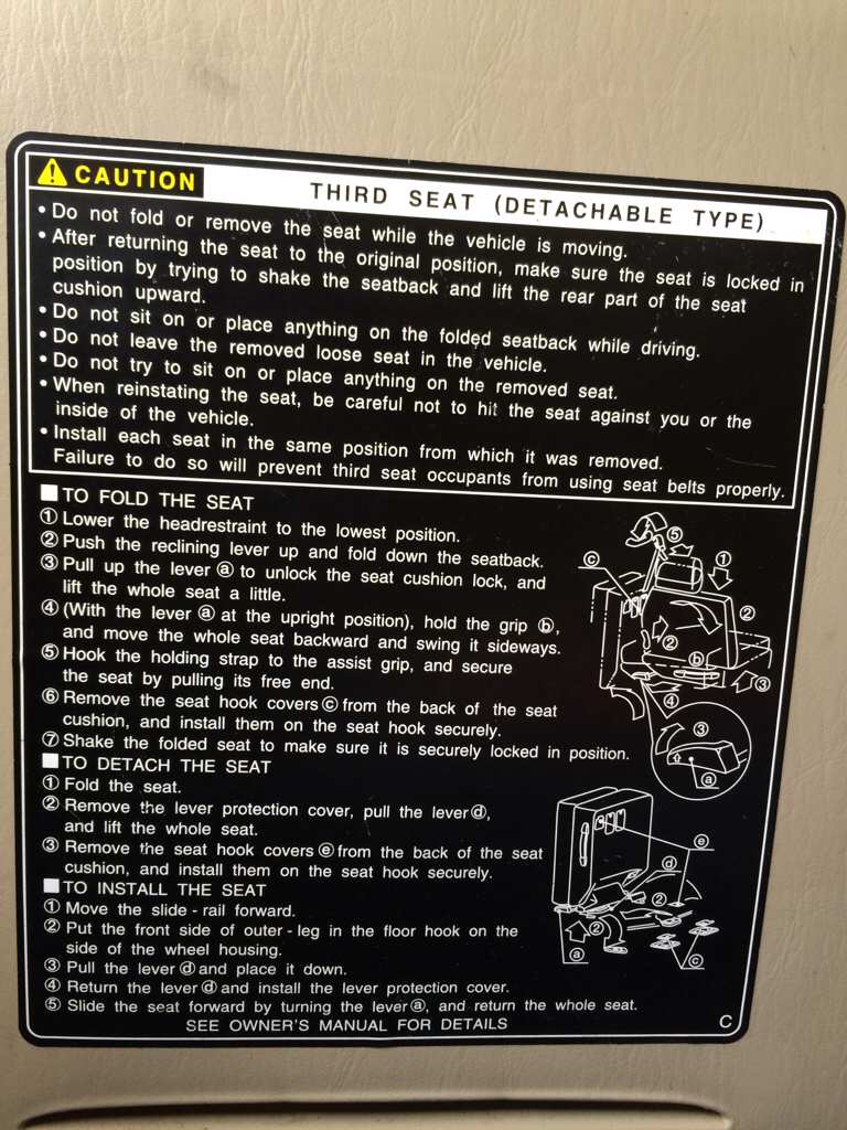

Hi all-
Did forum search and didn't find anything on this subject.
We are getting ready for a trip across country to Burning man, and went to remove the third row seats and I seem to have a broken latch "A", which is making releasing the catches impossible. Either the cable snapped, or i'm dealing with something else entirely.
Has anyone had this issue? Any way to work around it?
Thanks in advance.
If it's similar to the issue I have with mine, just use some pliers to grab the cable end and pull it towards you to open the jaws on the floor mounts. The plastic grab handle on mine no longer retains the cable so I have to do this everytime I move my seats.

You're likely missing the little black plastic rod retainers. Advance auto sells a rod clip assortment pack by Dorman. The black retainer in this kit works perfect for the 3rd row lever. You can also just put the rod in the little hole on the backside of the handle and get it to operate without the clips.
