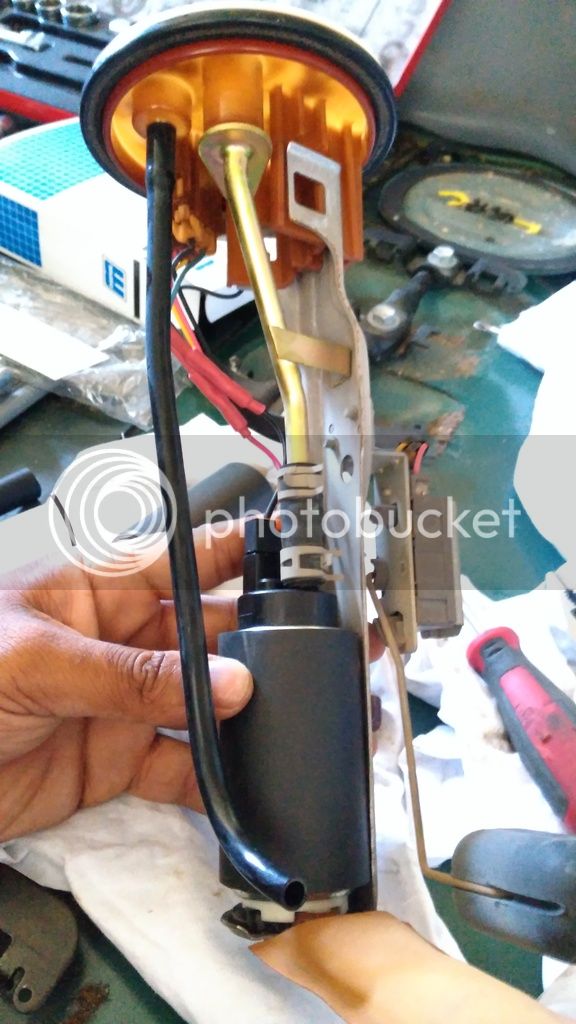

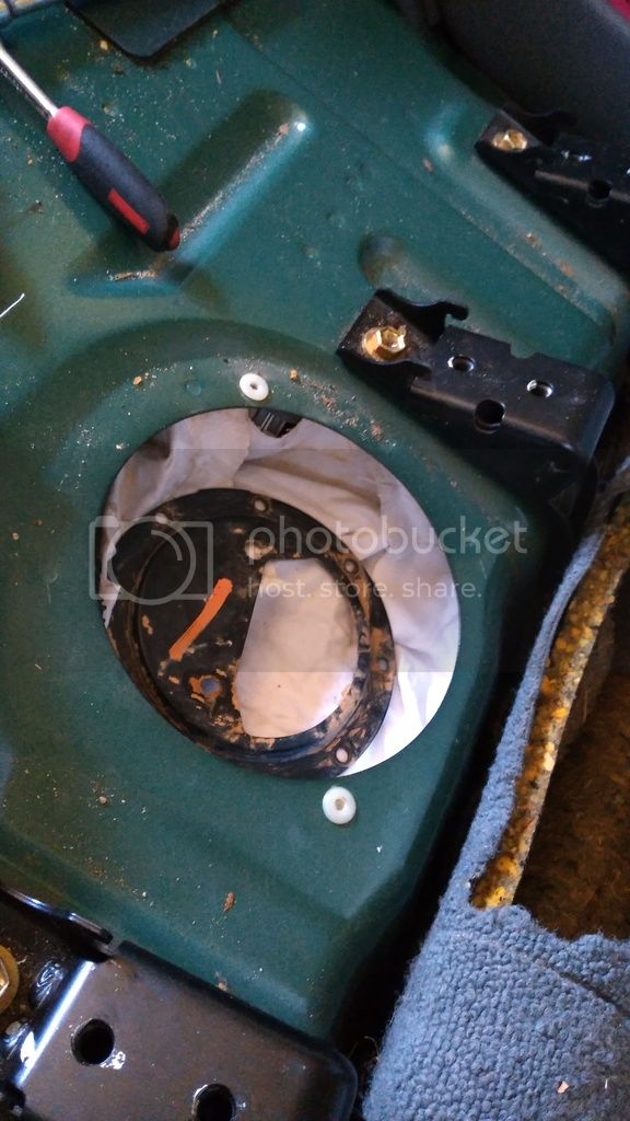

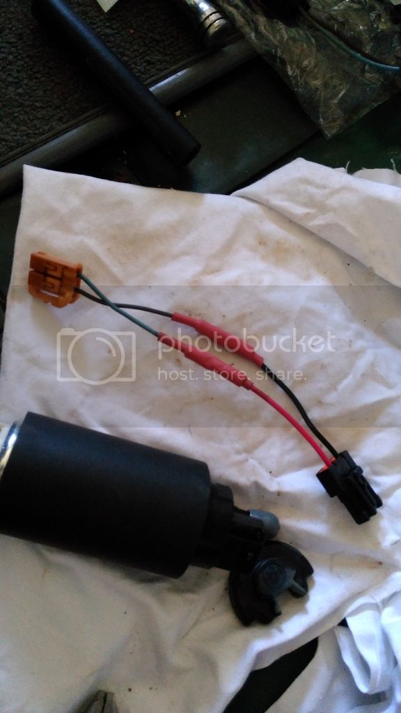

Installed Walbro 225 fuel pump to main tank. Still have sub tank to do. Also gapped my spark plugs (NGK BKR6EKB-11) properly as it was missing under boost. Gaps were huuuuuge, didn't check them before installing. Seems to be a lot better so far.
