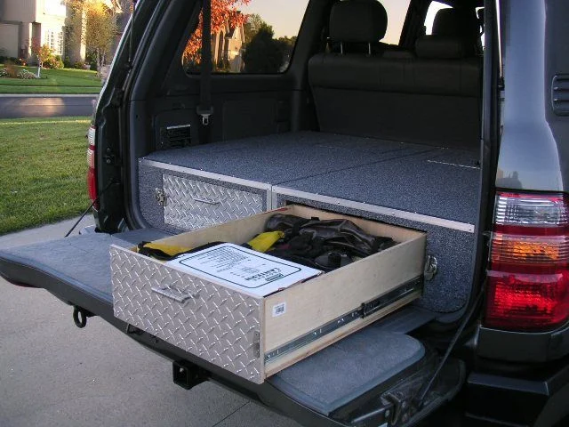

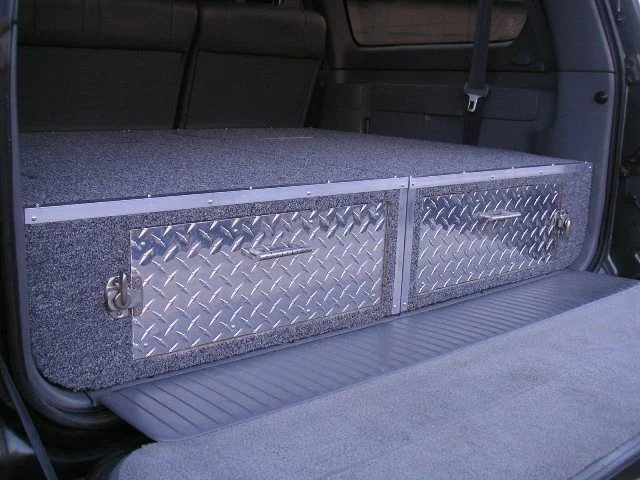

Well, I just finished up my rear storage drawer system for my 100. I built most of it out of 1/2" pine and the top out of 3/4" Pine to keep the weight down. I purchased the drawer runners, latches, handles, aluminum angle, etc. from Lowes and carpet from a local carpet store. I had a bunch of aluminum tread plate laying around and cut and used them for the face of the drawers.
I built the drawers so that I can take one side out and leave the other and still be able to put in one of the rear jump seats. I am using small u-bolts that attach to the latching system for the rear jump seats to hold the drawer system to the floor.

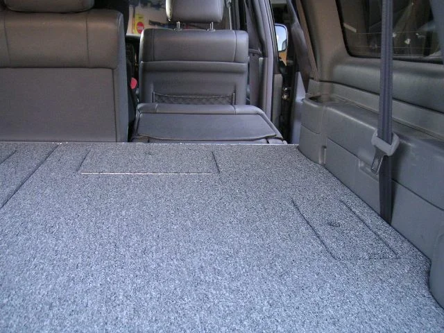

I built the drawers so that I can fold the rear seats down and place an air bed in the back and it makes a perfect platform for queen size bed.
The last picture is the back of the drawer system that is behind the rear seats.

Very, very nice. So the pop-out panels are to access space otherwise wasted behind/beide the drawers? Like where to stuff thing you don't need often but want to have (socket sets, jumper cables, etc.?). Nice. Two tiers of access based on need. Neat.

Yes the side pop out panels are to stuff anything you want in the empty space to the right and left of the drawers. I built hatches on hinges for larger storage that i can fit my tool bags, portable air pump and or things that I need to be able to get to without having to get out of my rig and open the tailgate.

I have a third child on the way so I will need the third row! Whats nice is that this design is module and i have the option to put both seats in, one seat in or no seats in!
