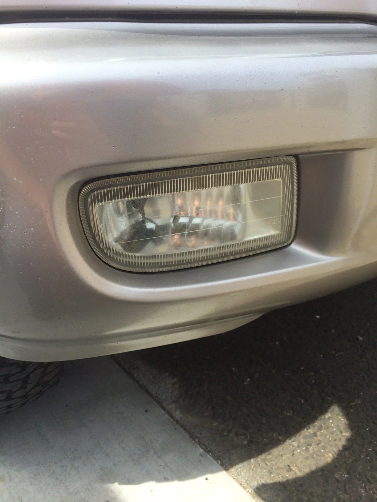

Took care of those old cloudy fog lights with a 3M product for $13 and put in some yellow bulbs for the epic fog around here. Also put in a K&N drop in.

^ how do you think the yellow bulbs are working?
I've been close to pulling the trigger on that one for a while.
Pretty nice. Major improvement over the ones that were in there. I like that its clear during the day and yellow when they are on vs that cheap film stuff.

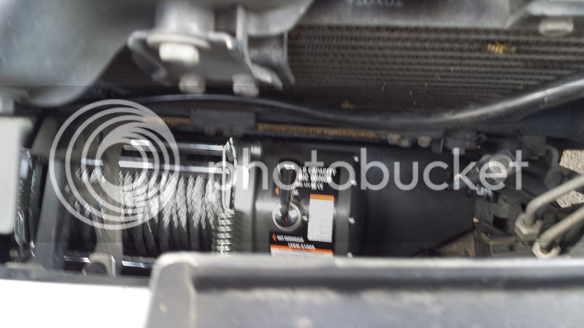

Put a winch behind the factory front bumper.
Now come on... you know you can't post a pic like that and leave us hanging. Well, unless that hornet was still alive... I mean, that'd explain the blurry pic, the lack of more pics... I'd have run too. ;)
I'm still working out how I'm going to make the hole (I love this truck so it needs to be nice) for the hawse in the front bumper, as soon as that's done I'll get some more pics up.

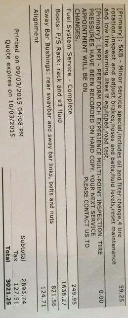

Had a reg maintenance service done yesterday. Service Rep recommended some "repairs". Check out the price on the Sway Bar repair!! They are trying to verify if it was a mistake...it better be, or the sway bar end links better be gold plated!!
The estimate didnt say, but maybe it includes replacing the sway bar itself? Not sure why they would need to do that though unless it is all rusted out.
Sway bars are cheap, as are all the components that go along with them: STABILIZER BAR for 2003 Toyota Land Cruiser|48805-60060
I think I remember replacing all the rubber and links for around $100 in parts, a Sat afternoon and a six pack.
Don't forget to order a few extra bolts. That one under the condensate drain gets really rusty.
Easy to do and doesn't require jacking or removing wheels. Just removing the plastic splash guard. Grease up the prop shafts while you're under there.
