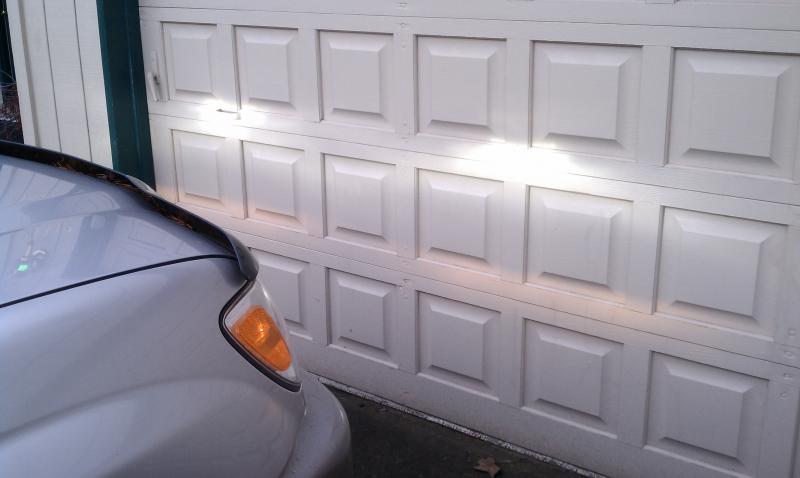

Switched over to 35w hid's. Not much light scatter and the pattern cut off is good.

How about a shot against a wall showing the output.
Which model infinitys? Did they drop right in?
Infinity 6032si. Minus clipping the metal around the bolt holes to fit the factory location, very simple install. The sound is better than the factory that they replaced, very good low and a crisp clear high (wife's description, she sings choir and has played classical music since childhood, so I'll trust her ear), mid range is solid.
Here's some pics in the daylight of the headlight pattern . I've also ordered some 20w cree's to install in the fog location and will show the pattern from those when they're installed.

Yes please. Want to see what the cut off really looks like.
PnP 55W HID Kit on 100 Series.

The cutoff is :meh: :meh: on a PnP kit, it will glare oncoming, it will have hotspots, and it actually makes the beam pattern narrower than standard halogens. It's not fair to compare a PnP kit to a bi-xenon retrofit with OEM components, however I would save the pennies and invest in a proper lighting solution. I ran HID's for two solid years and loved them, I've played both sides of the fight.
I'm just curious to see his "good" cutoff. I personally will never run hids in a reflector housing. If I run hids it's gonna be a retro or nothing.
