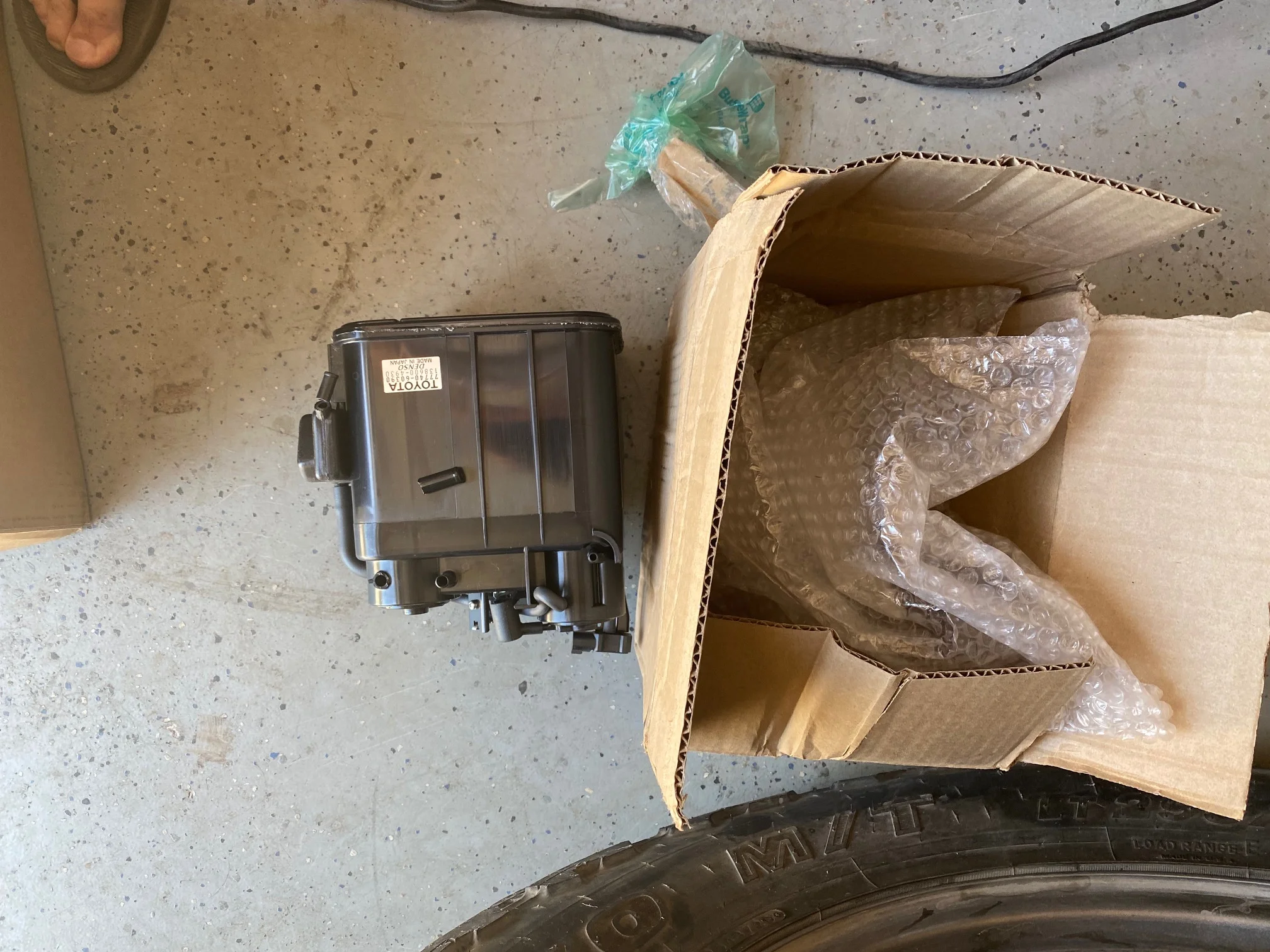

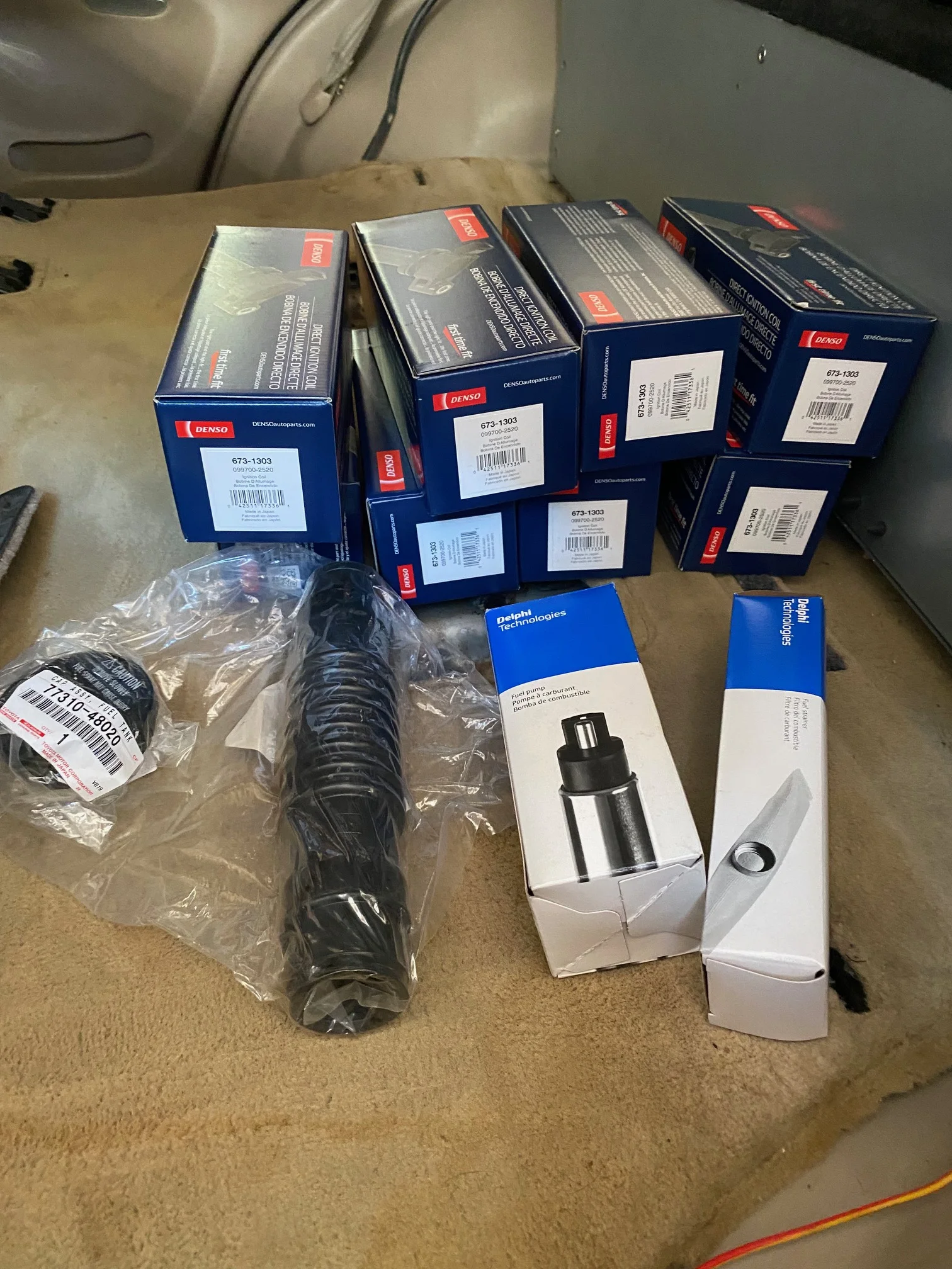

Went to Cruisers On The Rockies last week and ran into some issues at altitude. I could not fill my gas tank without it clicking off constantly, my fuel tank was building up pressure, and fuel was spilling out. Also lost a coil pack on the way home. Once I got home, I hit Rockauto and PartSouq and ordered a bunch of parts. New Denso coils and spark plugs, new fuel pump and strainer, new fuel filter, vapor canister, and Vapor valve. The Vapor canister came with a broken barb so waiting on a replacement. While I was at it, I replaced the gas cap and the rubber hose between the filler hard line and gas tank. It was really obstructed by what looks like the inner liner of the hose. Hopefully this will fix my issues for next year!

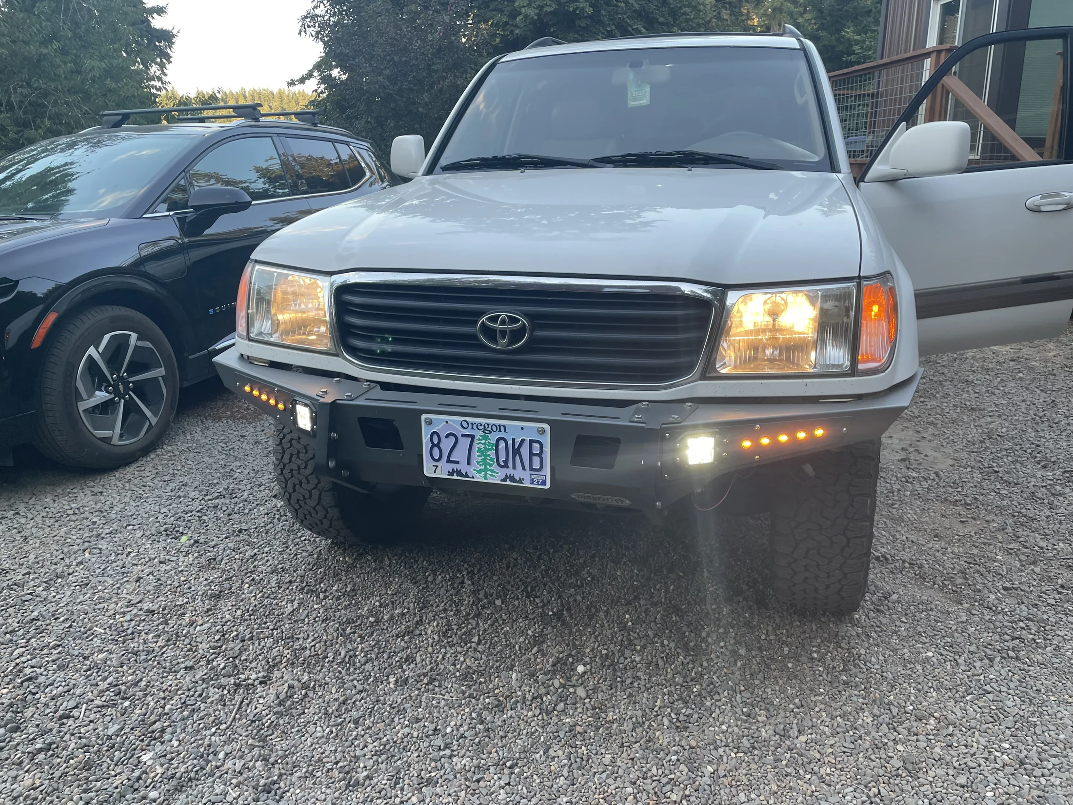

I hooked up my front bumper lights, the little square ones (Rigid D series). Punching through the DS wiring harness grommet wasn’t easy (that thing is tough — not sure what tool I’d recommend, but I cut some tiny slits and pulled out bits of grommet material with pliers — I’m sure there’s a better way). Anyway, they’re bright, and it looks nice!

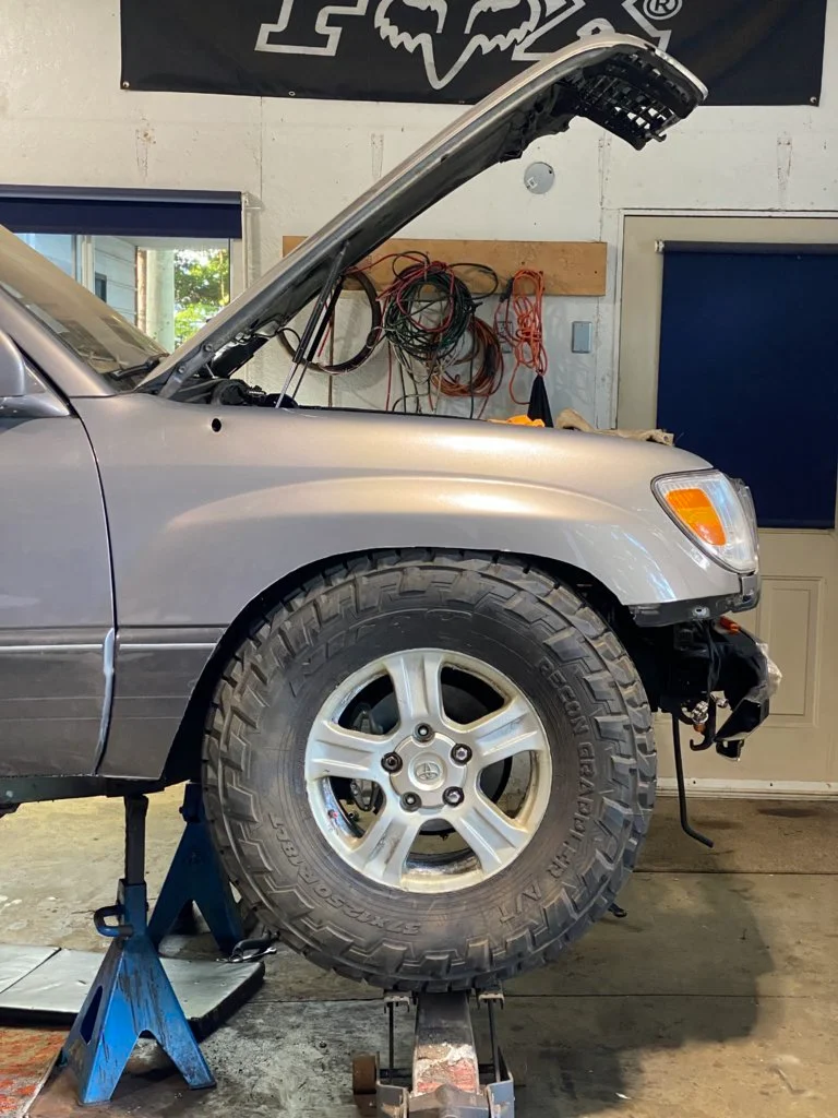

I finally got the engine out, I got held up on trying to remove the harness but the A/C compressor was in a tight spot and I can't pull the harness. I ended up disconnecting it from the ECU.
Drove it off the lift for the first time.

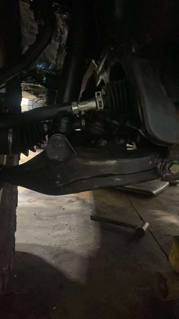

FWIW, and just my 2 cents, I've complained for the longest time about how absolutely horribly stiff the front end suspension was on my 100 with the 2" Ironamn lift was so a few days ago I decided to take off my sway bar end links but keep the sway bar in place.
I cant believe how much the driving comfort has increased, it's like transitioning from driving a freight train to being on a cloud. I live in the PNW so there's mountains, hills and sharp curves everywhere. I could immediately tell the difference leaving the driveway.
To put it to the test, I went camping at a dispersed lake up in the mountains this past weekend and the entire trail there is rutted with pot holes and i'm always having to air down for comfort or taking it extremely slow. With the sway bar delete, I felt like I was already aired down and riding in comfort. If it wasn't for the fact I had Trail Tailor extend sway bar end links, I would have chucked these in the trash and never looked back.
Might be a "late to the party" fix, and probably not for everyone depending on their use but just wanted to share my feedback. The slight difference I feel now taking turns sharply can never take away from how much more comfort I have now.
