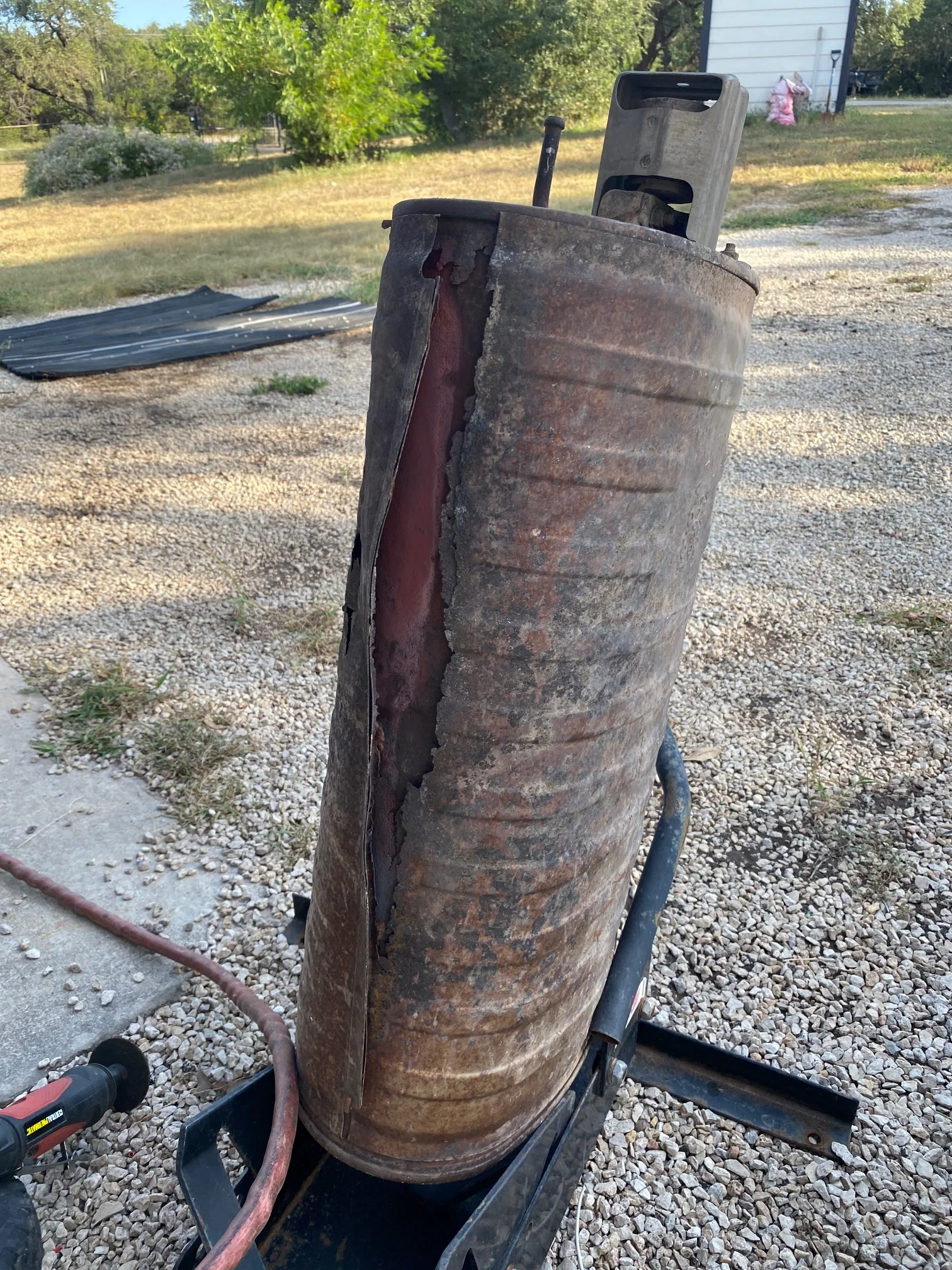

Cut out the exploded muffler and welded in a replacement. It is a DynoMax 17748 that has been recommended in a few threads on here. Welding on your back with little access is a real pain. It's hard to get a good bead with slag raining down on your neck and running down your shirt.

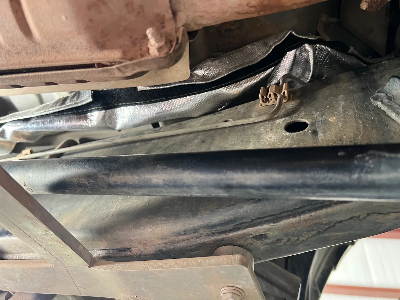

On a side note, has anybody wrapped their muffler with heat shield? It gets so hot under there that one of the body mount hole caps completely melted.

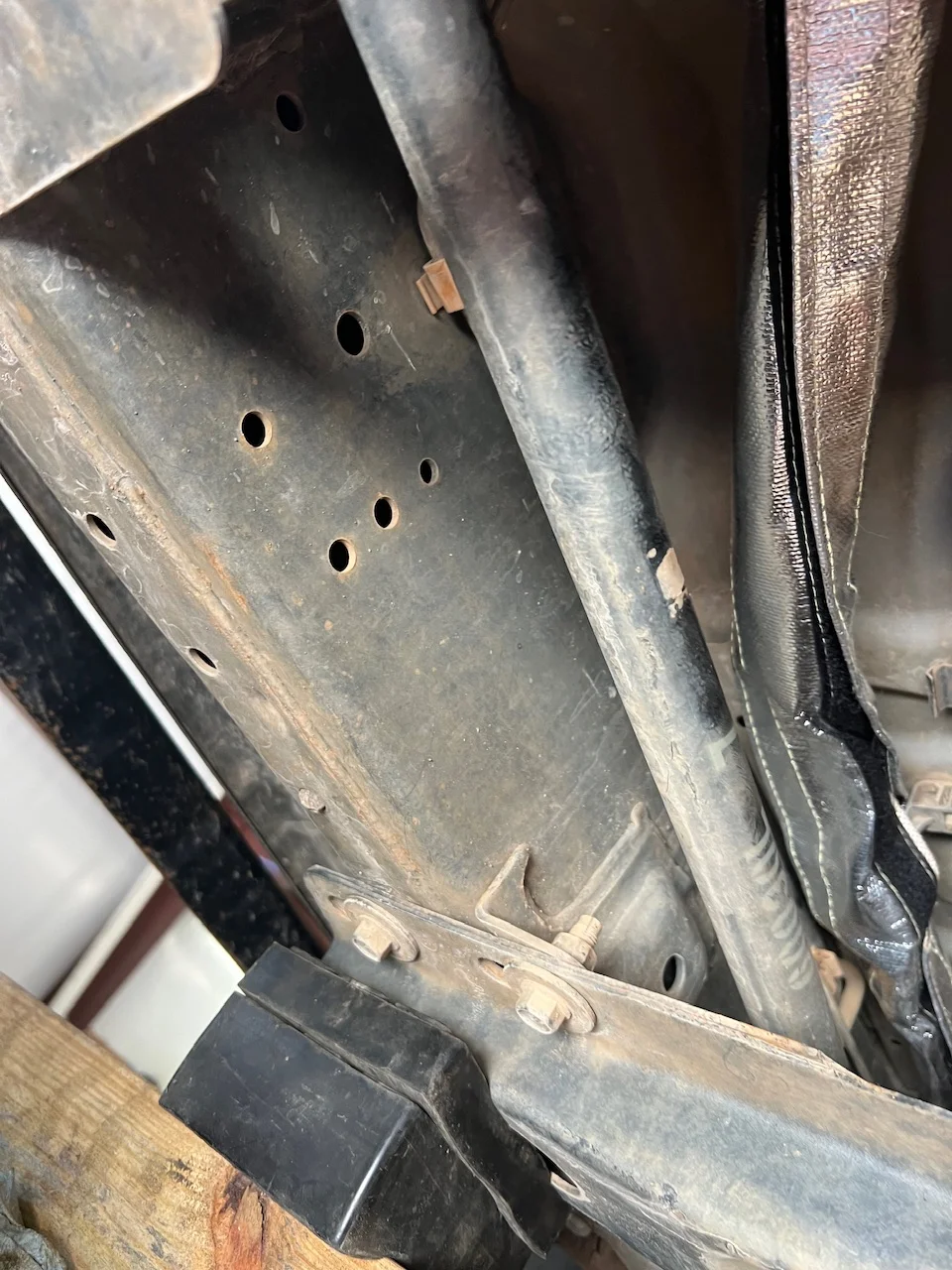

I’m a few days behind catching up on posts, so someone may have already offered this, but I solved this issue by insulating the fuel tank near the exhaust with adhesive reflective insulation, and wrapping the fuel lines with reflective insulation as well.
What product did you use? Did you apply it directly to the fuel tank or the tank skid? Thanks
