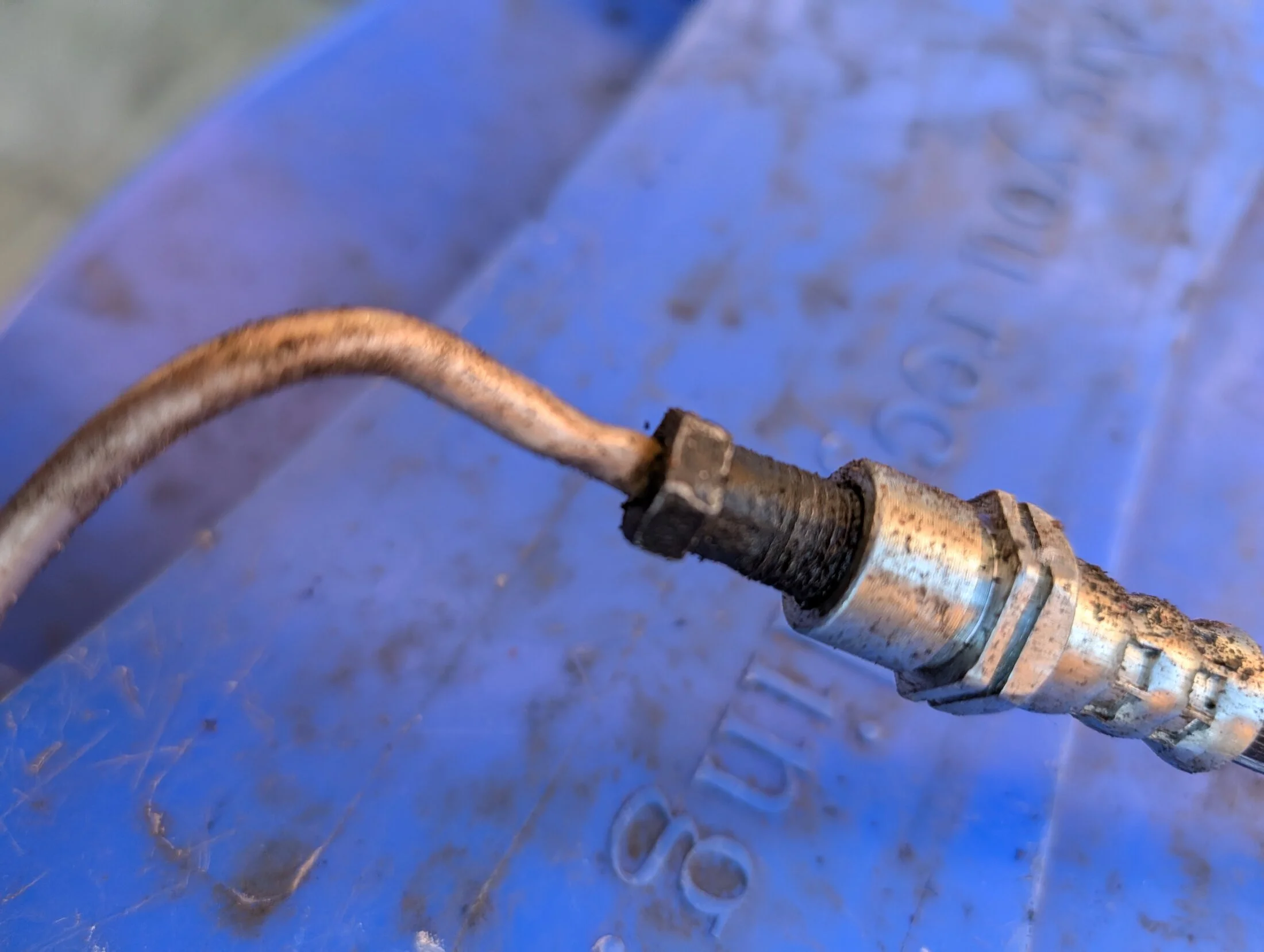

Changing out the rear flexible brake lines today, the top on on the centre line twisted the hard line.... Bugger.
Time for a new brake line, add that to the list of never ending jobs

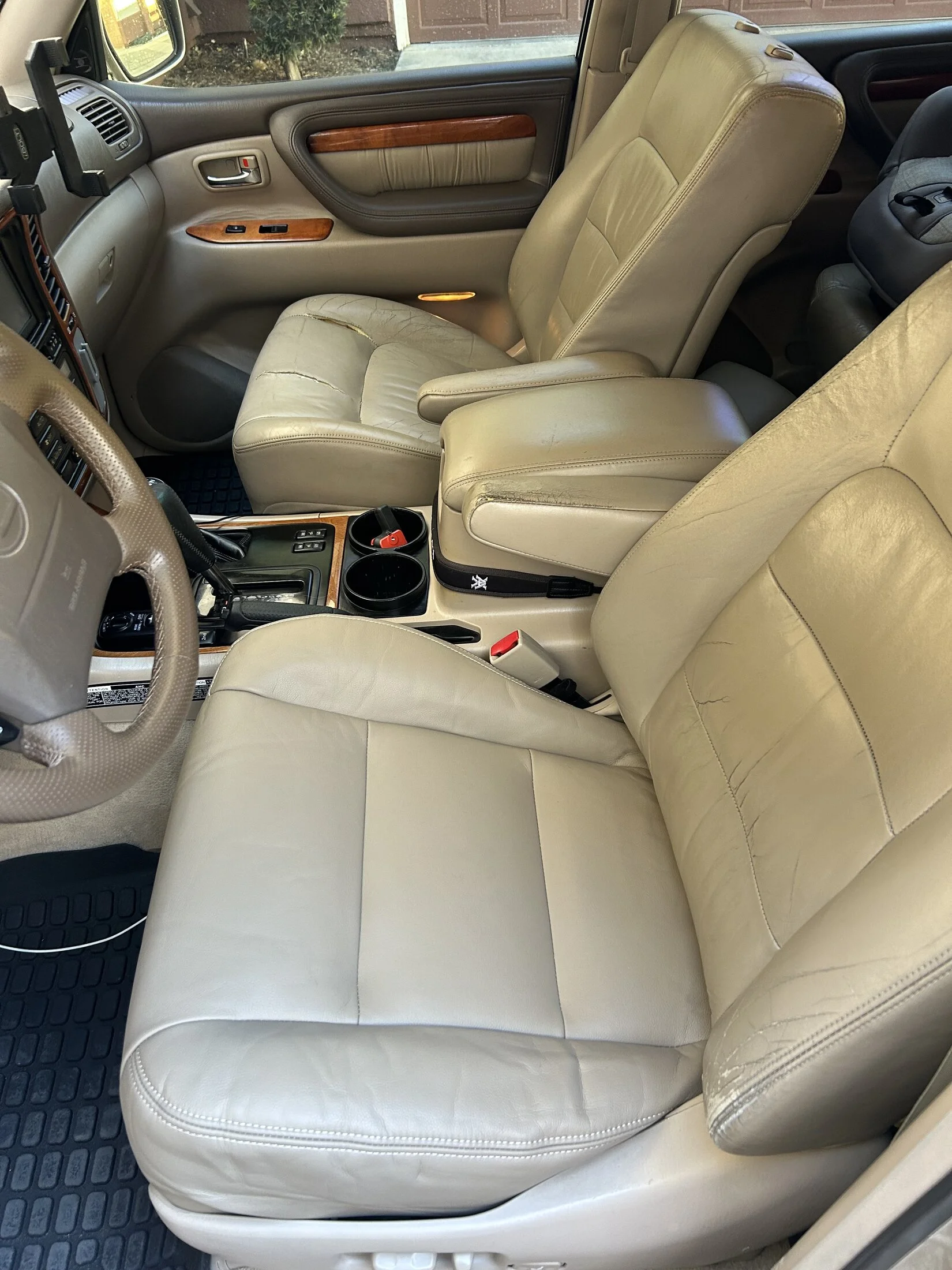

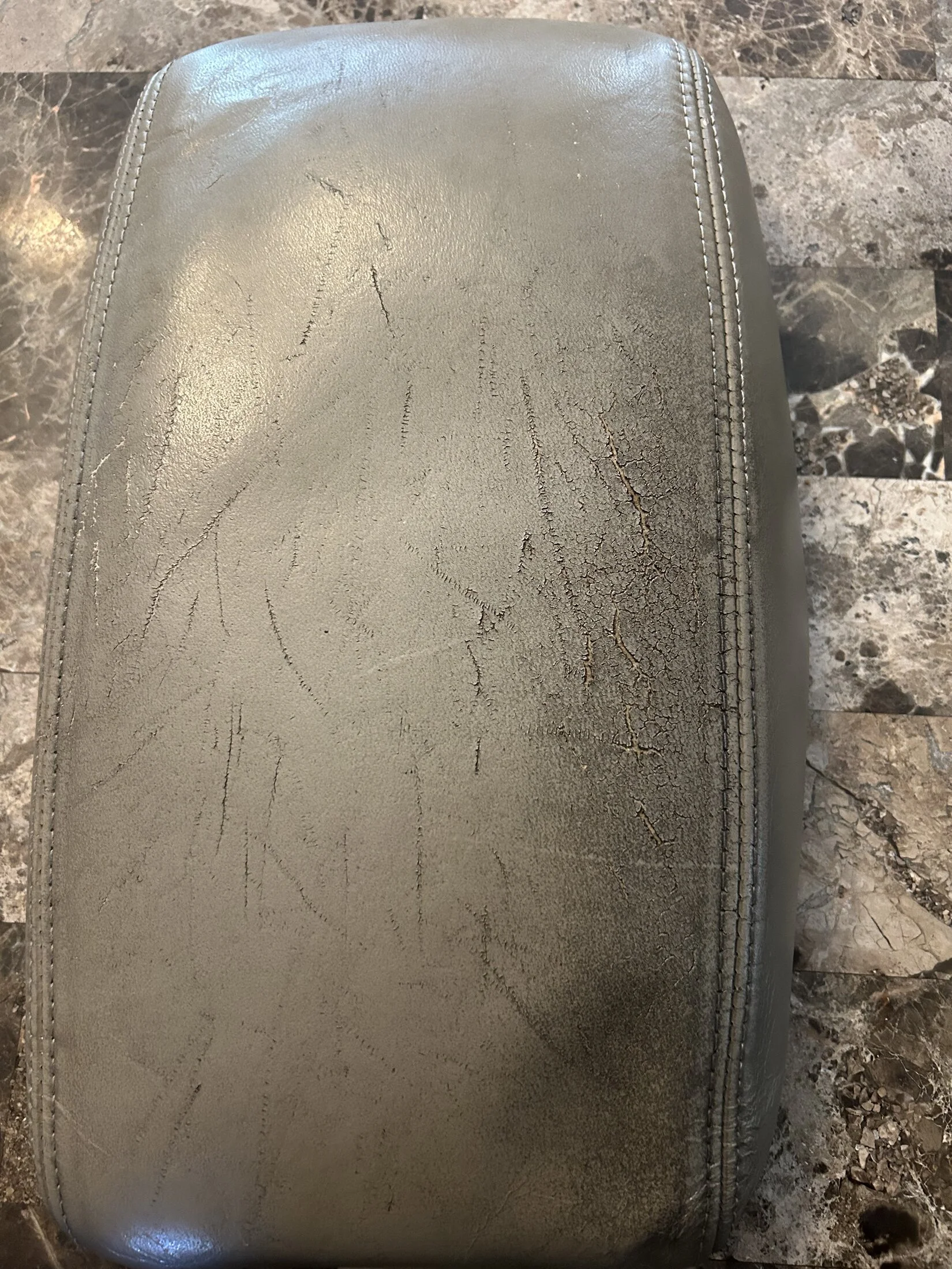

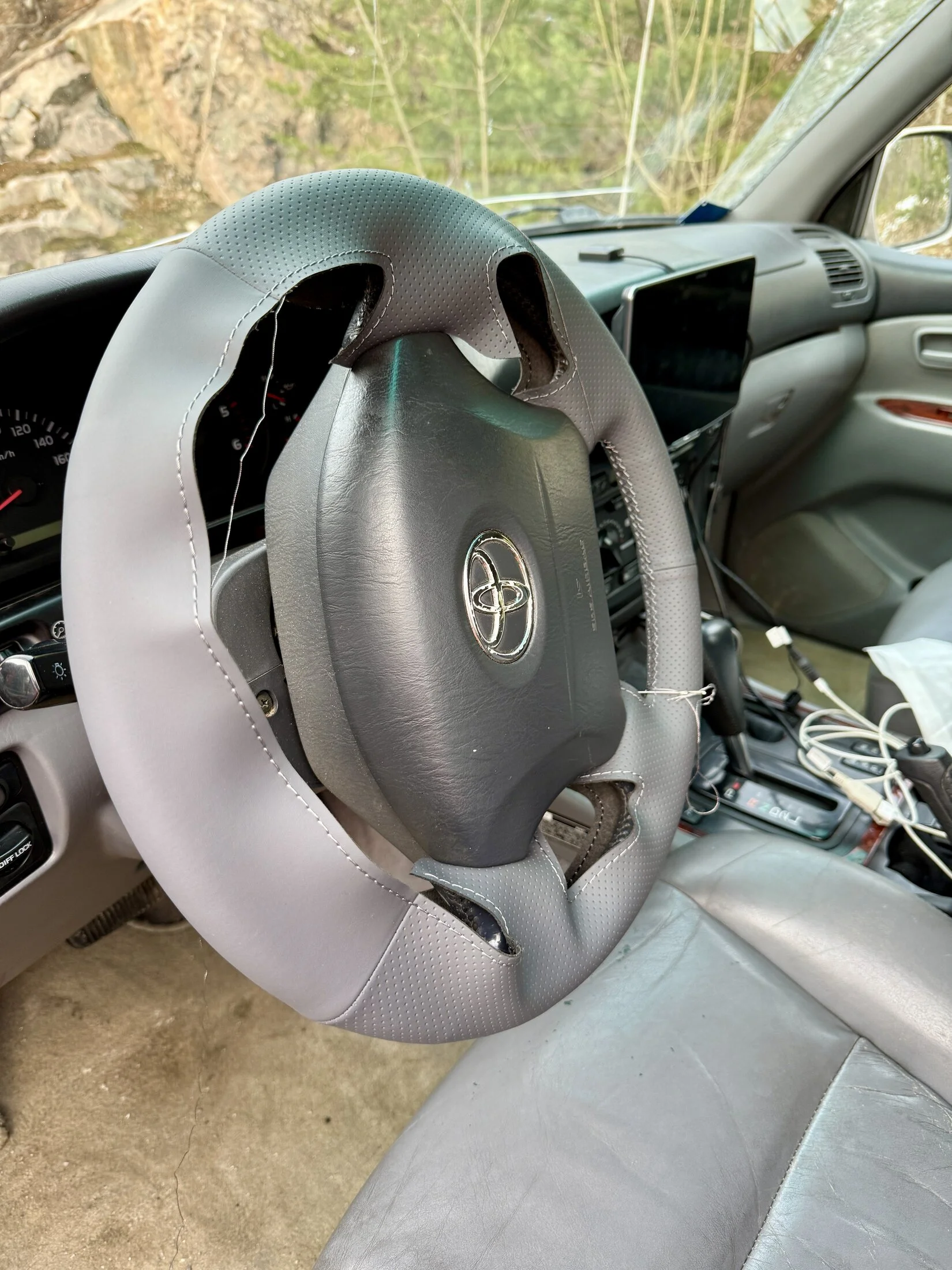

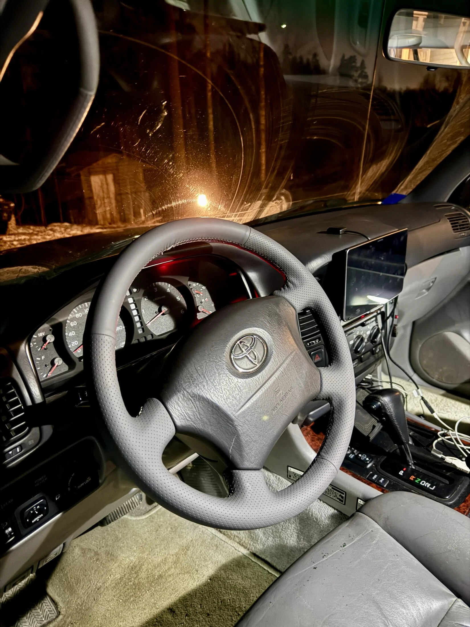

That looks like a nice match. What did the one seat set you back?
FWIW I spent $30 from EBay and replaced mine. It’s not high quality leather but it looks pretty good. If I have to replace it in a few years I won’t be mad.
that looks great, i wonder if i can convince the wife to have a go?
I did mine too (see the photo above) with the Loncky supplier on Amazon. It’s really not that hard, just tedious. Pulling the steering wheel helped tremendously. I say spend the $60 and ask the wife once it arrives :)

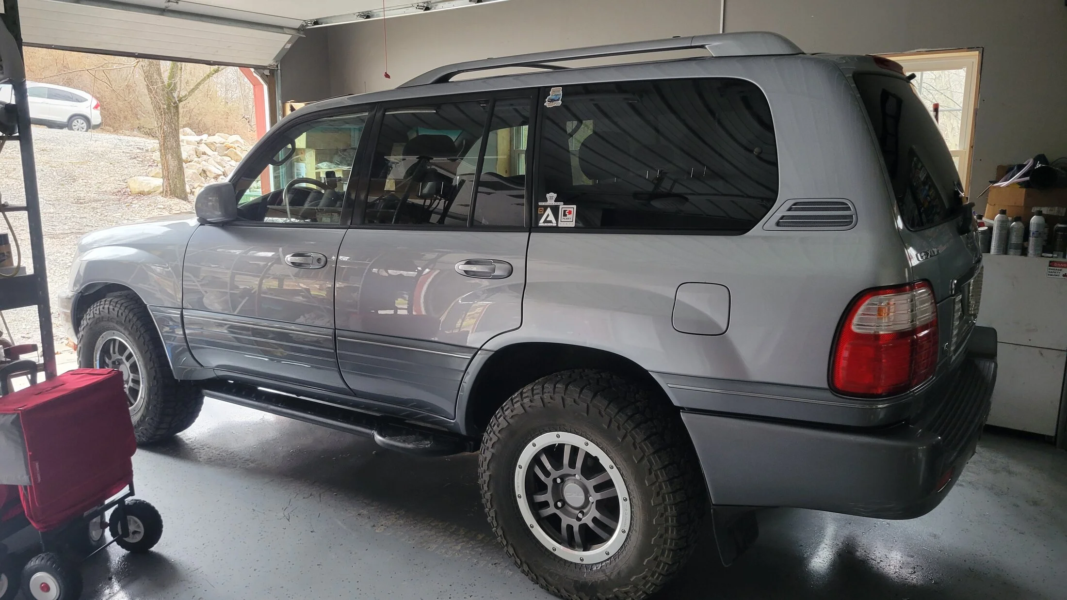

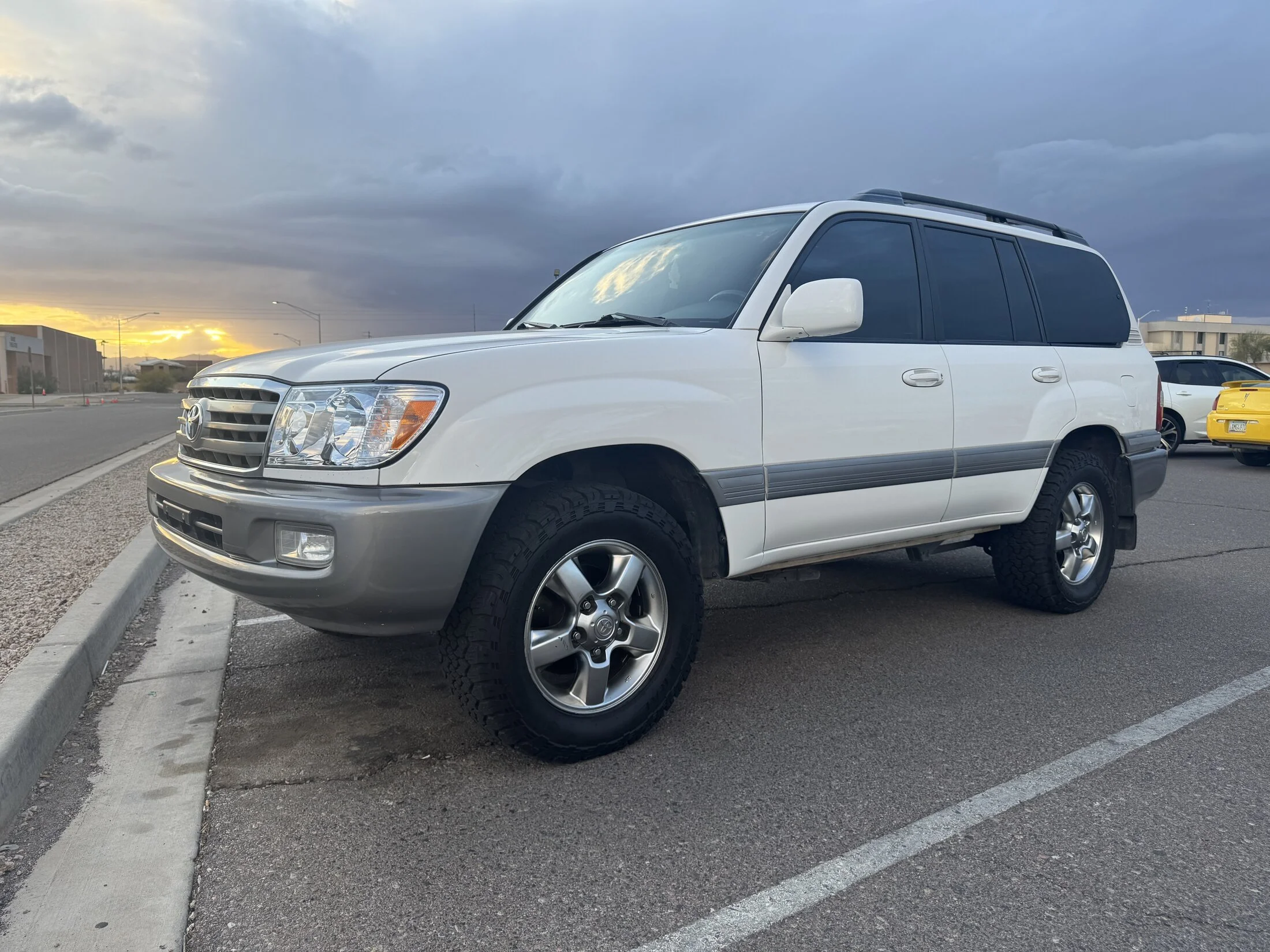

Lazarus got a much needed (and deserved!) spa treatment this weekend.
Wash, iron decontamination, clay bar, compounded, polished, and finished with a ceramic spray. So shiny!
Definitely the cleanest/nicest looking this vehicle has been ever since I've owned it/brought it back to life.
I just did the same for my white ‘06. It had pretty good sun fade, but came back with the Meguiar’s three part paint correction (compound, polish & wax) via DA polisher.

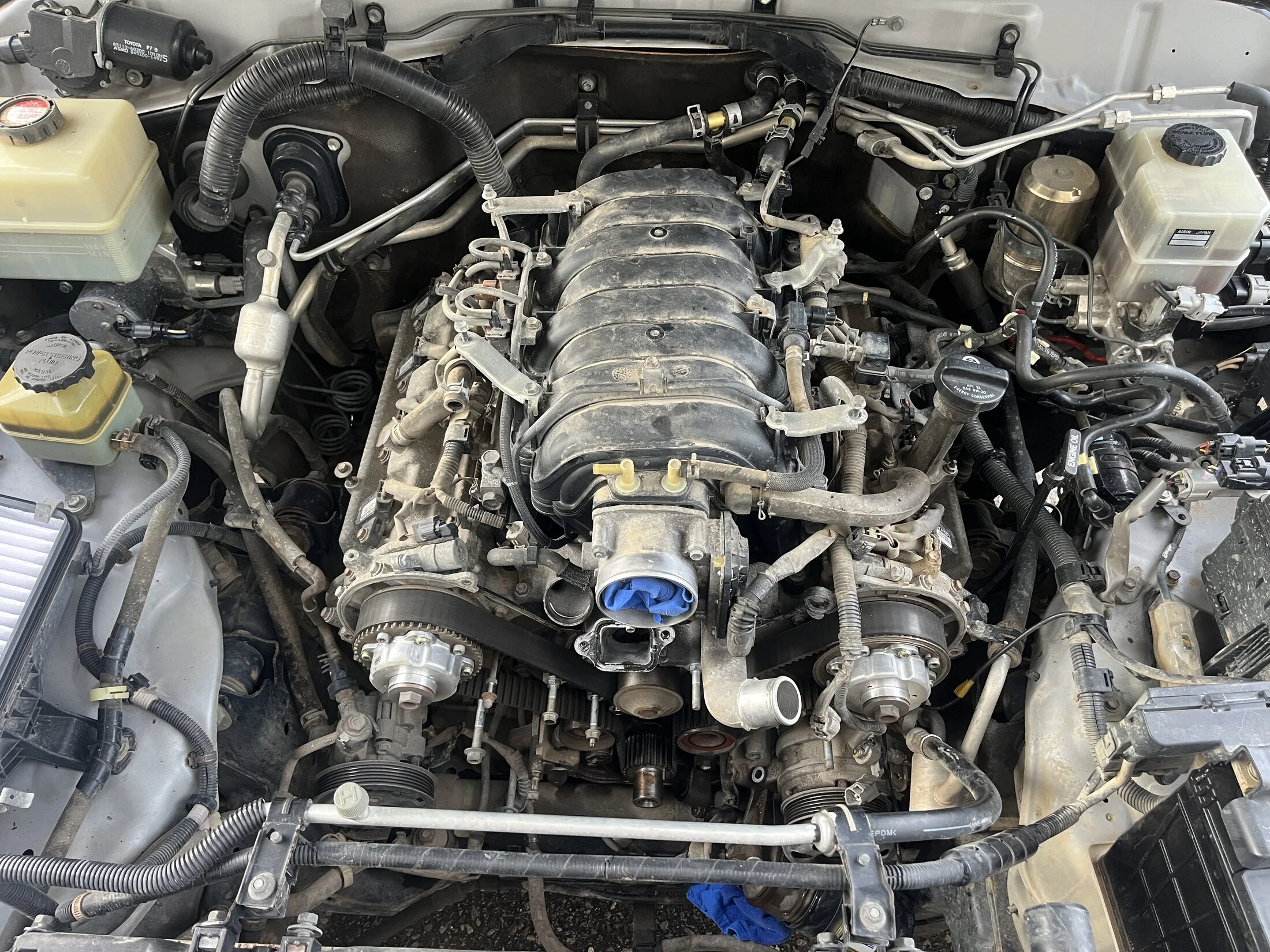

Day one- Tore down my engine to the timing belt. Swapped out the heater T's (96k miles, still solid) for 80 series brass T's and replaced the spark plugs. Plugs 6 and 4 weren't exactly tight and number 5 was actually very loose and the coil is discolored. I'll keep an eye on it and pack a spare. I'm glad I caught it when I did and I'll be checking plug torque again well before the next timing belt.
Even though this is my 3rd timing belt job I found the LC much more challenging to work on. Tundra/Sequoia is a breeze by comparison.

Glad you caught it!

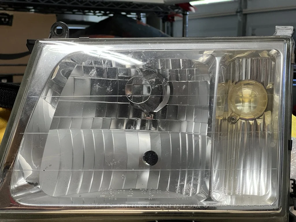

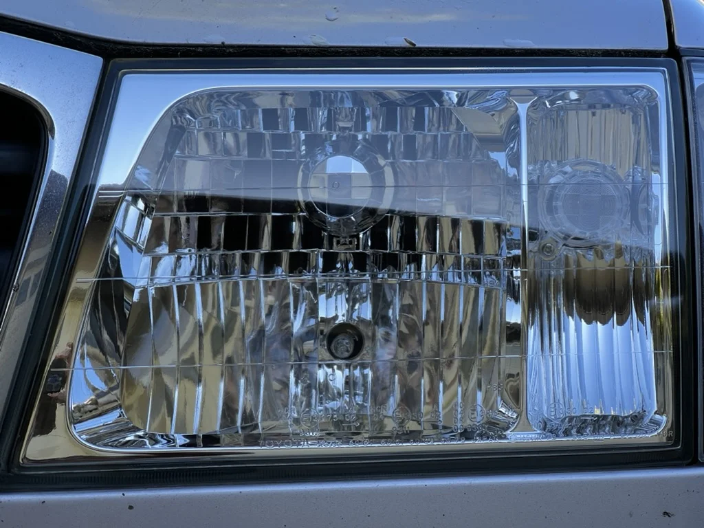

1999 LC100: I did the same. I replaced both the left and right headlight assemblies (right hand: 81019-60072, left hand: 81059-60072). Notice the difference in the reflectors: Daniel said I needed to check to see if the reflectors had dulled before bothering putting HIR/HIR2 bulbs in. I can say that the new assemblies made a world of difference along with the bulbs.

What bulb did you go with?

Where’d you source your headlights from? I was in the same boat and ended up replacing my tired old headlights with a slightly used eBay set. Daniel hooked me up with bulbs as well. They made a huge difference in nighttime visibility.

I got them through the local Toyota dealership in Walnut Creek, CA. They came to $235.16 each with free shipping. Unit Sub-Assy, Headlamp W/Clearance, LH from $209.83 | Toyota OEM parts 81059-60072 | Cruisin4Parts.com - https://cruisin4parts.com/oem-parts/toyota/81059-60072 and Unit Sub-Assy, Headlamp W/Clearance, RH from $197.89 | Toyota OEM parts 81019-60072 | Cruisin4Parts.com - https://cruisin4parts.com/oem-parts/toyota/81019-60072 both show availability.
