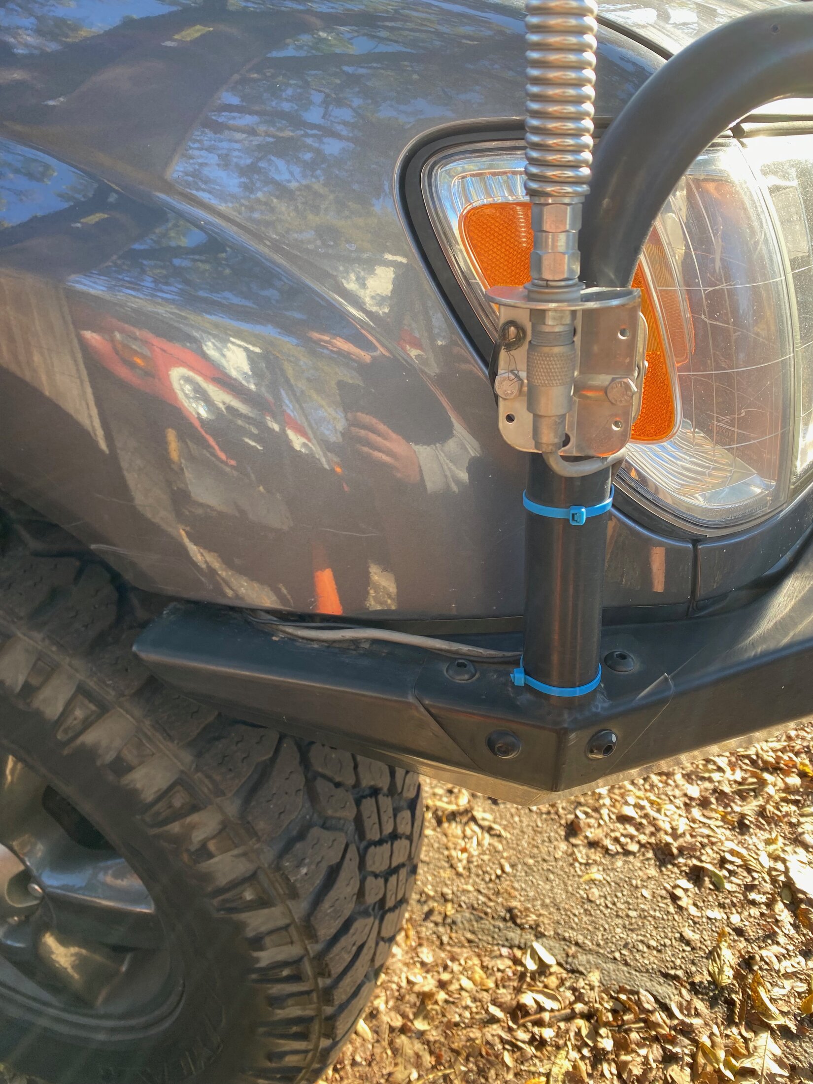

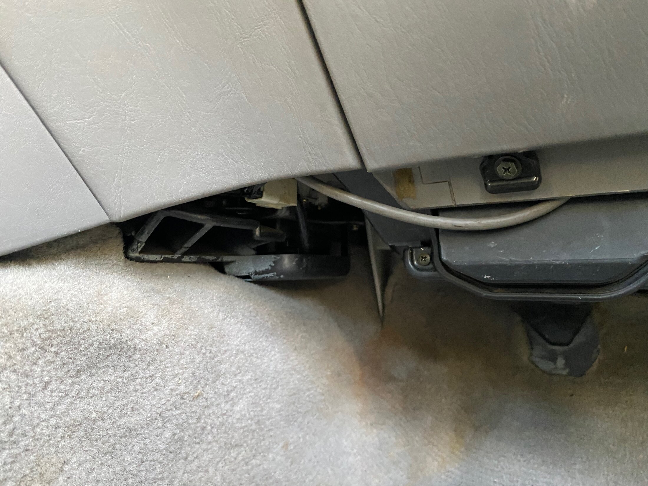

Yeah coax is what I ran out behind the glove box and it was easy through an existing location. I just made a small nick in the existing rubber large enough to fish through then RTV’d it.
Was a great route for me from the center console to the front of the truck since it allowed me to run my wire under the console trim without having to take anything out.
@Helipilot updated to include photos. The grey wire is the one routed from inside to the front bumper for CB.
^ Exactly how I passed wiring through the firewall as well

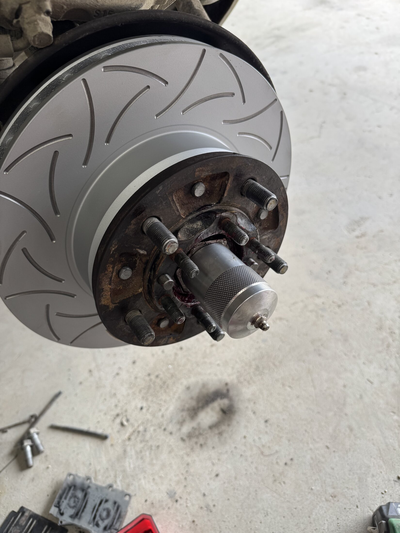

New to the forum and LC’s overall. This week I did front and rear rotors and pads. In the process found mangled threads in 2 of the rotor to hub holes so got those Helicioled. Buttoned everything up today and started to flush the disgusting brake fluid. That was a pain and I still can’t get fluid to come out of the rear driver side other than the initial 1/4 cup. I’ve learned that LC’s are not like most vehicles and not to think thoughts like “brakes are easy or I know how to bleed brakes, I don’t need to research that”🤣.

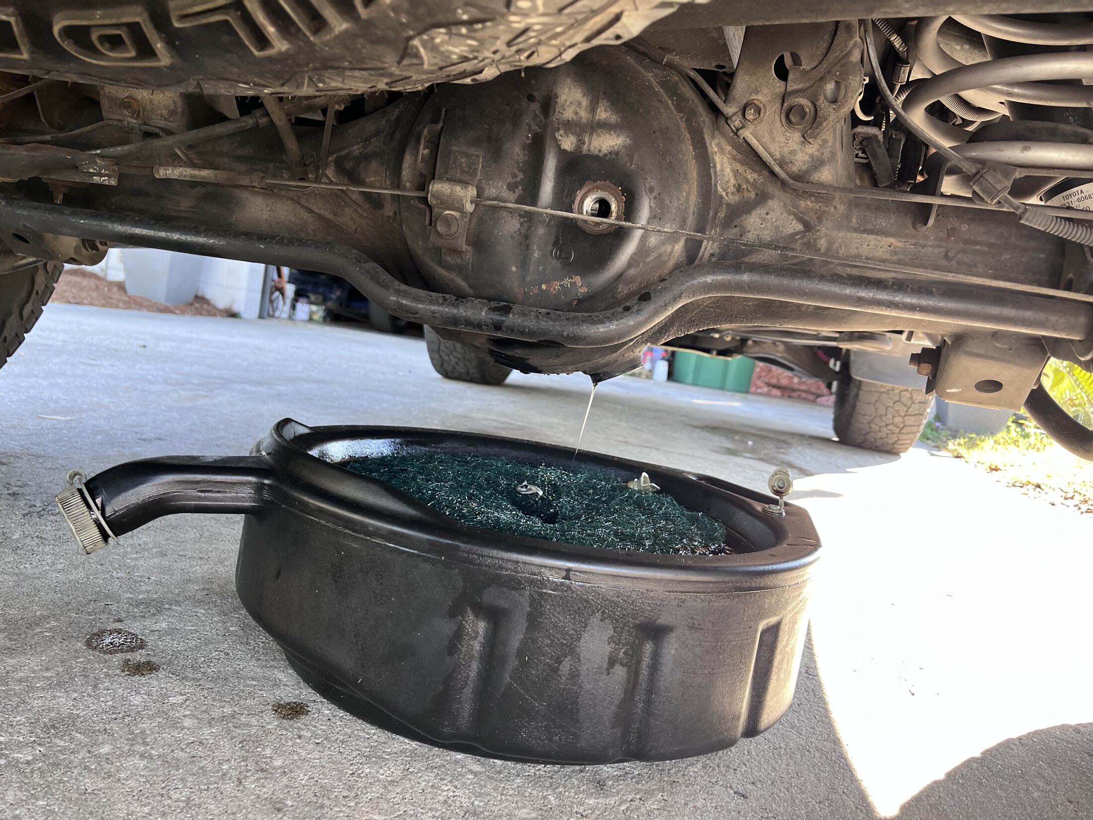

Replaced the rear differential fluid today.

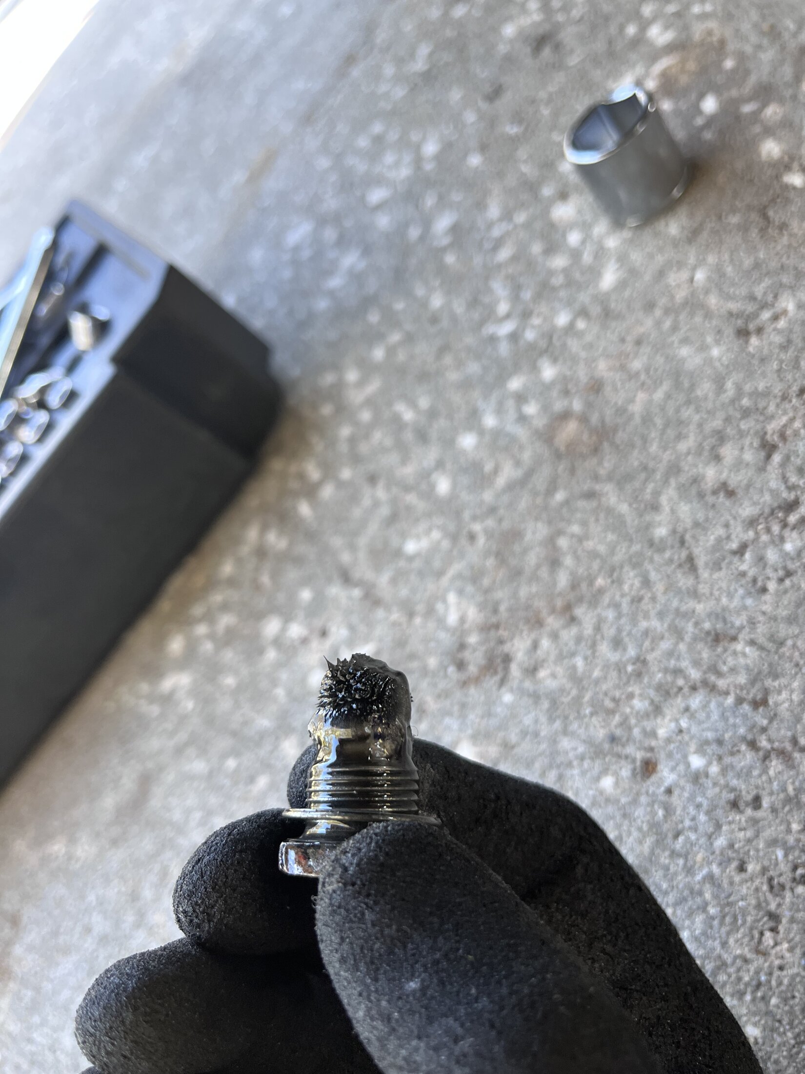

Looked like it had been a minute since last done… this has me worried.
… obviously
Need to let my wife know because of all the metal I found on the drain plug it’s time for a rebuild on the diffs, and re-gear to accommodate some new larger 35” tires.
…obviously
I just got the Yukon 4:88 and 35” tires. Gears made fun to drive again. I also did rear lockers while they were in there
