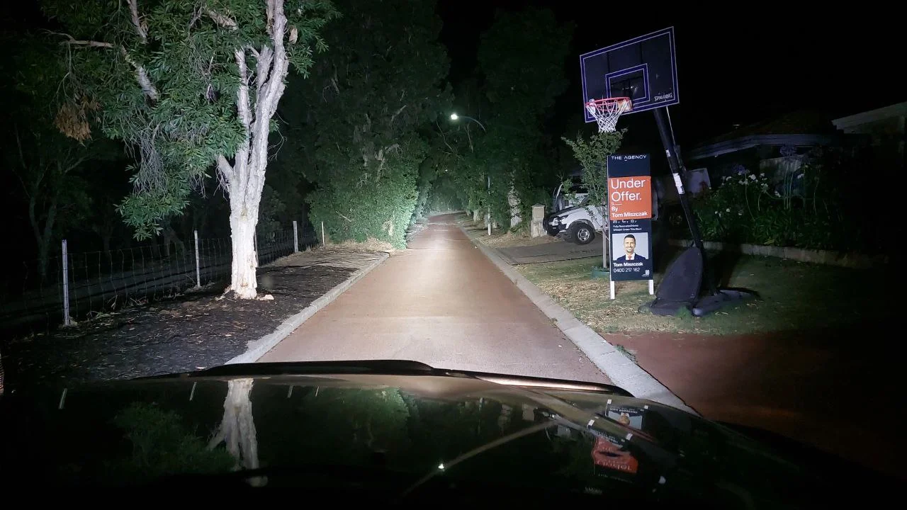

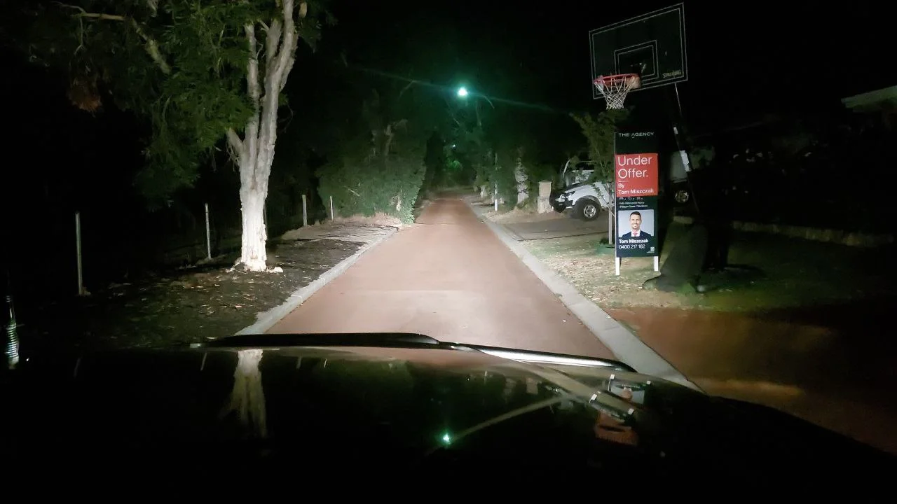

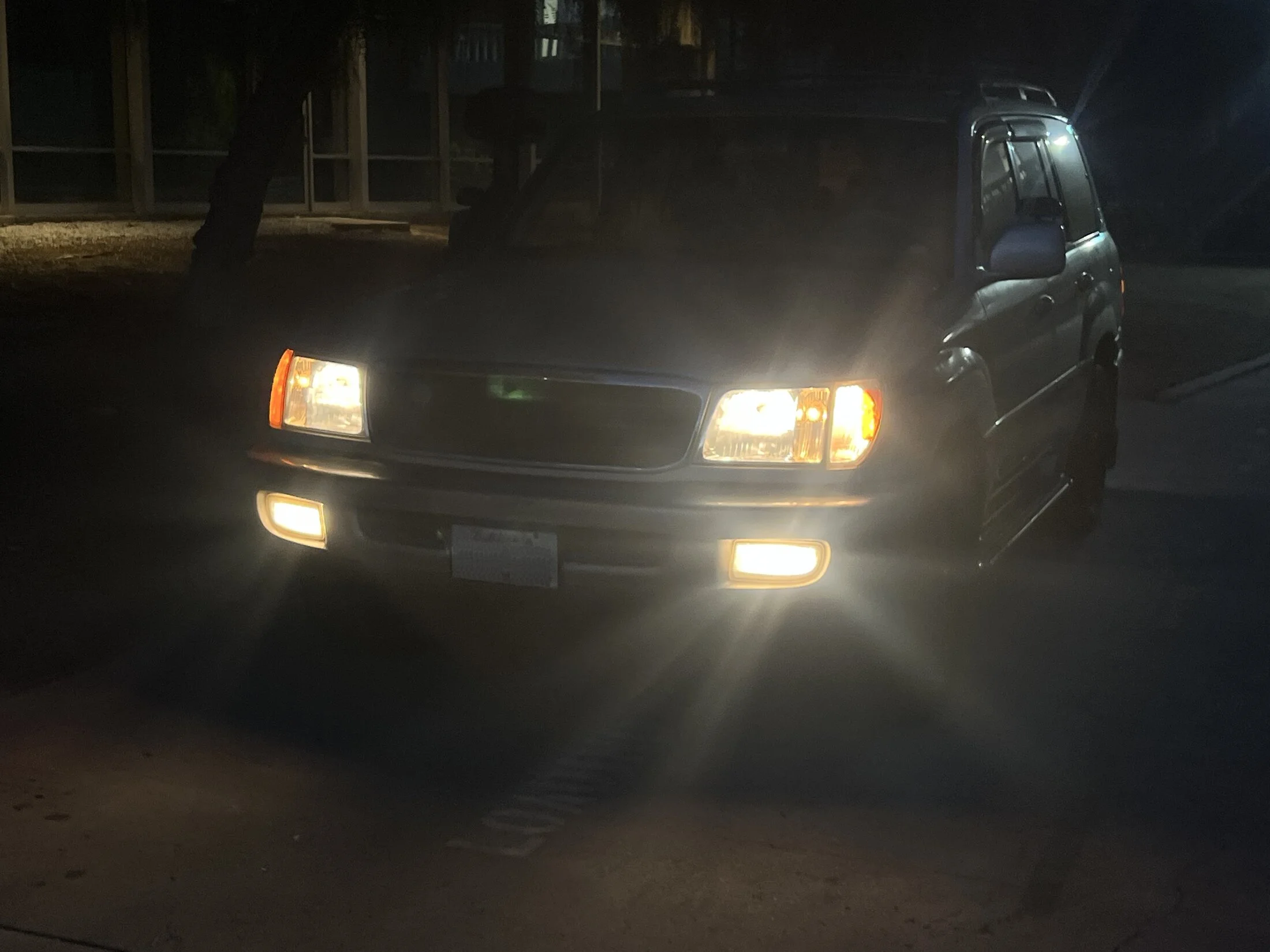

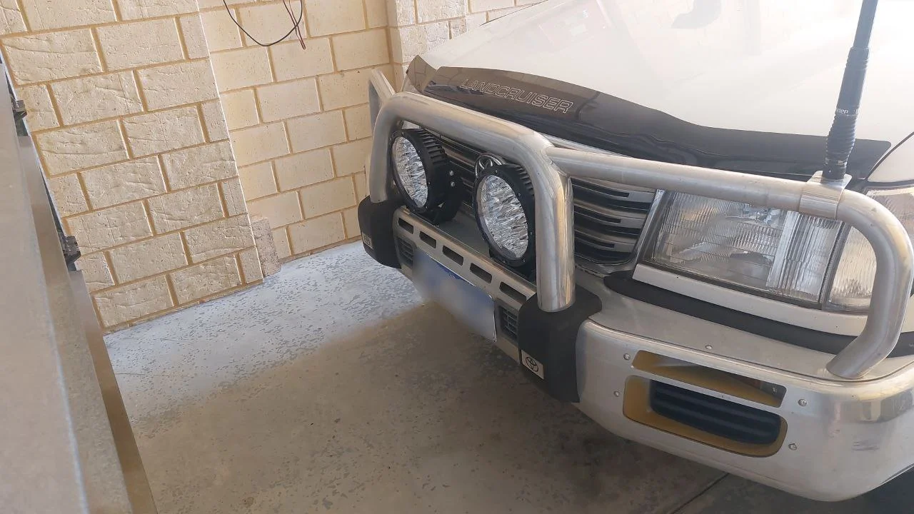

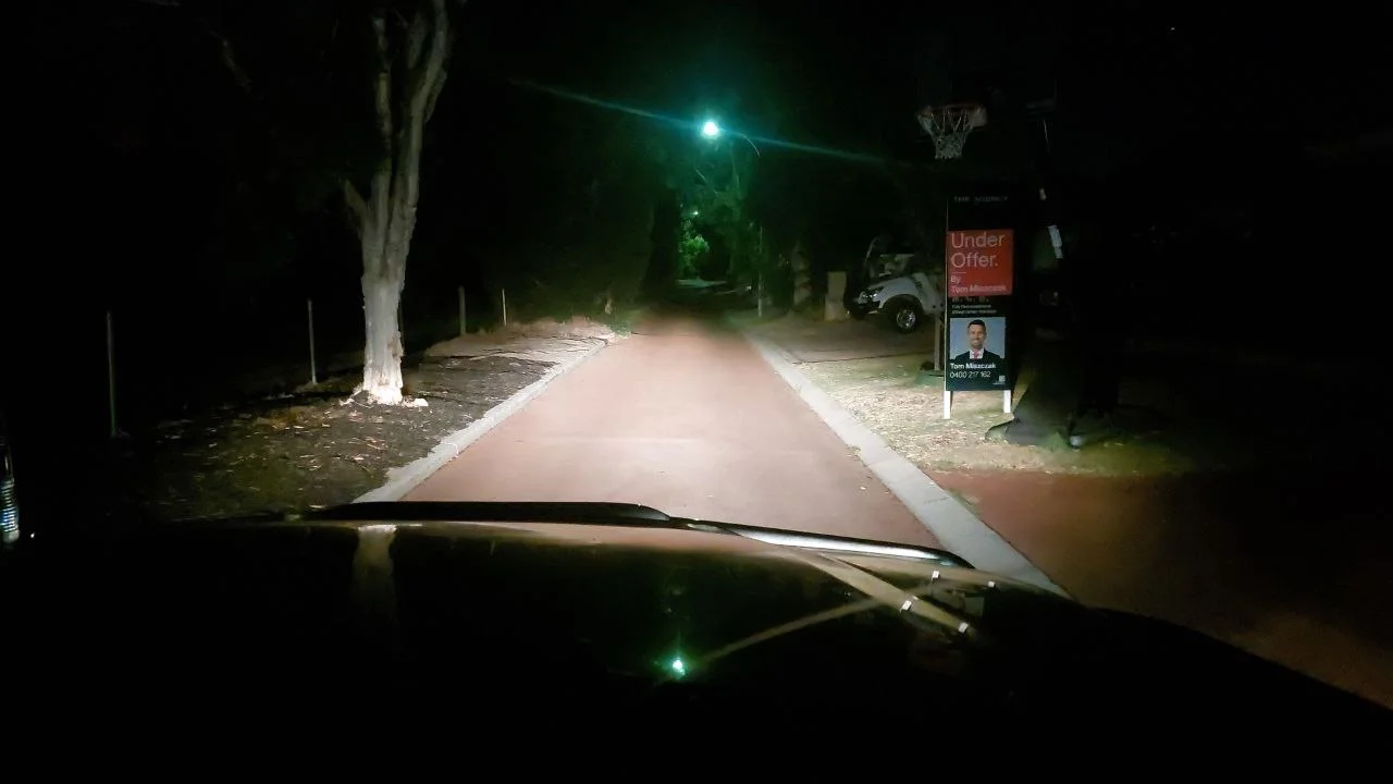

BIG LIGHTS!
9" King 'Lethal' LED spots.
Man, I can see the road again! :)
Main beam (take notice of the street light centre top of the picture. Watch how much the camera stops down with each succession of the photos)
High beam (no spots)
Now the spotlights!

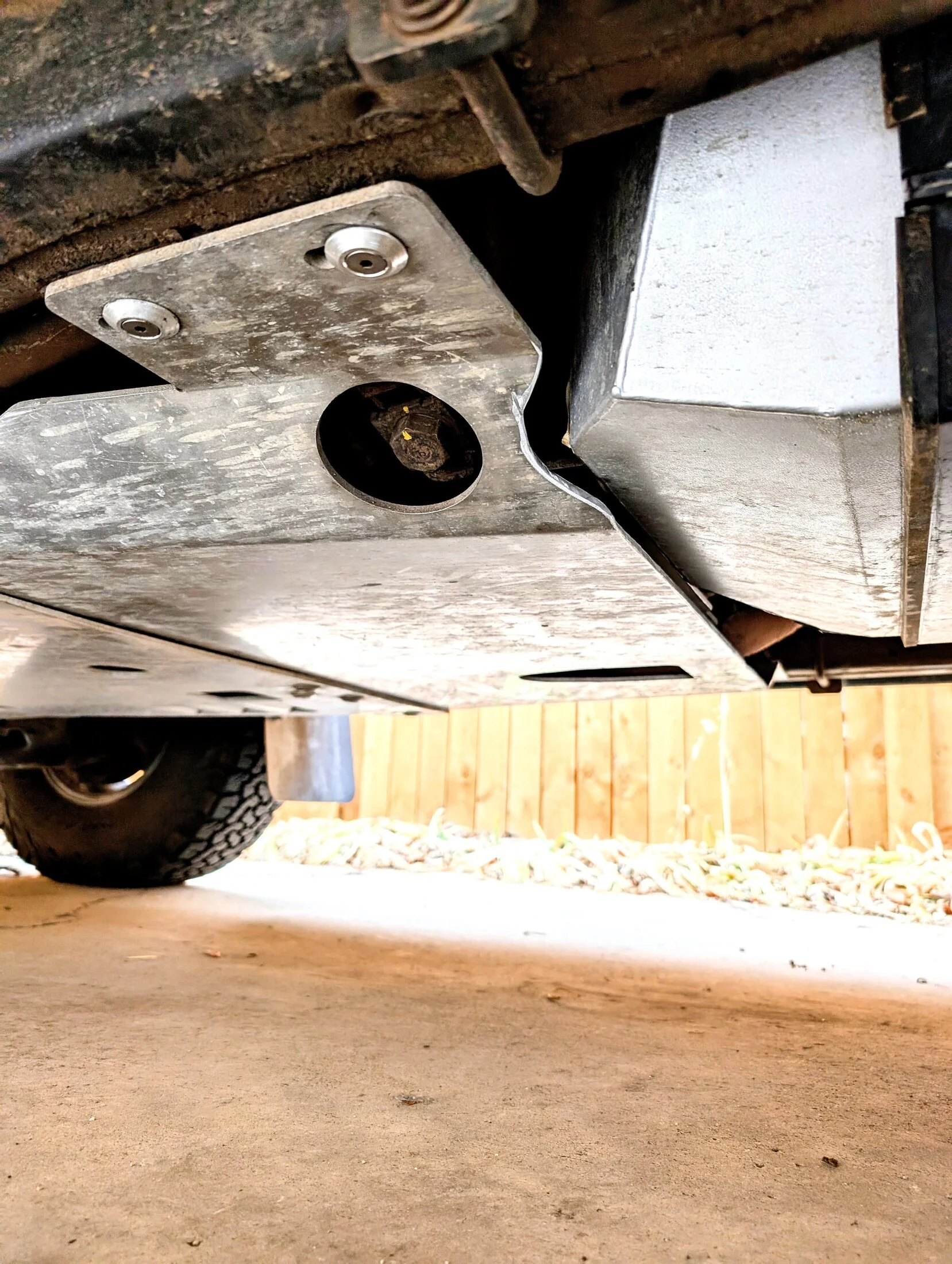

Finally got around to cutting up the rear-most dissent skid plate to accommodate the long range tank, we'll see if the ~1/2" of clearance is sufficient or more is needed:

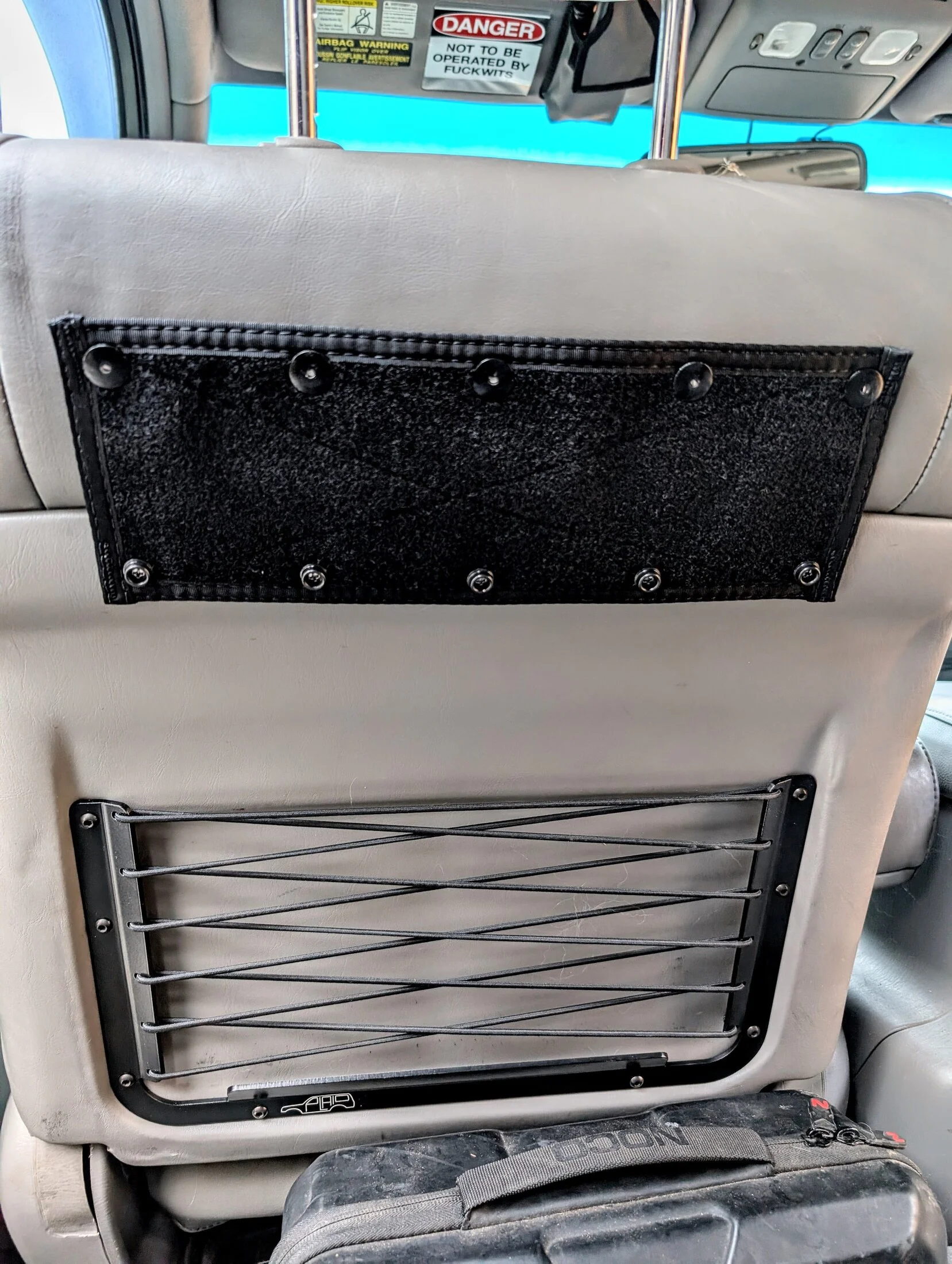

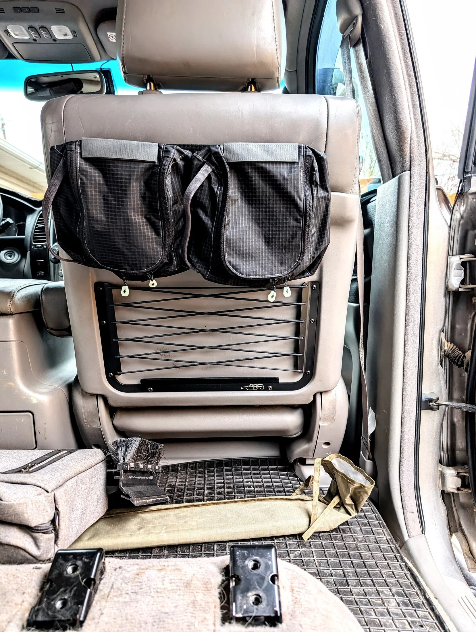

Starting to think about the interior build-out. Riveted in some velcro panels for seat-back and rear storage:
