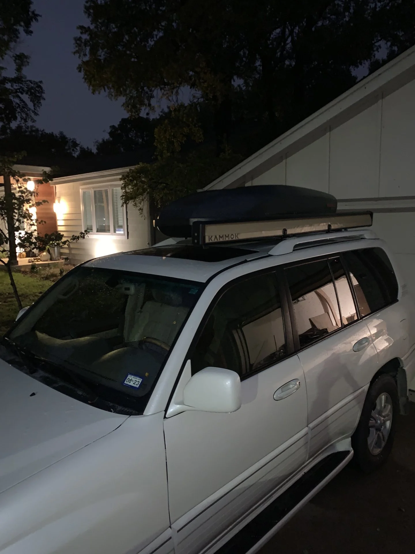

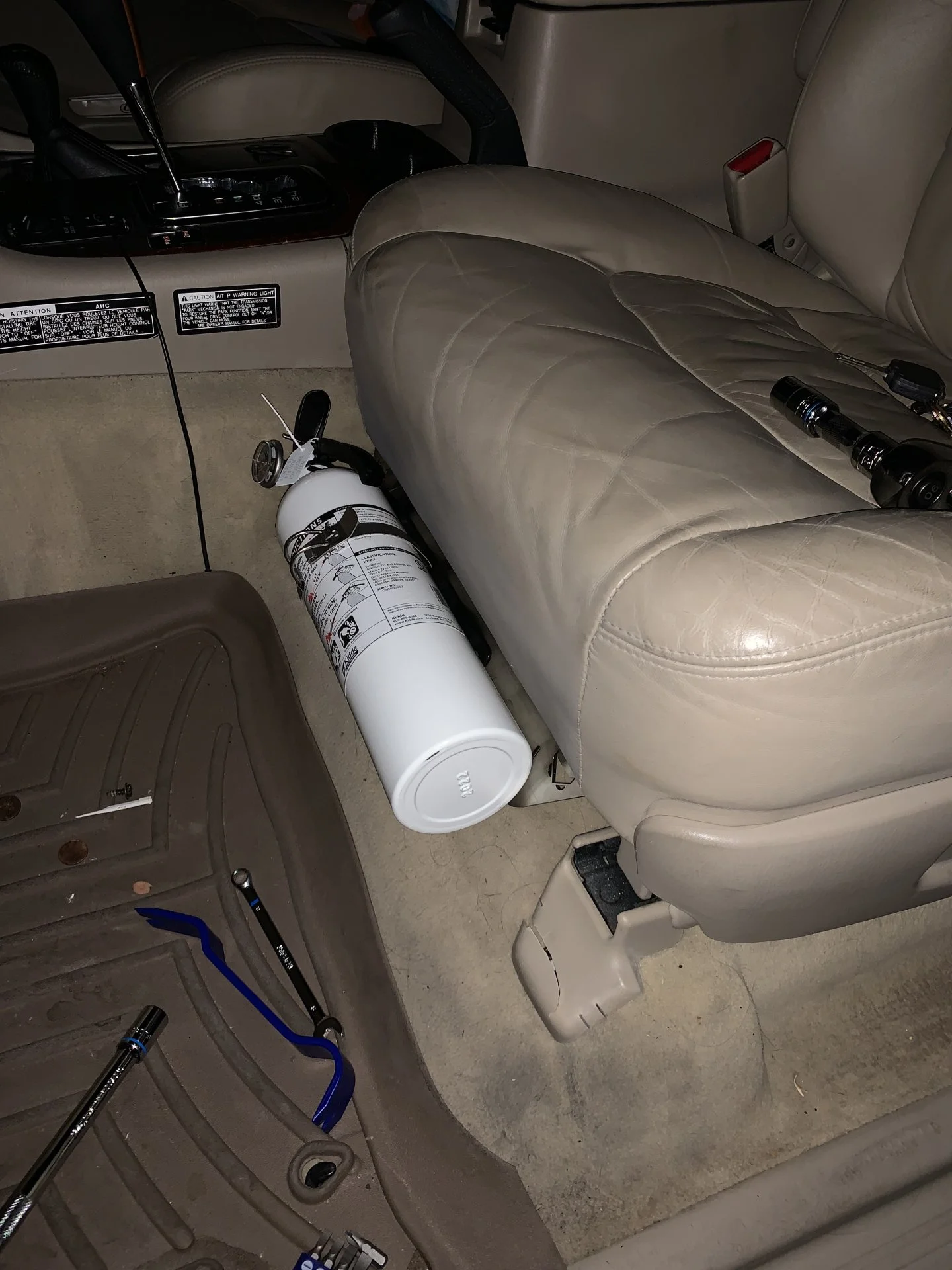

This was a big week for my rig. Got to install some toys and go for a good camper towing trip...followed by the annual Christmas tree haul.
Rented a Taxa Cricket for Thanksgiving
Installed a Kammok Crosswing quick-deploy canopy from the kickstarter

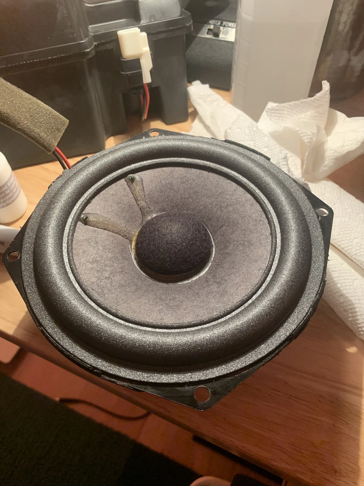

replaced my ML subwoofer foam surround (shoutout to Simply Speakers)
Installed Owl Expedition seat MOLLE/Extinguisher mount
NOT PICTURED: some new Bosch wiper blades
View attachment 3177855View attachment 3177857View attachment 3177860View attachment 3177858View attachment 3177859

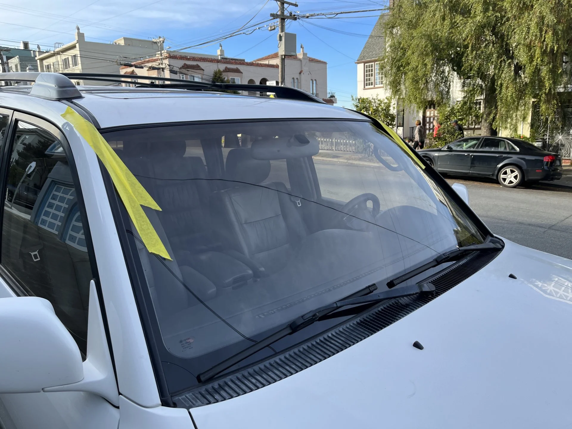

Got a new windshield installed and some minor surface rust cleaned up around the frame. I'll probably everything except the glass removal/install myself next time so I can make sure everything is thoroughly addressed and installed correctly, but I didn't have the time or space this time. I'm pretty happy with this shop's job though. They used all the oem parts I provided, riveted the side trim, and the window seems to be sitting the right place. I can finally read the vin on the dash.
I just need to finish cleaning the cowl now...

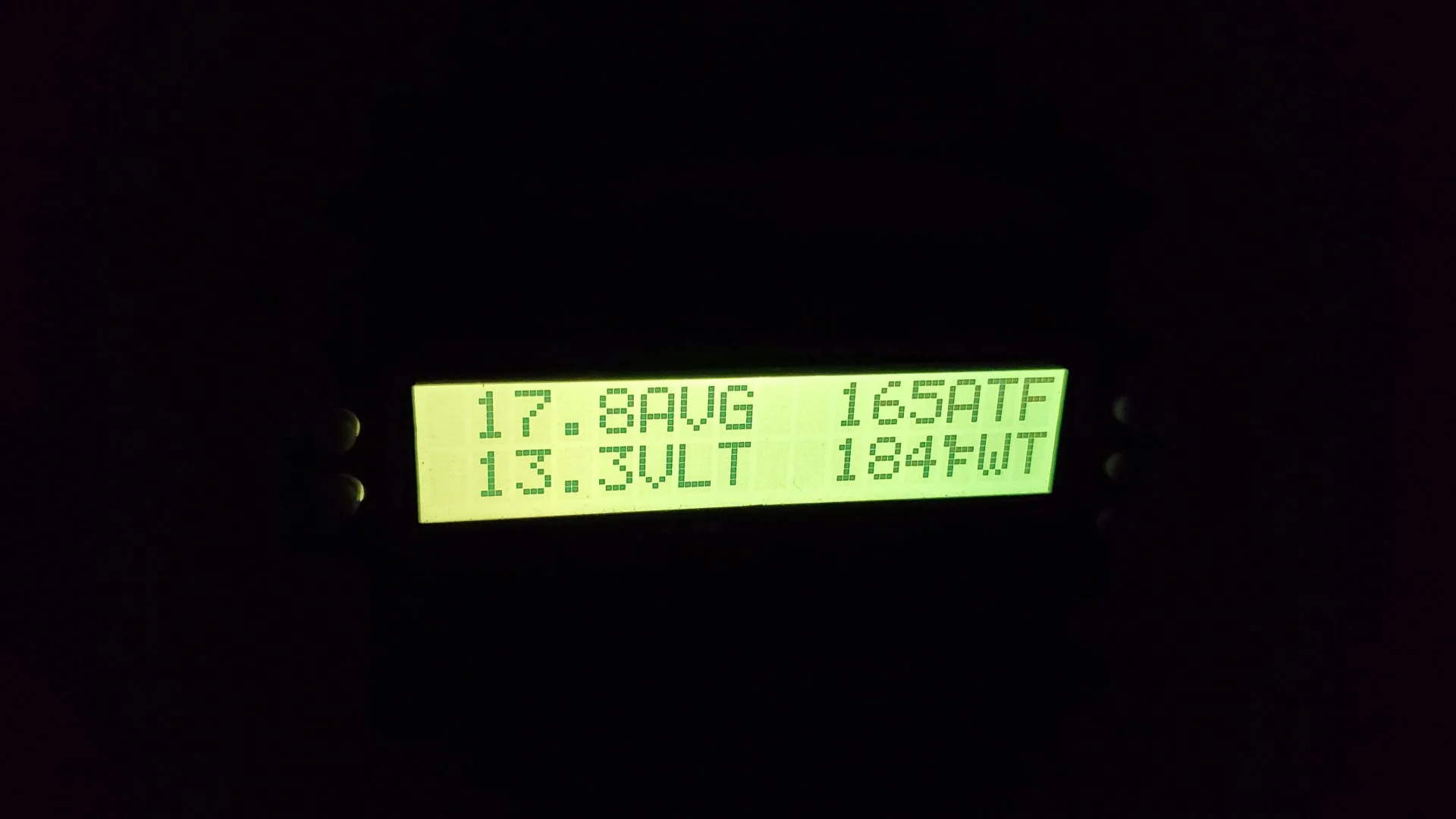

I saw the best fuel economy so far, with the roof rack removed! Cruising at 60mph with a couple of very short stops on flat-ish highway. 40⁰ F ambient temp, rolling on Bridgestone Blizzaks.
17.8 MPG is unreal!
17.8 MPG is unreal!
edit- just noticed you’re rolling on snow tires. Probably the larger portion of your increased mileage, assuming that they’re smaller diameter ?
Also, with 35” tires not probably your actual mileage, unless you’ve calibrated your Scangauge?

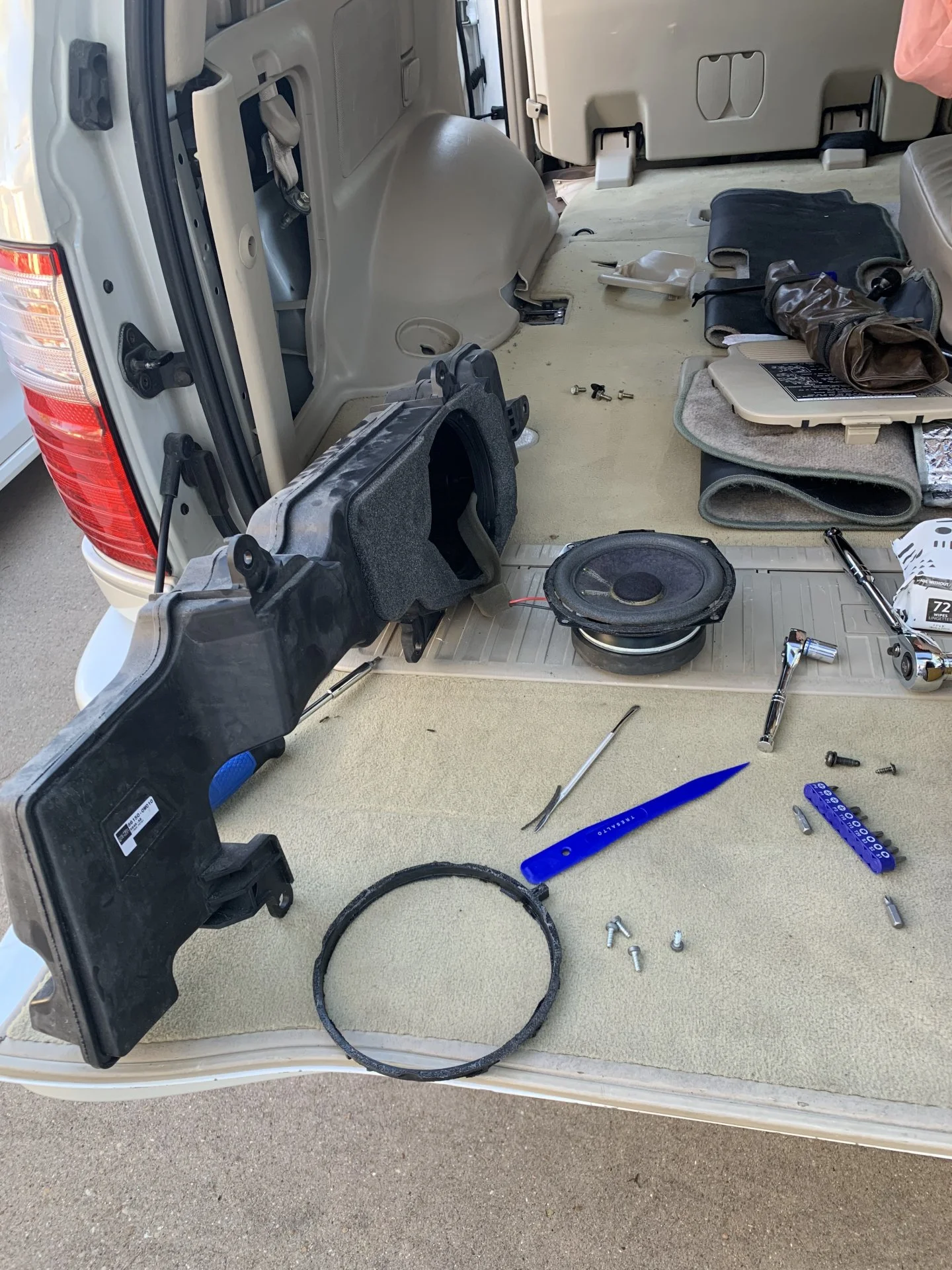

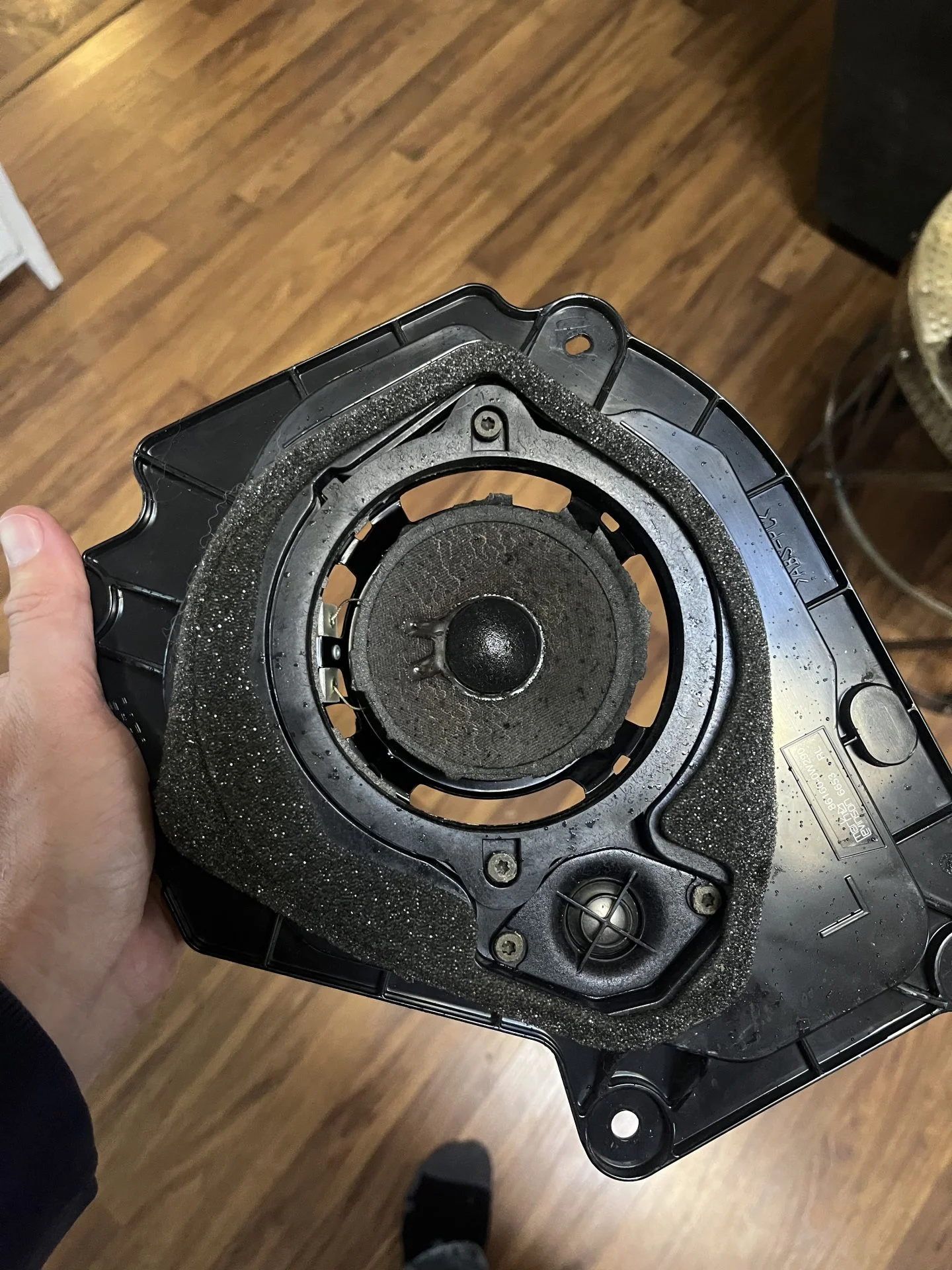

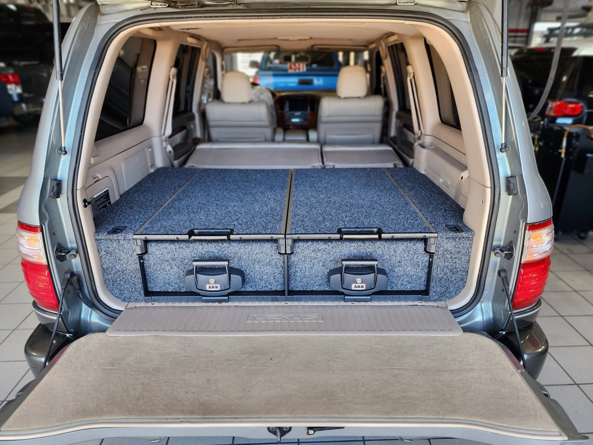

Installed drawers*. Big thanks to chowcares's video. Huge help. Installed 3/5 of the Visaton speaker set. Thanks to @cdoglesby for talking me into that.
* What the heck is up with ARB's 'grab bag' of screws. Missing a dozen you need and an extra 50 you don't. It's like some off-road Halloween trick or treat.
My truck is regarding to 4.88 in both different and the speedometer is absolutely accurate with 34.5" tires that I usually run.
These winter tires are 34.1" (the largest I could find). With these my speedometer is under reading by 1.5 mph at 60 mph speed, so I think these fuel economy ratings might be actually slightly underreported! 😳

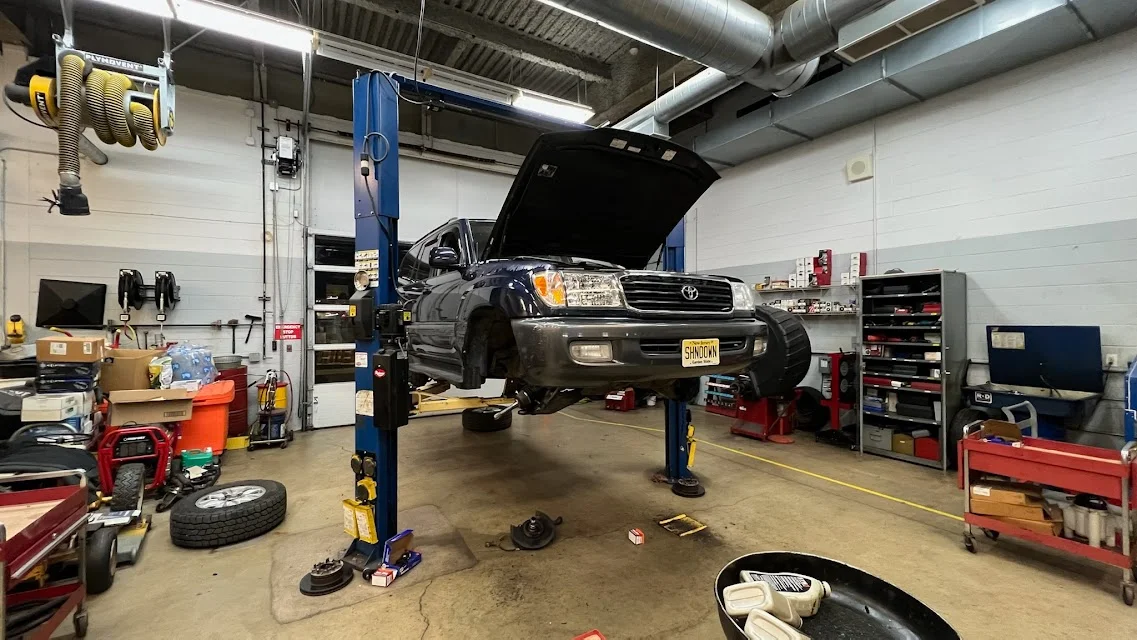

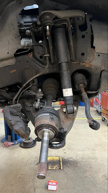

New lower ball joints on the 99...that turned into a much bigger project. Truthfully you'd never know it because the thing rides like a dream. Its now also getting a full brake job with hoses, repacked bearings, all new spindle innards (technical term), rebuilt CV axles, and tie rod ends.. Plus, at one point I realized one of the upper ball joints had a ripped boot, so I placed my very first order ever with Cruiser Outfitters (yeah I know). The parts were ordered Weds late and arrived Friday from UT to NJ. Wow. I laughed way too hard at the enclosed sticker "Jeeps are s***!" There is another lift on the other side of the room pictured below. It has a jeep on it that the poor guy has been trying to get coolant to stop leaking from for the past year.

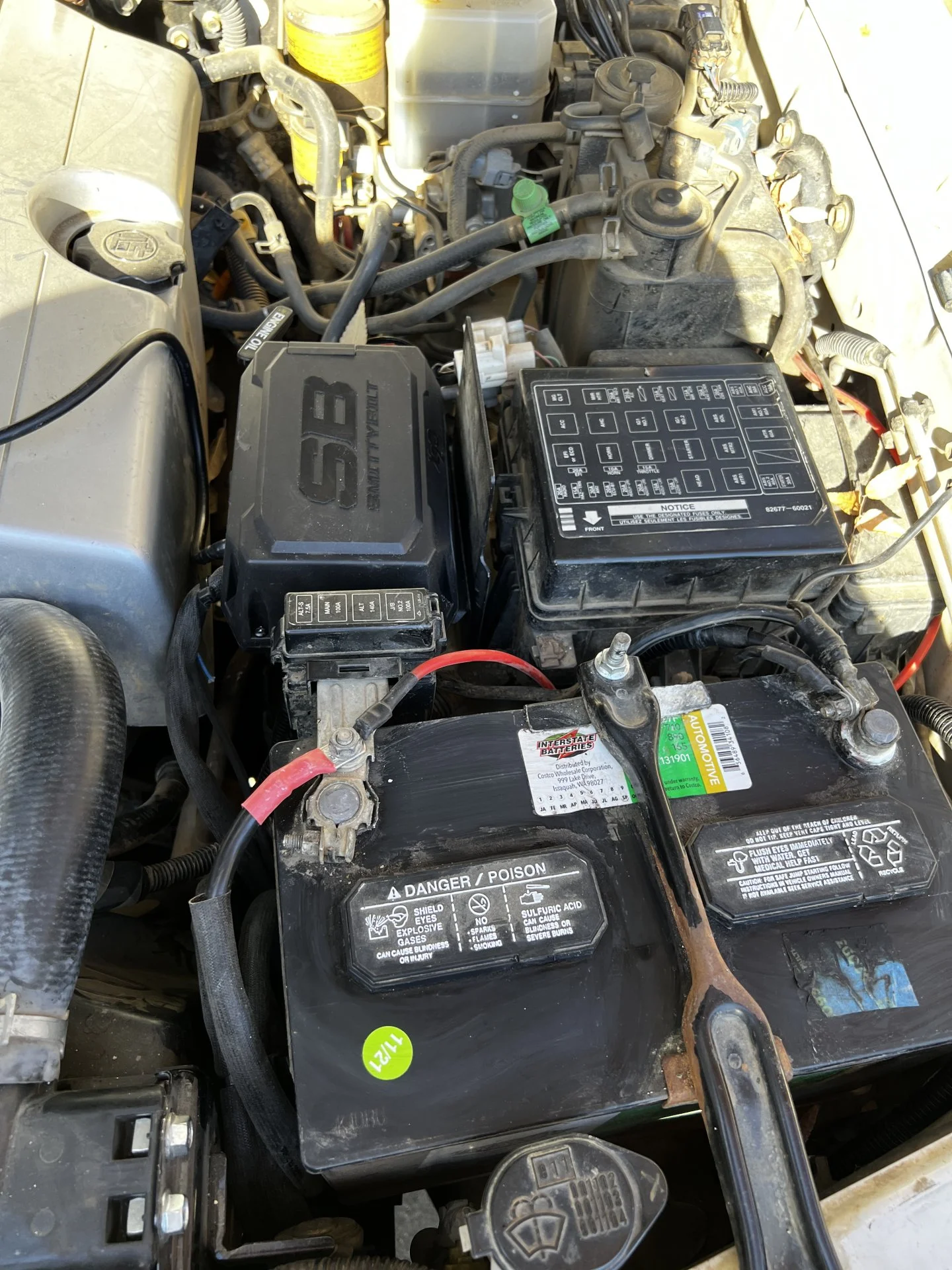

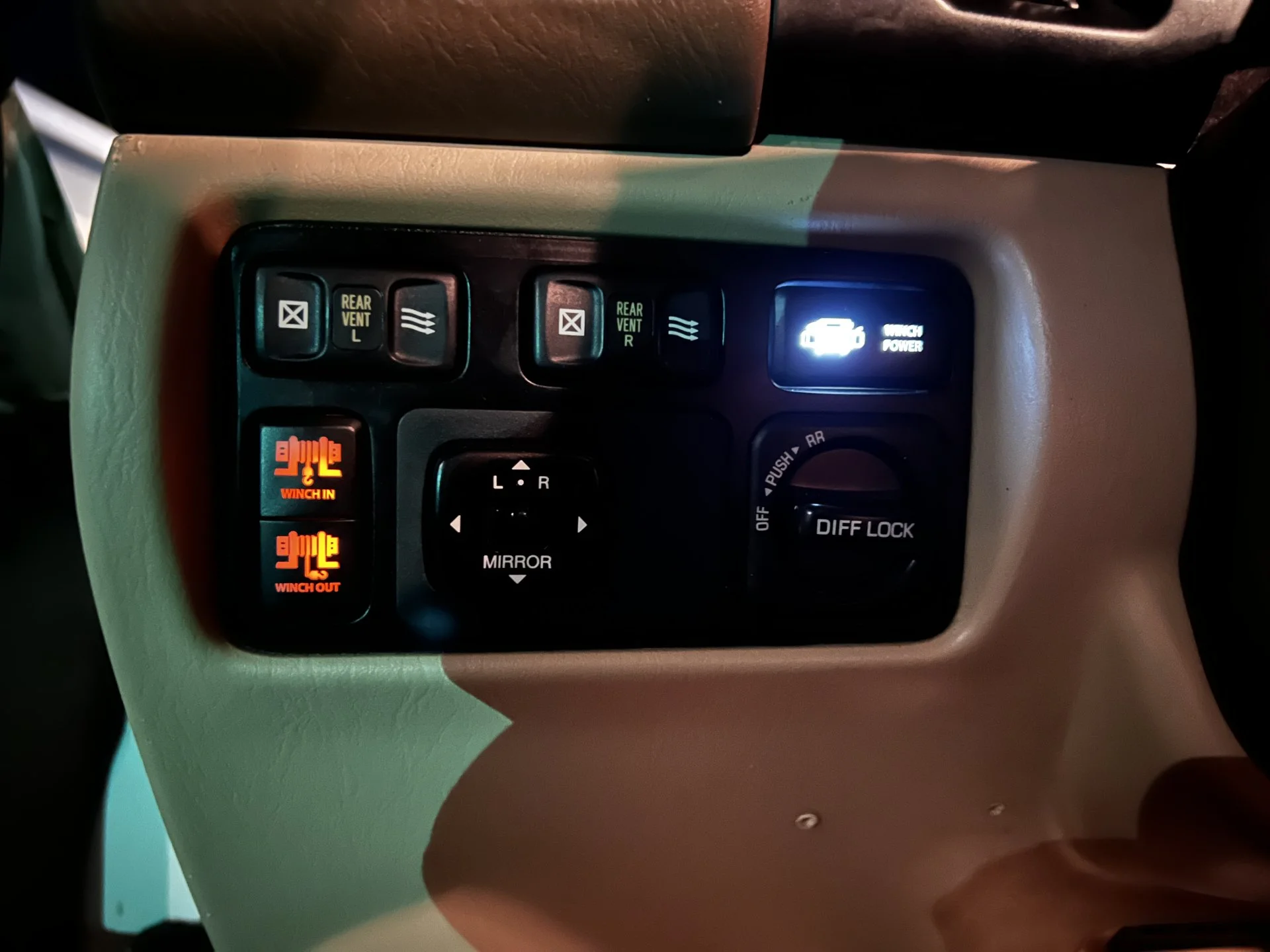

I installed a smittybilt x20 into my dissent bumper. The control box didn’t fit well, so I mounted it inside the engine bay with an Owl accessory tray. I then got some four strand cable and hooked it onto the relay inside the control box to extend the controls into the cab using some CH4x4 switches.
