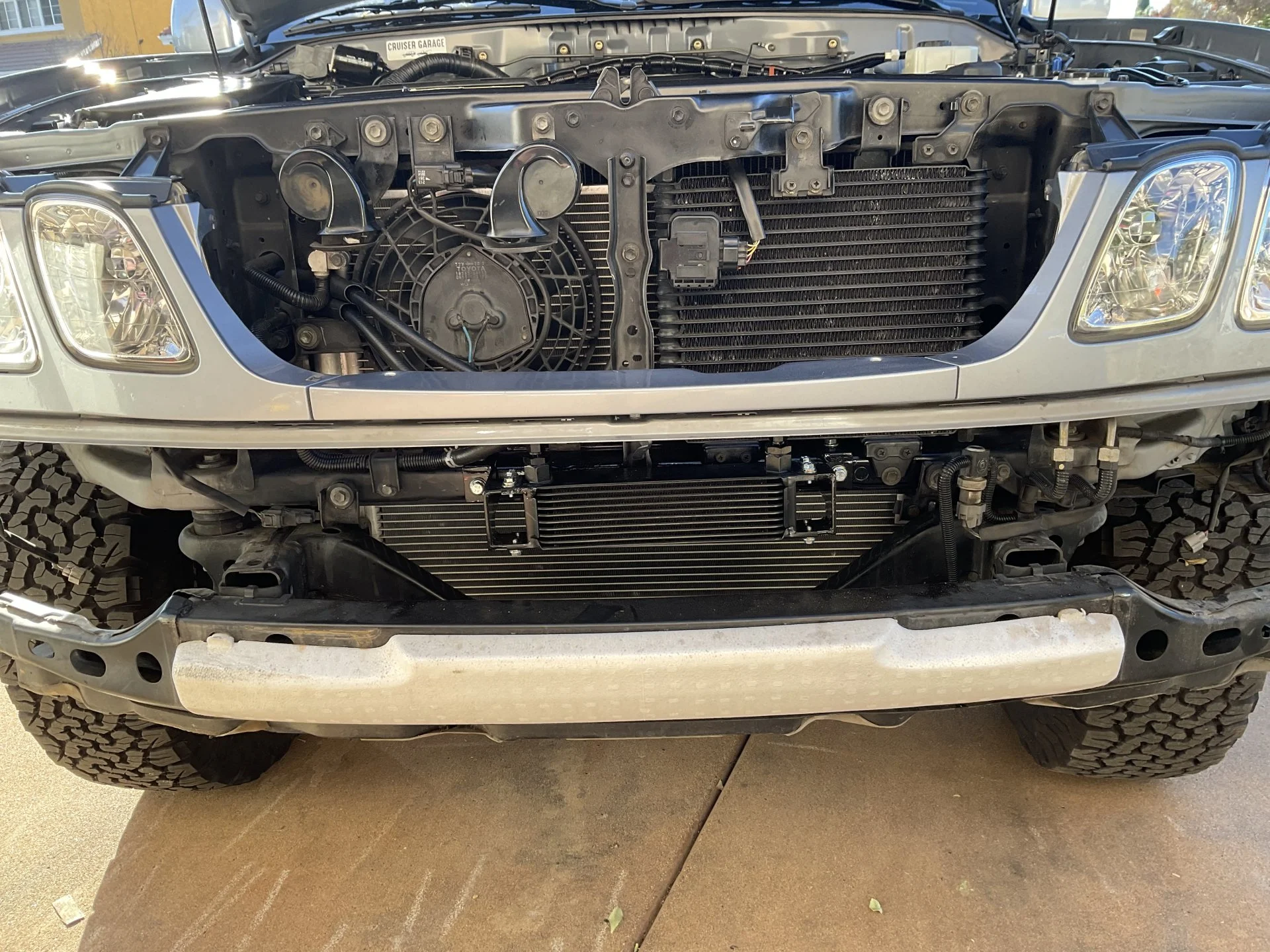

We're you having issues with power steering fluid boiling?
@ownerwent through some issues with overheating PS fluid recently

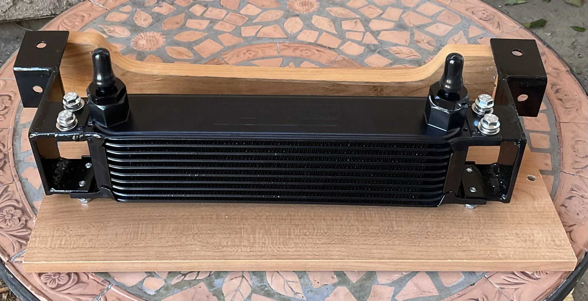

I was not having any issues with power steering fluid boiling… But on this forum, I have read many a story about the need to replace power steering racks and power steering pumps… and Toyota did begin providing a cooler for power steering fluid beginning in 2003… Although it was a cheap heat sink paper clip type.
The root cause of power steering rack and pump failure is heat… Super heated fluid swells spinning shafts, and causes premature failure of seals that create an expensive end result. I figured if I could cool the fluid, these parts should last much longer if not indefinitely… Especially if you use full synthetic high quality fluids.
I completed this power steering cooler installation today… And I found that after driving for as little as five minutes, the power steering cooler becomes quite warm borderline hot. I also found that the hotline into the cooler is much warmer than the cold line out of the cooler. So despite the diminutive size of the cooler that I installed, it is quite efficient at shedding the unneeded heat that could potentially cause failure of expensive parts.
In summary, that little cooler is doing its job, and I am quite happy with the installation. The fluid in the reservoir is much cooler now than it was prior to the cooler installed.
I was striving for an OEM appearance… all metric bolts and M8 riv-nuts… OEM constant tension hose clamps.

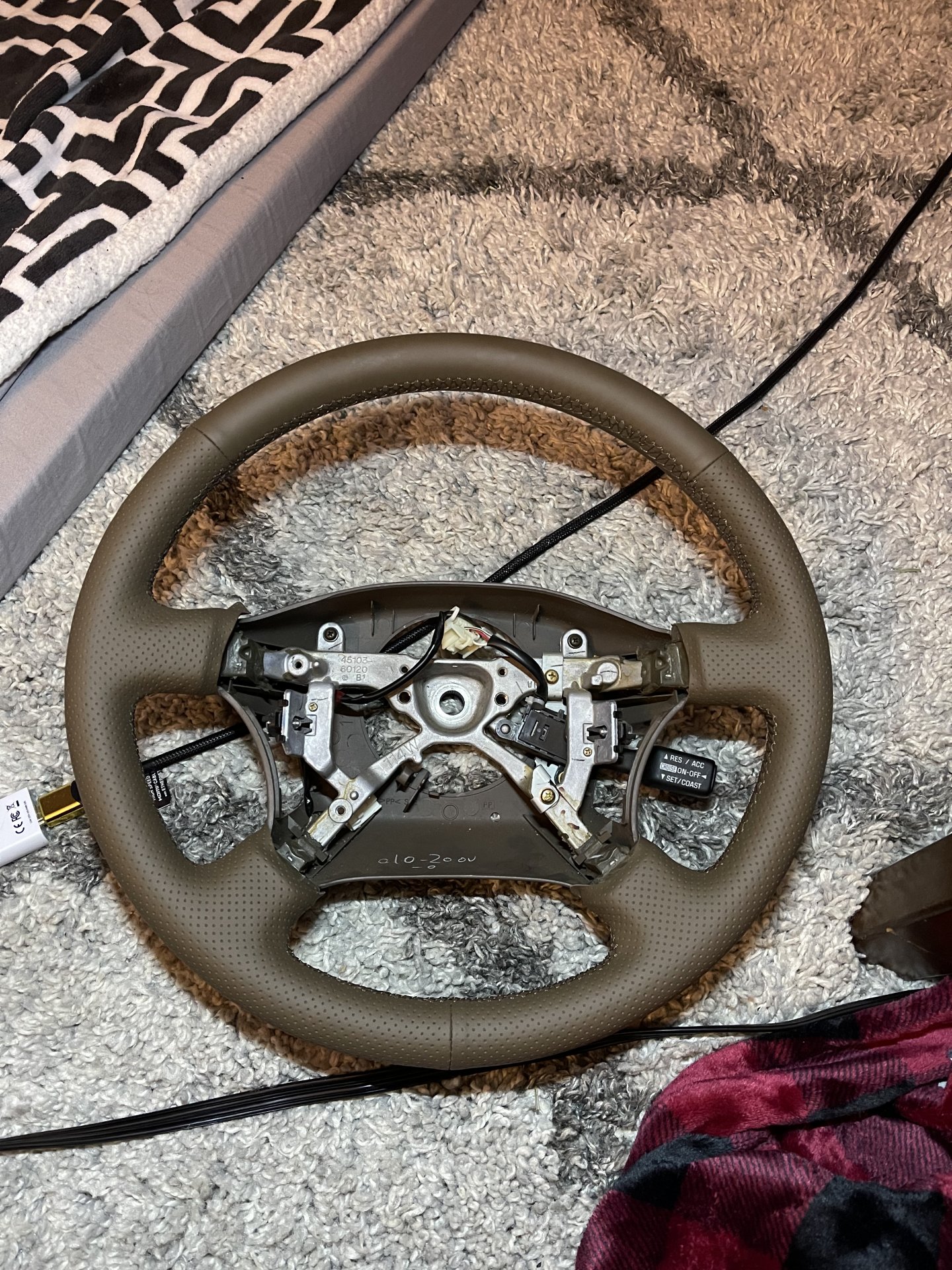

Looks great! Is that the Loncky kit?
Yep, it is! Like I mentioned, it was a huge PITA to install but so worth it when done. It's not a perfect match to the airbag color but it feels great when done and looks the part. Definitely a worth it upgrade considering this is a part of the vehicle that you have to 99.9% of the time touch.
My only recommendation is to not order directly from Loncky and get it from Amazon instead. I ordered through their website originally and 3 weeks later I never even got a shipment notification after numerous e-mails so I canceled and ordered from Amazon and got it next day.

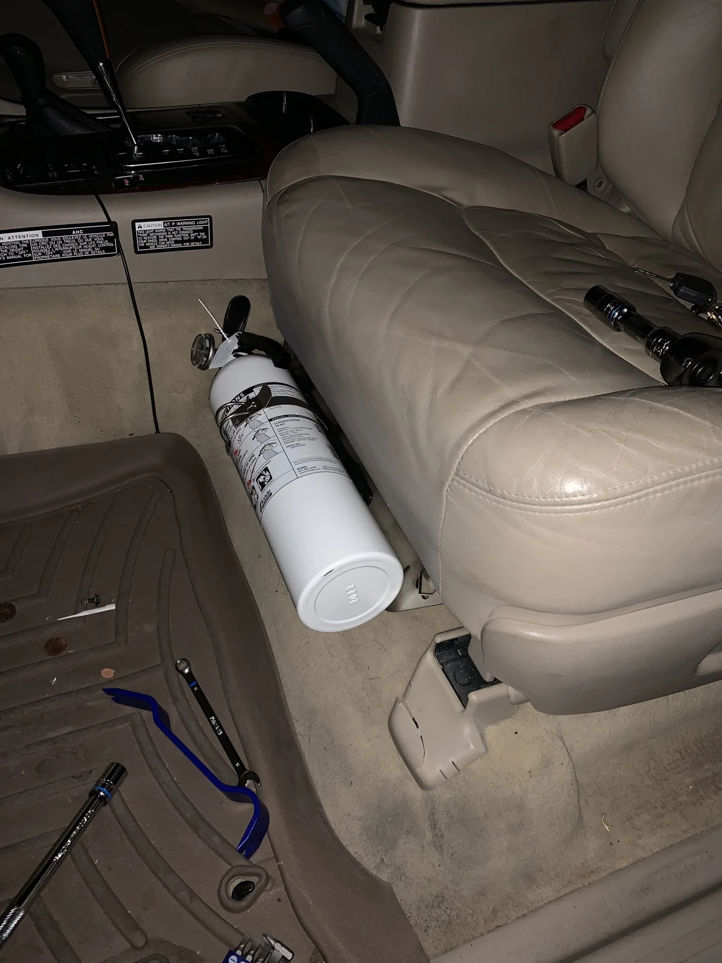

Installed Owl Expedition seat MOLLE/Extinguisher mount
