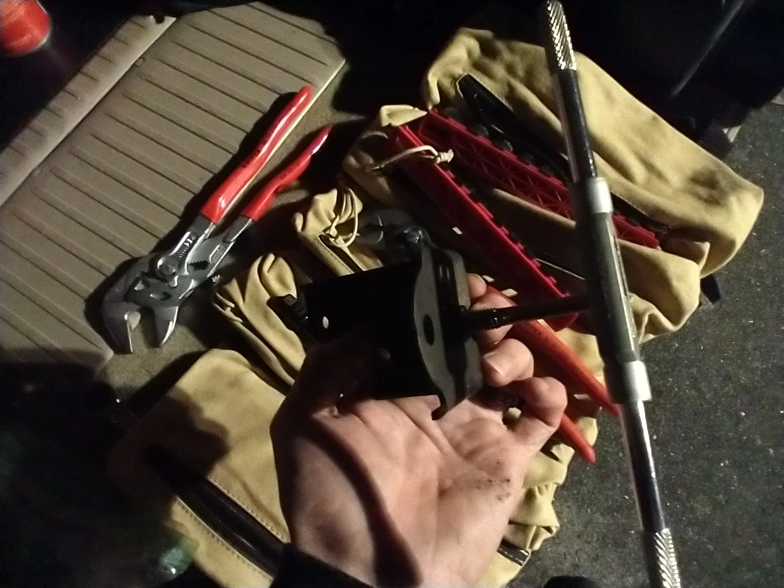

Silently spat a caliper bolt and said nothing about it. Upper one, left front wheel.
Tend to believe it was just a warning as only the rim suffered a bit and couple of thousands of my neurons.

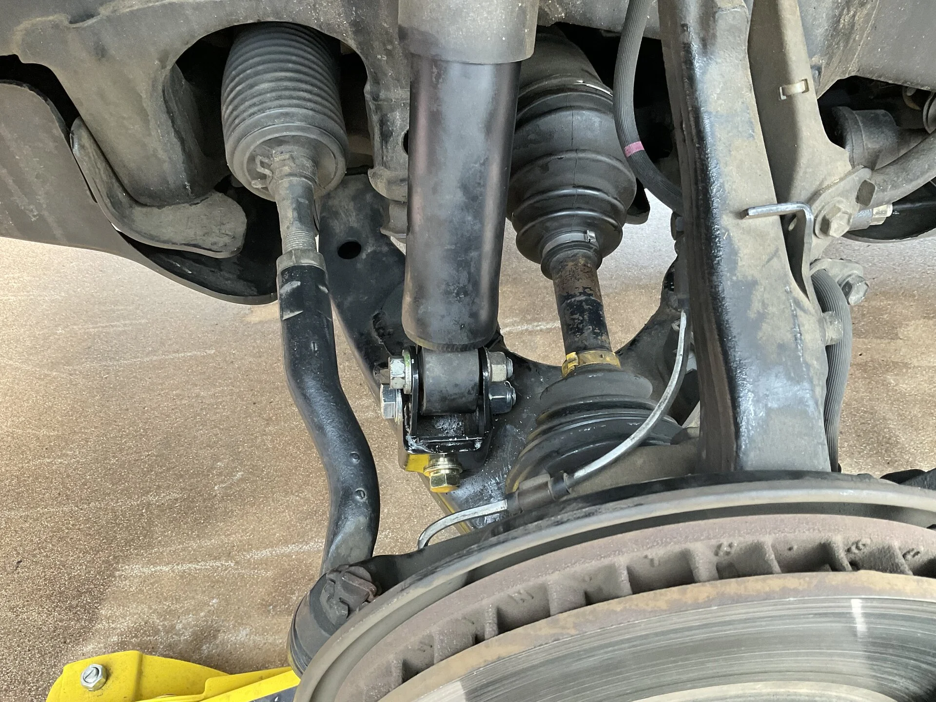

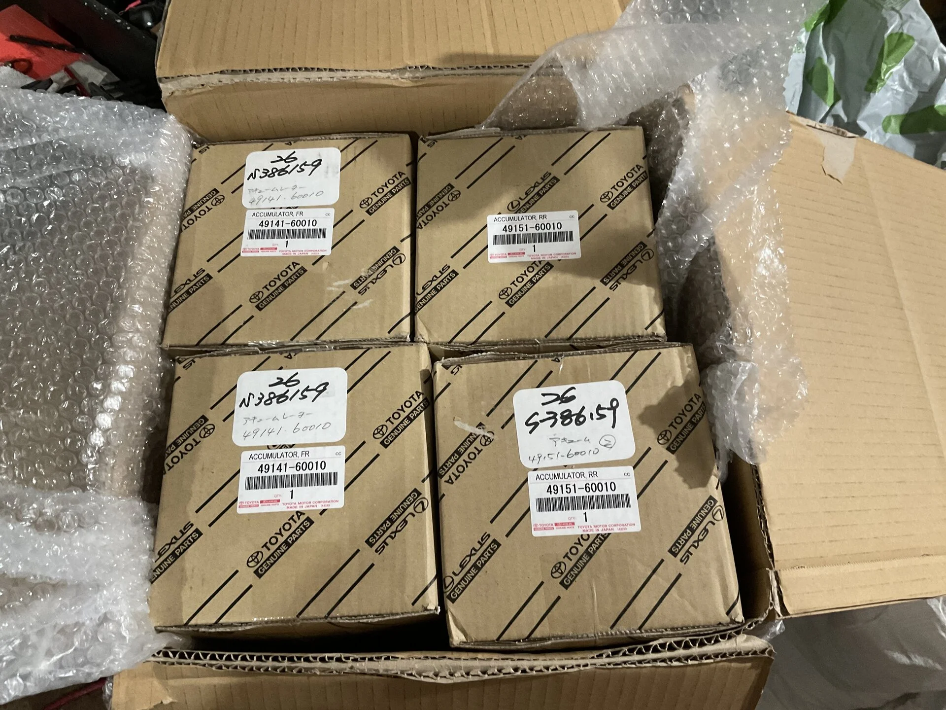

Received 4 new, current production OEM AHC globes from IMPEX Japan… and Zeal AHC shock extensions from Japan 4x4.
Installed today… Went from 8 graduations High to Low up to 14 graduations… the drive feels the same, perhaps a bit tighter body control in the rear. Only have 102,000 miles on the original AHC globes, but in 20 years, I would imagine that the nitrogen pressure has gone down a bit. Wanted to start fresh.

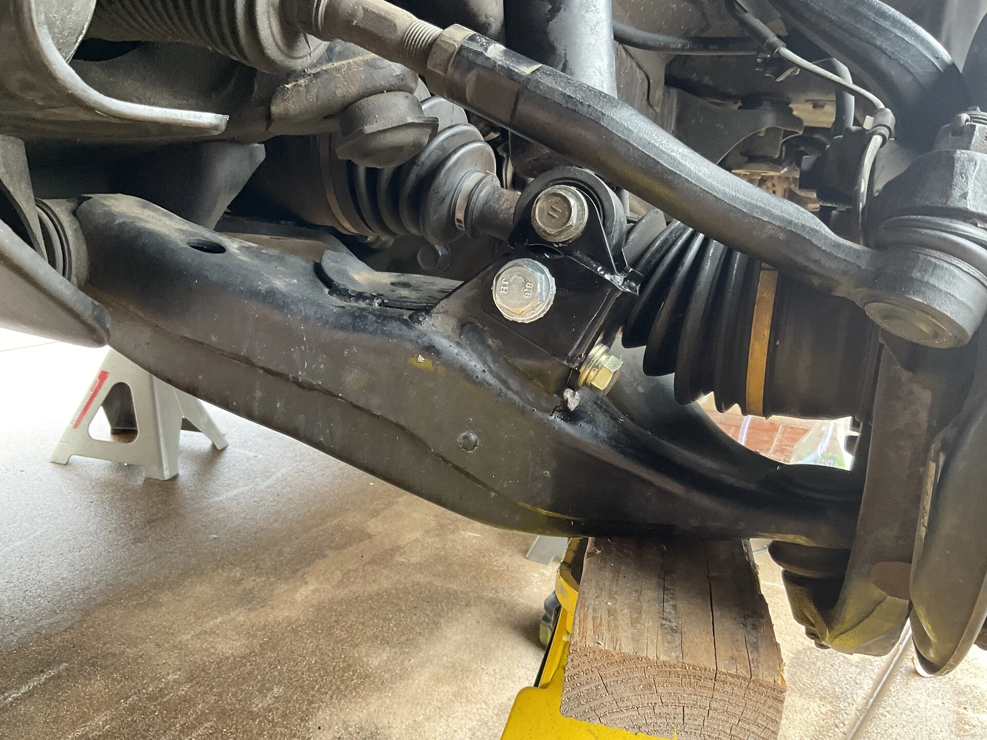

If you do the AHC shock extensions, be sure to check for CV boot clearance to the shock extensions bracket. Mine would barely touch the CV boot at full lock, on both the left and right side shocks…
So I shaved down the shock extension brackets with a flap disc, and welded through to fuse and laminate the 2 layers of steel in the bracket. Sadly, in this process, I lost the zinc plating in that location, so I ended up prime and painting them black.
In the last photo, you can see where I changed the radius in the lower right corner of the shock extension bracket. I now have 3.5mm clearance to the CV boot at full lock.

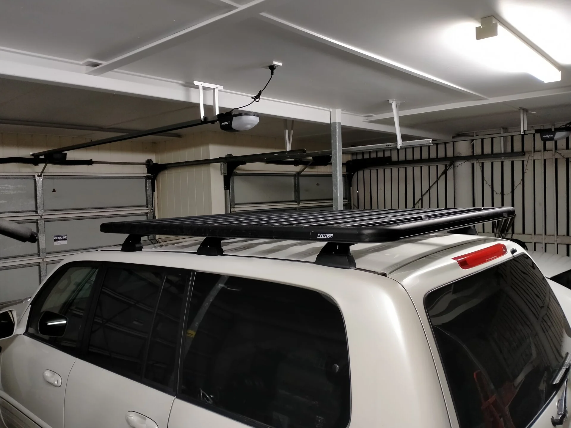

Removed the roof rails and attached a Kings (essentially a re-badged Yakima) aluminium platform roof rack. Used a grinder cutting disc + Dremel to insert a gap in the black aluminium trim. I remember my 100 series had plastic inserts - the full length trim with the LX470 is a lot stronger and a better fit.
Also attached some recovery points. My boilermaker mate wasn't happy with the M14 threads, so drilled and tapped them to M16. He then had the Milwaukee Fuel Impact Drill + Locktite blue and "uggered" them to a vast number of newton metres.
