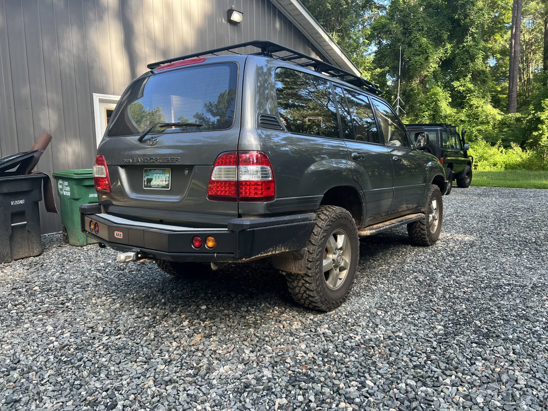

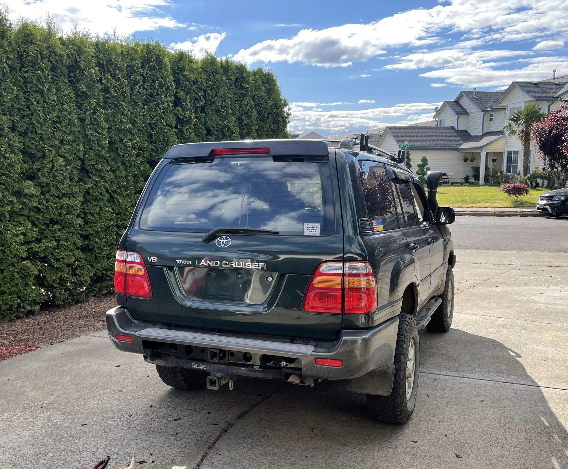

Today I chopped up my rear bumper with mixed results… I think. Because of my hitch receiver tire carrier it was a real struggle to access the hitch pin and with my up coming RV trip I don’t know if I will have enough clearance to run the tire carrier with the trailer so this is the result.
I’m gonna order up some bumper trim to hide the hack of a job I did cutting straight lines and curves. Cutting this bumper material is a huge pain because it melts and flings scorching hot shards of burning rubber everywhere.

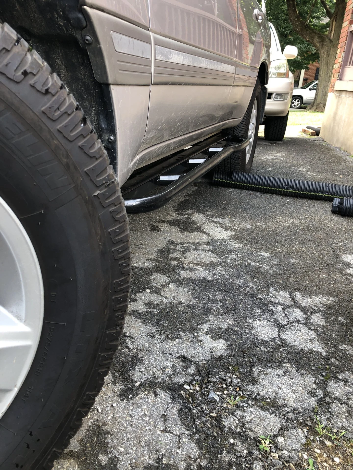

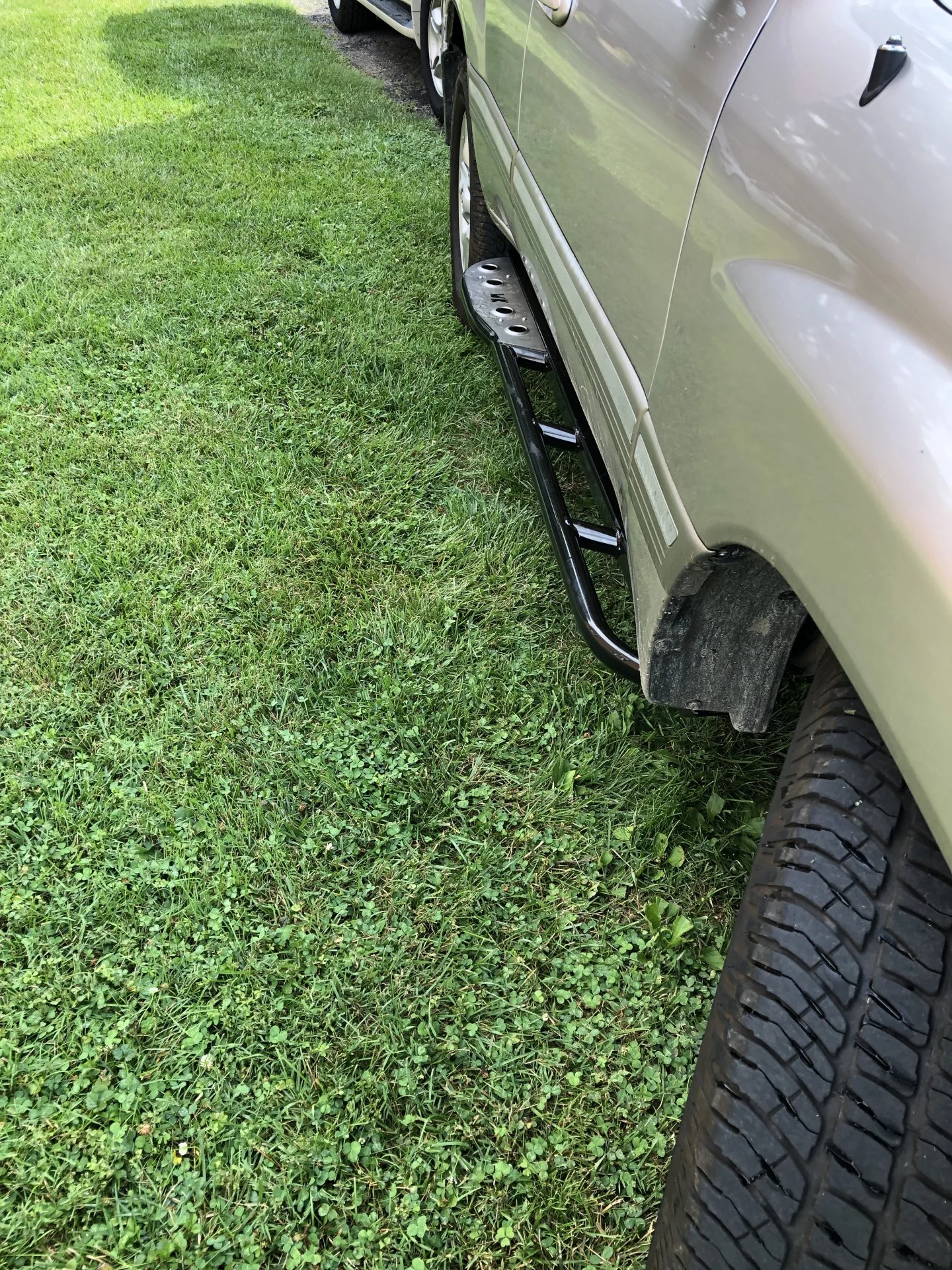

White Knuckle to the rescue. A little primer, paint, and some u bolts. Don’t forget about the brake lines on the inside of the driver side frame.

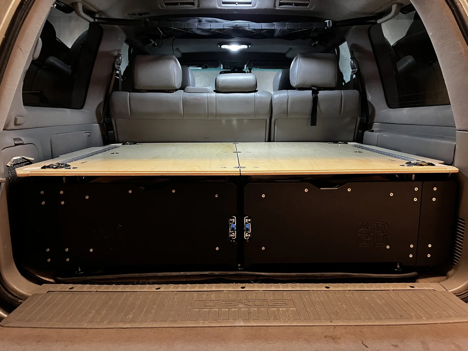

Installed and carpeted an Air Down Gear Up premier package in the LX.
What receiver do you have for that cutout in the stock bumper? Need to buy one..

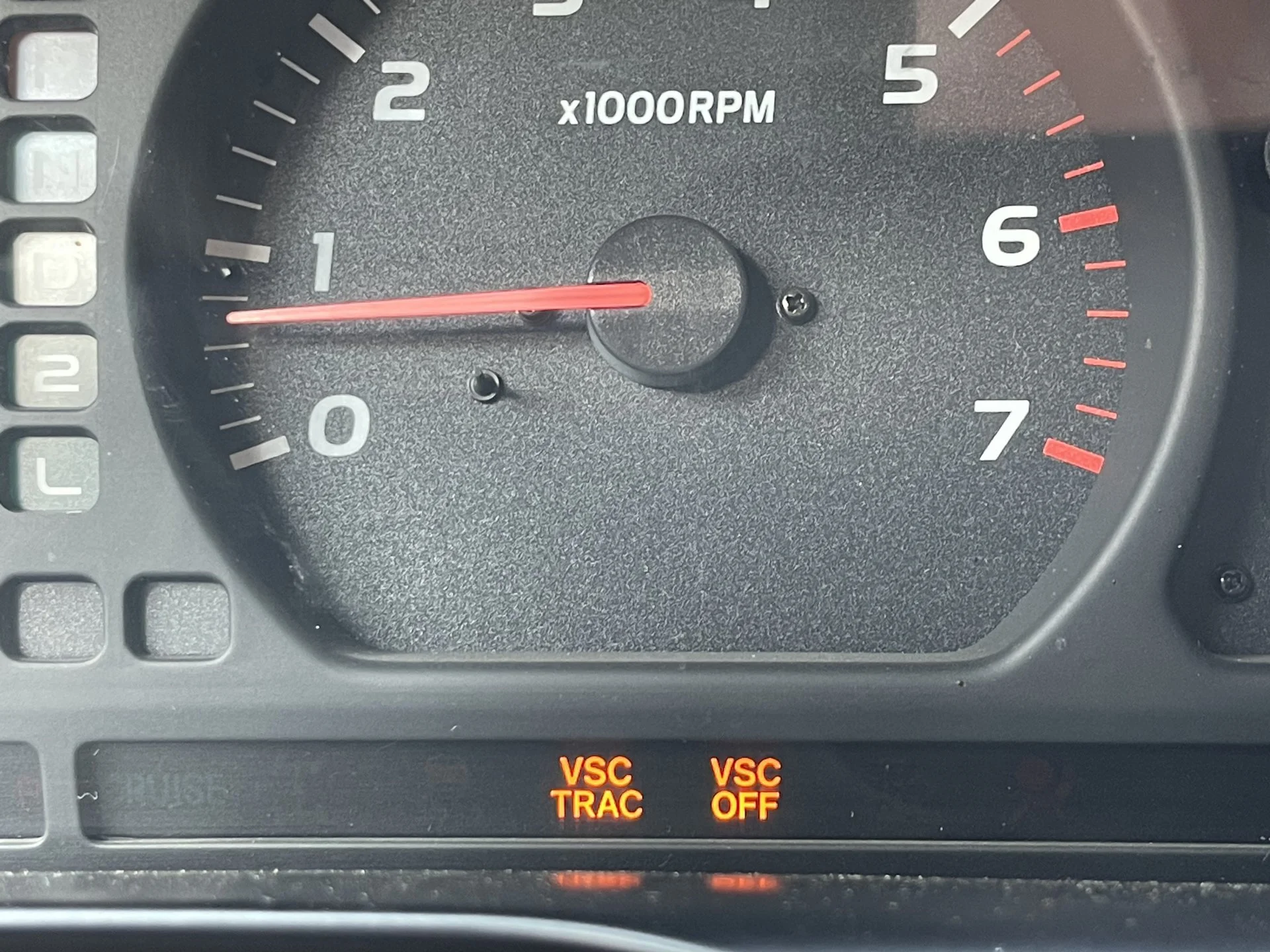

After I turn off the Diff Lock my VSC lights remain on. The only thing I found that works to get them to turn off is turn key off and restart. This is on a 2000 LC. Am I doing something wrong? Hoping this is something simple like a fuse.
A couple of thoughts: Have you run an OBD II scan to see if there are any codes? Also, if there is a TRAC button try pressing that to see if that turns off the lights. The most likely scenario is probably a code of some sort. Any number of things can activate those warning lights. You could also pull the negative battery cable for 20+ minutes and reset the entire vehicle. But I would try to find a solution/code before doing that.
This happens to me intermittently as well. I believe the computer is losing the signal to the diff lock switch which trips it. I’ve noticed no loss of functionality on the trail (ATRAC still works) so I stopped worrying about it.
