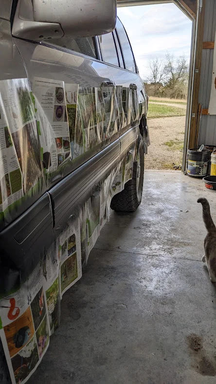

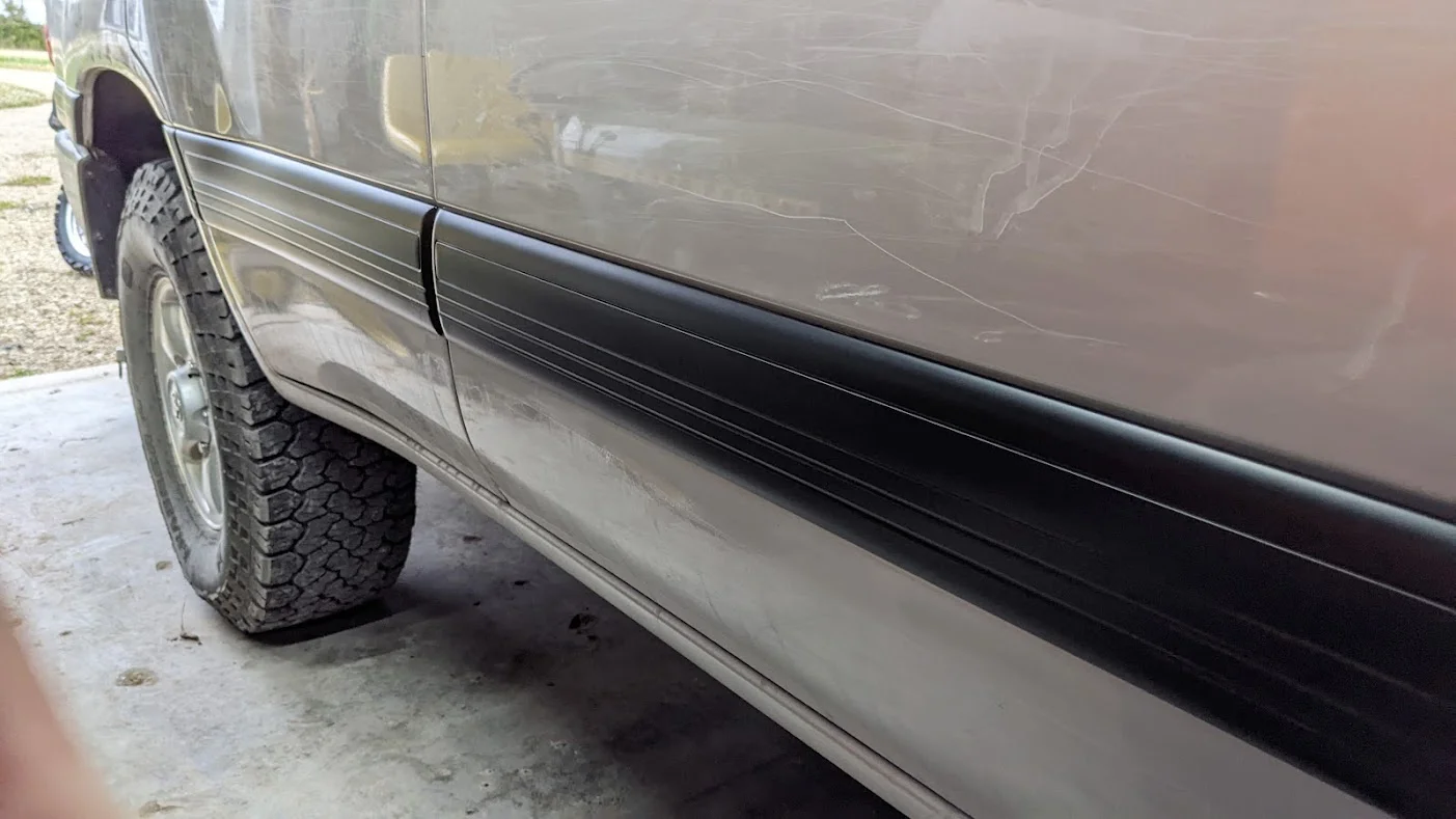

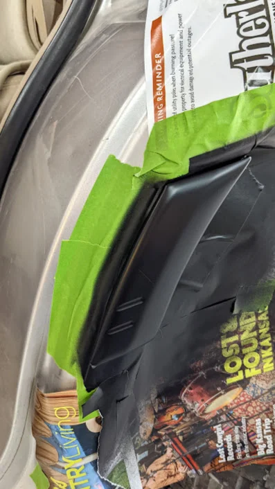

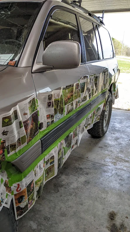

I tackled the really unattractive paint peeling and mismatched door trim on my '99.
Cleaned, scuffed, wet sanded, cleaned (again) and taped off.
I used SEM Trim Black paint. One can did 3 coats.
Don't forget to tape off inside the door jambs unless you like overspray.
This paint takes 2 days to harden. I hope the trim paint isn't too glossy once I get it out in the sun.
...hmmm, maybe I should buff all of that pinstriping. On the other hand, I would just pinstripe it again :hillbilly:

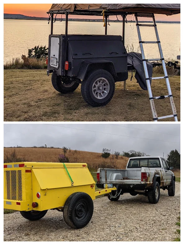

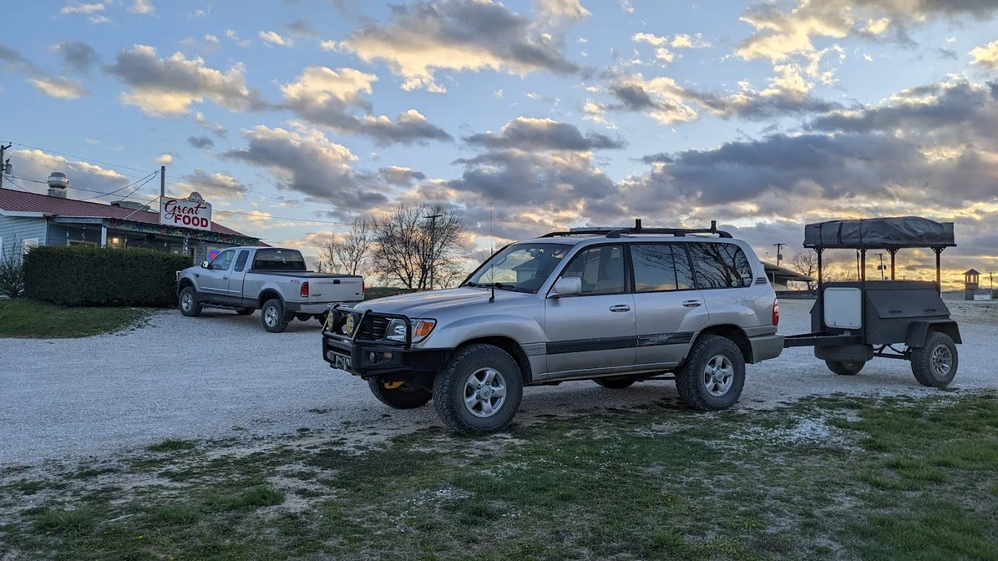

Can you tell me a bit about your trailer setup? I haven't ever really looked into something like that but yours caught my eye.
Thanks. It is a retrofit project I put together last year from an old 1960's welder trailer.
Thanks. It is a retrofit project I put together last year from an old welder trailer from the 60's.
Aha. I thought the trailer shape looked familiar. Thanks! And your fresh trim looks nice. I need to do the same to mine, but can't decide which route I want to take: try to make it look original, or match the paint, or maybe even try some 3M material.

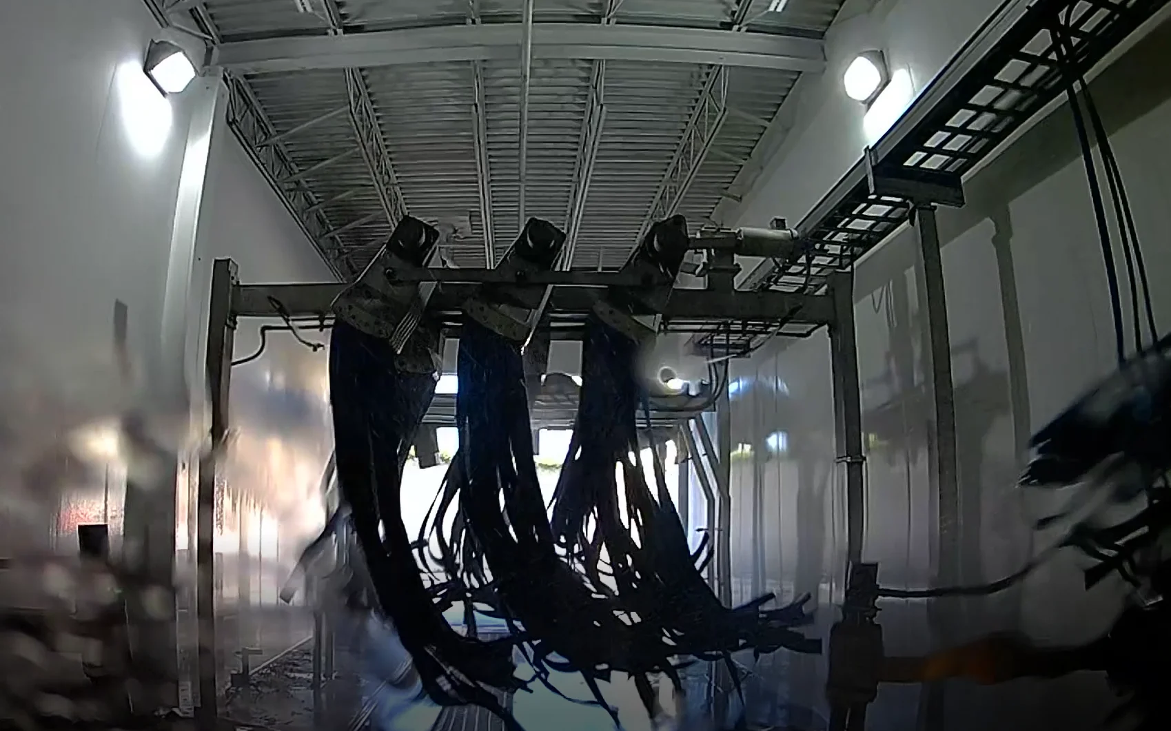

Finished off the front end work with a Hunter Hawkeye Elite alignment at the stealership.
I think the mechanic working on the alignment enjoyed working on the LX. I cleaned the undercarriage and frame some weeks ago. Completed the LCA/UCA/steering knuckle area cleaning (grease puked from old CV boots) before I put the front end back together. Said "it's brand new" to another mechanic before taking the LX out of the shop (yes, CVs and steering rack are new!).
Not sure how the Hawkeye Elite works, but he got it all "green" in 20 minutes and proceeded to wrench for another ~20 minutes before taking her out of the shop for a road test.🤣
$99 with a loaner and car wash was a pretty good deal.
