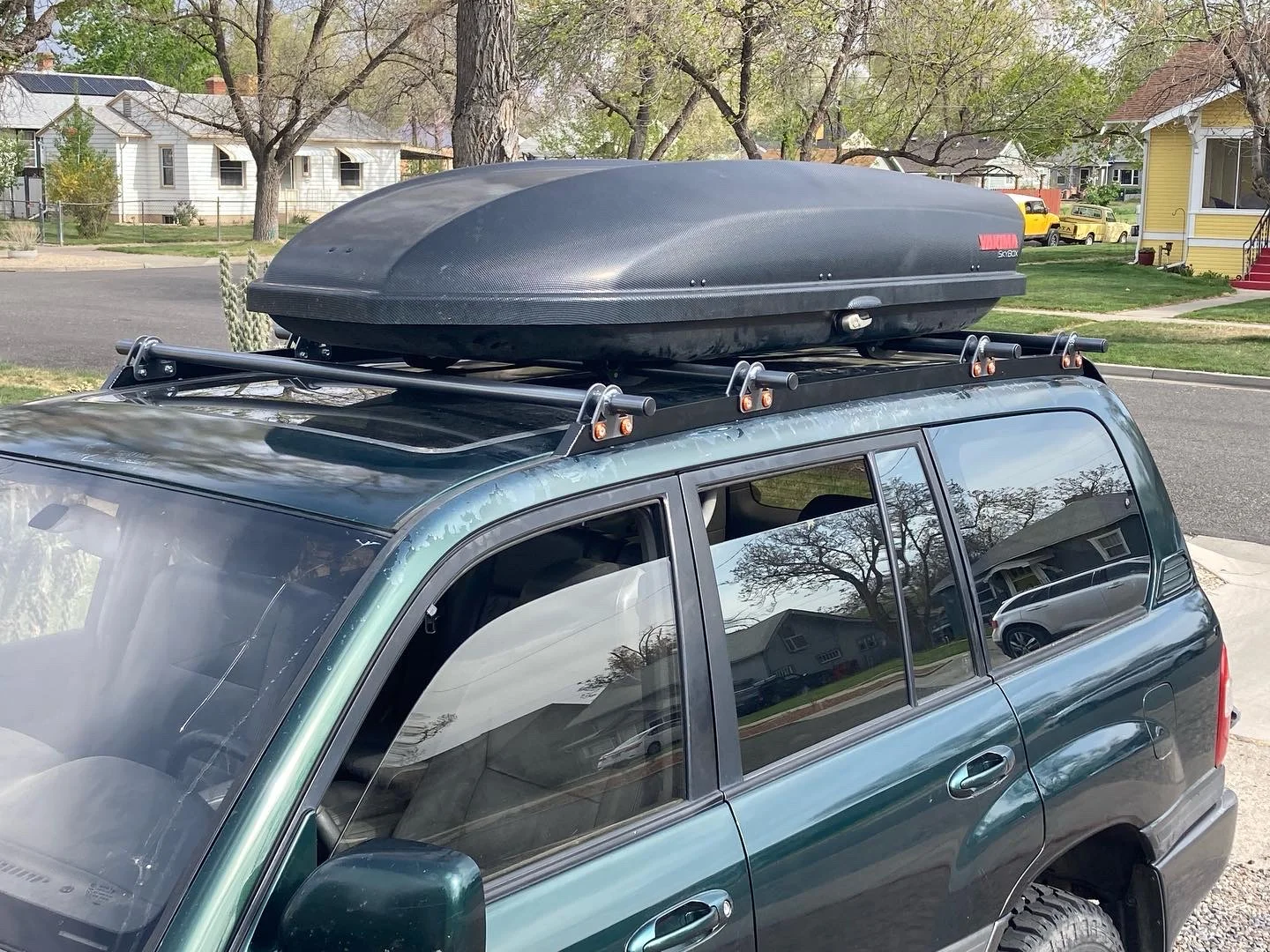

I made an all aluminum roof rack to replace my janky factory one. I mostly just need crossbars for my Yakima box and things like that. Did a trip to Denver and back and it passed the test but proved to need a front fairing to cut the wind vibrations.
You should be able to get a Yakima or Thule to fit on that front cross bar easily.

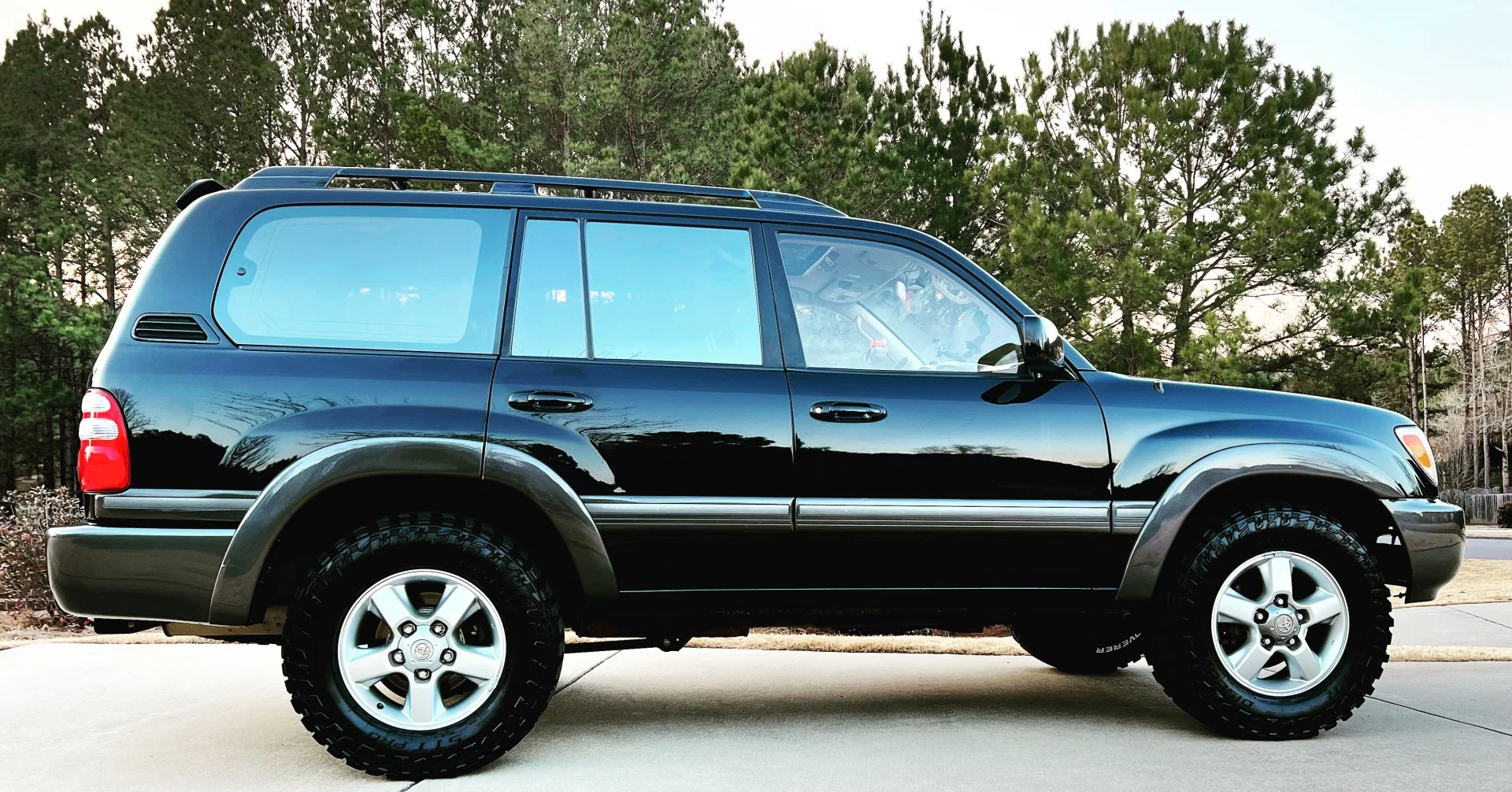

How are you getting the marks out? Do you have a buffer? Looks great btw.
Thanks! Yeah, a buffer and the 3M professional three-step paint correction system. A couple tiny places will need some paint touch up with a toothpick or whatever. It won’t end up perfect but it will be a lot better than when the flares first came off. I did this to my 2000 LC also. It was champagne pearl so the marks didn’t show as much.

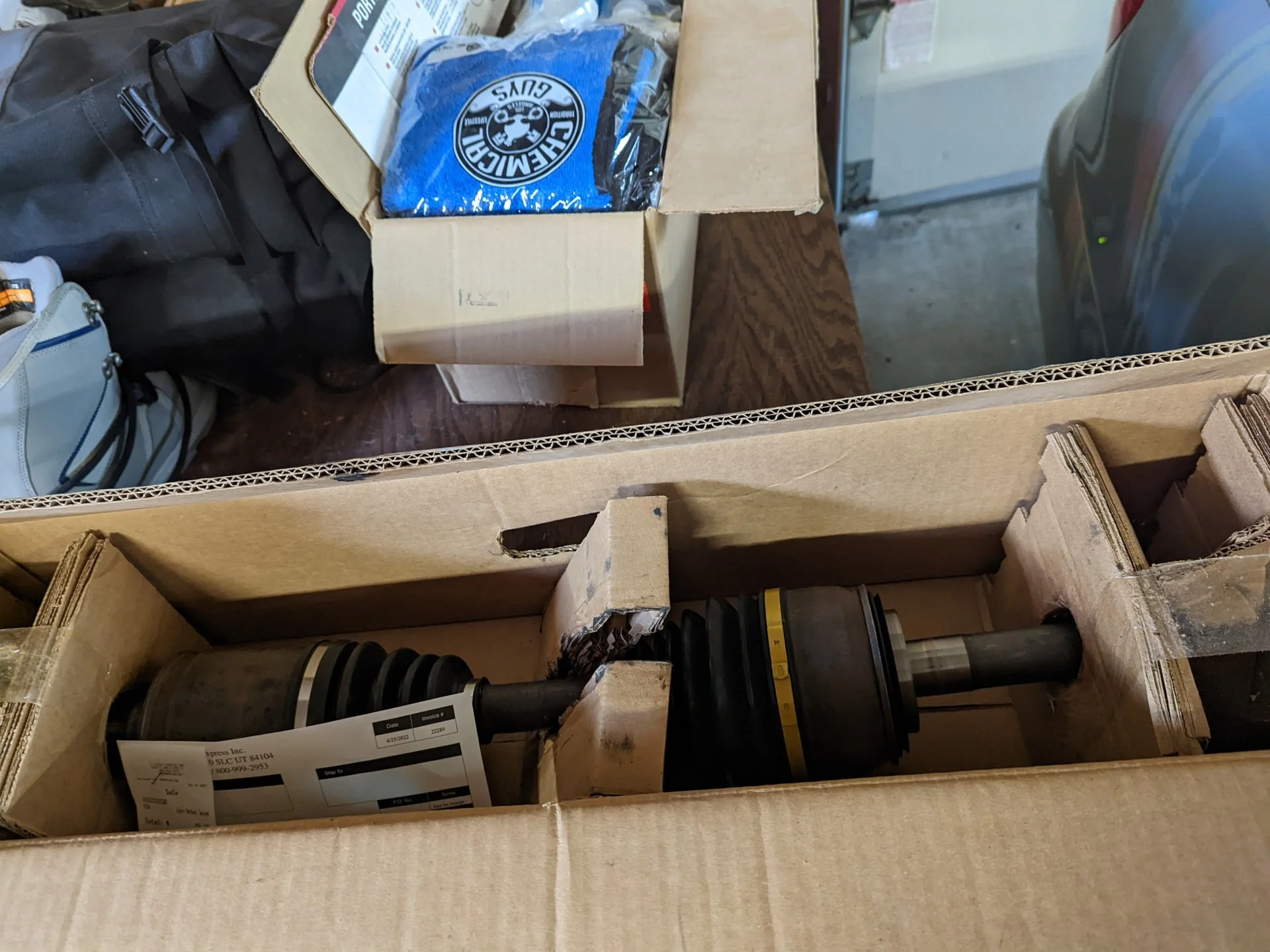

New guy here. just got a 05 from the inlays with a host of long put off repairs. started today by replacing the door lock actuator motor so that one of the doors works again. couldn't have done it for cheaper had it not been for a handy thread on here showing me where to find the motors, and I still managed to buy the wrong ones or my actuators are different than the other 100 series. next up are the CV axles. hopefully those aren't too bad. shop wants 2k to do both sides with OEM.
What is wrong with the cv axles? if boots torn, just go to toyota and get a kit, it will come with boots, bands, and grease. Not a bad job, a few hours and getting dirty.
leaking from the diff side, both boots torn on both sides, and only 12k miles on them. id like to go back to OEM. those lasted way longer with no problems. I figure if I'm already ripping into them to the diff, I might as well put in the equipment I hope will be problem free longer.
