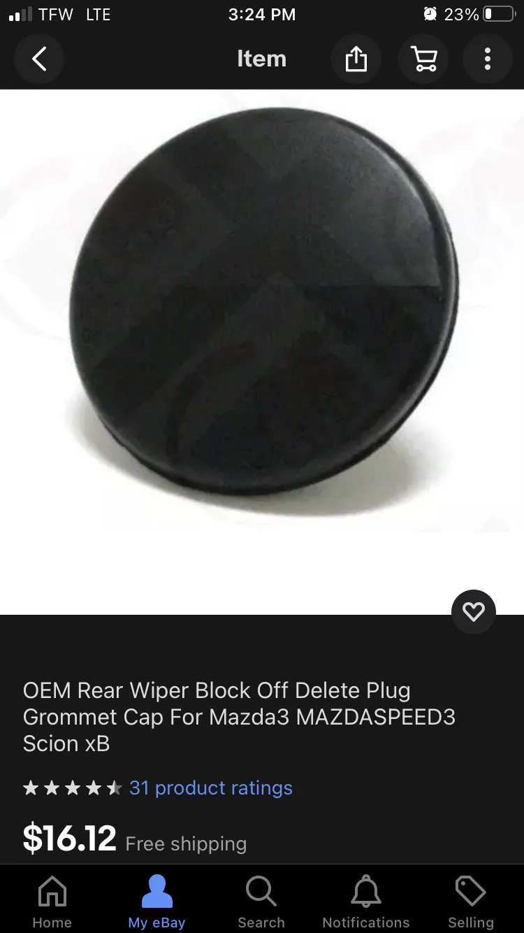

Rear wiper - you mean wiper delete? Do they have such a kit? I have a Golf R and they sell a delete kit for that one, would be interesting to do that on this tank.
Not that I found, but if you remove the motor and arm there is a Honda plug that works. I did the rear wiper delete to mine using it. I’ll see if I can dig up the part number for the plug.
Found what I bought on eBay:

thanks for this, i you find the other link send it my way please.
with regards to wiper delete how you find the rear visibility in rain etc? I mean i live in socal so we dont see much inclement weather lol, just curious

The only time I have had any visibility issues have been snow related or fogging. Obviously fogging is remedied easily, as is snow removal before travel, but honestly I drive my Cruiser to work and sometimes a quick run to town. We mostly drive our ‘16 4Runner due to the fuel mileage being better. It has the same 4WD as the Cruiser as well, so that’s a big plus.

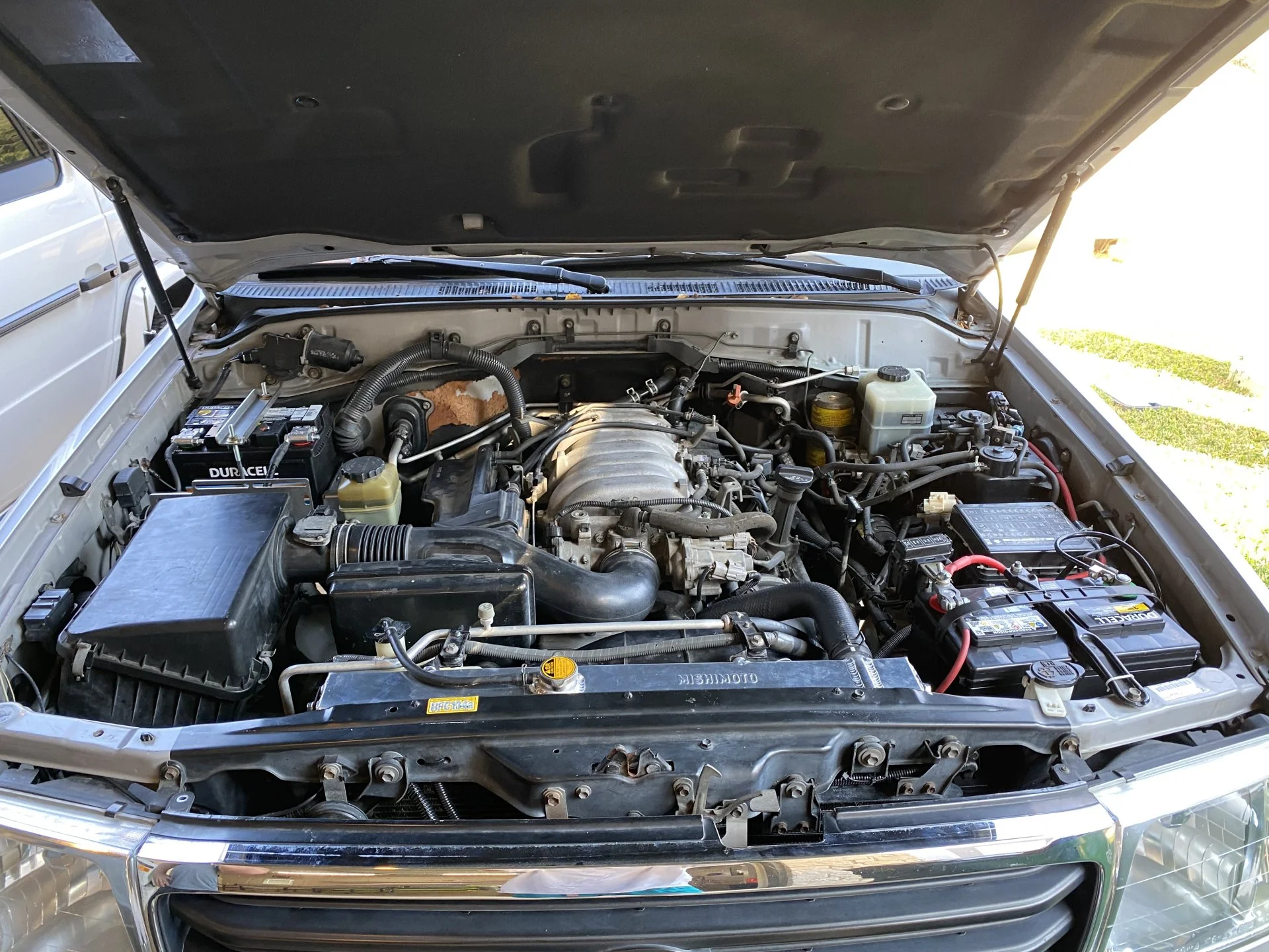

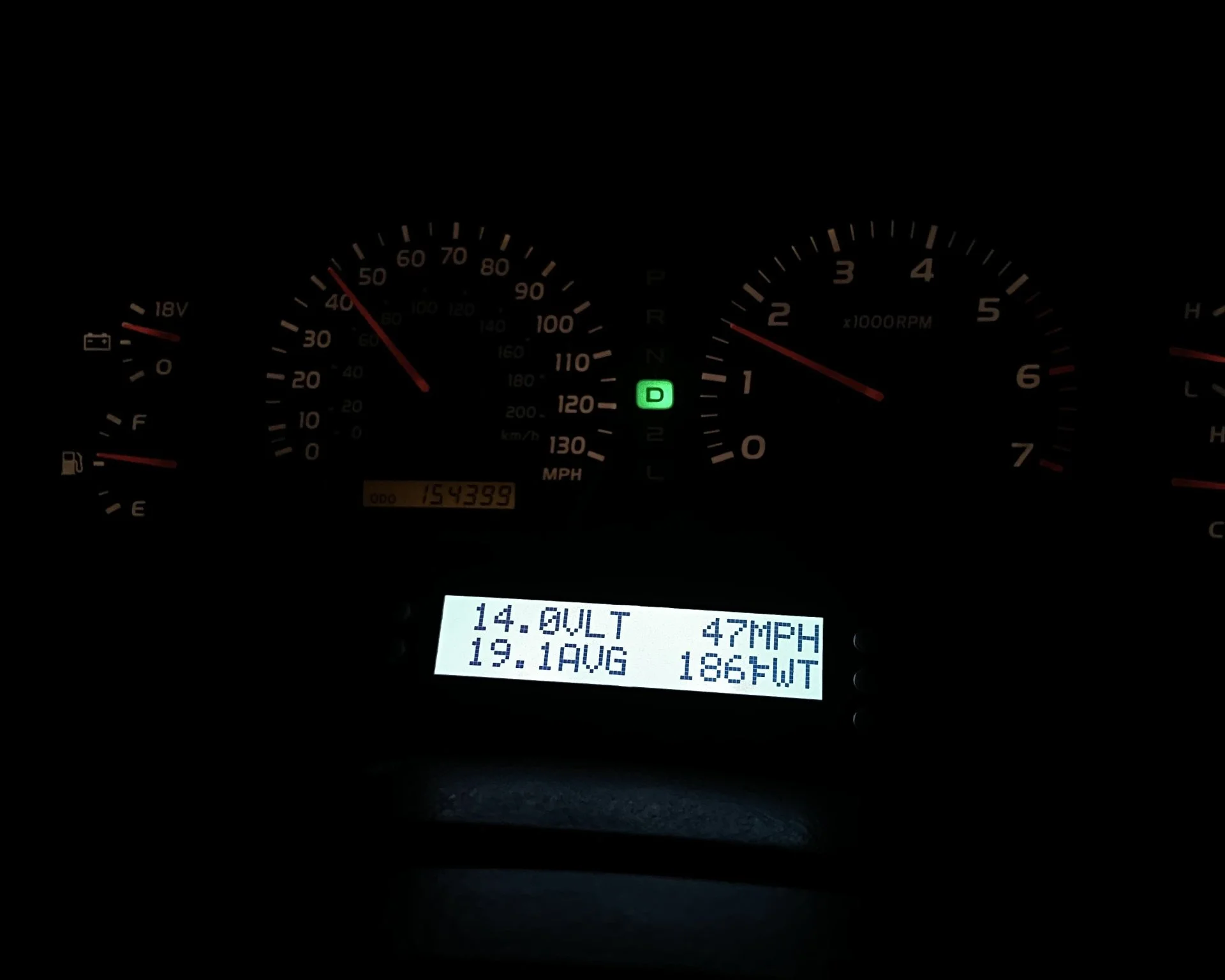

Installed a Duracell AGM from Sam's as second battery in Slee tray using a Redarc charger. Used the Redarc 100 series charger bracket which places the charger behind the grille. I had to bend the bottom bolt hole on the bracket to make it line up with the hole on my 100. Oh, I also got 19mpg!

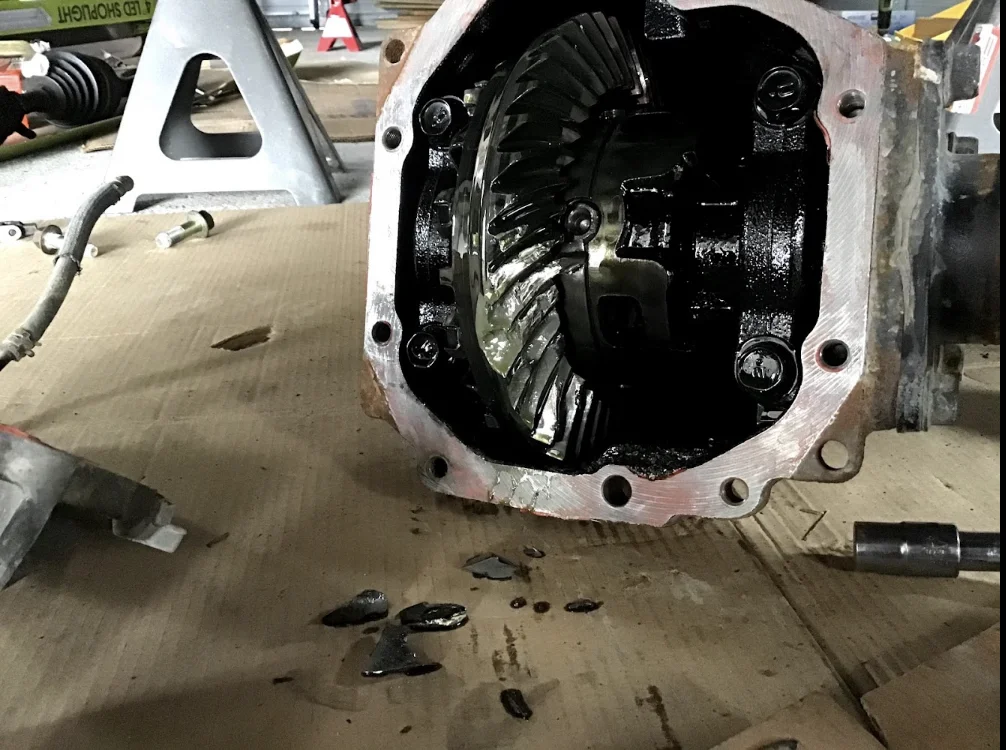

Got my cruiser towed. Saddest day of my cruiser life...
We were wheelin' around in the snow. Got into a ditch doing a u-turn and when climbing out heard a god-awful snap, whine and clunk coming from front end area. 4-Lo but the CDL was off (I just forgot to turn it on, didn't need it for where we were so I guess I just never thought about it). Truck wouldn't move, just whine, spin and clunk noises. Turned on CDL and climbed the rest of the way out of the ditch. Limped back to camp with a clunk/chunk noise every few rotations then limped to gas station (about 3-4 miles from camp area) with the noise getting louder.
Plan to dig into it this week. Fingers crossed it's only a shaft or splines but the noise pattern makes me think it's the diff. I've been reading up on front diff threads but any suggestions on the order of teardown to find the issue?

It happened to me in a snow bank, too, and sounded exactly as you described. I went with Nitro Gears and ARB airlocker (since it gave me on board air). I had @cruiseroutfit rebuild the diff. I did everything else. A few tools and one other person when reinstalling (my daughter helped route the breather).

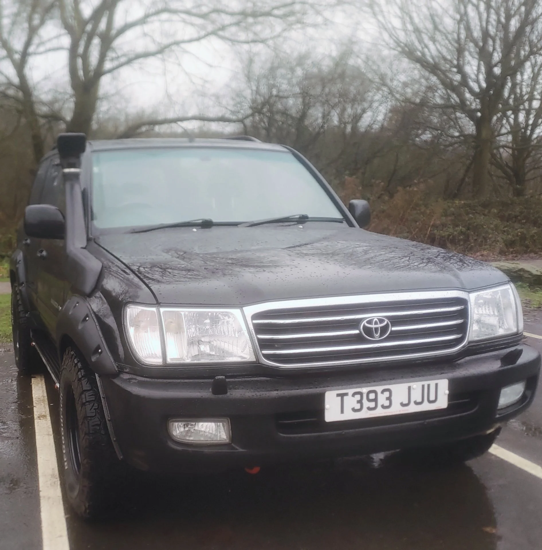

This week a snorkel, new steel wheels with a o offset, window draft reducing things, black side indicators, new DAB aerial and fitted the dash cam.
Trimmed the arch liner and front of the bumper lip to accommodate the wider stance and generally turning it into my truck and not the PO.

Did you notice reduced wind noise from the window draft reducing things?
