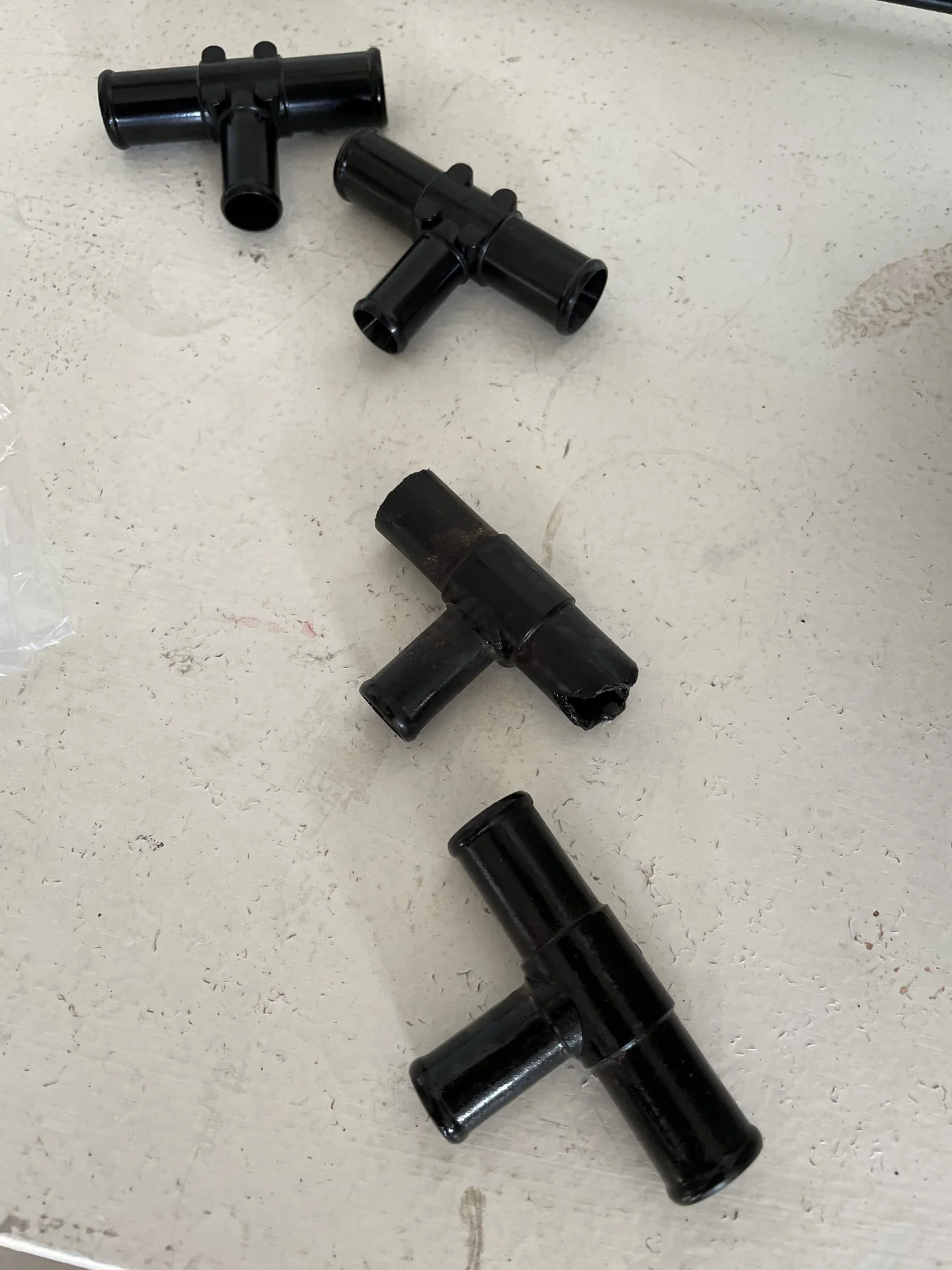

Replaced heater tees, changed the oil, and installed a new rear wiper assembly.

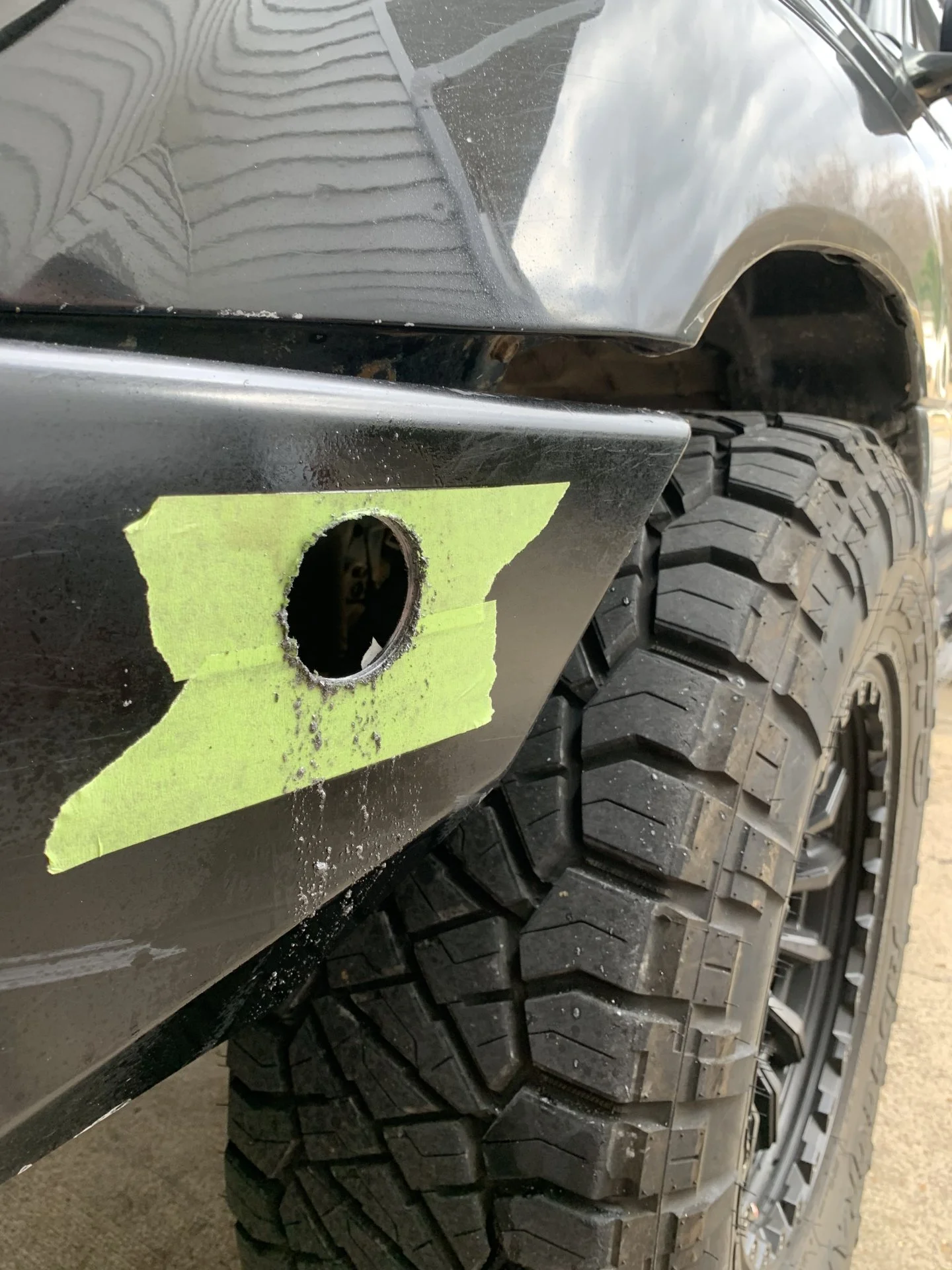

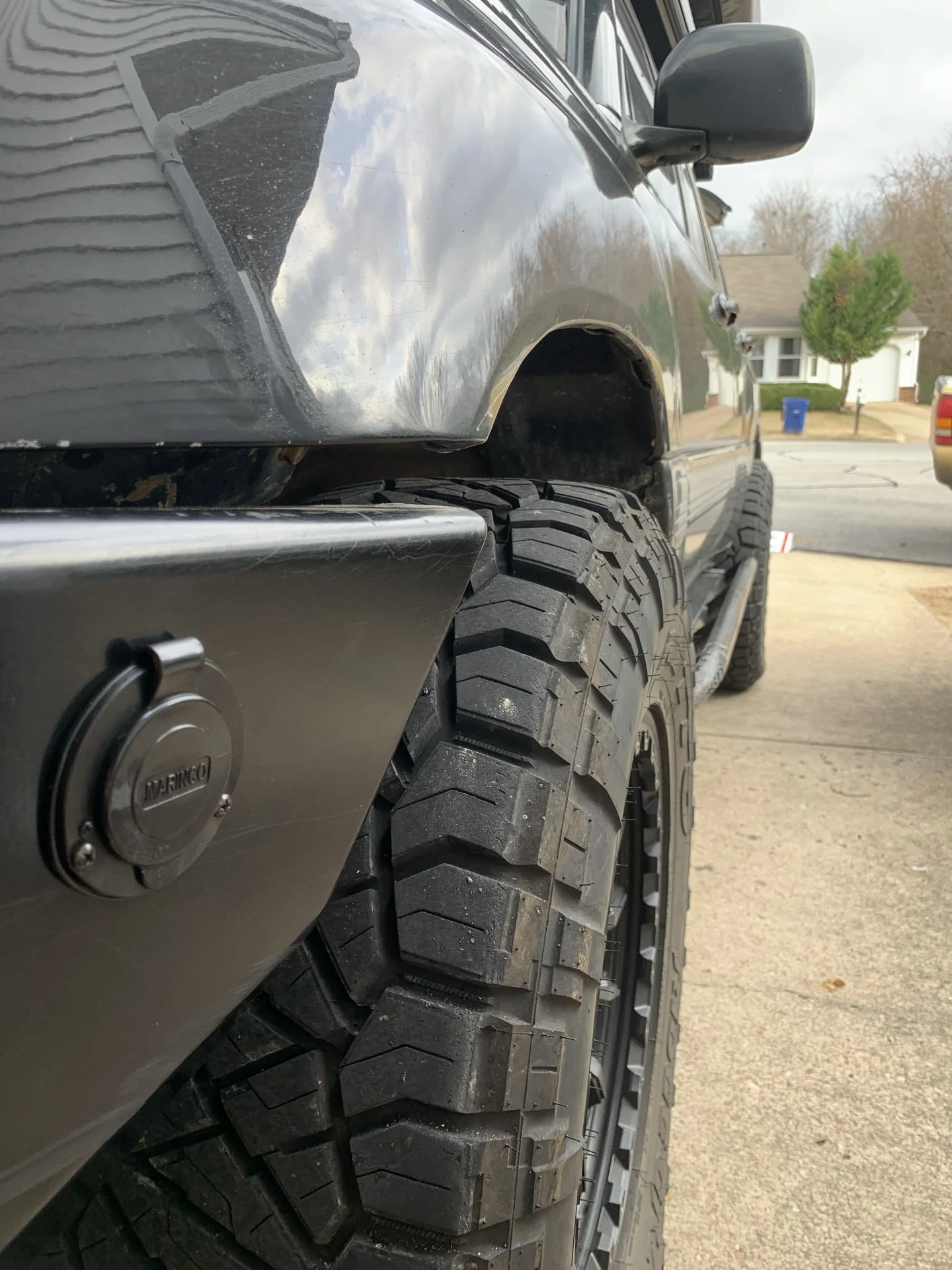

Nice—I put mine in front of the LHS headlight, same effect. And yeah, I've ripped the cord out of the wall more times than I'd like to admit 🙄
This is why mine is in the front bumper, and I back out of the driveway so it will unplug itself if I forget.
