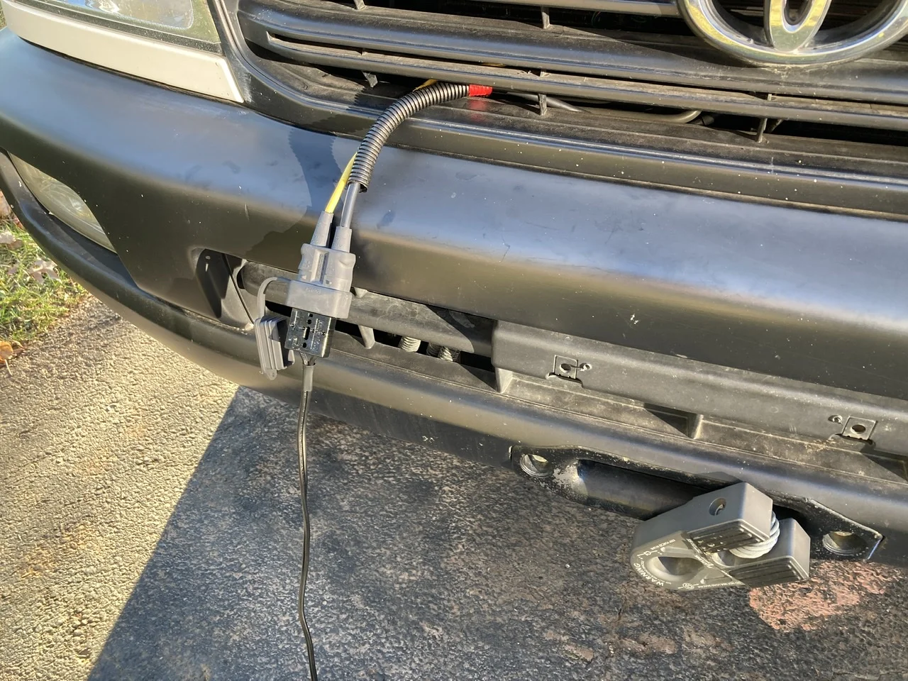

Completed my Redarc TowPro install. Pretty proud of the OEM switch look.

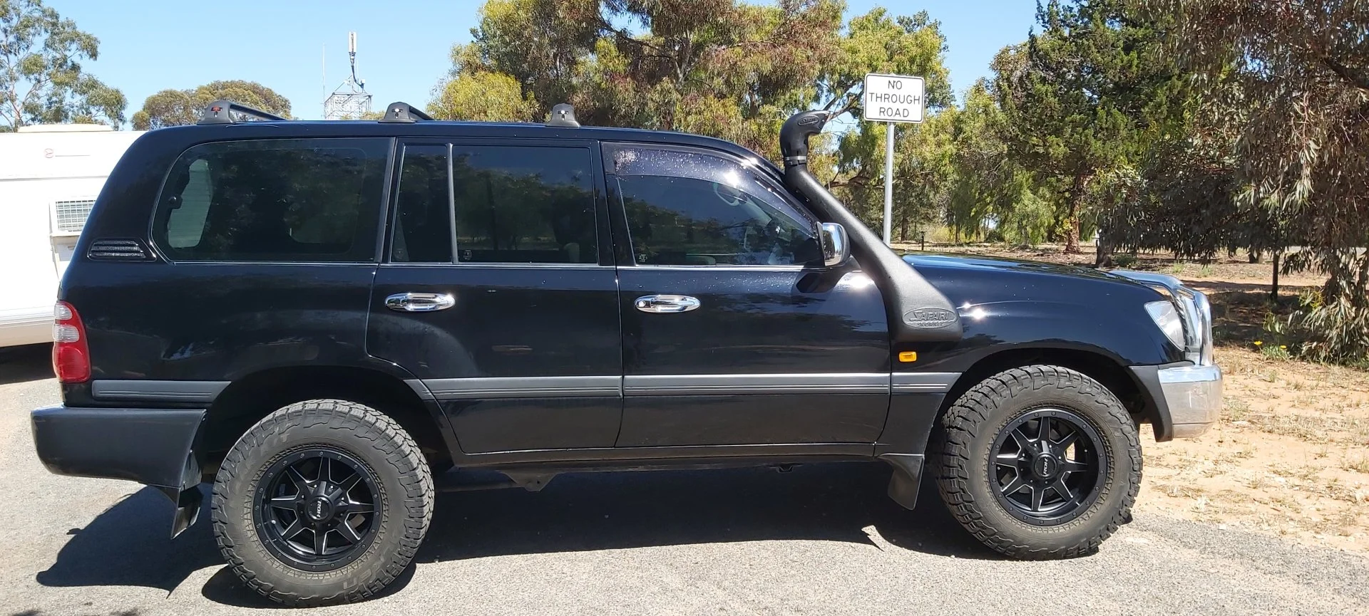

Upgraded tires to 285/75r16 on stock 16 wheels after the suspension upgrade (ironman foam cell pro+ SPC UPC). After the project i don't think i will need a aftermarket wheels as i like the look.
Such a good size for the stock 16" wheel, you can always add a 1" spacer if you want a bit less offset.

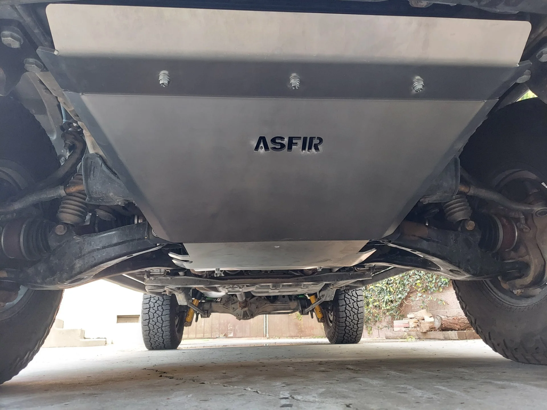

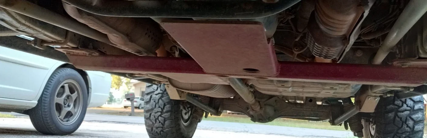

@TRAIL TAILOR Front diff drop installed. Best part is I didn't have to alter my ASFIR skid plate in any way. Used the Trail Tailor bolts supplied with the kit for the skid plate. Did not use the skid plate spacers.
View attachment 2860318View attachment 2860319View attachment 2860320
It looks like you are ready to have some fun off-roading or whatever you want to do. I did exactly the same thing with my TT drop diff and Asfir. No spacers. No regrets.
My skid plate takes a serious beating over rocks. Depending on how hard you are planning to wheel, the TT creeper skid works well.
I understand Jason just made up a few creeper skids for the 100 series. @TRAIL TAILOR
I know I need it for the occasional rock crawling I do. Not in the budget at the moment, but definitely on my future mods list. The mods never end haha. :cheers:

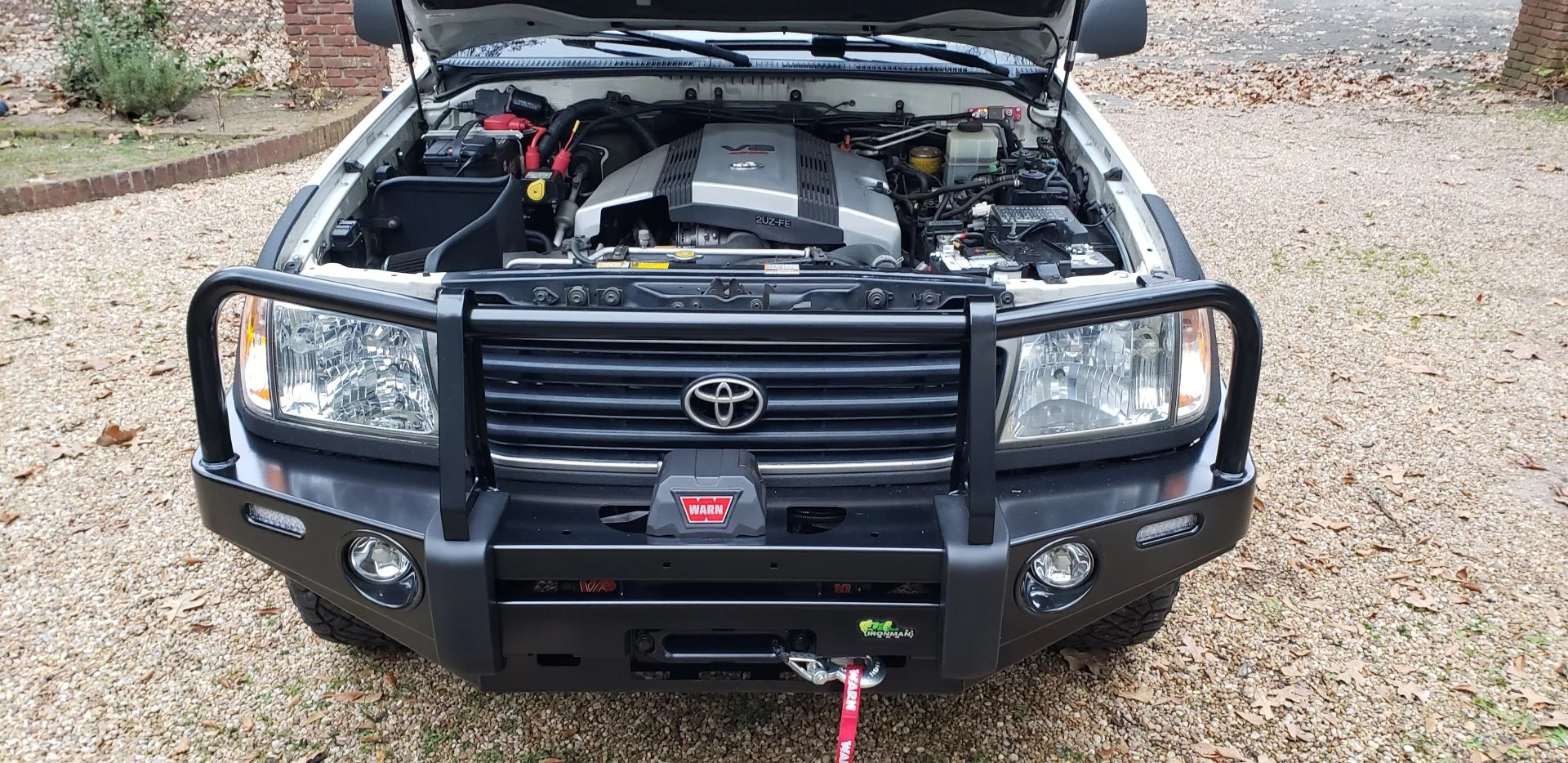

I installed my new Ironman 4X4 classic bumper, Warn Evo winch and SDHQ battery connections. I've owned my LC for close to a decade and these are the first major mods I've done for quite a while. The desire to get outside more his re-kindled my interest in the LC, and the members of the forum are an amazing resource for knowledge and insights. Thanks!

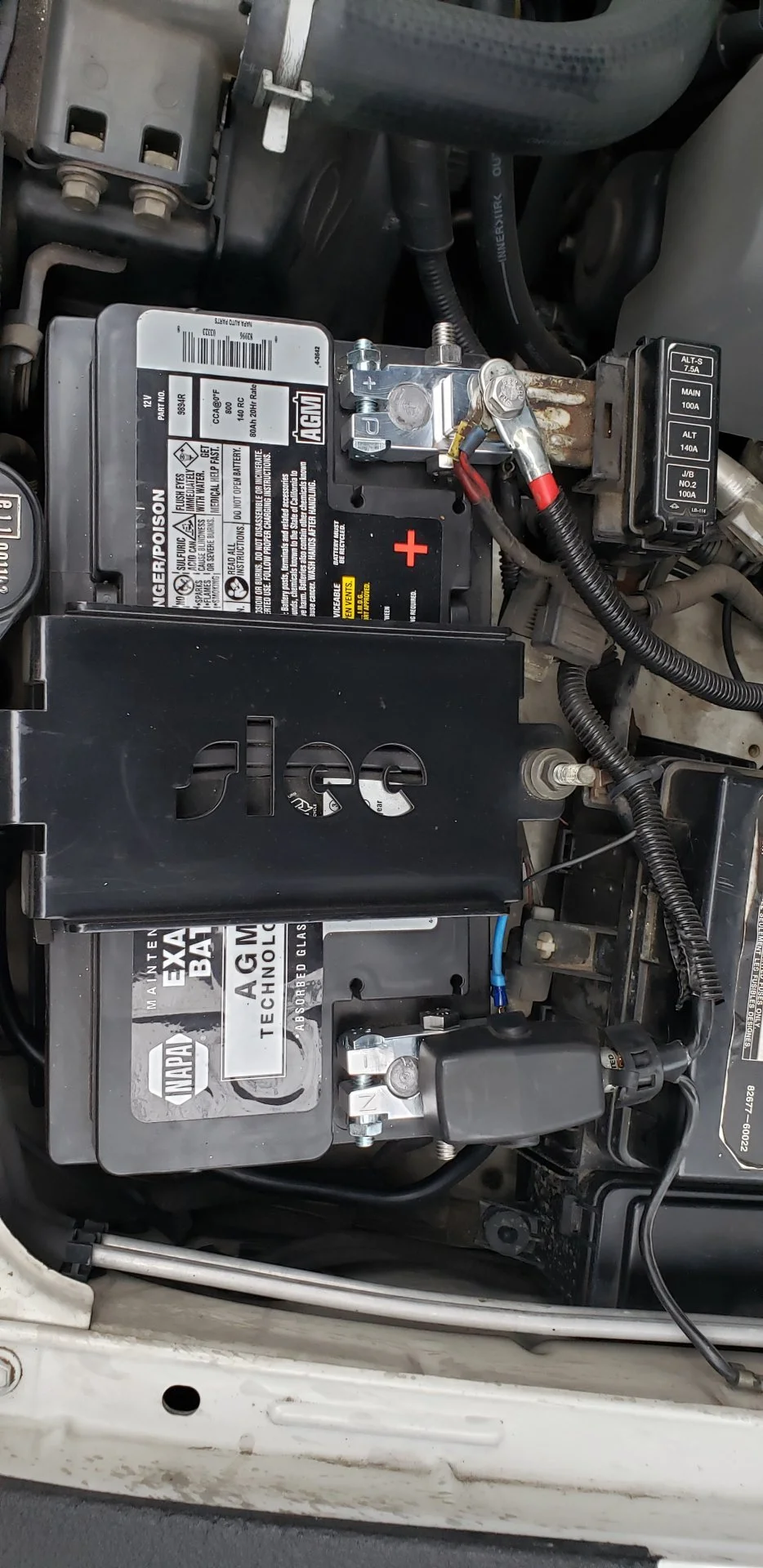

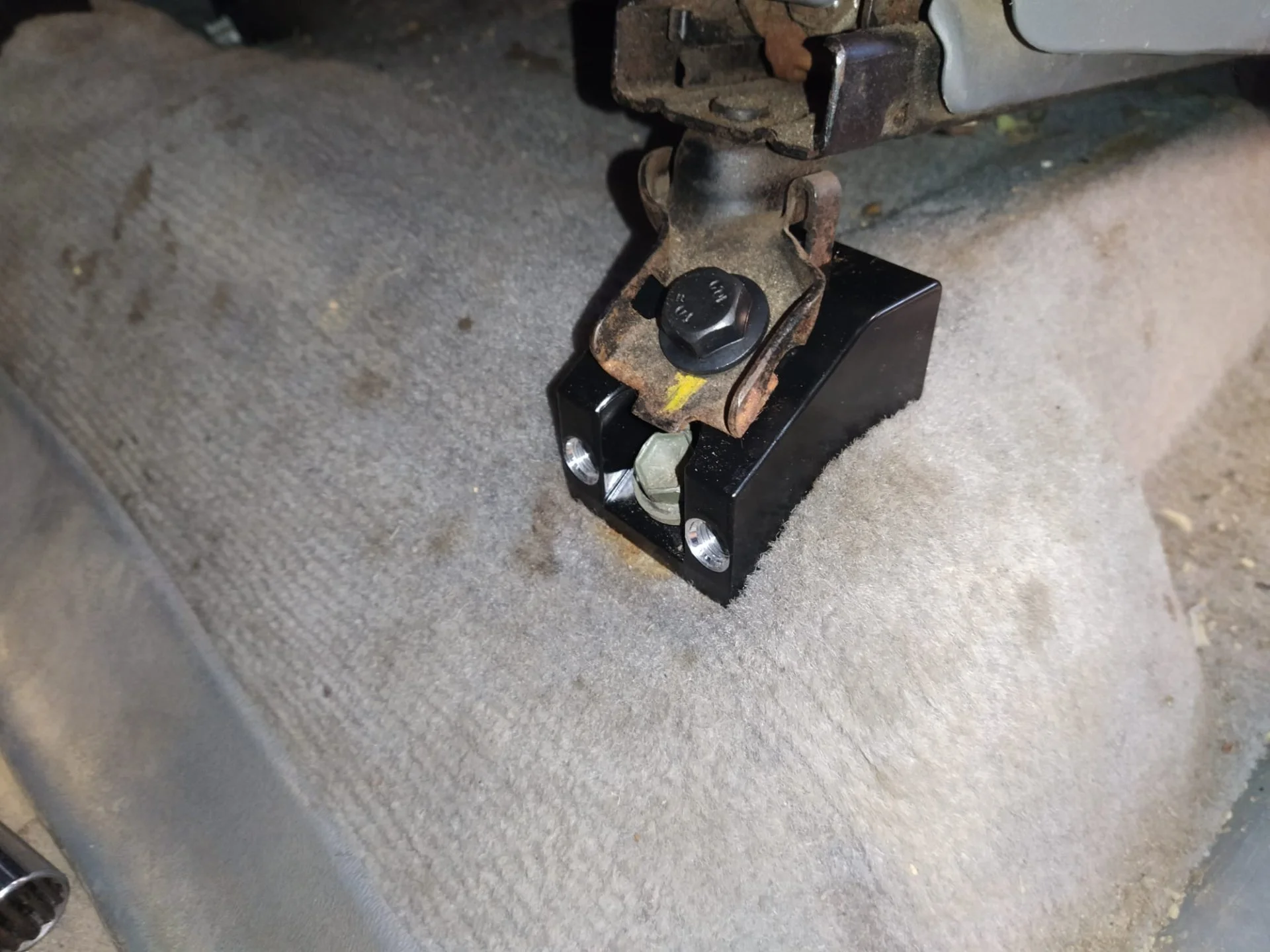

Also Installed Seat Jackers from Desert Does It, I like these things.
Those front seat lifters, which product are those on their site ? link would be nice. This would solve my low seat height !

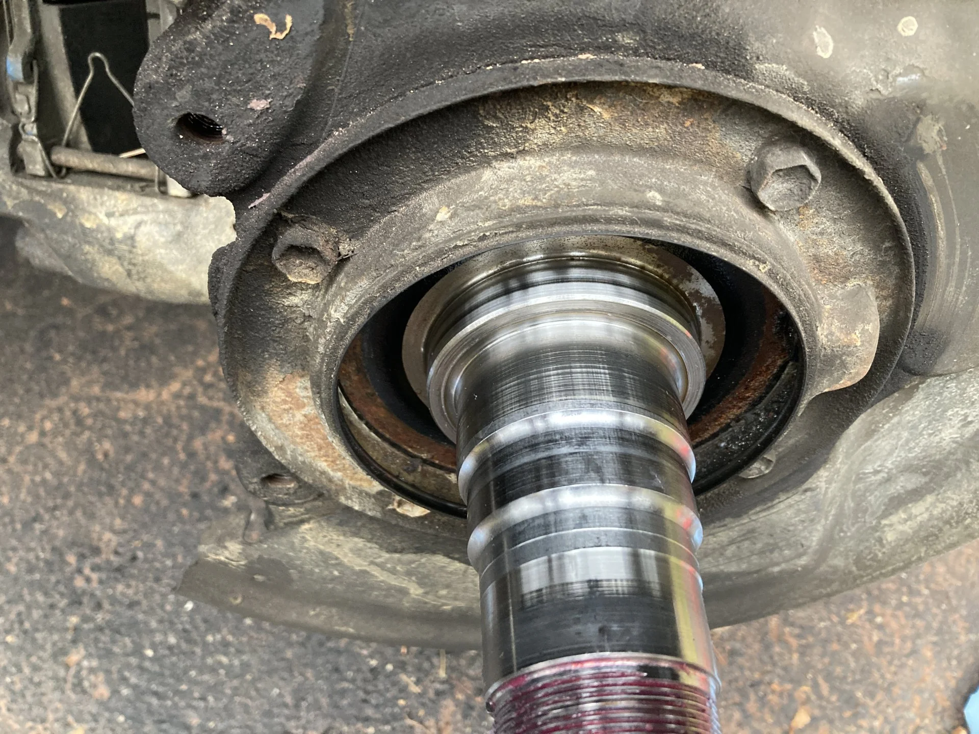

We’ll I’m getting fast at hub work. After replacing RF steering knuckle and bearings I decided to replace the RF bearings with koyo/Toyota, assuming they were Timkens like I found on the left.
Got it apart and noticed that bearings have spun previously on this spindle too (it actually looks worse than the left one!)….did not notice this when I repacked them a month ago. So I buttoned everything back up and ordered another knuckle.
Makes it feel like less of a wallet blow to order the two knuckles separately, so I guess that’s the silver lining…..
Thanks for sharing. Definitely, something to keep an eye on.

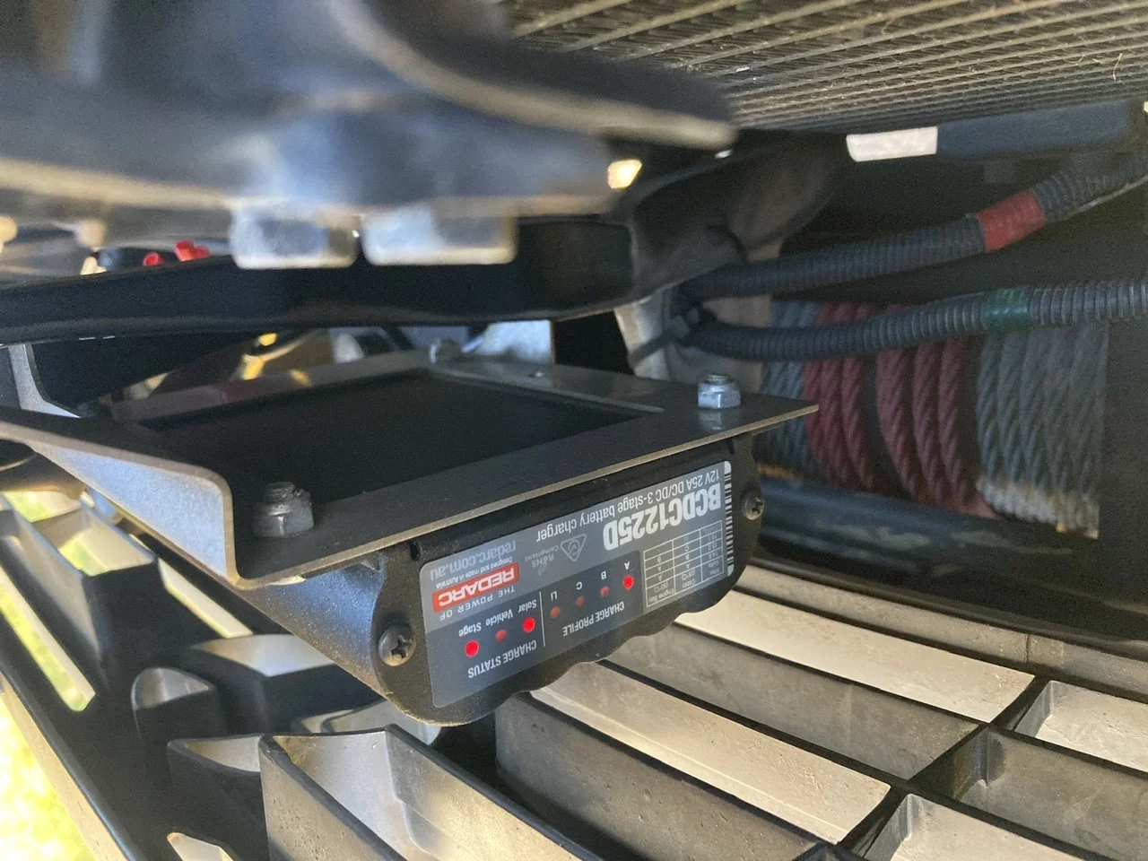

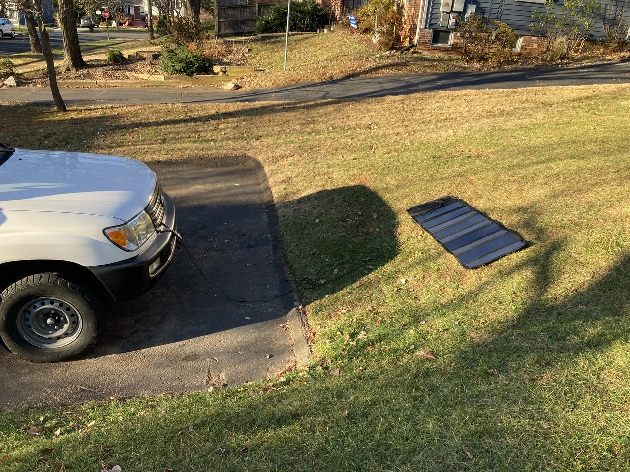

Anderson Powerpole day. Wired up my Redarc BCDC to connect my Overland Solar Bugout 130 solar panel.
