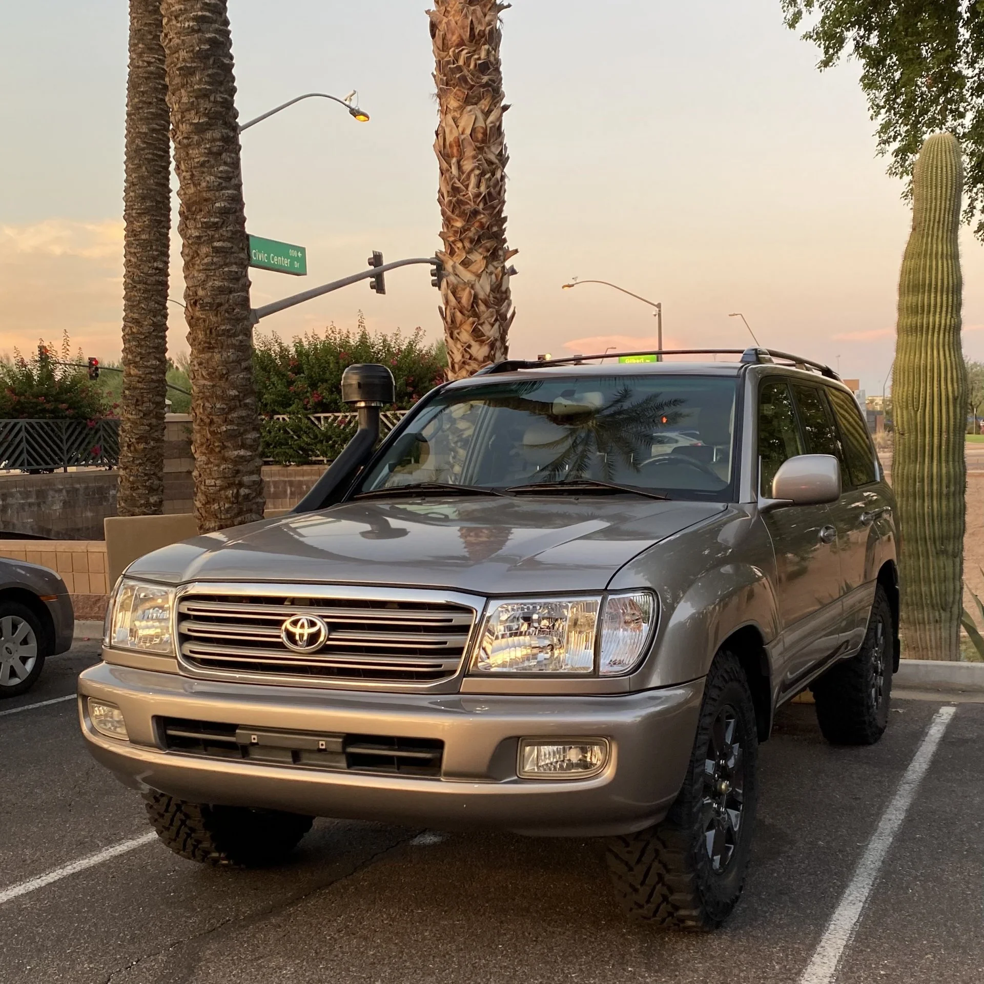

What’s your secret to such a clean engine bay? What’s your detailing/washing routine?
I've found that once you have a baseline clean to work from, it's pretty easy to "touch it up" on a regular basis. In my case, I gave it a thorough cleaning when I first got it. But my general approach is this: I like to use a hose spray attachment with a mist setting for getting the bulk of the dust off first--being careful around electronics. I'll use some microfiber rags and a toothbrush + Simple Green to get the grime off. I rinse it again. Dry it with clean rags or compressed air or even a leaf blower (seriously, it works great!) Then follow up with Auto Drive Ultimate Cleaning Wipes (30-pack from Walmart) which cleans the plastics and rubber components keeping them looking nice and new without leaving behind a greasy residue. To be clear: no Armor All or similar! Hope this helps.
Pei Wei parking lot flex. 😆

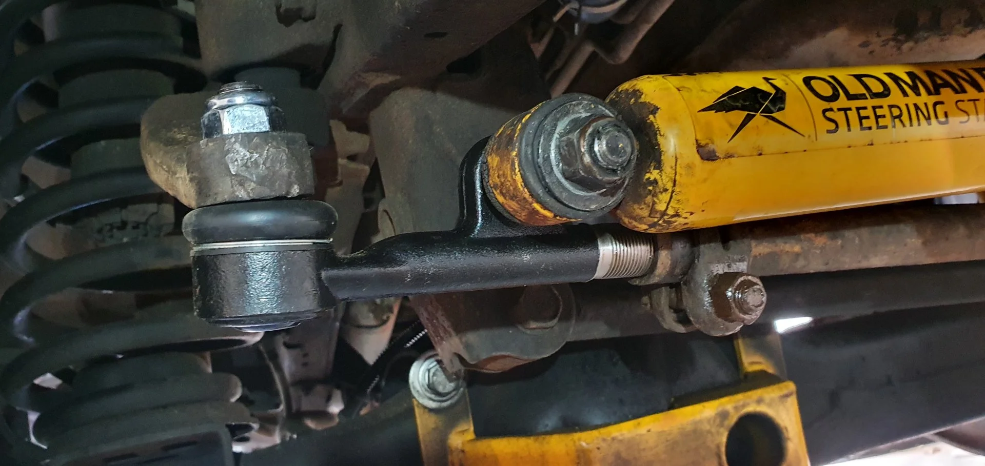

Replaced the tie rod ends. Surprisingly they came out for the most part without struggle which dropped a few bananas off the difficulty scale, now to find a decent alignment shop
I have this on my list , any before pics? and after alignment any noticable difference in handling on road?

No before pics just picture it looking 20 years older and a bunch of dirt haha, since I'm not going anywhere for a while I have ordered the ends for the tie rod behind the diff too so I haven't got it aligned yet but expect it to track and steer more positively. Also to mention a while ago I changed the other end which was seized on (prev alignment shop broke the ball out of the joint trying to get it to rotate for alignment). I had to use an oxy torch and a big bar to get it to come loose so don't attempt it 30 mins before a family dinner.. Hopefully with a bit of luck and wd40 it'll be a nice job for you

yeah mines 105 too. I've often looked at those bushes and thought wow, they look knackered (split, some grease visible). thanks for the tip. you have the same OME dampener too. How did that feel when you took it off still viable? I got a little wobble driving but feel a lot like my 35s MTs gripping curvature in road. would be great if it held true

The damper felt still pretty nice and smooth pushing it in and out with some resistance. If the boots and grease are gone, the joint will wear quicker leaving you with loose or vauge steering if it gets bad. Also one more thing to check to help tracking on the road is that your wheel bearings are tight and you can also adjust the preload screw on the steering box if you have excessive steering wheel play

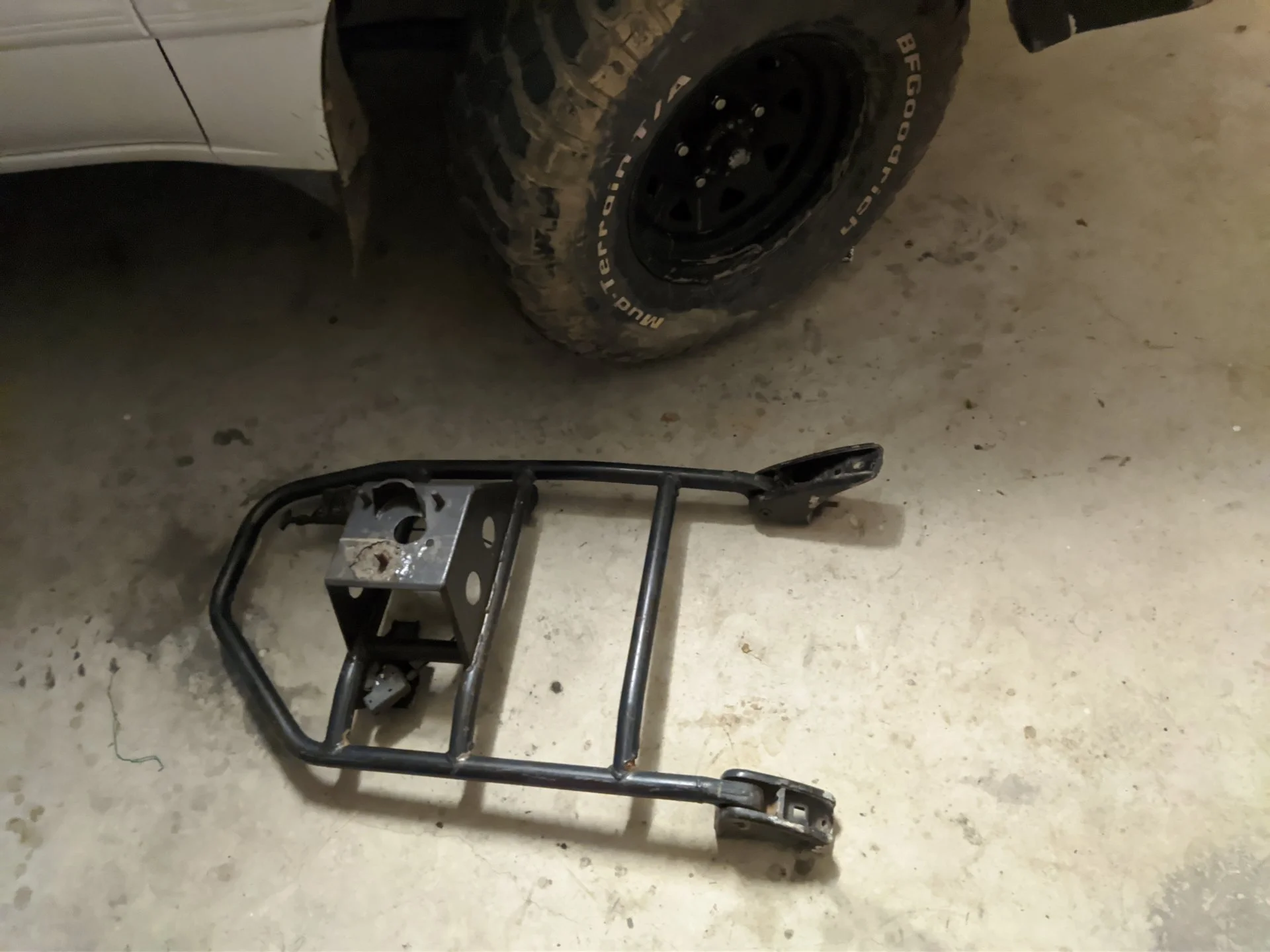

Found this thrown off the side of the road with some other junk, one jerks trash is another mans treasure, I've been searching for one of these to buy!

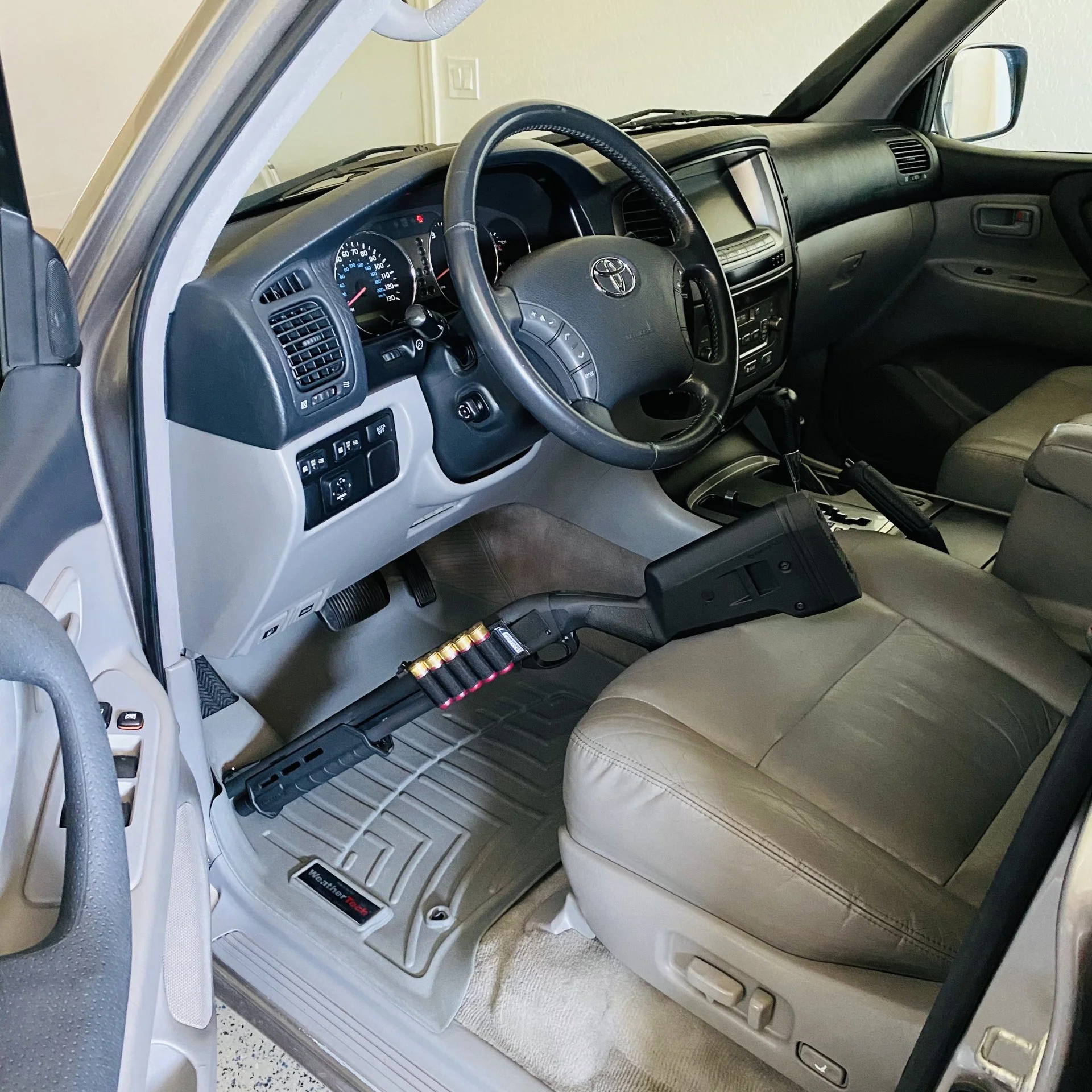

PSA: Make sure you guys vacuum the driver’s side footwell every once in a while. You don’t want debris or objects obstructing your access to the brake pedal, etc. Never know what you could find just hanging out down there.
You had to pull the SG out... what did you find? A racoon? A hobo? :rofl:

Just found this Remington 870 police 14” SBS in my footwell. How’d that get there? 😆😂
I can imagine a few scenario's where that would find its way into the car
