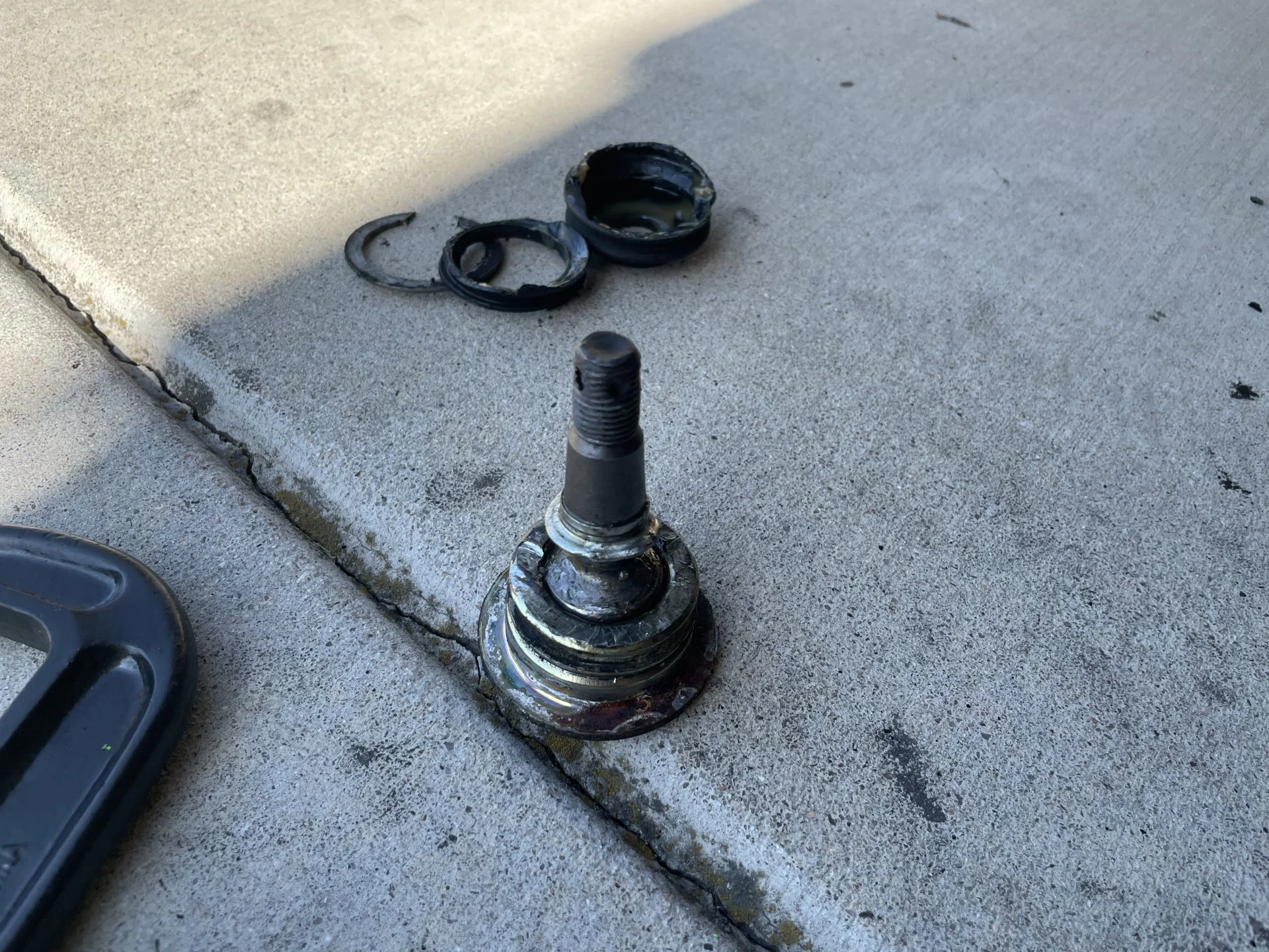

Finally fixed my Drive/Reverse clunk.
After cross country trips, I bit the bullet and replaced the aftermarket CVs with OEM Toyota axles. At the same time I had the front wheel bearings replaced and the front diff support bracket replaced (using OEM part with the integrated bushing). I wish I could say I did these repairs all myself. $2300 parts and labor for a Land Cruiser specialist to replace the CVs with OEM, new bearings and new diff support. It was not an easy pill to swallow, but I believe their labor charges were fair and I sleep well knowing it was done the right way. With one CV boot torn flinging grease, and the other boot heavily cracked plus a vibration around 70 mph that was not tire related - it was time. With the repairs above, all of these issues are gone. Hoping this is the last set of CVs this truck will need, and I will rebuild if needed from here on out!
PS - previously, using advice from others on this forum, I drew a chalk line on my CVs and pointed a camera at them while I sat parked, engine running and shifted through DNR. You could see and hear the CV move and clunk within the drive flange. That is how I knew the source of the clunk on this rig - plus a friendly point in the right direction from Ryan at OTRAMM.

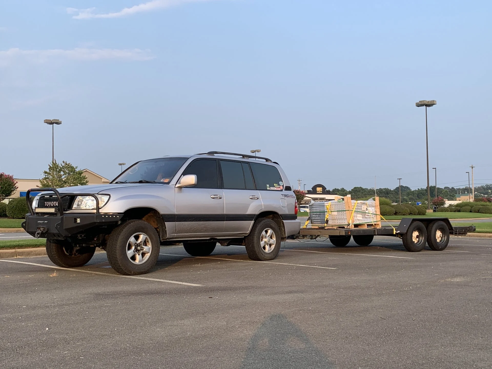

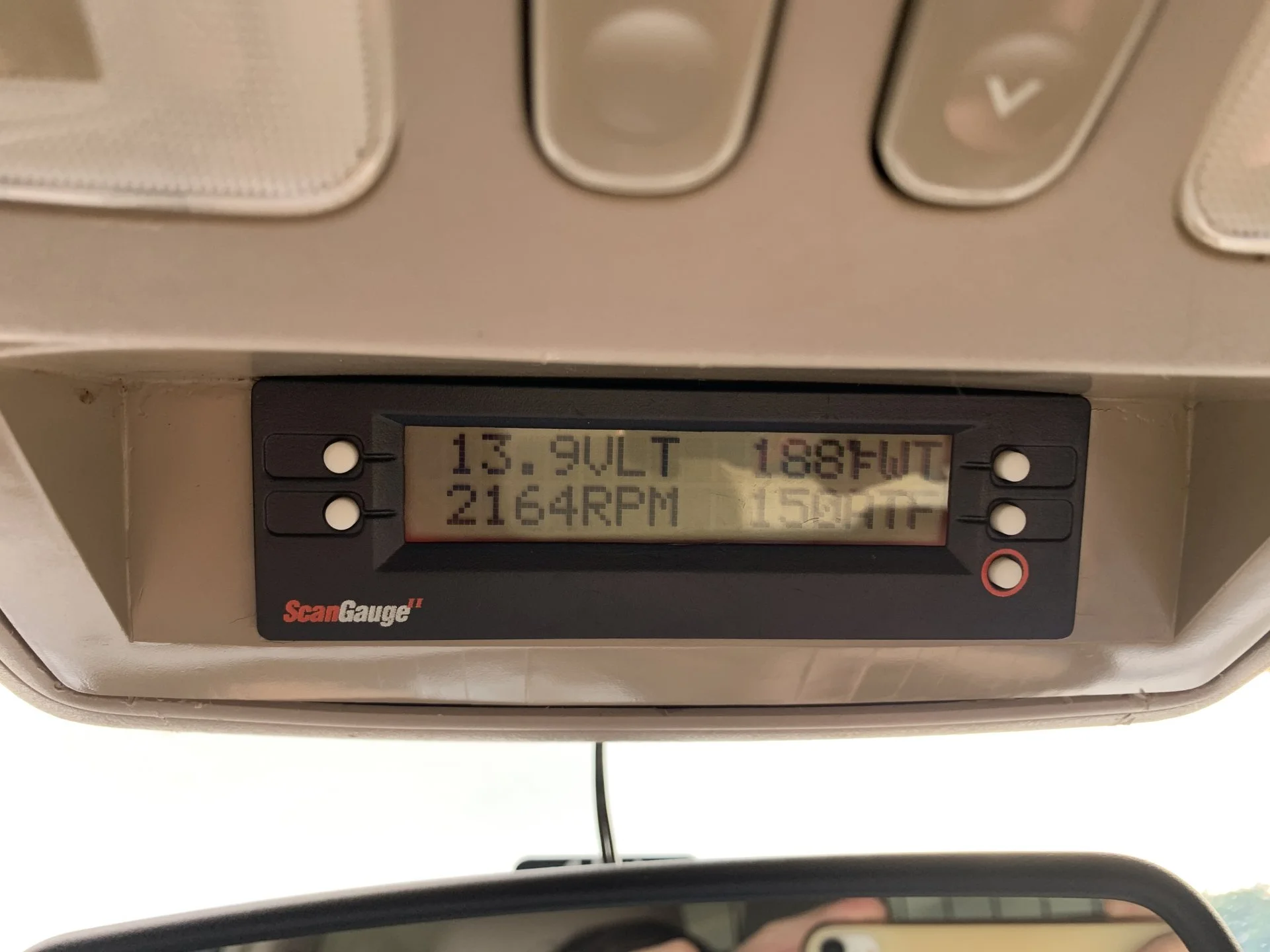

Hauled 2,200lbs of vinyl plank flooring + trailer weight (~1,100lbs) to the new house and she didn’t even break a sweat. 98° air temps and cruising at 65mph around 2200rpms caused it to briefly touch 188° coolant and 150° trans but it didn’t hang there for long.

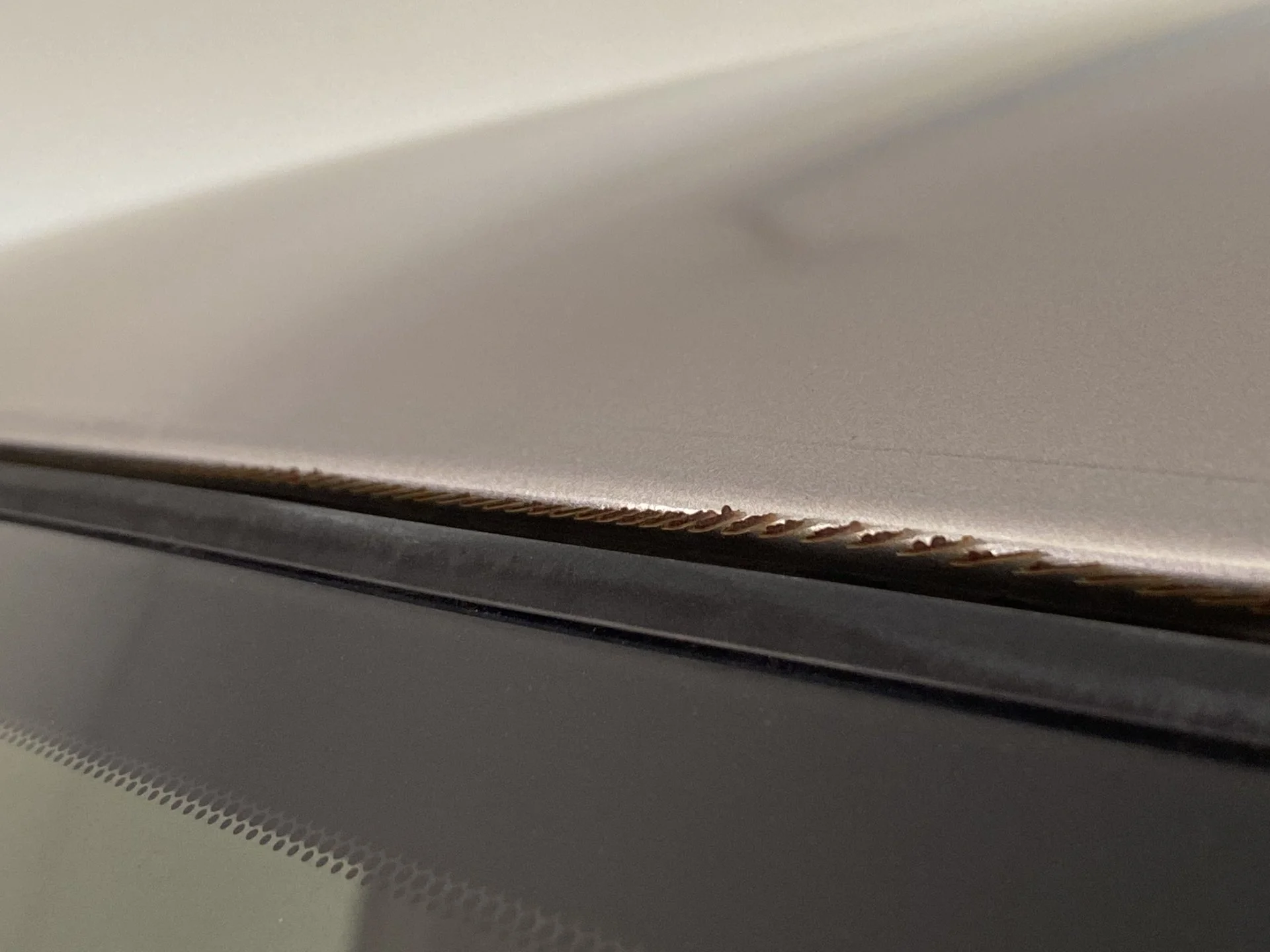

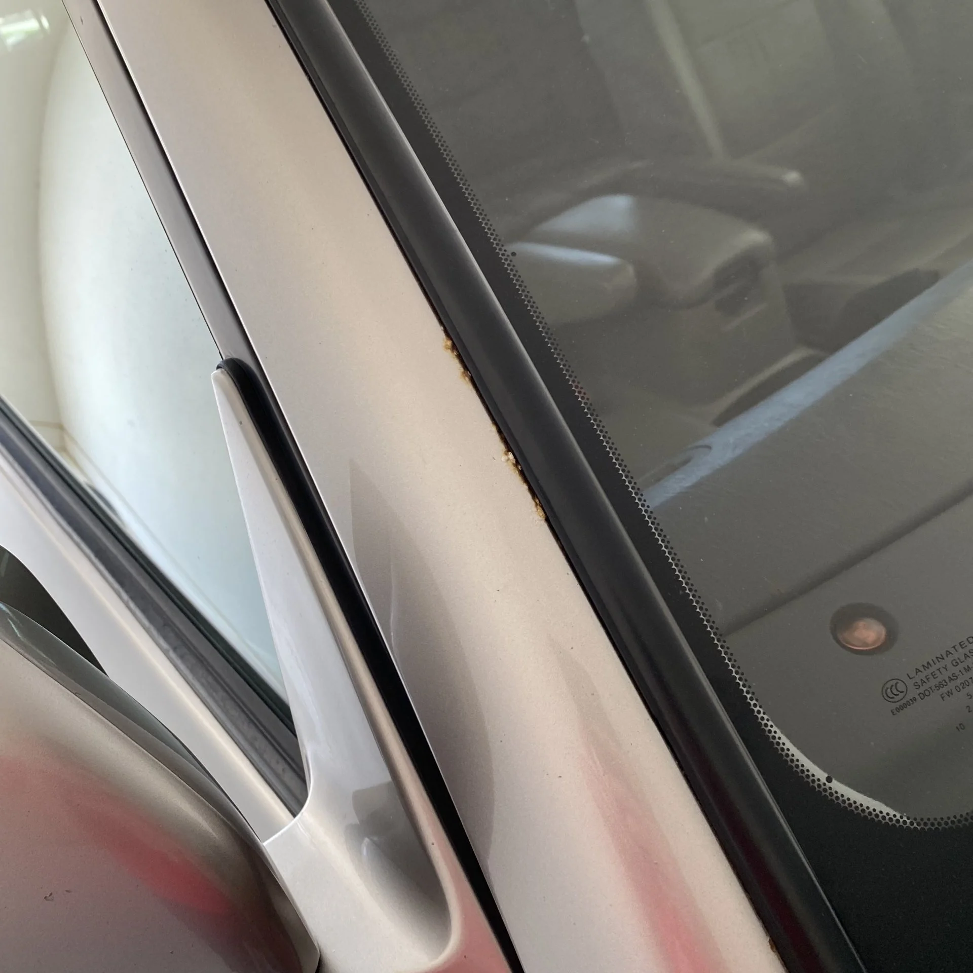

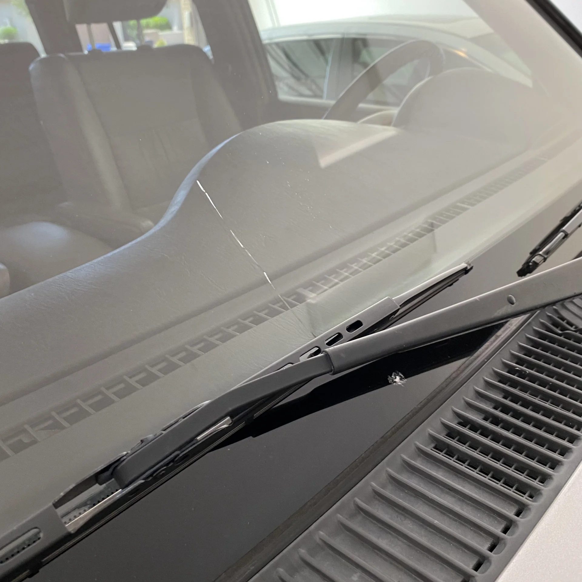

Was scheduled to get a new OEM TOYOTA windshield this morning (surprisingly my insurance company approved the $1K cost for genuine TOYOTA and I have no out of pocket on glass), but understandably, Safelite wants the rust addressed first. So I got some estimates and scheduled the work to be done.
After the windshield is professionally removed by Safelite, the collision shop is going to sand down the rust around all four corners of the opening, treat it with POR-15, and then prime, paint, and blend it. I also asked them to paint the rock-chipped grille winglets. $535 is what it’ll cost me. Sure, I probably could’ve gotten it cheaper at some hole-in-the-wall shop, but good work isn’t cheap and cheap work isn’t good.
View attachment 2751975View attachment 2751976View attachment 2751977
What look like grind marks are apparently some jack hole’s carelessness with a knife edge to remove the moulding and treat the rust prior. I have the receipt from the previous owner and he didn’t spend very much to address the rust then. It shows.

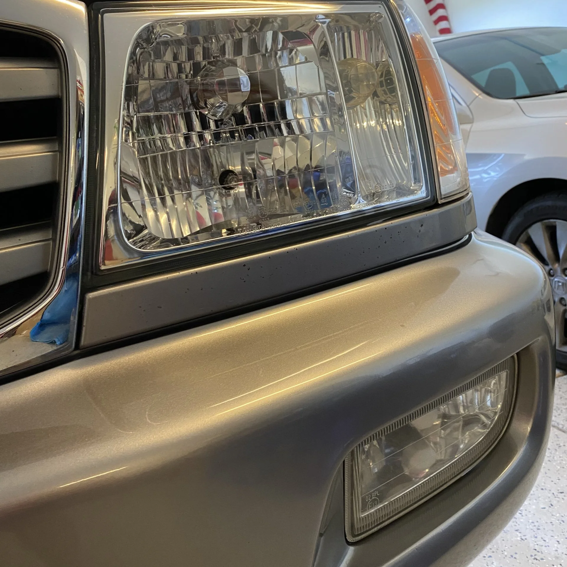

Rock chipped winglets.
Fit the acoustic insulated windscreen glass if you able to as it reduces sound and increases comfort levels considerably. Its standard for most of the Lexus models

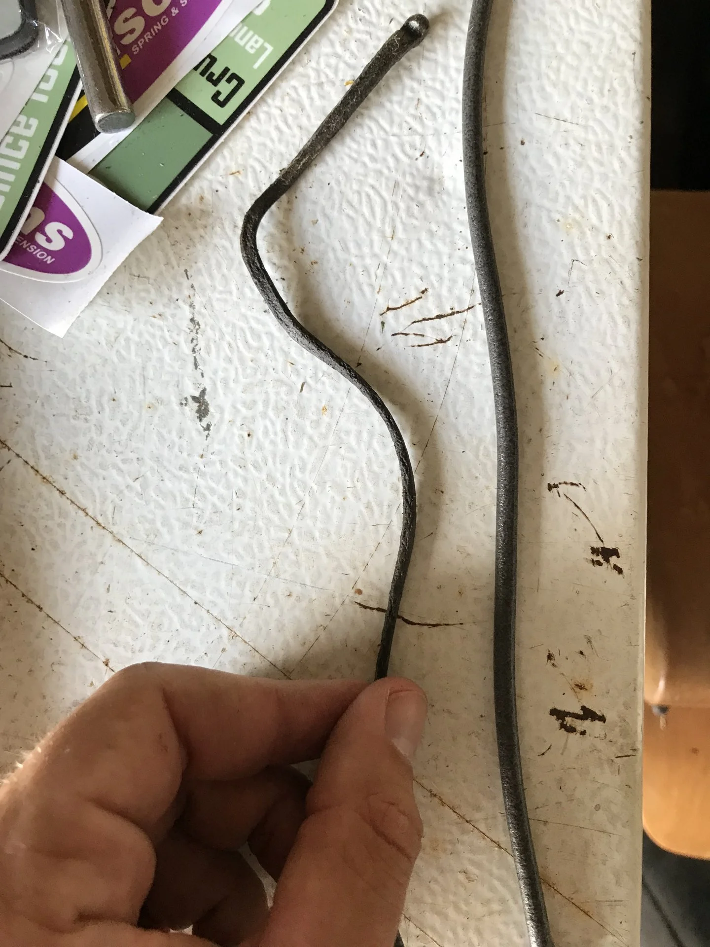

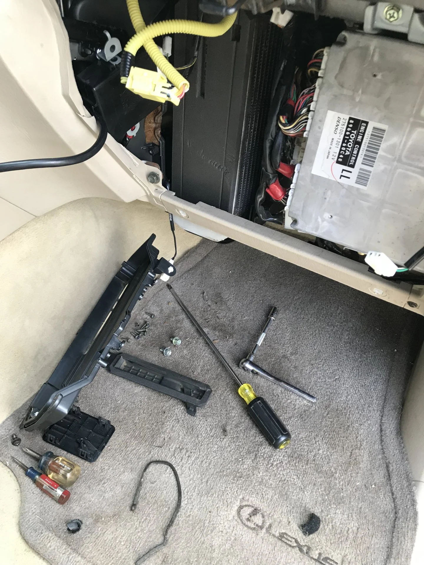

Replaced this little conveniently located evaporator case seal.. Man that's a tight fit. 184k miles and she'd had enough. No more passenger floorboard drip *the Toyota engineers really dropped the ball on that whole design..

Would you please let me know the X-Code inputs you have to get transmission temp working? Used some that I found in another thread but it didn’t work. I have an 02 and yours looks close enough.
I believe I used this one
ScanGaugeII supports Landcruiser transmission temperature. Here's a pic I took today:
2013-08-29
Model year 2000. I'm not sure if I can pull the code I used, but I recall that I found it on the Internet. I think this is the one that worked:
TXD: 686AF101B4
RXF: 044105B40000
RXD: 2808
MTH: 00090005FFD8
You can try that and see if it works. You can also label it however you want, I chose TM* (Transmission Degrees) but you can make it any 3 letter code you want.
But if that doesn’t work try these
This code worked on my 05
Scangauge:
TXD: 686AF121B4
RXF: 046105B40000
RXD: 2808
MTH: 00090005FFD8
Heres a thread to research other options: I think the codes that work on the newer 100's are backwards compatible
Transmission temperature on a late model 100 series
And then a more in-depth thread:
Torque app plus bluetooth adapter in my 100
Thanks, I have the code necessary (should have stated that). Looking for the procedure to enter the code (Xcode) into my ScanGauge.
TXD – 686AF101B4
RXF – 044105B40000
RXD – 2808
MTH – 00090005FFD8 for deg Fahrenheit
