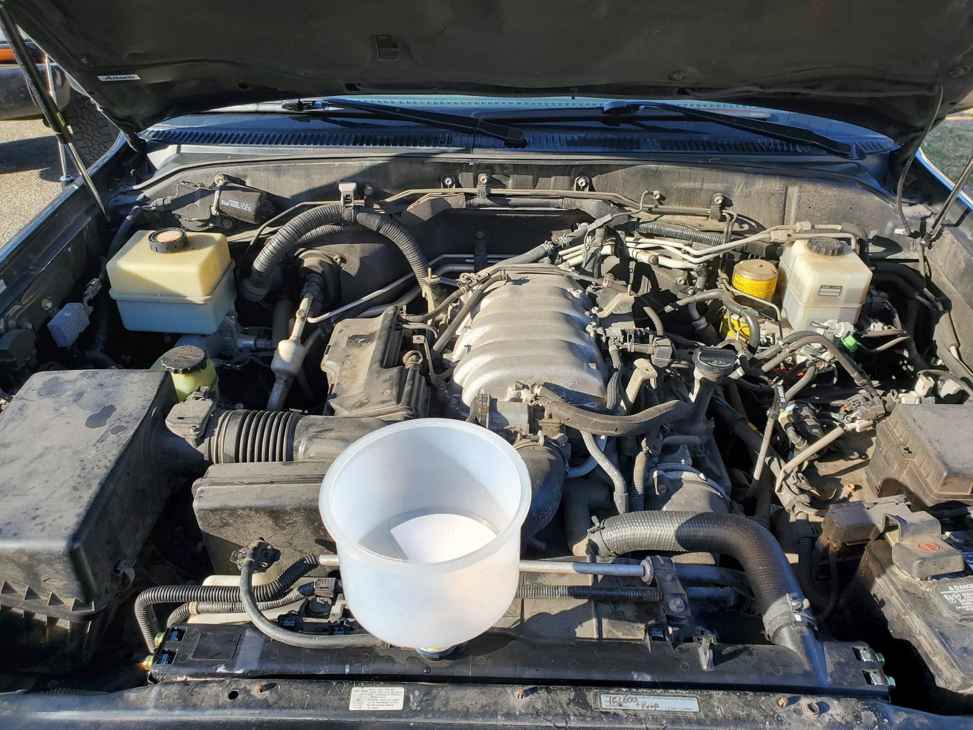

I have this job coming up soon so I'm just curious - What was your tool of choice to get that snap ring on/off? From what i've seen here a pick tool is recommended, but you probably had an easier go at it with the radiator out.Did a three beers job today...
Replaced radiator, hood supports, and A/C hub bearing.
Just a pair that has interchangable tips. Radiator being out made way easy. I was surprised the hub slid right off with no effort.I have this job coming up soon so I'm just curious - What was your tool of choice to get that snap ring on/off? From what i've seen here a pick tool is recommended, but you probably had an easier go at it with the radiator out.

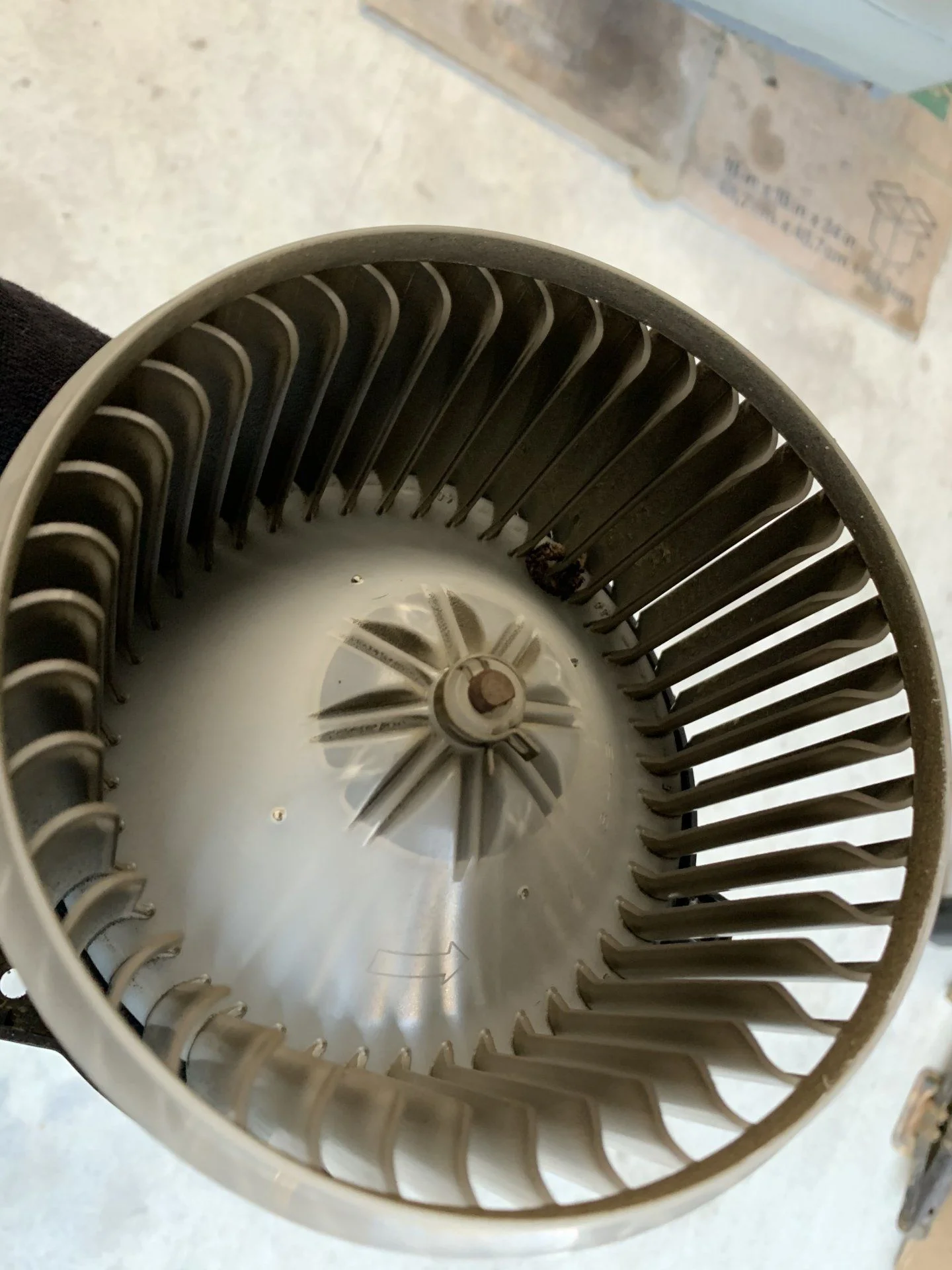

Also dropped my blower fan to figure out what was making noise. This little piece of vegetation was annoying me for the past 2 years:

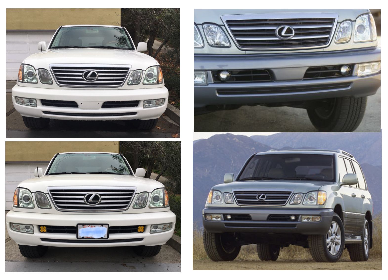

I am seriously considering to do this too. Did you get the sport / pro / max SS3? We drove through Cajun pass at night in San Bernardino CA and wife was driving, it scared the hell out of her, we couldn’t see anything because of the dense fog. I am running 55watts 6000k MiniH1 Morimoto projector clear lenses on my headlights and and Matchbox 2.0 35watts on the factory foglights and the light isn’t piercing through the white fog. I think I need an auxiliary yellow light that can do the job. Any output shots at night?I really liked the Diode Dynamics but their SS3 pods measured out a hair too big. I actually printed out the drawings at full scale, cut them out, and held them up to the LX to determine fit. You can see that the DD are about a 1/4” bigger than the BD. View attachment 2585999
I really liked the look of the lights on the LX with the heads-up display and I figured if Lexus put them out there they wouldn’t block any necessarily airflow. I figured lights in other locations would block some air.

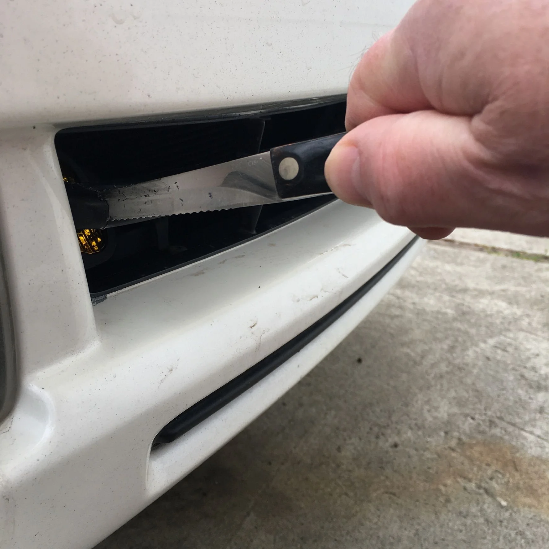

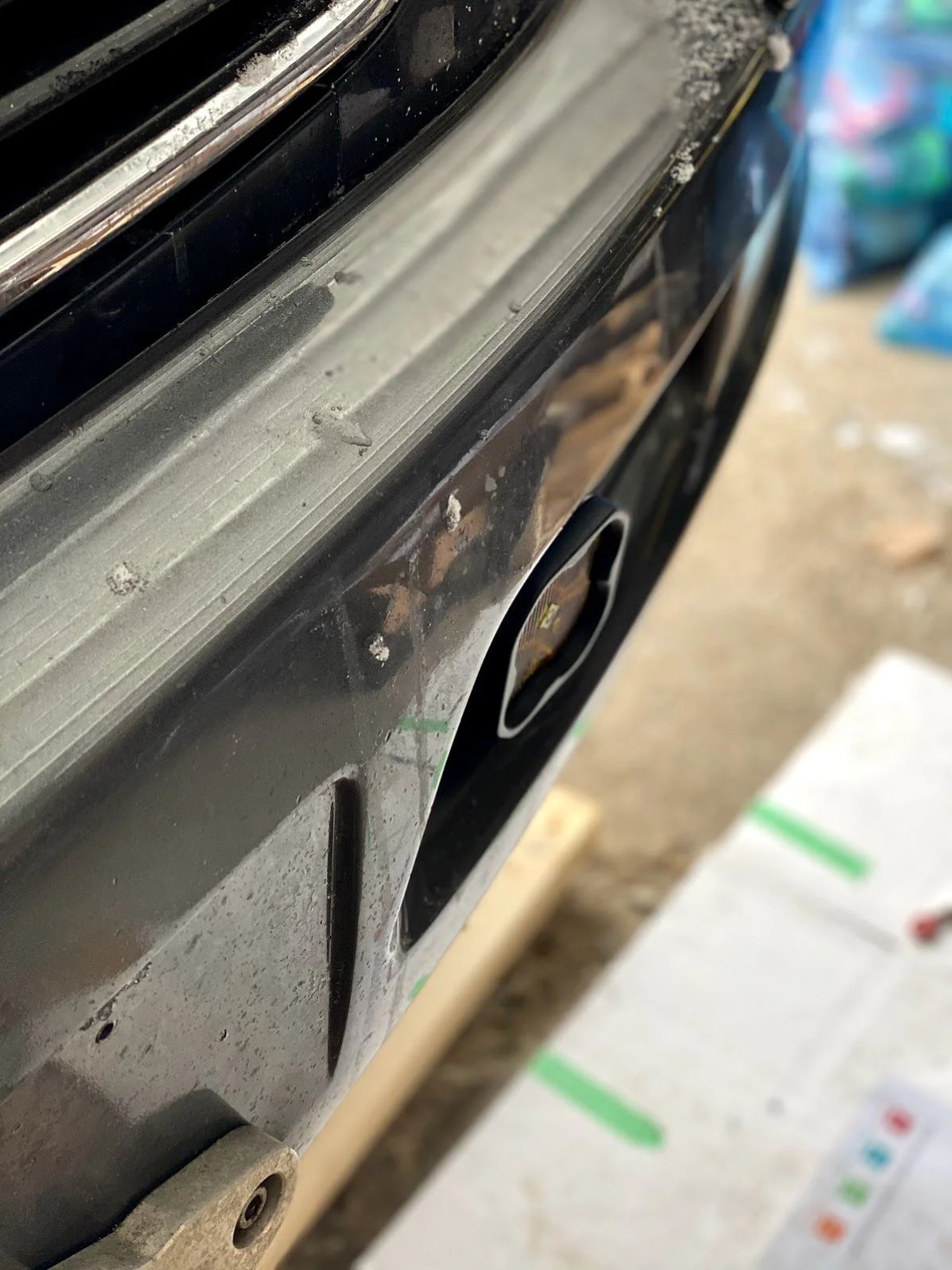

The grill cut really easily with a sharp serrated knife.

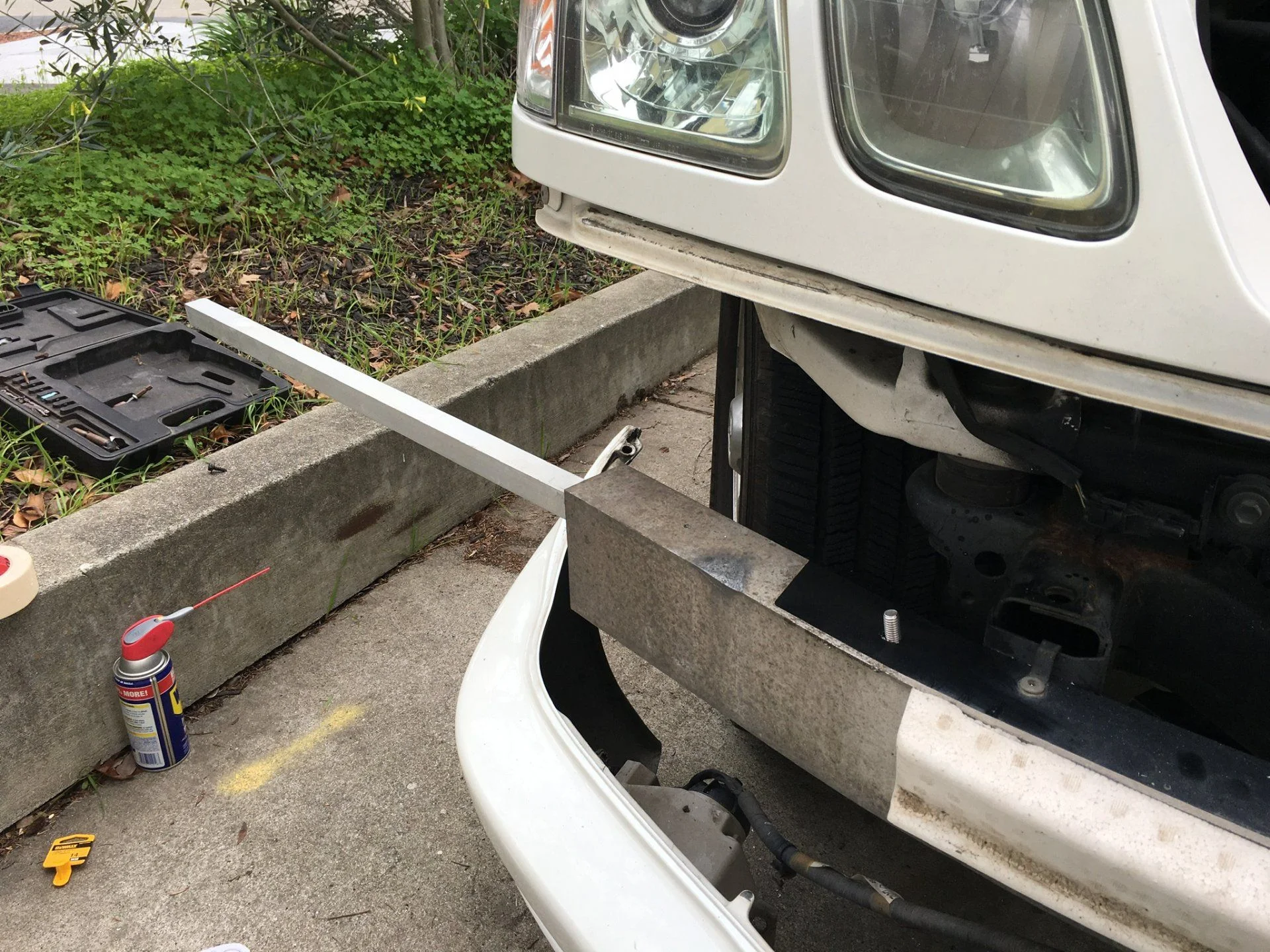

I had to use a 1x1 square aluminum tube as an extension for the longest wrench I had. I taped the bolt to the wrench and carefully slipped it through the 3/8” hole I drilled in the metal bumper beam.

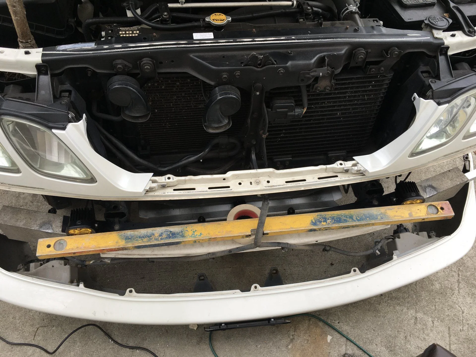

I used a level to get them straight and lined up before I tightened the nuts and bolts. They are inaccessible after the bumper is reinstalled.

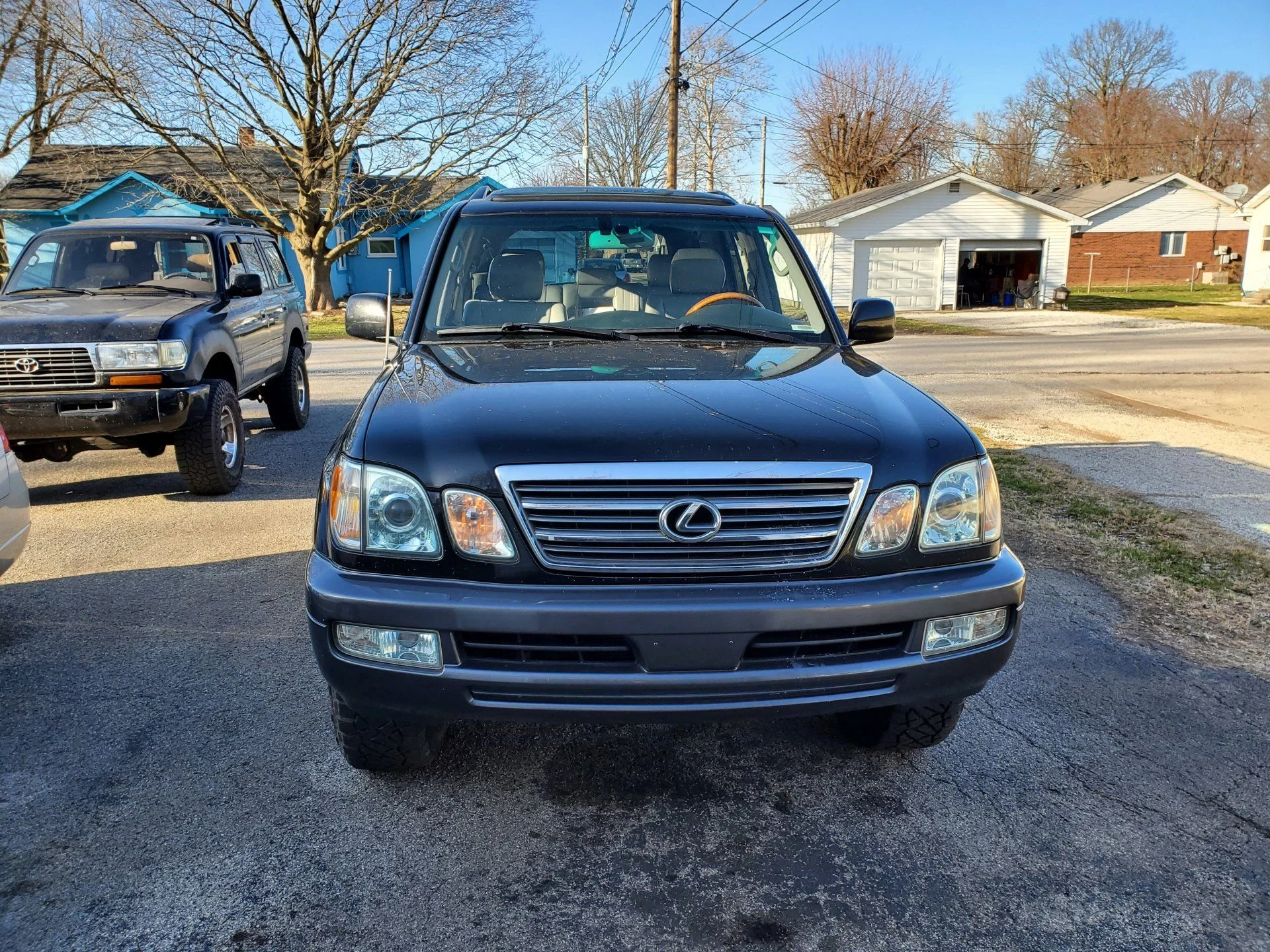

My 100 got a much needed bath after being ignored all winter while I restored a 40th. Nice family photo in the sun.

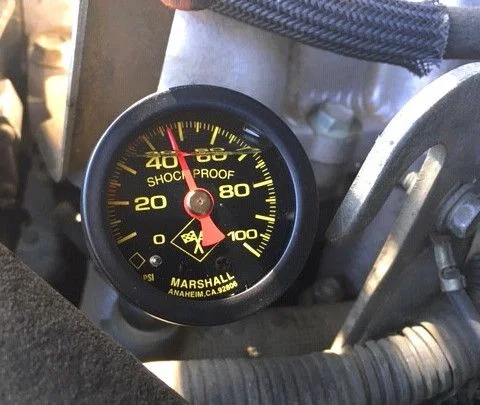

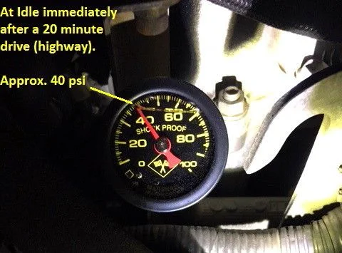

Thanks for doing and sharing. Did the same thing to mine this weekend. Running around 50lb, so I may have pressure regulator issue. But at least I know now.Edit/Update:
Took a couple readings tonight to follow up on this.
Wife came home and parked the vehicle. It had been driven for 20 miles at highway speed. I let it sit for 10 minutes and then went and looked at the pressure. It had dropped to about 36 psi.
I then cranked the engine and let it idle for a few minutes before recording the pressure (about 40 psi).

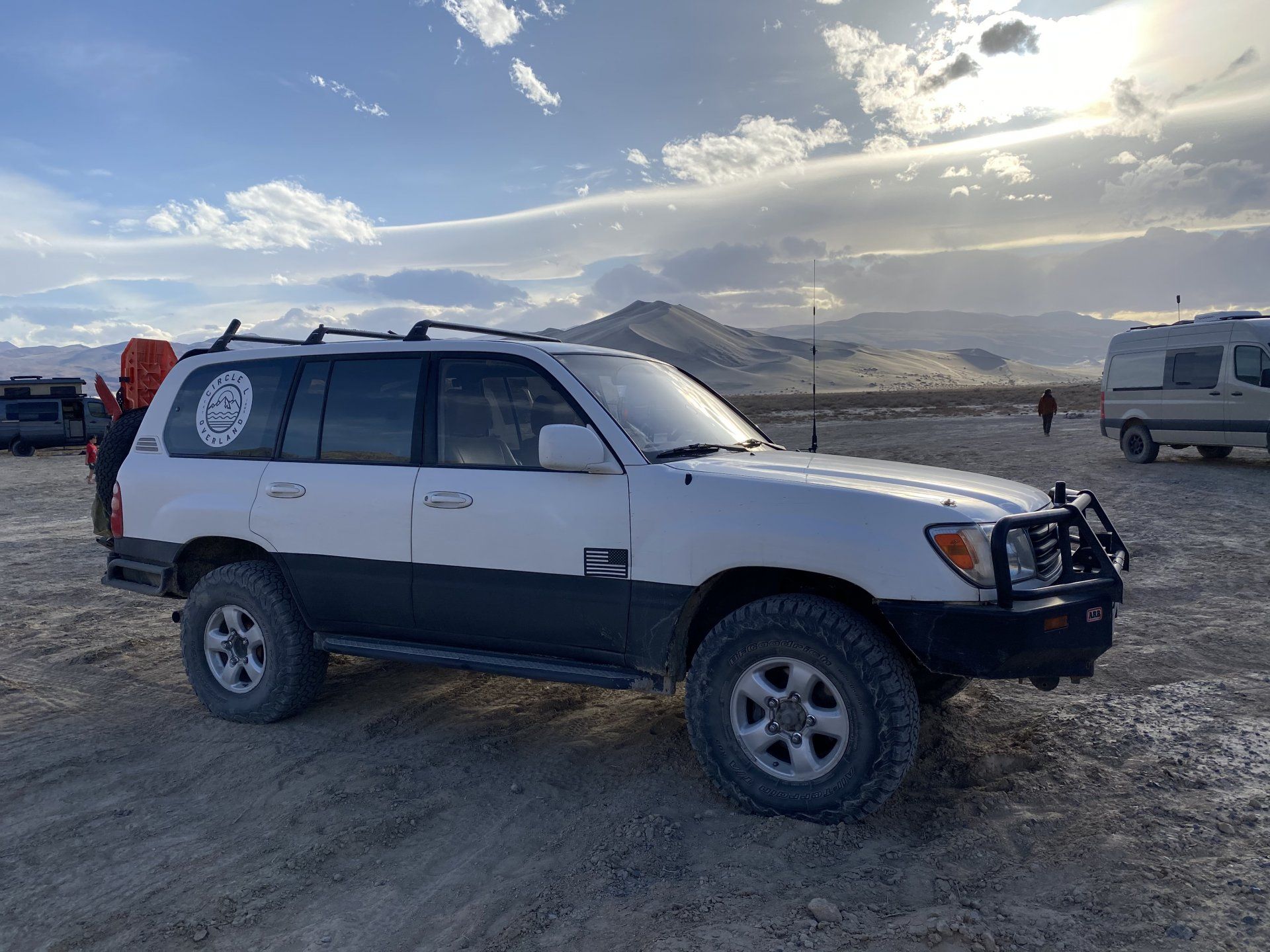

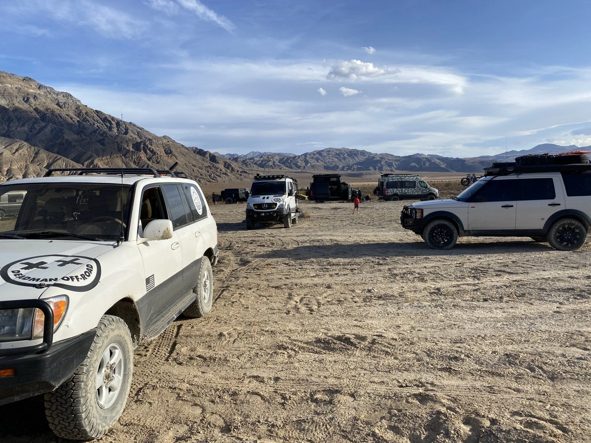

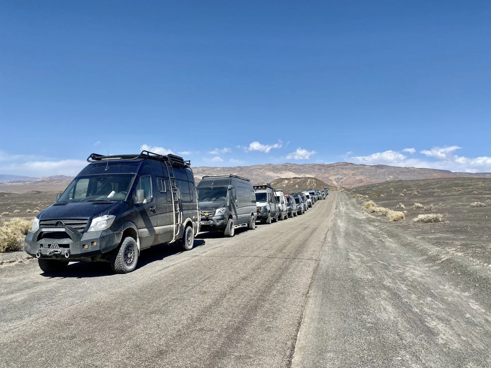

Okay tell us the truth, the guy in the Land Rover invited you along just in case..........Land Rover stuff happens?Trip into Death Valley with 20 some odd sprinter vans
He was the group leader actually.Okay tell us the truth, the guy in the Land Rover invited you along just in case..........Land Rover stuff happens?
Well that is one way to insure you won't get left behind!He was the group leader actually.![]()

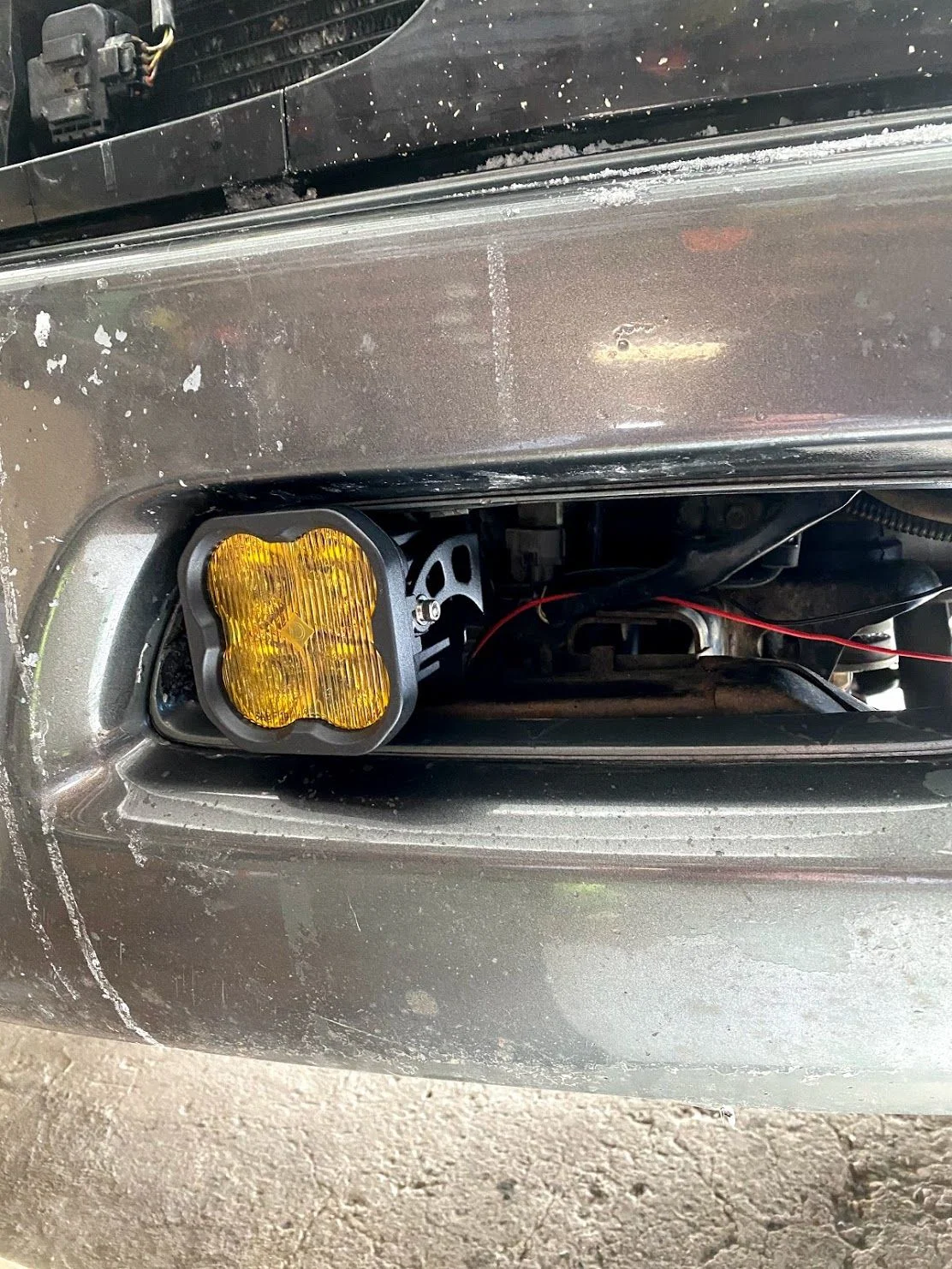

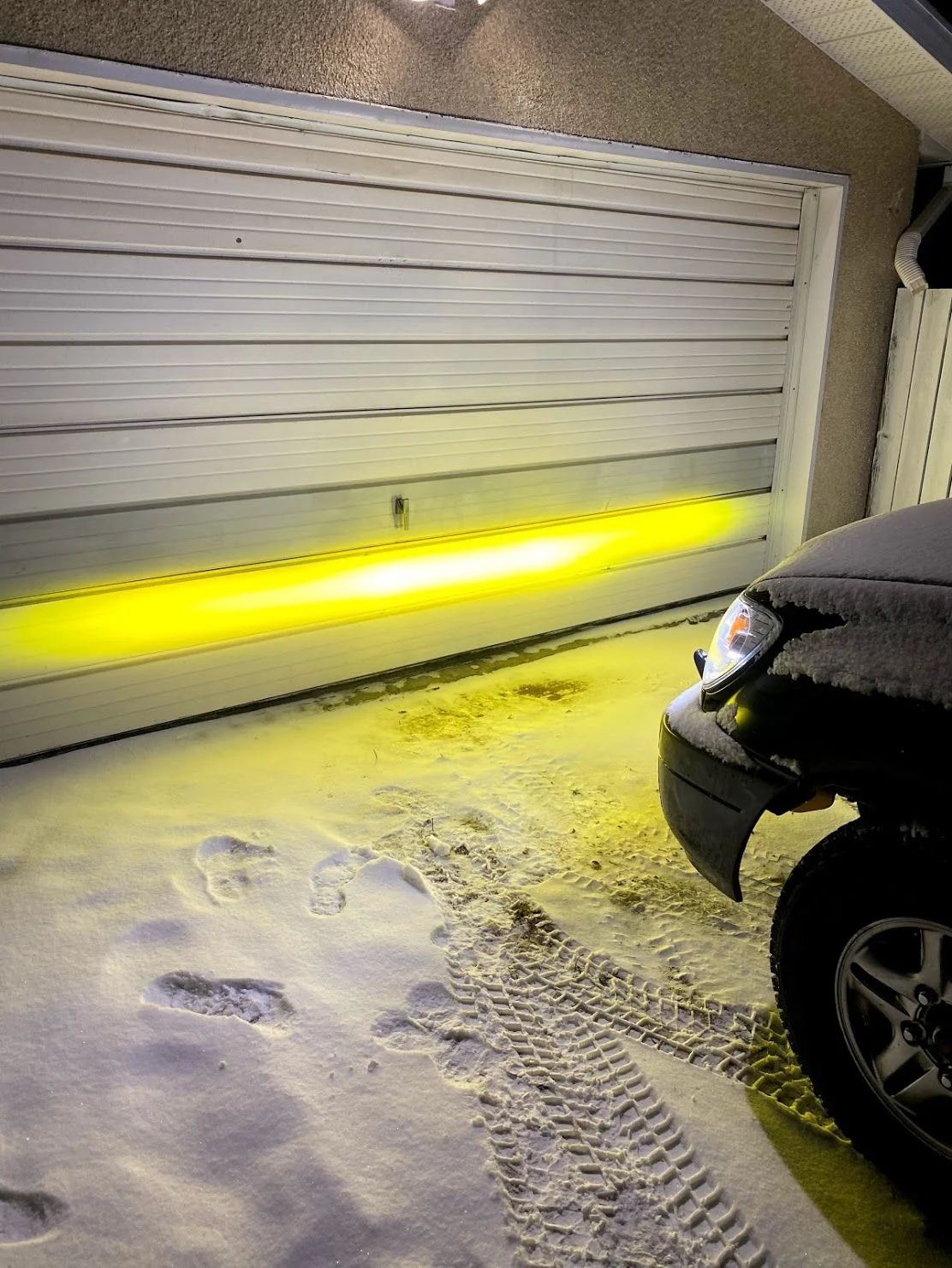

I actually ended up ramming mine in they fit nice imo. I got the max and boy they're bright and a cool wide beam. I welded a little L bracket to the bumper support. They wiggle a bit when I hit bumps but all in all not bad. I also didnt cut the horizontal plastic piece totally out of the left side and it looked better.I am seriously considering to do this too. Did you get the sport / pro / max SS3? We drove through Cajun pass at night in San Bernardino CA and wife was driving, it scared the hell out of her, we couldn’t see anything because of the dense fog. I am running 55watts 6000k MiniH1 Morimoto projector clear lenses on my headlights and and Matchbox 2.0 35watts on the factory foglights and the light isn’t piercing through the white fog. I think I need an auxiliary yellow light that can do the job. Any output shots at night?
Awesome bud! Damn those ss3 maxs are indeed bright!I actually ended up ramming mine in they fit nice imo. I got the max and boy they're bright and a cool wide beam. I welded a little L bracket to the bumper support. They wiggle a bit when I hit bumps but all in all not bad. I also didnt cut the horizontal plastic piece totally out of the left side and it looked better.
